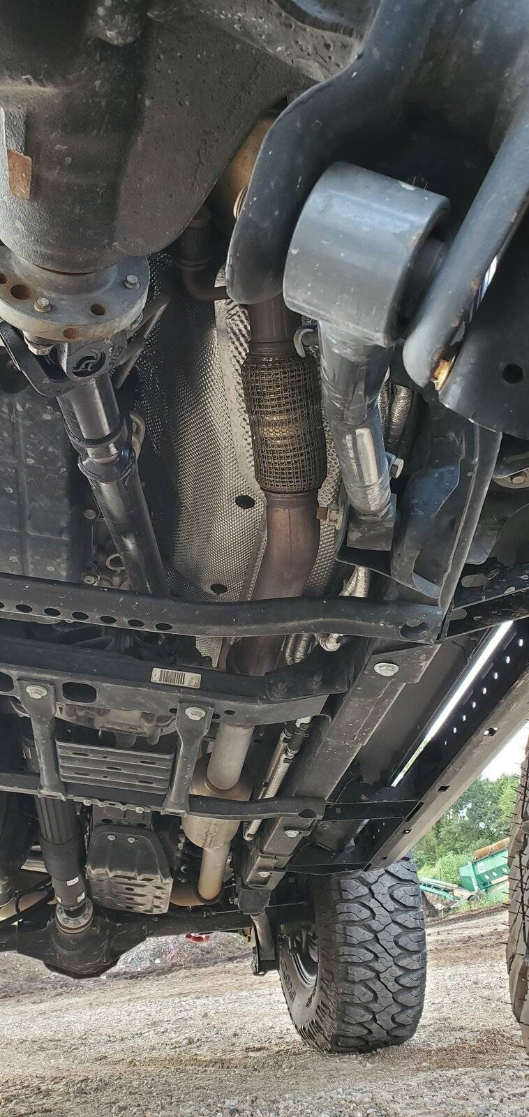

I thought I could continue using the arms, but that didn't work out. After just a couple of flex tests at work, I started noticing some handling issues as it's also my daily driver. I was under it a dozen times, quadruple checking everything and not finding a culprit. Knowing it had to be a bad bushing somewhere, I decided to start checking and the lower front control arms seemed like the most logical spot to start.
Turned out to be the tie rod end spinning in the adjuster bushing. The thing is, I checked them after the antiseaze treatment just like you and they were all soild. I loosened the pinch bolt and retorqued it to 90, but it wasn't as solid. I have a long pry bar with a pointed end that I use to misalign the bushing to check a pinch bolt or jamb nut. It took 110 on the pinch bolt to make it right again. The Jeep was back to driving like a dream, so I went back to keeping UPS busy.
A short time later, after another flex test, the same driving issue started to crop up again. I put it back up on the forks so I could see what the control arms looked like. In this pic, the front right tire was 40" off the ground and the back axle was still a couple of inches away from fully into the bumpstops.

I pulled the arms and retorqued, but couldn't get them solid before the slot in the bar became fully collapsed right at the pinch bolts. A few weeks later and all 8 synergy arms were put into a Metalcloak control arm box that's still sitting in my garage. The front and rear uppers were still OK, but both pairs of lowers were spinning under the clamping force due to not having enough misalignment in the bushing ends. All this babble is just a heads up to keep an eye on them. They were definitely not made to handle a lot of flex.
