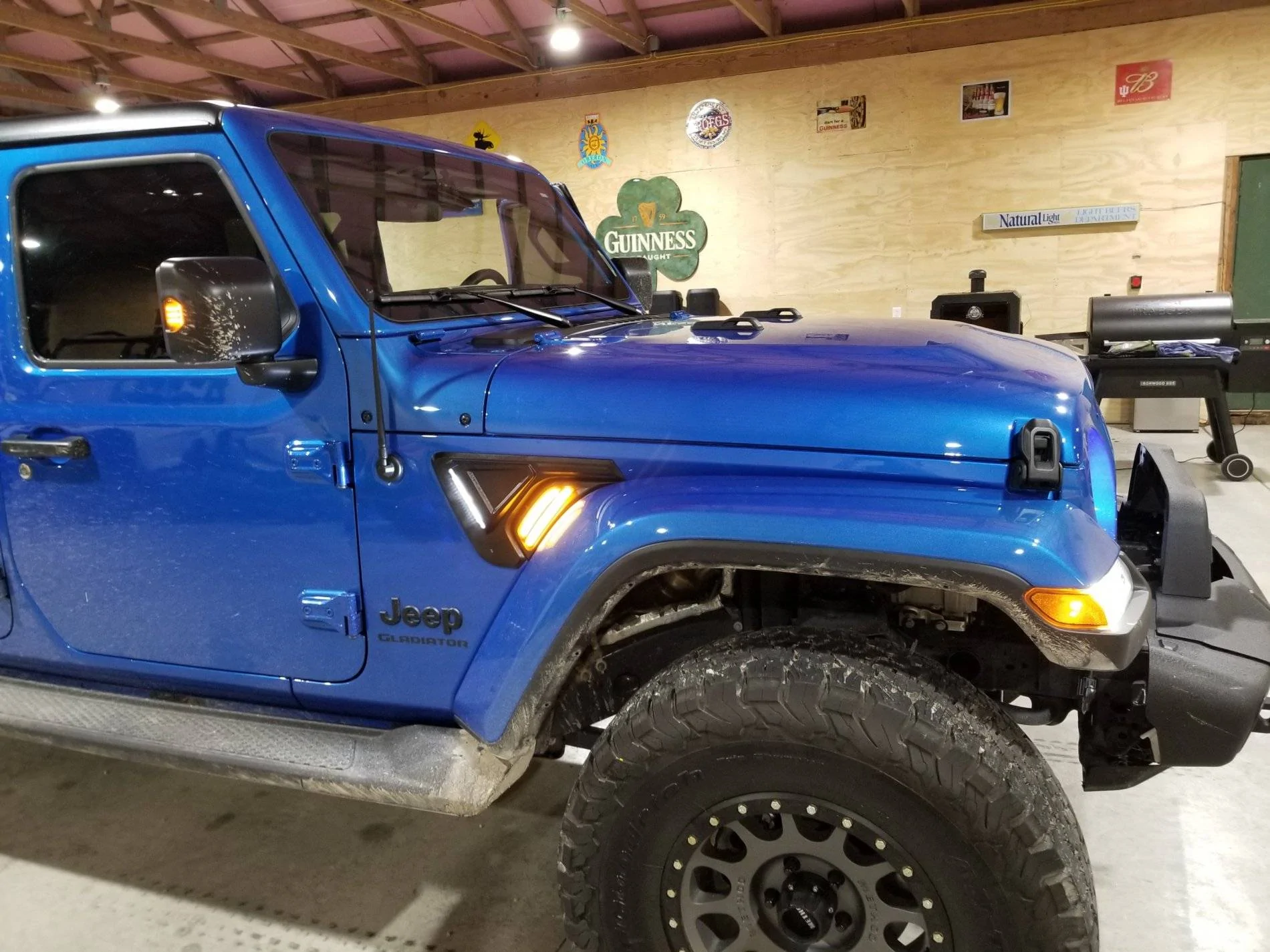

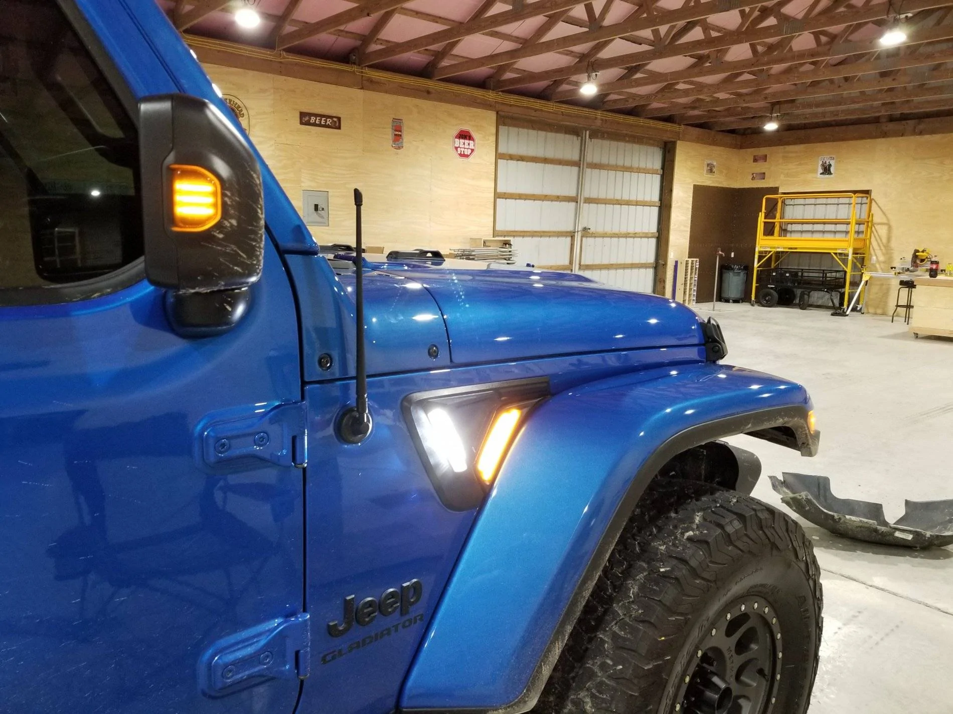

Added Mirror Turn Signals

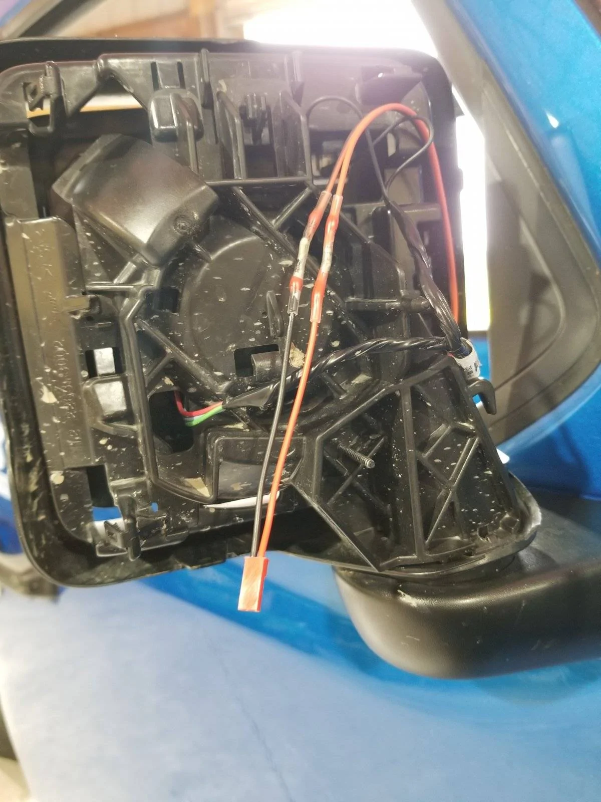

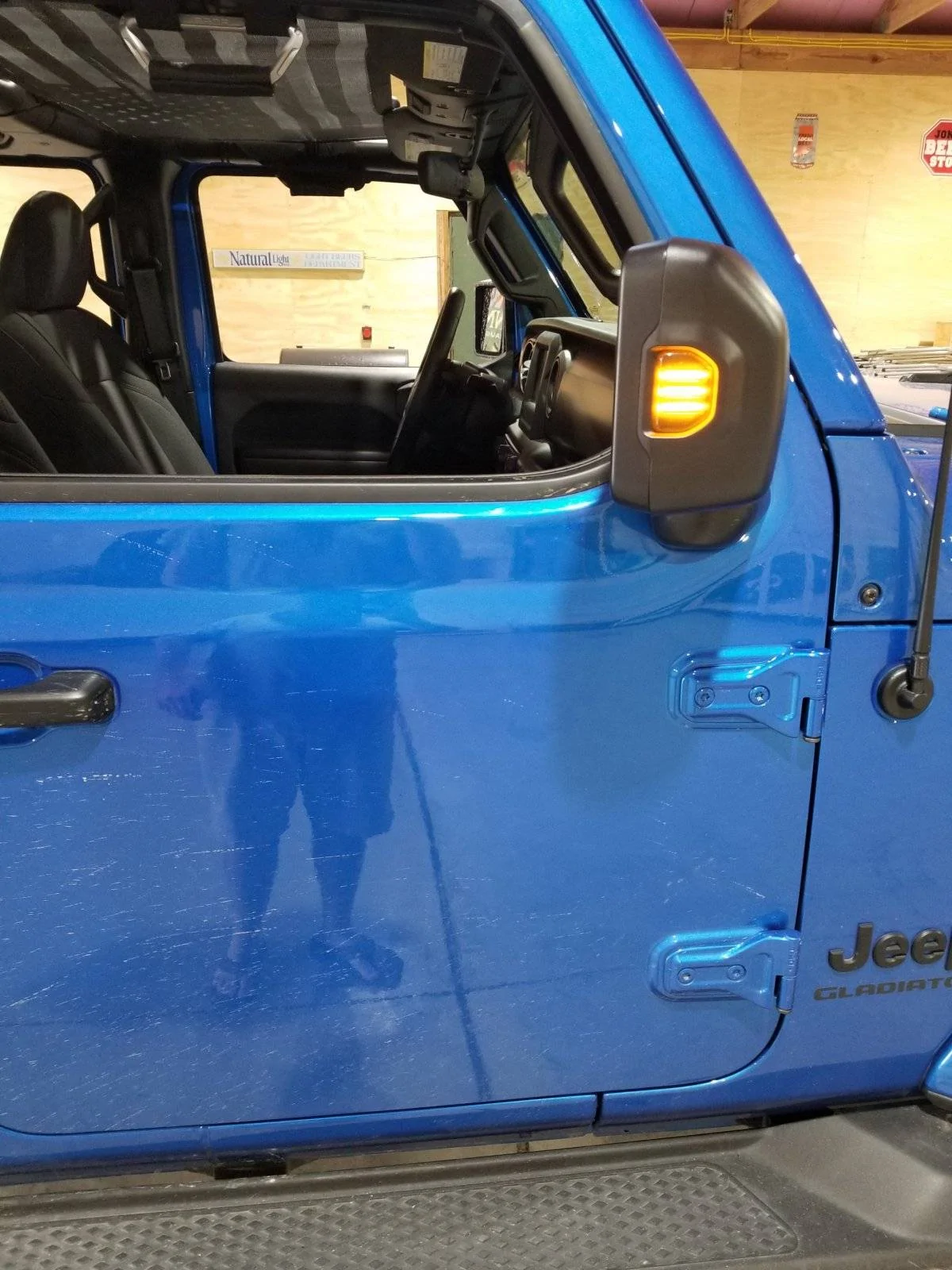

Awesome, thanks! It plugs right into the light itself, you can see the 2 little pins in that picture, it doesn't snap in or anything but I think it will hold. I was going to run a separate wire alongside the other wires for the mirror, ill take some pics when I get to wiring it up

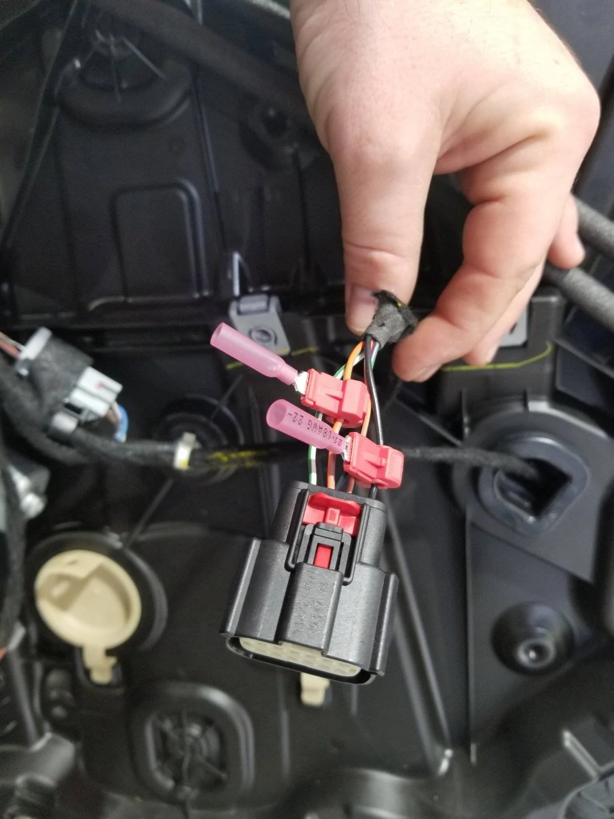

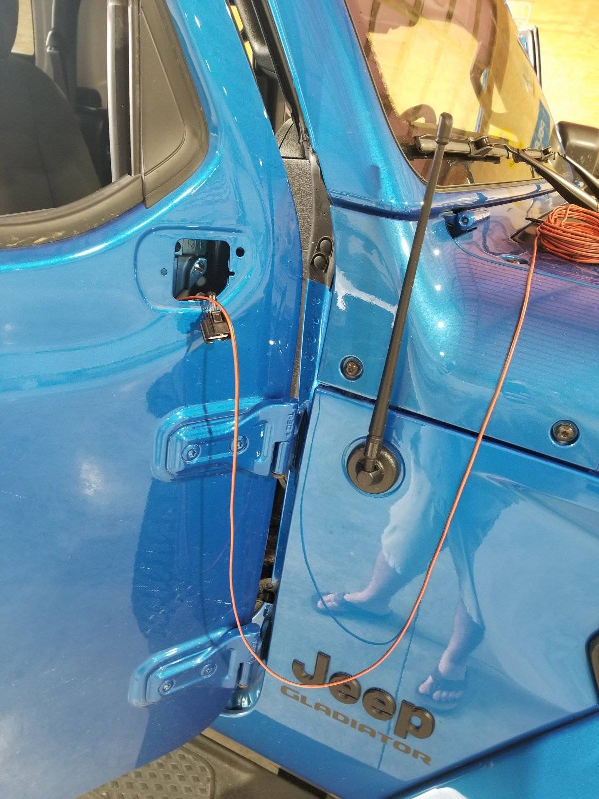

So I got the passenger light in, wasn't sure where to get the power from, I was wanting to have it on all the time, since I am planning on putting on oracle sidetracts. I found two wires that I was getting 12v across when the engine was running and not when the engine is off so I tapped into those two seen in the picture, this is the plug that goes to the lock/unlock button on the door. Worked initially but then quit and I'm not getting any power across those wires or across the corresponding pins down at the main wire connector for the door. Ok HELP! The lights are 3 watts so I don't see how that would have blown a fuse. I guess I need to figure out how to get power back to those pins/wires. No warning lights or any signs of problems when driving

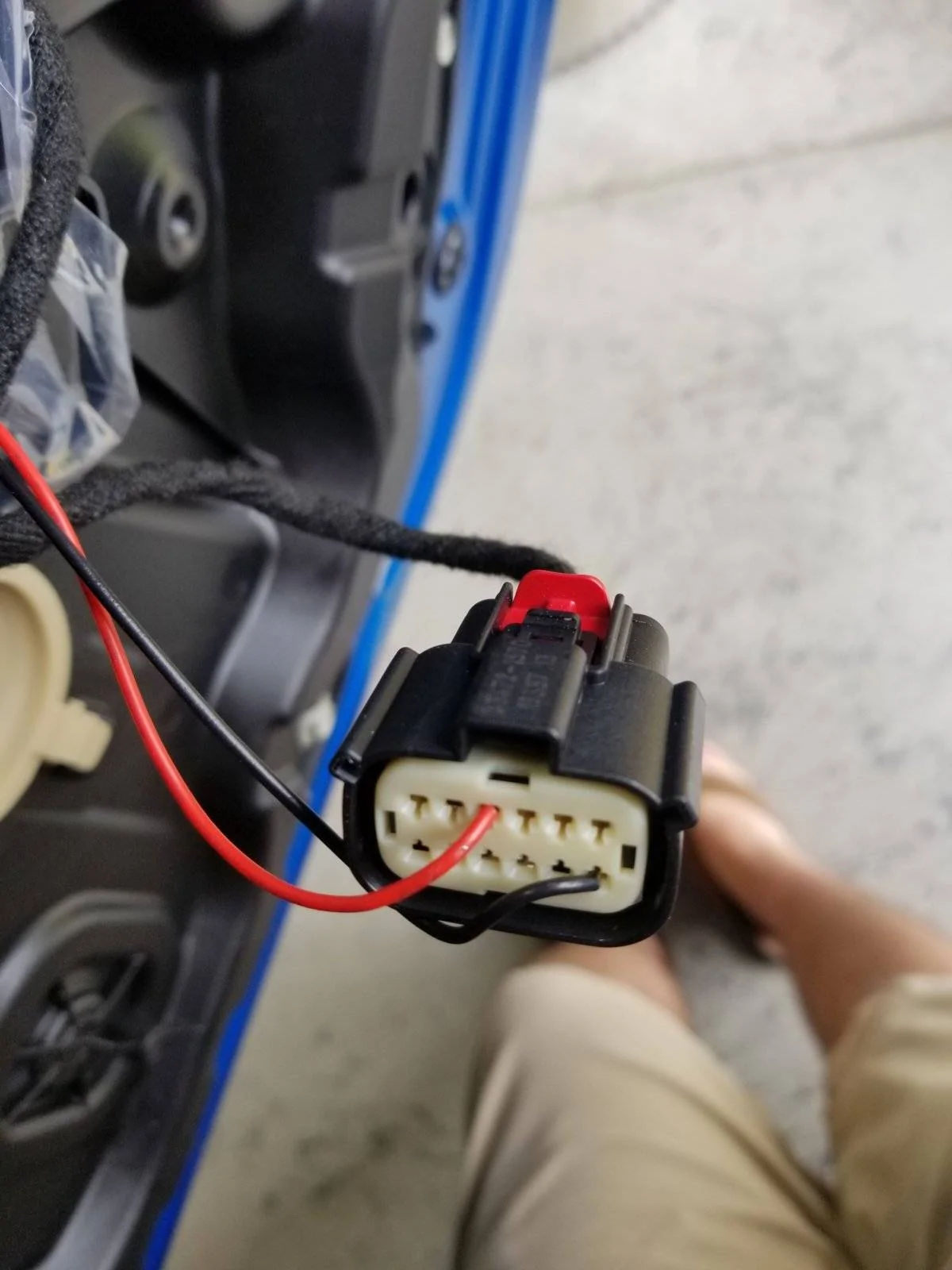

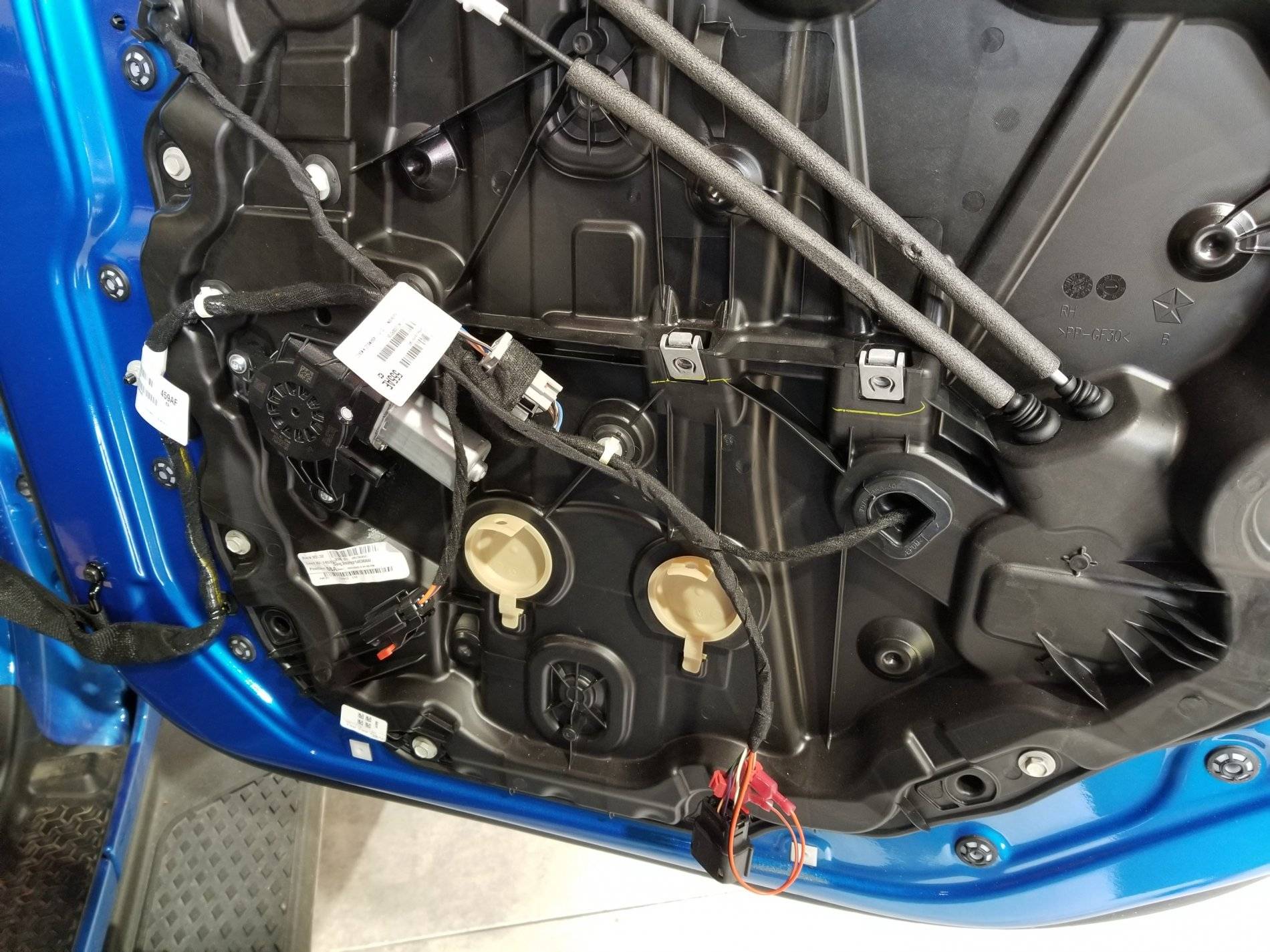

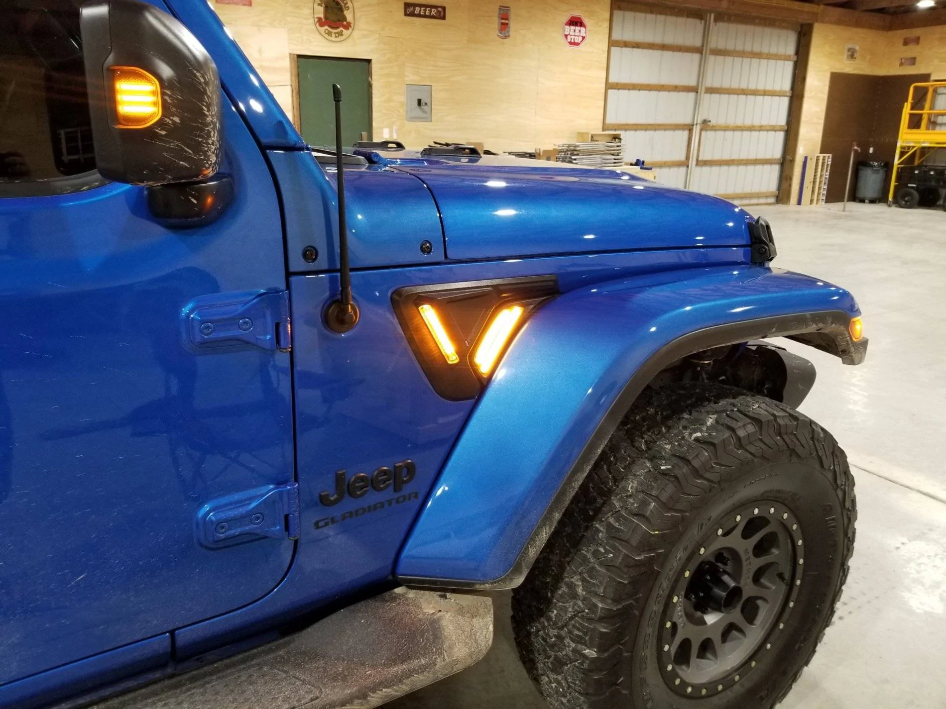

I ended up running power to my side mirror light from my turn signal harness under the fender when I added the vent light and oracle side tracts. I ran the wire down the door and through the bundle of wires at the bottom of the door and put a disconnect along side the big one for taking the doors off. I have the vent light and mirror light on as running lights and the oracle has the turn signal and a white light that comes on with the entry lights

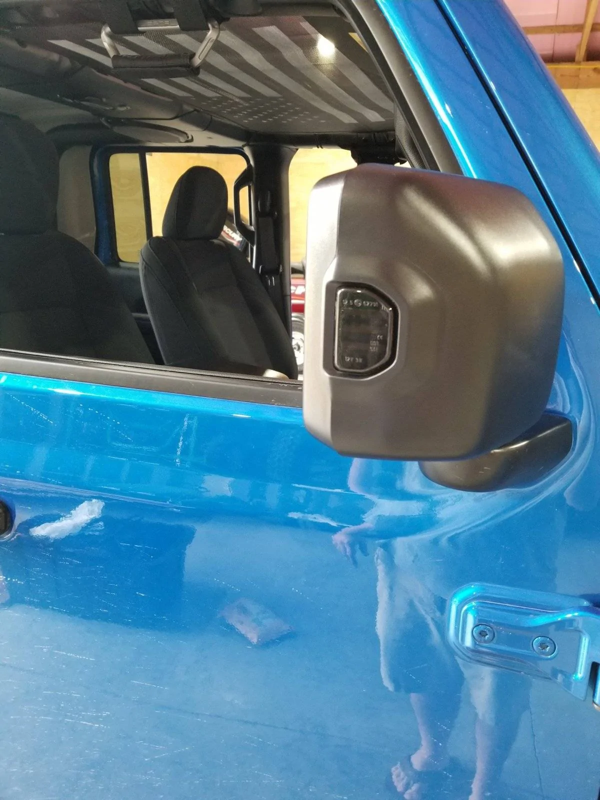

No worries. So the cap I ordered, 68361982AA, is the factory matte finish and didn't need painted or anything and I'm waiting to receive 68361983AA and that should be the same. I did see there is a set, 82215786, that is both caps but they are an unpainted glossy look

The part numbers for the matte black caps that match the original factory ones but have the light cutouts are 68361982AA and 68361983AA (still waiting for this one to arrive but it should be the matching drivers side mirror cap)
