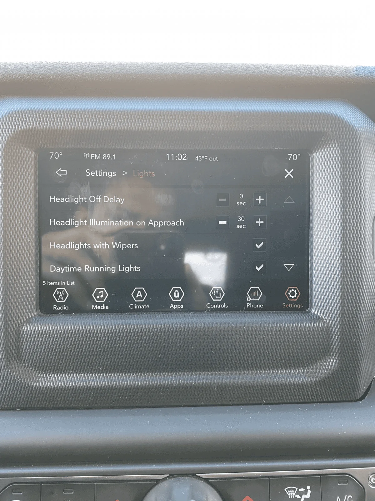

I just tried this and nothing. I can get the DRL working on the orange turn signal but not the white.
I saw this screenshot with the enable DRL options in Uconnect but I do not have it. Even after enabling the option in Jscan

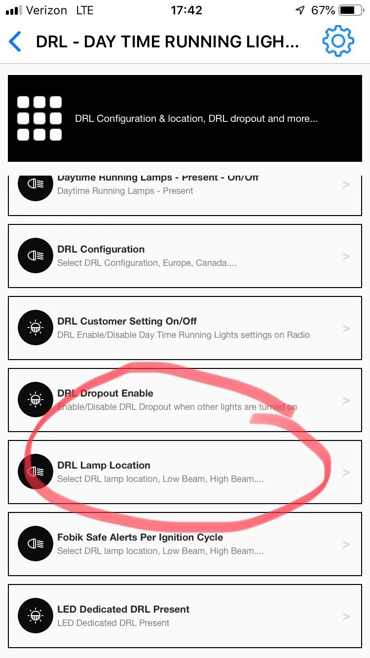

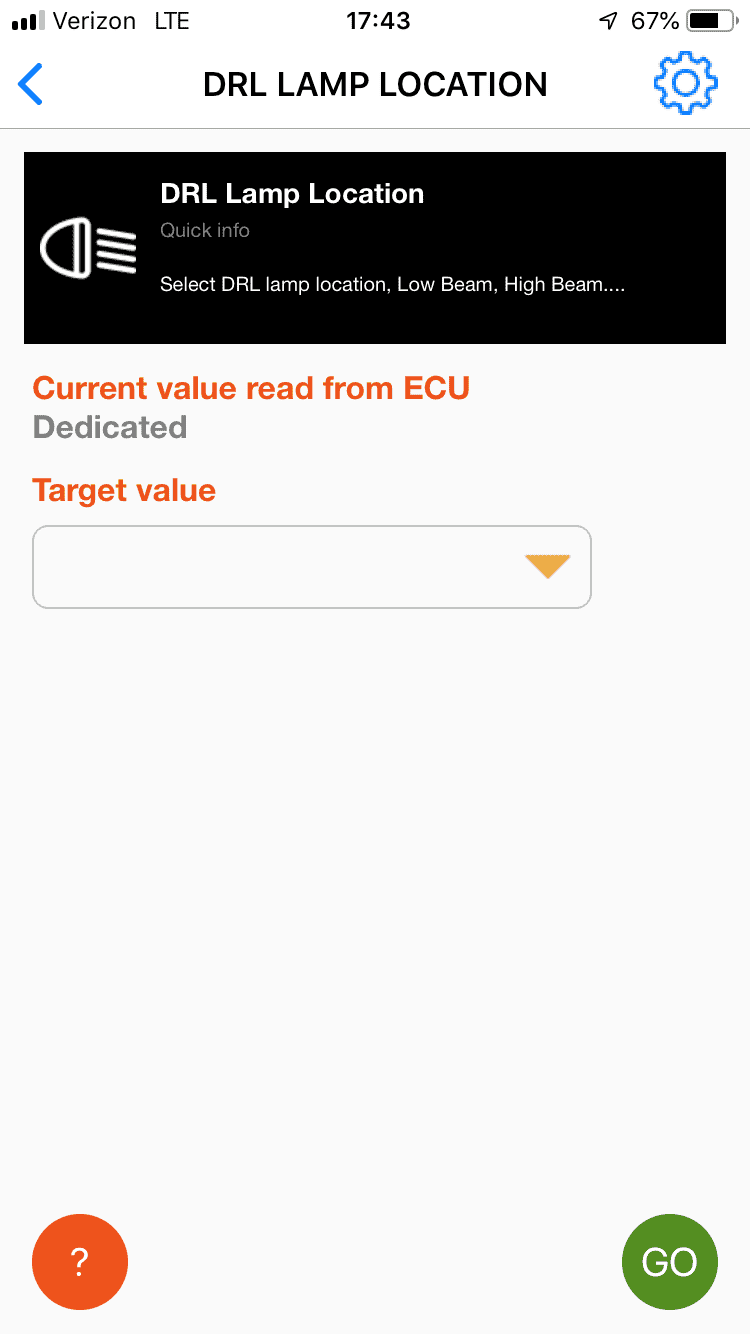

Chris,
In the app change this setting
Jeep Wrangler JL Morimoto turn signals. 1609375581510
Jeep Wrangler JL Morimoto turn signals. 1609375689092
