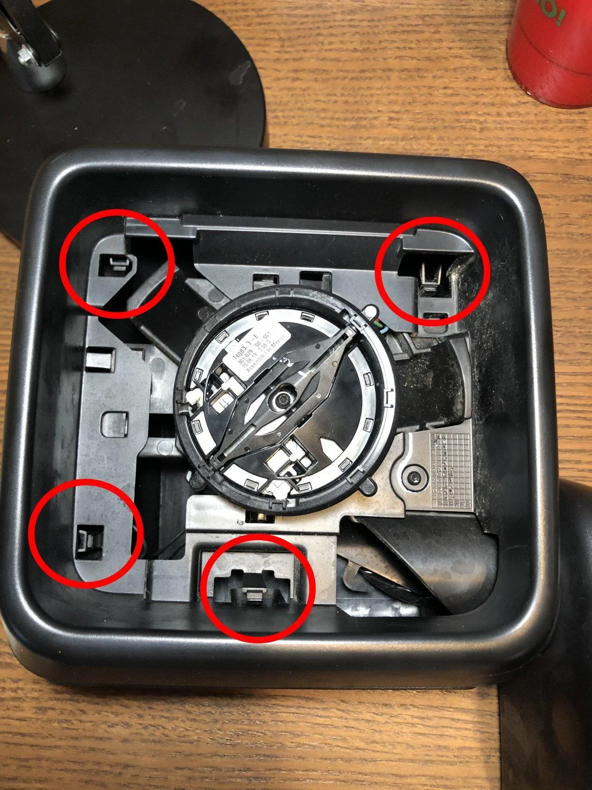

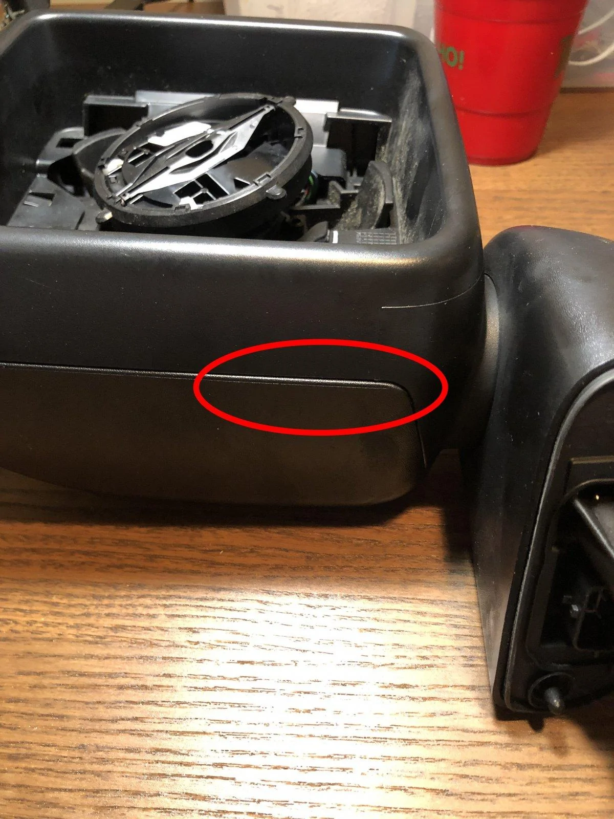

Hey Steve, so once the glass is off there will be 4 clips inside that need to be disengaged. The trick is you have to disengage them as you go around the outside with a plastic trim removal tool. The 1st pic are the clip locations and the second is where I like to start with my trim tool. That way any mistakes will be on the bottom but also I found this area has the most give when inserting the tool. Once it's in work it around as you disengage the clips.

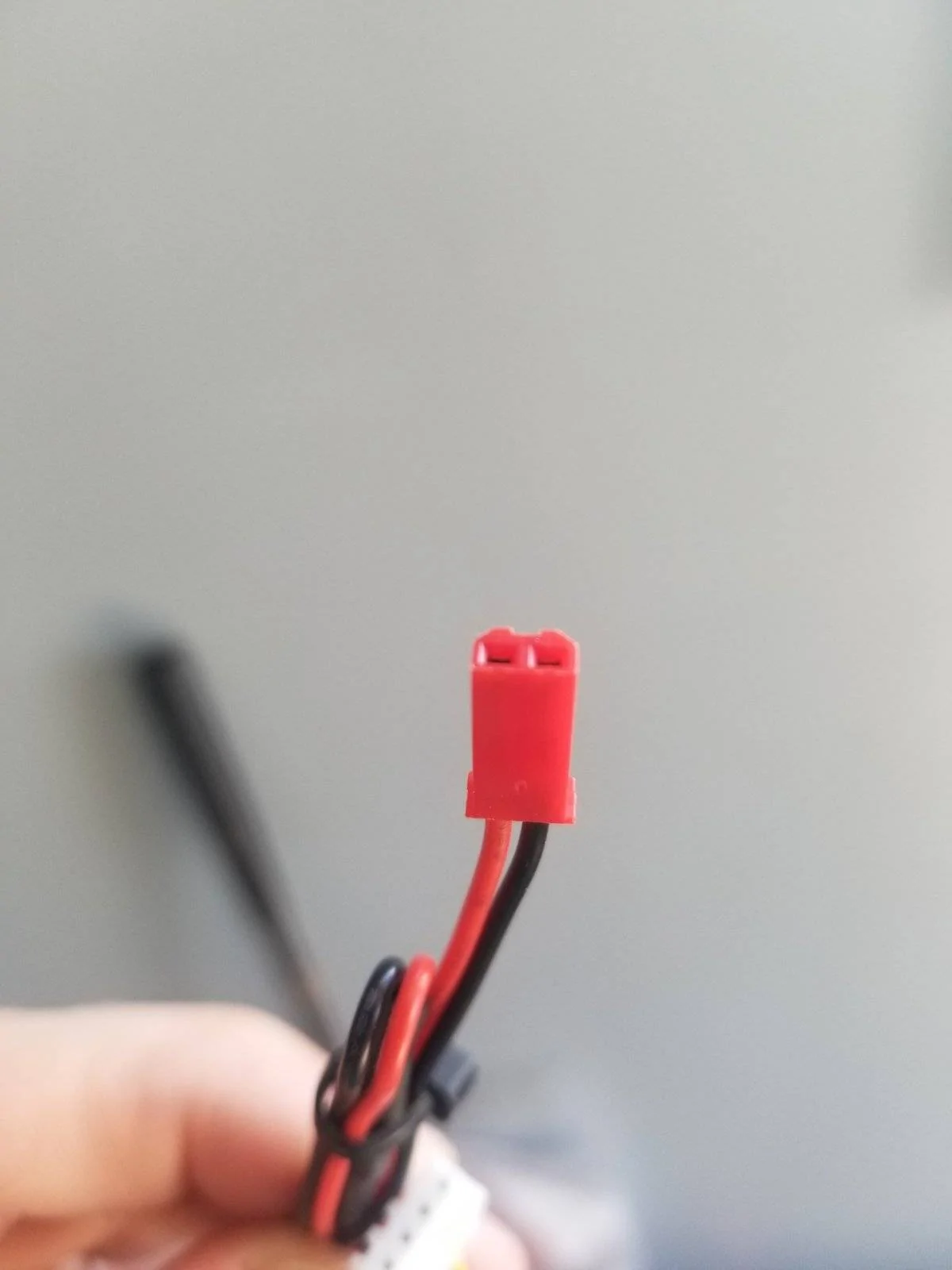

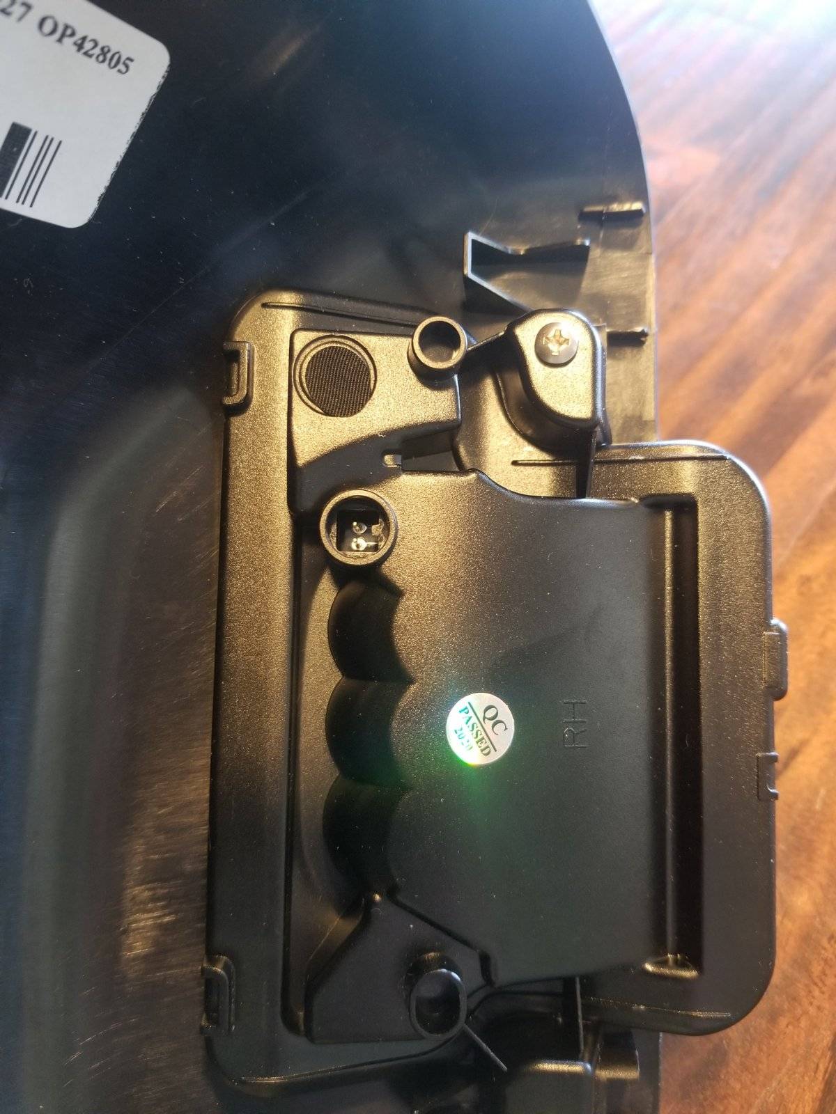

Hey, Im in the same boat. I ordered a new mirror cap after losing my passenger side one to a tree branch hanging out in the road. Anyway I accidentally ordered one with the light cut out, so instead of sending it back I ordered lights to put in. From going thru some model r/c stuff I found connectors that fit, and the polarity on the lights I have didn't matter, it lit up with neg/positive on either position.
https://www.amazon.com/Silicone-Connector-SIM-NAT-Connectors/dp/B07R4YBXYX
These are the lights I have, I assume it's the same connector
https://www.amazon.com/NDRUSH-Assembly-Compatible-Wrangler-Gladiator/dp/B08NWLV5KY
