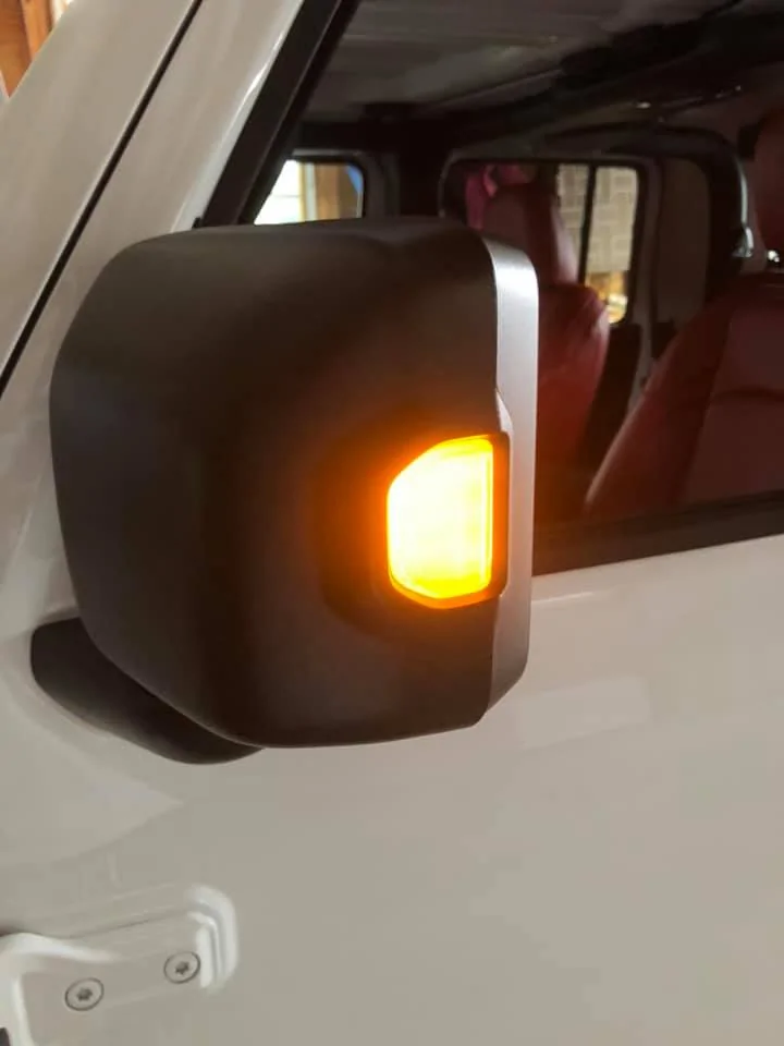

I've always thought having the turn signals visible to the sides via a side marker is of huge benefit safety-wise when making lane changes, etc. Really wanted to add the turn signals in like they come on the Euro-spec models and finally took a crack at it this weekend.
For starters, my US-spec JL had power/heated/blindspot monitor mirrors to begin with.
I ordered the Euro-spec version of the mirrors that had the same specs power/heat/blindspot + turn signal indicators. Thanks to @RocketScientist for the help with getting the part numbers. Anyone interested for these specific versions of the mirror they are:
Right 68281902AD
Left 68281903AD
(Last two letters may be updated to new rev like AE or AF)
These part numbers above include the following options:
-blind spot (XAN)
-black texture (LE4)
-heated (GTB)
-turn signal (LES)
The big question was would the wiring be present? All indicators I could find from speaking to others as well as my research on Tech Authority showed the turn signal wire would NOT be present. This turned out to be correct, it was NOT plug and play. The other features (heat/blindspot/power) worked plug and play since that was already on my JL from the factory, so just the turn signal wire needed to be run. The indicator is grounded already through the mirror so you don't need to run a ground.
I ran a wire from the front LED turn signals (the green/white striped wire was tapped on each side) for each respective mirror. Wires were run into the cab, into the cloth wire harness and into the doors up to the mirrors. I added disconnects at the mirrors and at the doors for door removal.
With the mirrors, the blue/black wire is the one that needed to be routed for the turn signal feed. I pulled the wire out of the mirror plug, added a connector to it, and plugged that into the turn signal wire I ran up to the mirrors.
Very happy with the results. Also the Euro-spec mirrors have different convex areas than US-spec, they both have convex areas on the outer parts. I found this gives a huge improvement in visibility on the driver's mirror especially.
Install took me about 4 hours for the first side just figuring things out, testing, finding the best way to do it, and then only about an hour for the second side. I removed most of the clips for the fender liners on the front to have access to the wiring there.
Another option: is to purchase and add the lights only + new covers on your existing mirrors. Apparently when you buy just the covers they come with a semi-glossy finish for some odd reason. I didn't want this so I ordered entirely new mirrors.

Just FYI as i'm working on this now.. your indicator should have two wires. You will always have the blue/black stripe which needs to be wired to the turn signal. The 2nd wire(ground) will either be green or black. IF it's black and you don't have BSM, your indicator will not be grounded. The black ground is piggy tailed off the ground for BSM. If you have the green, it's directly grounded through the harness, but most cases you won't have anything on the door harness.
Long story short, if you don't have BSM, you will need to ground to pin 10 (ground for heated mirror)
mjoneil
matt
Sep 10, 2020
MA
gladiator
up and running! thanks for the info @paulr
ended up tapping into parking lights so they are always on... gonna give it a few days and see if I want to keep them there or tap into the directional.
