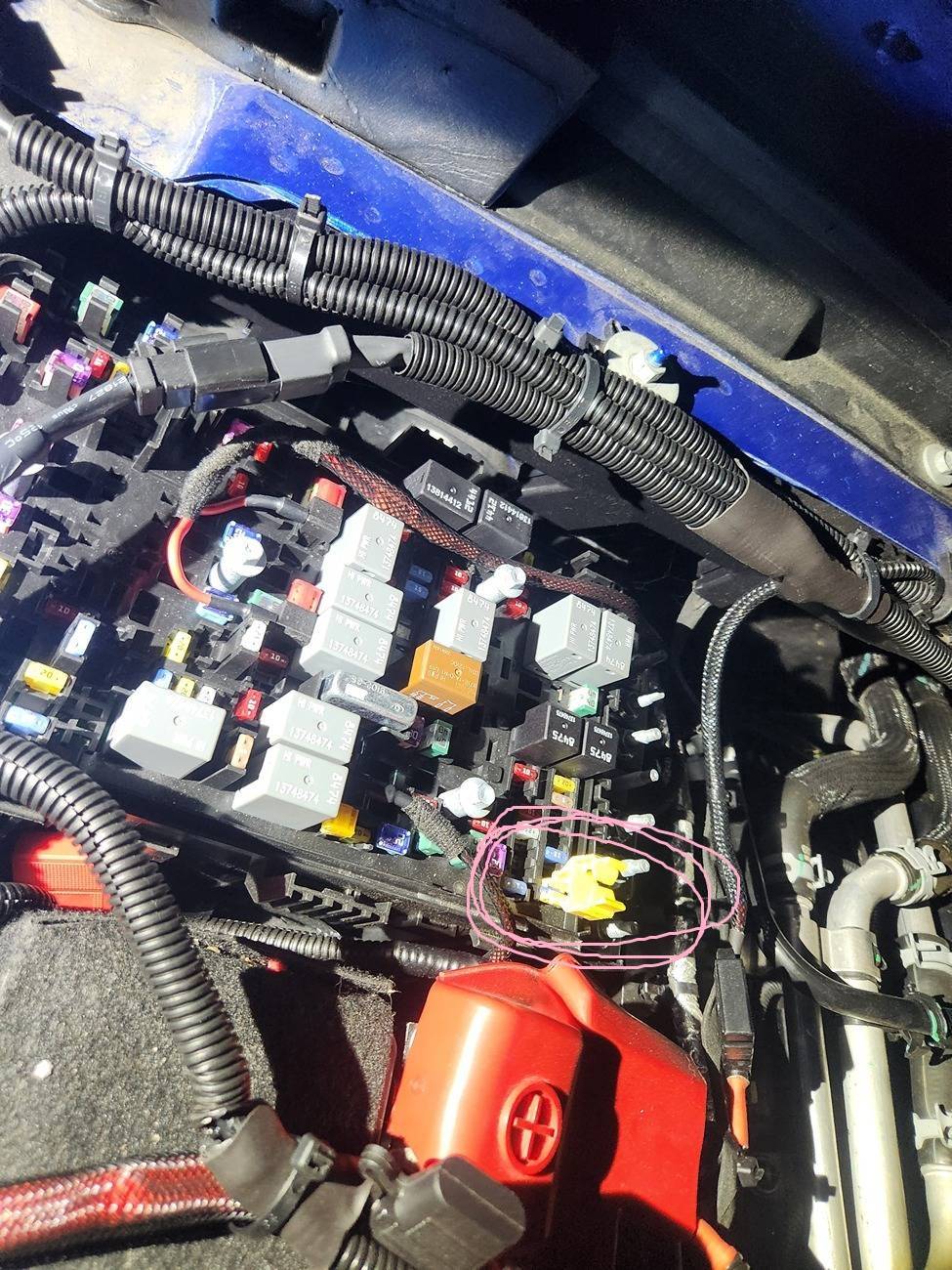

Ok I can’t find the thread so I could be wrong, but no harm in trying. Switch Fuse F10 with a known good spare. Unless you are actually testing the fuses, I have been fooled by bad fuses that look fine visually. If not, someone smarter than me will be along soon to correct me. 🤞

Fuse F10 supplies power to the ignition button/keyless entry(RF HUB). 15 AMP fuse, I have fuse puller on it in the photo
Replacing fuse F10 did the trick. Everything is back to normal. Thank you.
