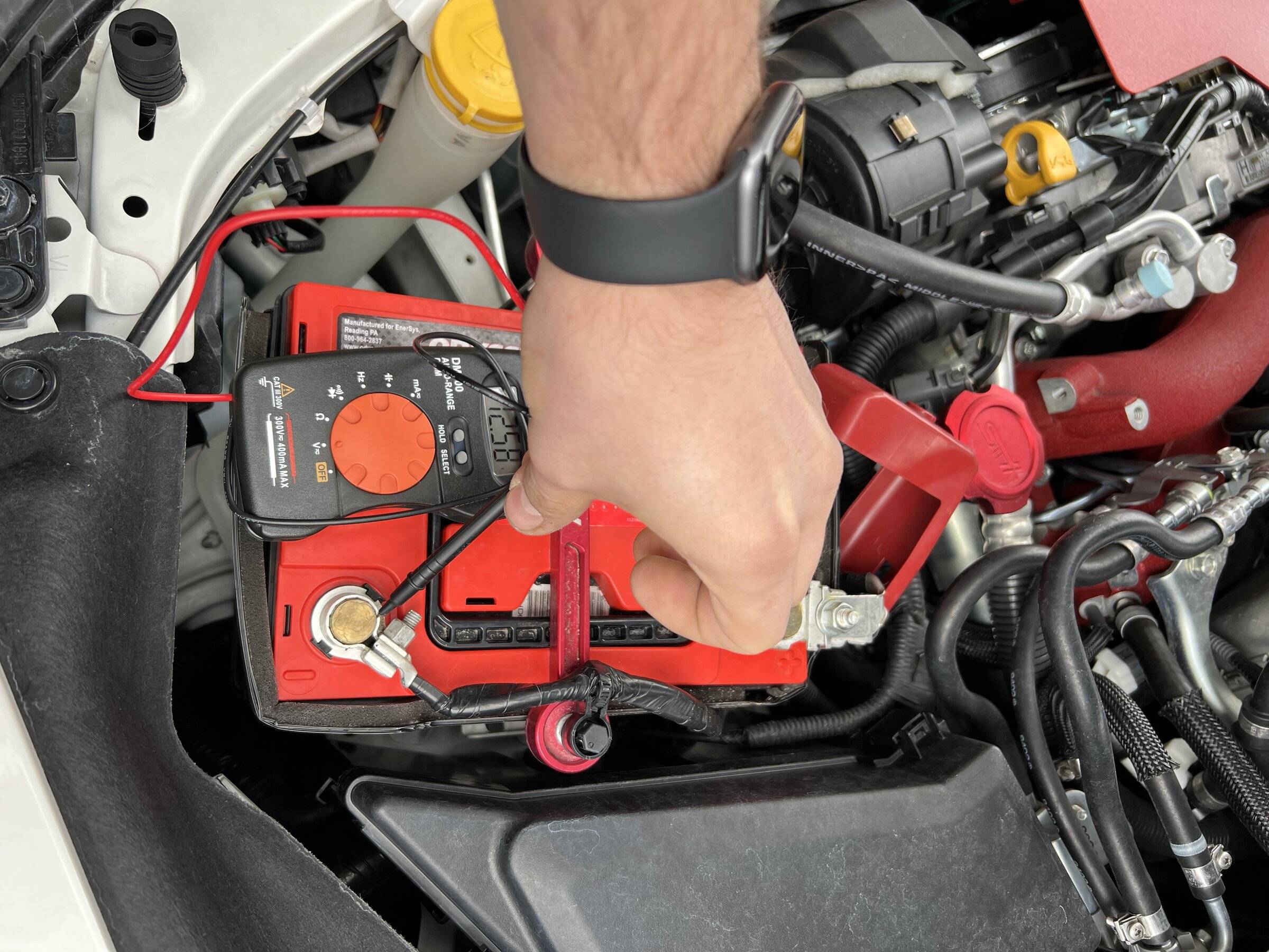

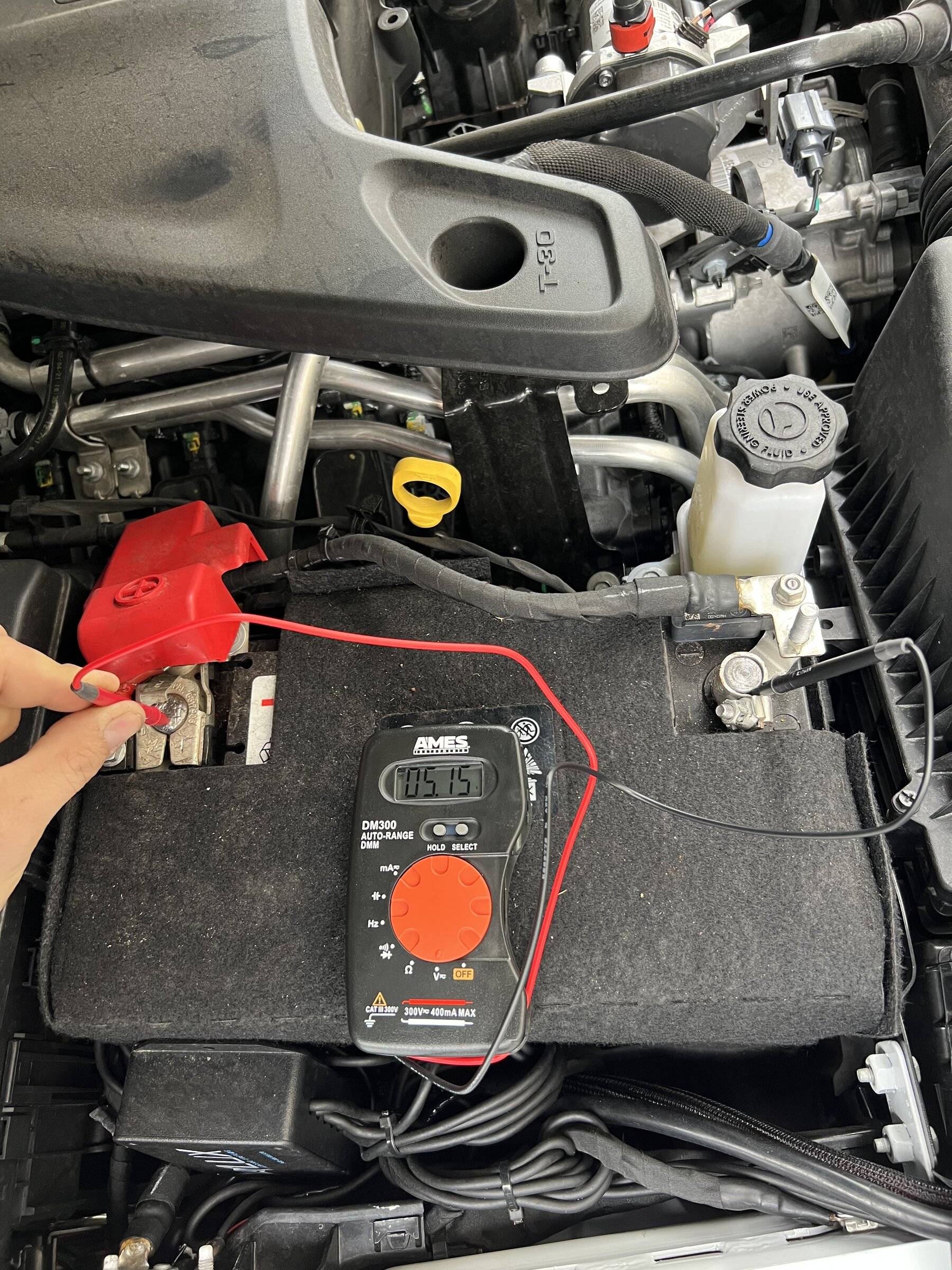

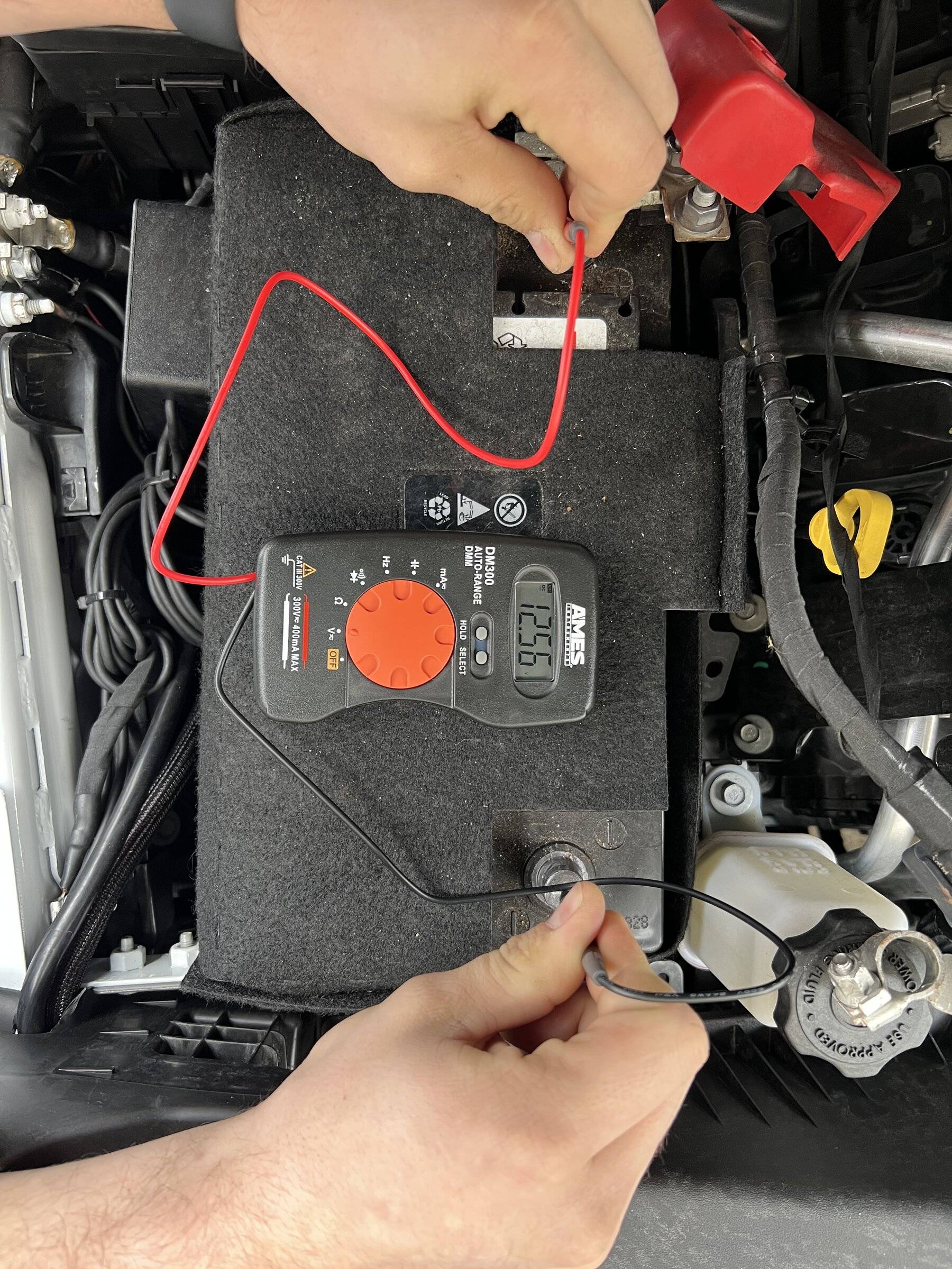

*Update
I tested the battery with the battery cable still attached. It was only reading 5.15 V. To confirm no error occurred, I hooked up the volt meter to a known good battery in a different vehicle and it tested at 12.58. I disconnected the battery cables from the Jeep and tested the battery again. It tested fine this time and had 12.56V.
Pictures included below :
*1st photo - Original Jeep battery test.
*2nd photo - Separate vehicle to confirm tester operation.
*3rd photo - Jeep with cables disconnected / testing battery.
