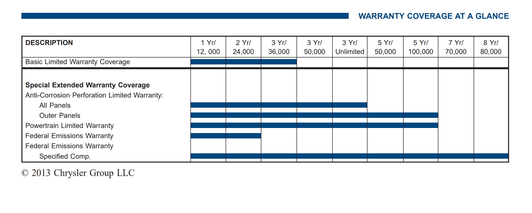

Interesting that the powertrain warranty went from 100k to 60k a few years after the 3.6 came out! This is comparing a 2017 and a 2014. The oil was changed late 2013 I believe.

Agree, if they usually do it with other motors, and they specifically do not do it with this motor that leads me to believe that they actually engineered this engine, and it works as designed on the recommended oil.
I am not in agreement with that given the rocker failures and the like, but your point is well stated.
