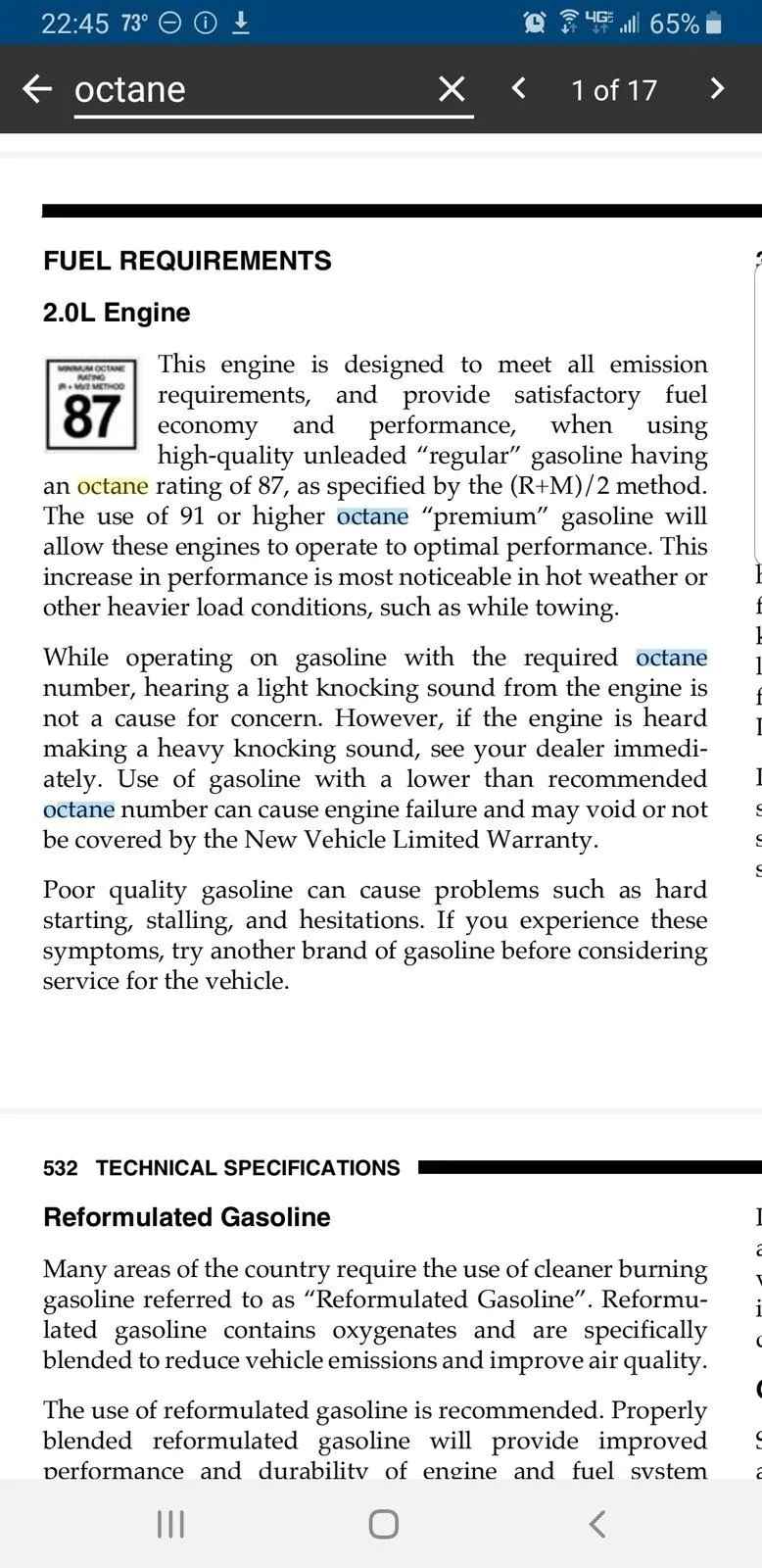

I have a 3.6L and when I'm in an area where 85 Octane is "Regular," I always go with the mid-grade 87. I hate to pay more than the regular costs, but I'm careful not to run less than 87 Octane.
You've probably seen this in the Owner's Manual, but just in case you haven't:
"Use of gasoline with an octane number lower than 87 can cause engine failure and may void or not be covered by the New Vehicle Limited Warranty."
