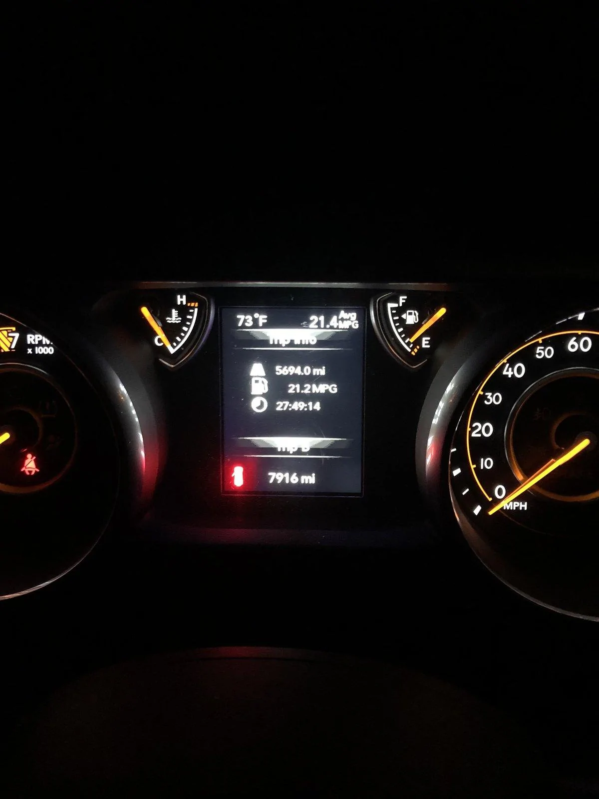

Yes, you are absolutely right. I can’t believe for a second that anyone is getting 22mpg in a wrangler, unless they are driving 45mph, down hill in neutral. But at some point, you have to go back uphill.
Jeep Wrangler JL 6 Speed Manual performance difference? IMG_0166

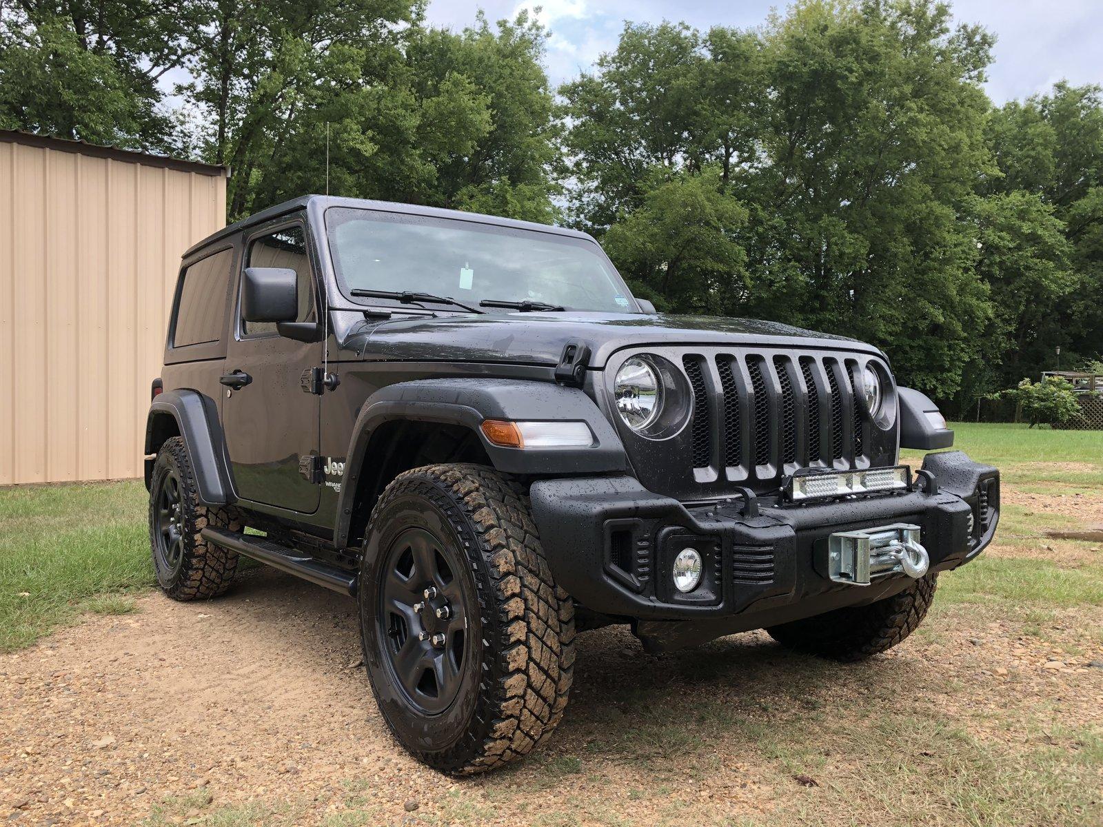

Okay its closer to 21 and this is my setup.
Like the tires, what kind are they?
(PS, I'm scraping up to 16.X MPG....think MPG is mainly related to the right foot. I drive 80ish on the highway.)
Cooper ST Maxx
