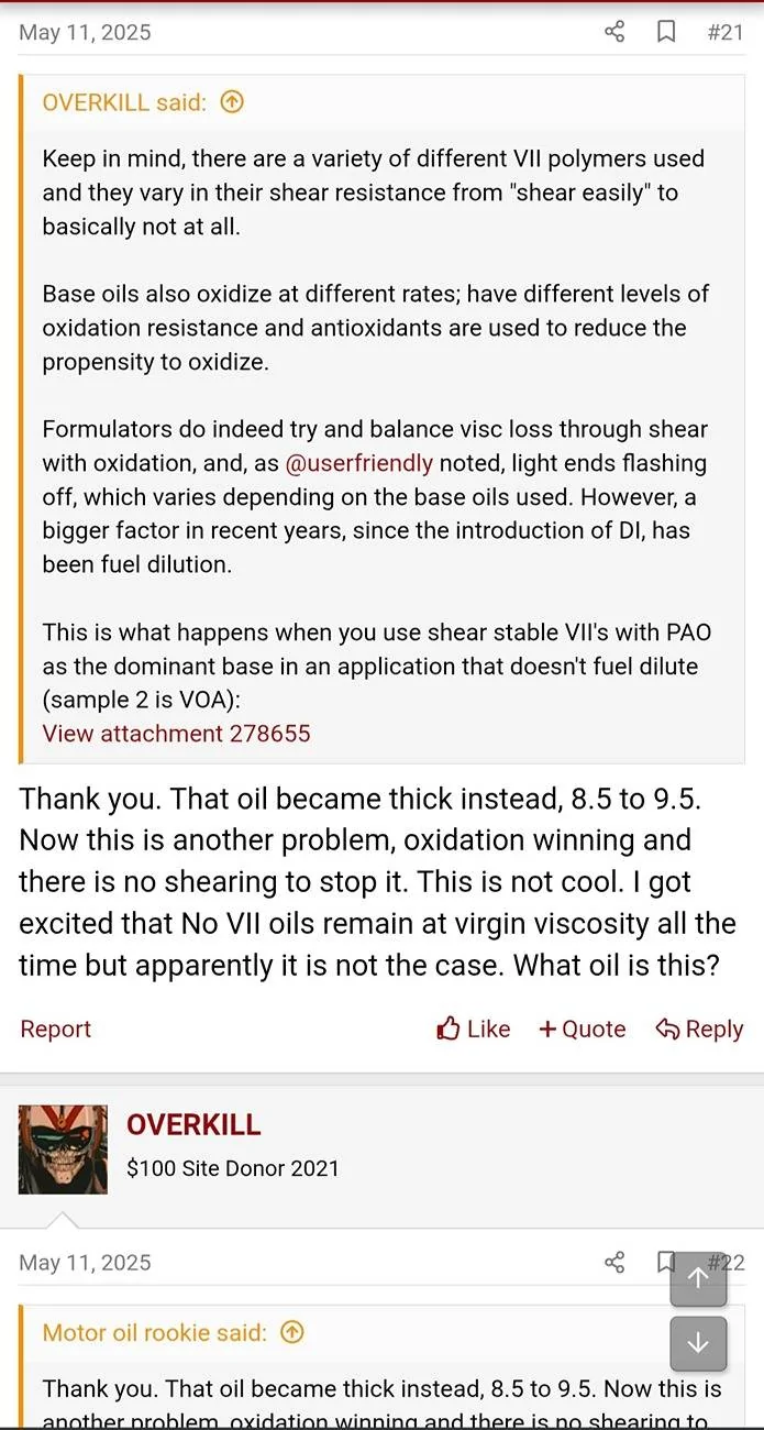

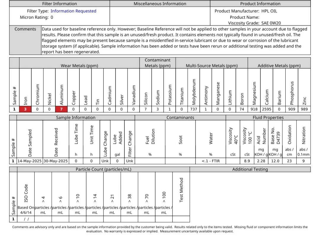

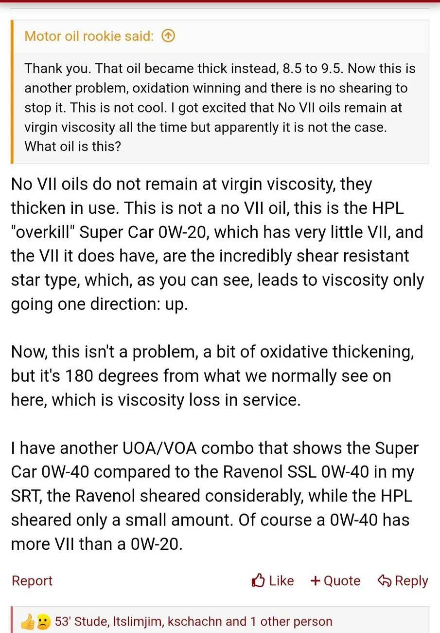

I did a VOA and this is how it looks, already so thick for a 0w20. So it will creep up after use
Jeep Wrangler JL 5W 30 versus 0W 20 Screenshot_20250629_161658_MobiPDF
