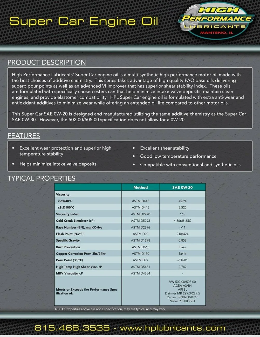

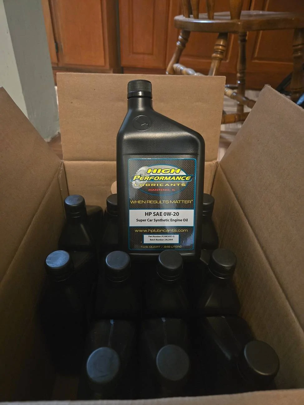

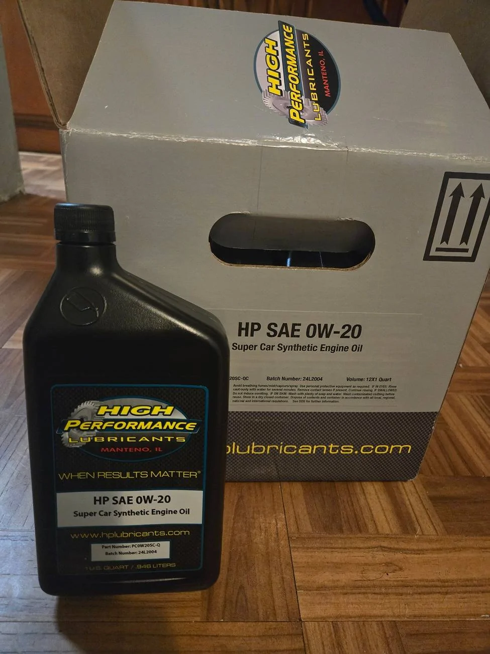

Don't yell at me but I bought a 12 quart case. I am just nervous about using it. It starts at 8.9, not sure where it will end after 5000 miles 🫣
It has a pour point of -81 degrees F 🤯That's pure PAO for sure
