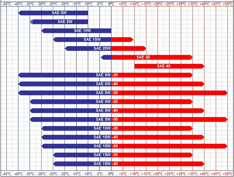

I’m moving to Anchorage, Alaska this summer so next winter I’ll have to deal with some real cold. Should I stick with 0w20 or step up to something heavier?
I don't know, ask people who live in colder climates. I live in the tropics of Houston. Research what the temp ratings of other weight oils are.
CarbonSteel
Jul 21, 2019
305
5,795
8,237
The number to the left of the "W" indicates its winter performance since the "W" stands for Winter and not Weight as typically misunderstood/misstated.
Before I sold my Wrangler, I ran 0W-30 year round in Colorado where we see negative double digits a number of times in the winter.
In reality, all oils are too thick at start up no matter what viscosity they are, but the Winter rating indicates how cold the temperatures can be and the oil still function properly.
It can depend on the brand and formulation, but most 5W-xx oils are good down to -30 to -35°F and likewise 0W-xx oils are good down to -40 to -45°F.

I was looking at a similar chart the other day and came to the conclusion that 0w40 was the best to cover 99% of the temperature swing up here, only problem it is only available in euro spec that is no where to be see in the owner manual
