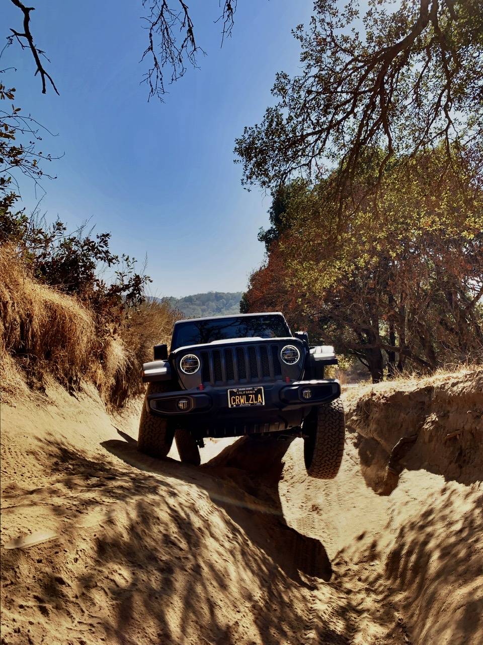

A person on youtube shows his jeep with 35's on stock rims with stock height. He shows at what point it would rub which would be above what most people would put their jeep through. To make it clear, the percent of most people is smaller in a forum like this ;-)
so this might rub?
I’ll have find that video - are spacers an option for a little more clearance or frowned upon?
