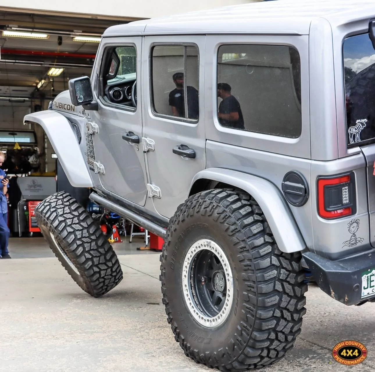

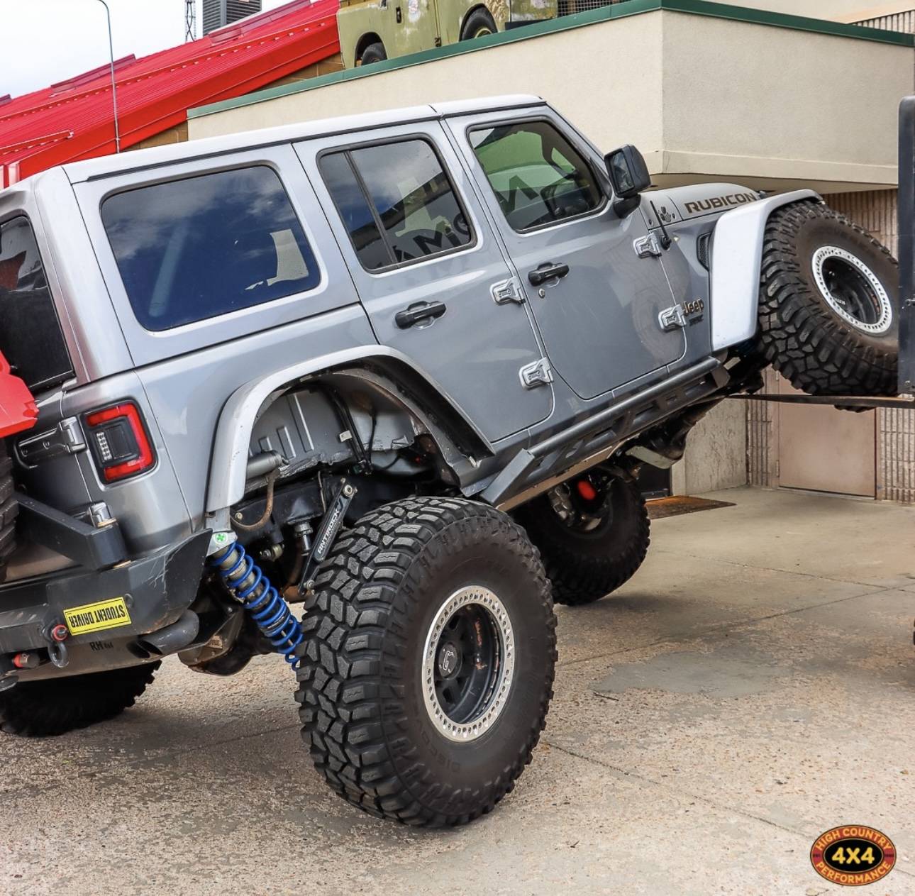

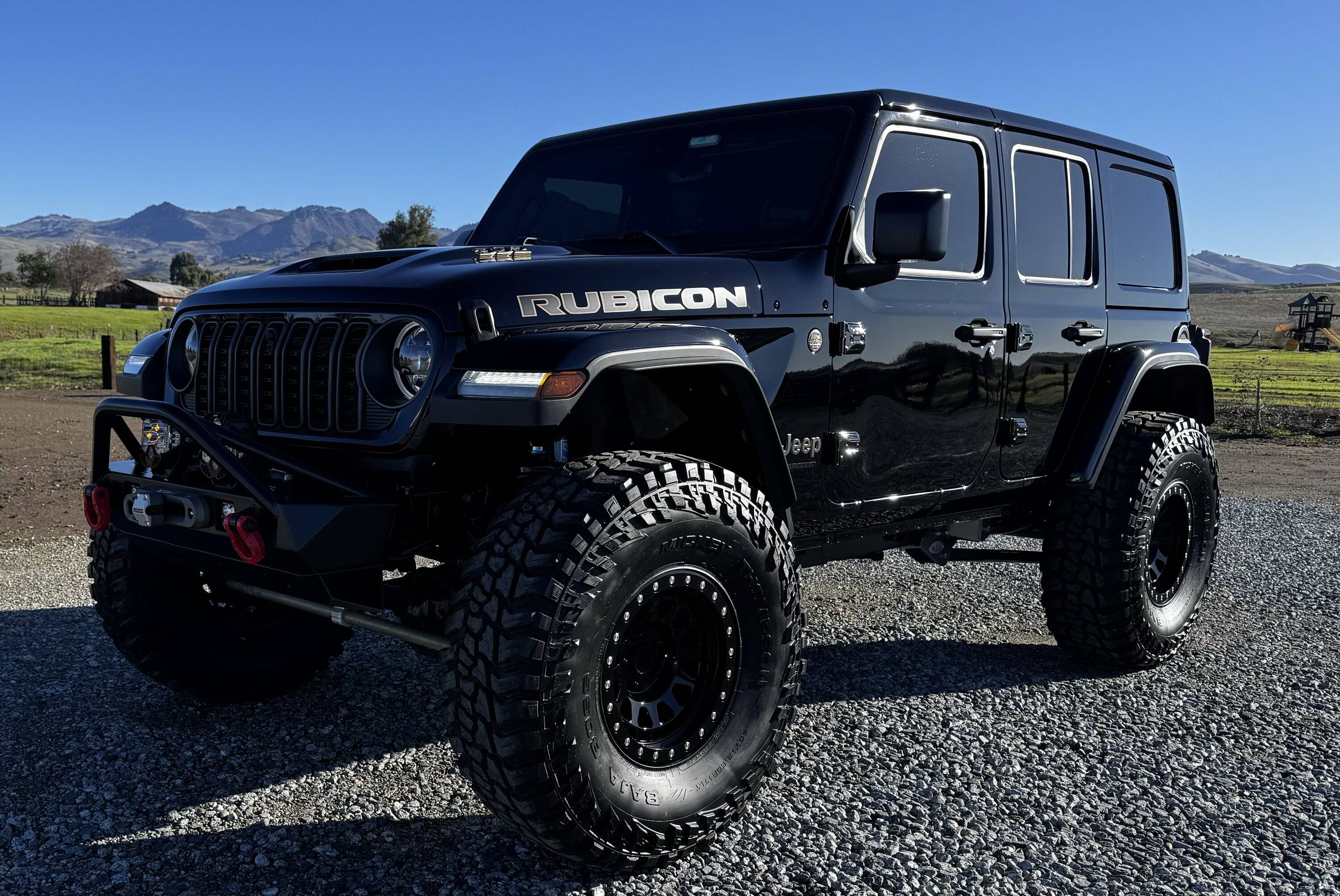

Nope, but I did have the frame notched so I could clear the front shocks.
Jeep Wrangler JL 40's on 392? IMG_0867
Jeep Wrangler JL 40's on 392? IMG_0869
Jeep Wrangler JL 40's on 392? IMG_0870
Jeep Wrangler JL 40's on 392? IMG_0868
1996cc
Aug 19, 2019
901
1,177
Oregon
22 JLUR 392

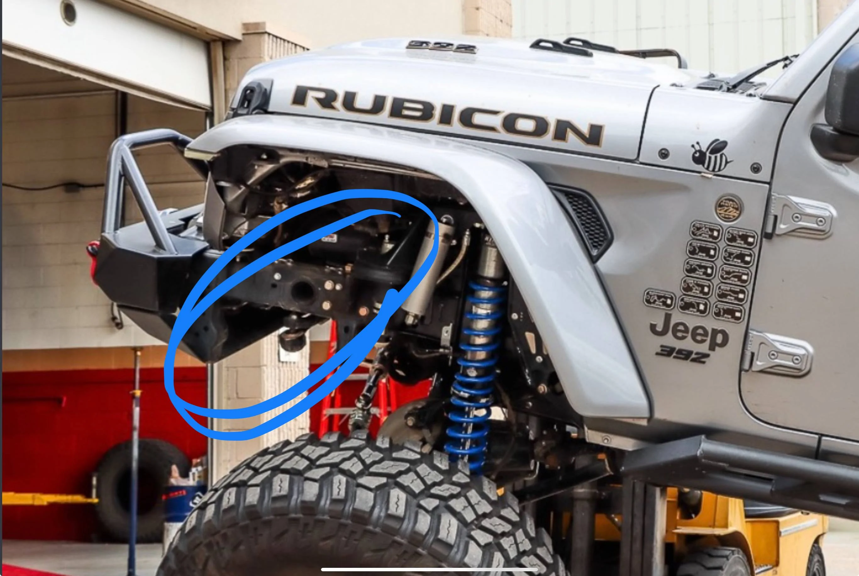

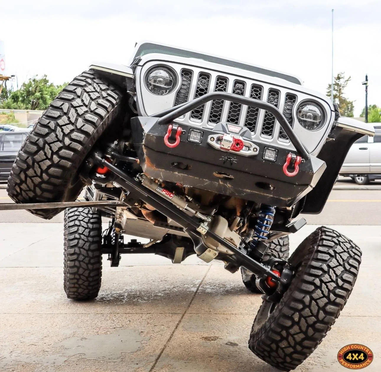

Looks great. I’m surprised you just didn’t move the lower shock mount out versus notching the frame?
And what’s going on with the drag link here, looks like it’s about to fall out?

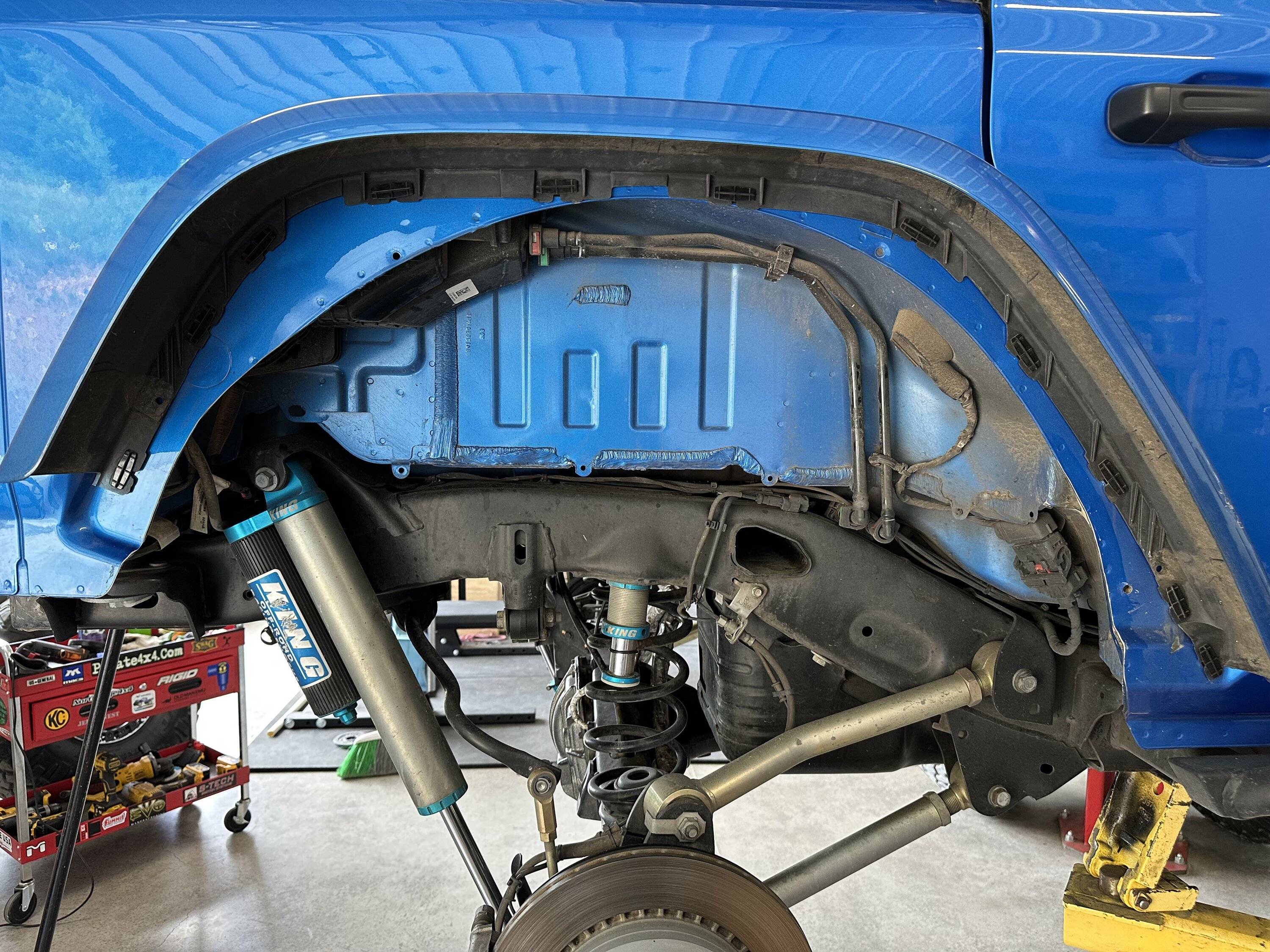

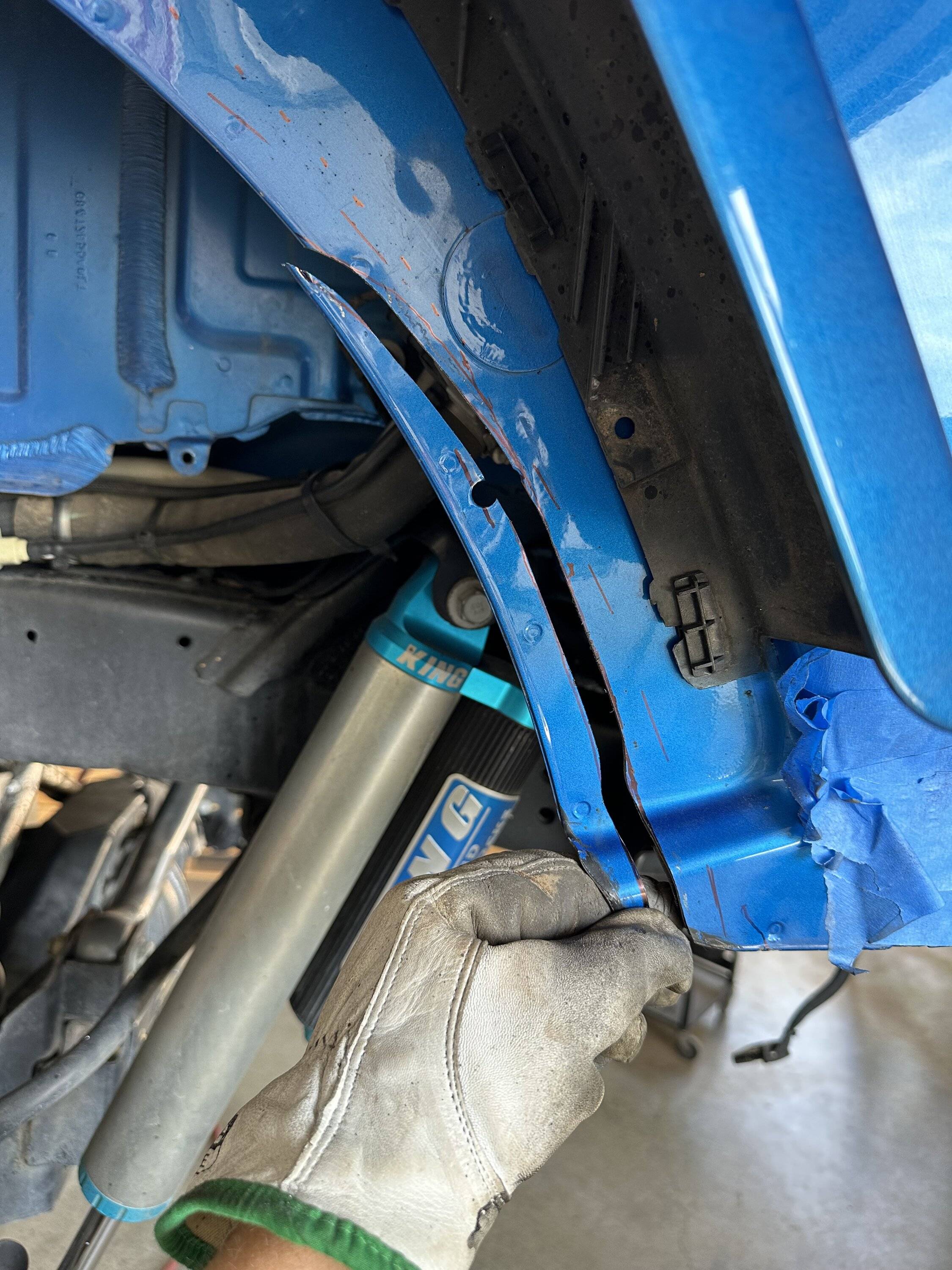

Yes, I had to trim about an inch behind the rear tires, and a little in front of the rear. I only rubbed during faster obstacles and places like the sand dunes.

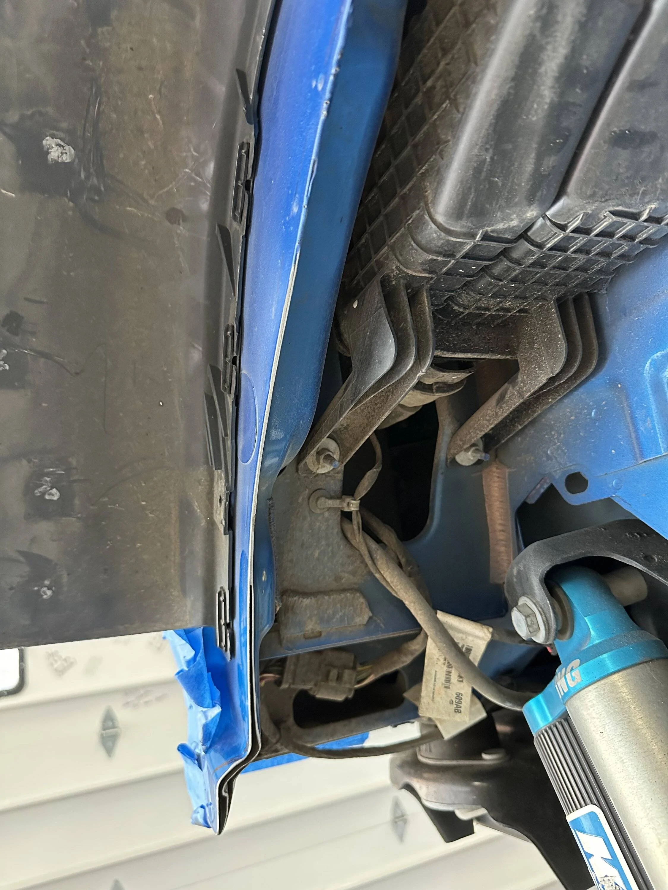

This is all I trimmed on the front just the passenger side.
Jeep Wrangler JL 40's on 392? IMG_5935
Jeep Wrangler JL 40's on 392? IMG_5925

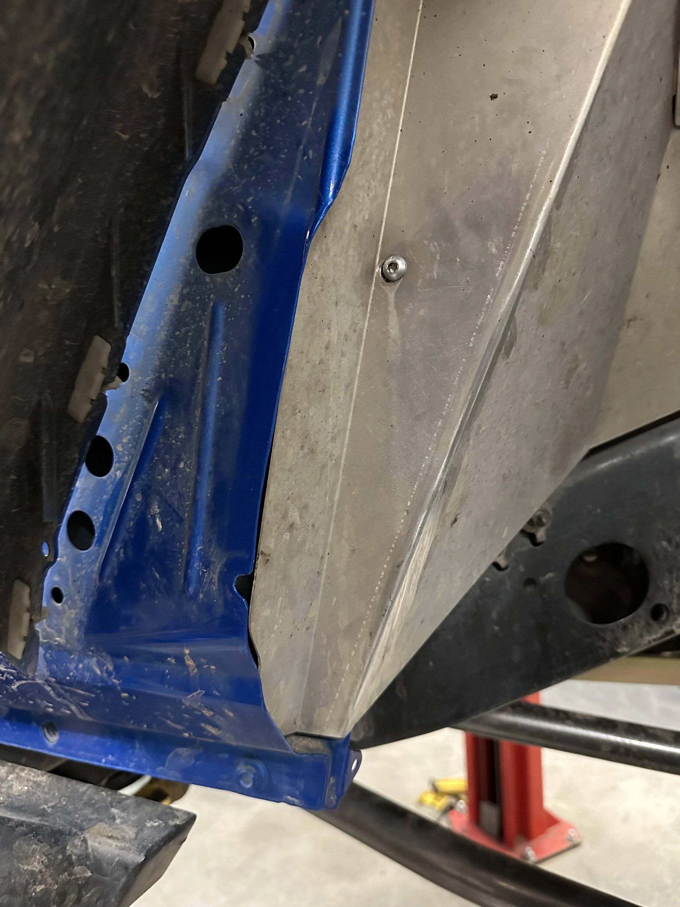

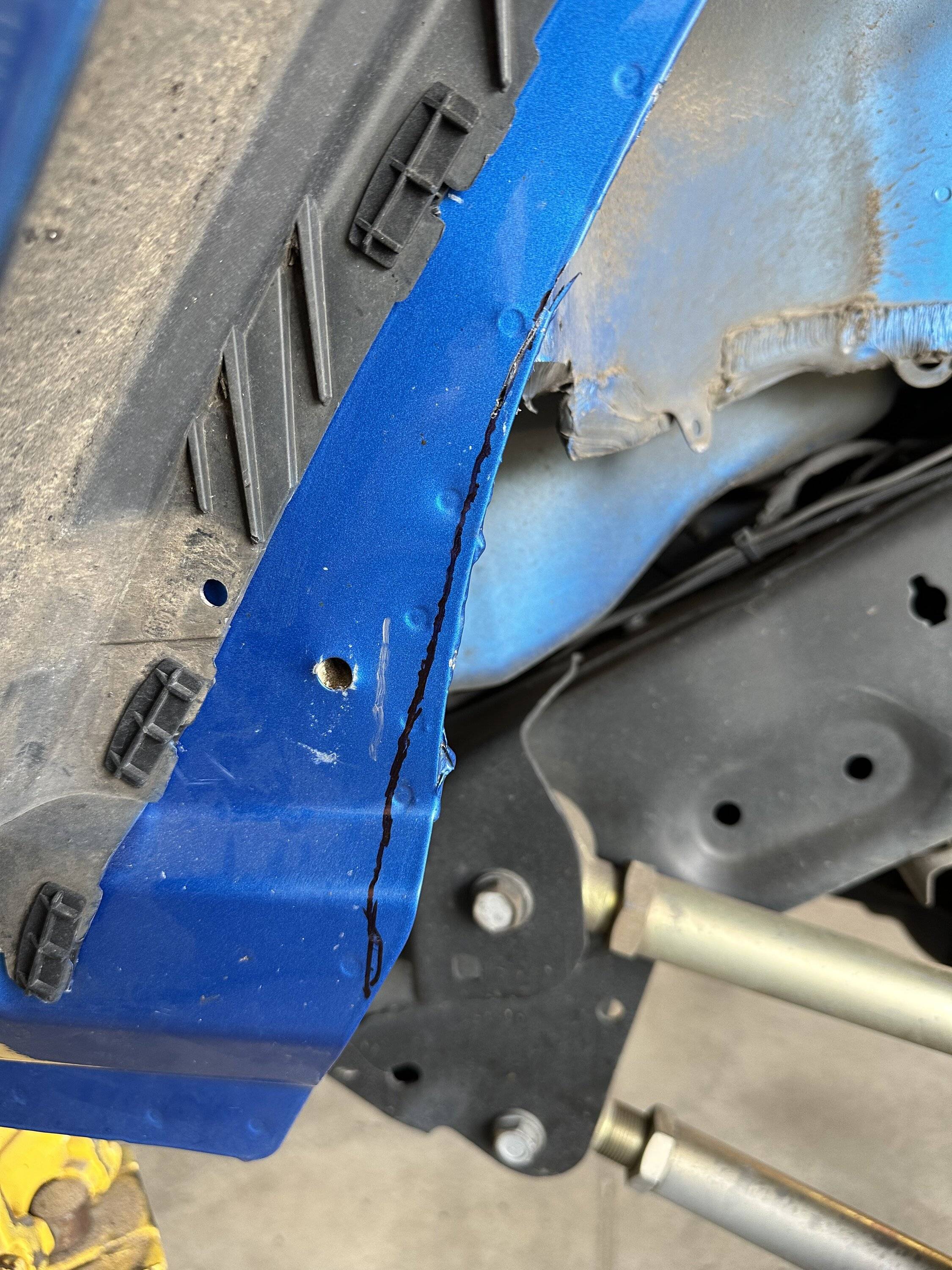

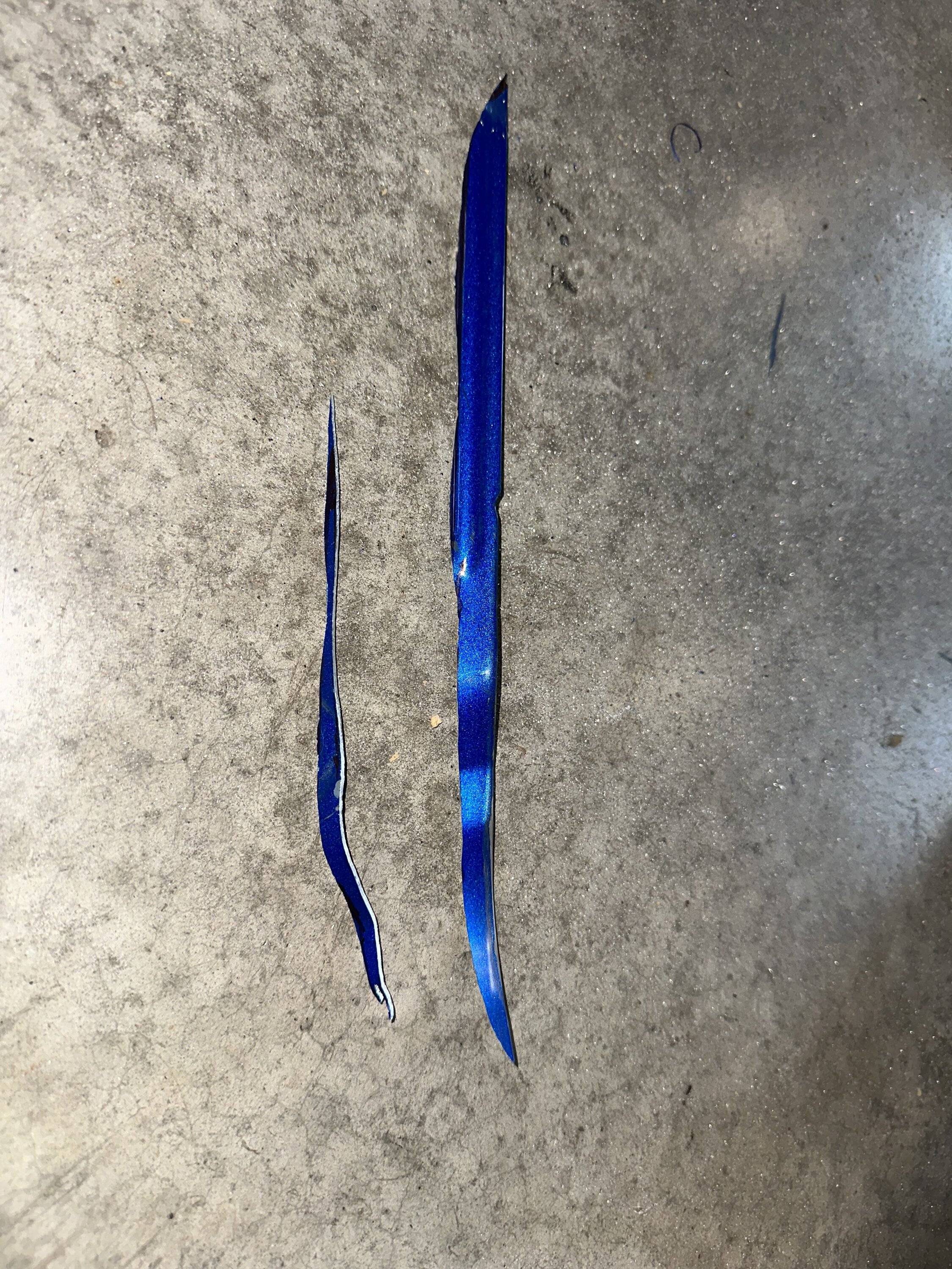

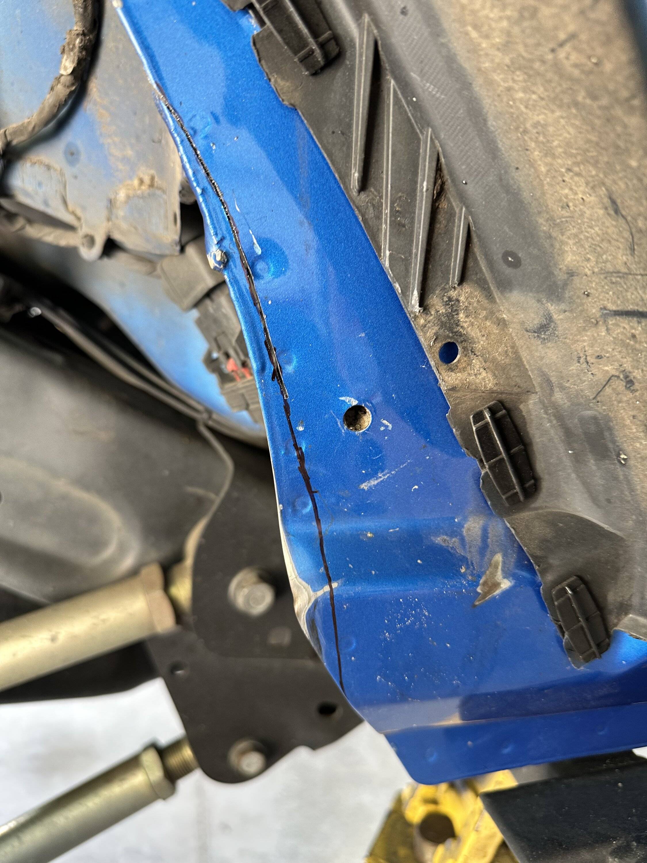

This is what I did on the rear-
Jeep Wrangler JL 40's on 392? IMG_3886
Jeep Wrangler JL 40's on 392? IMG_3887
Jeep Wrangler JL 40's on 392? IMG_3889
Jeep Wrangler JL 40's on 392? IMG_3891
Jeep Wrangler JL 40's on 392? IMG_3898
ShockerRacing
James
Aug 1, 2018
268
672
Chicago, IL
www.youtube.com
2022 Mojito! Wrangler 392, 2020 Neon Gladiator

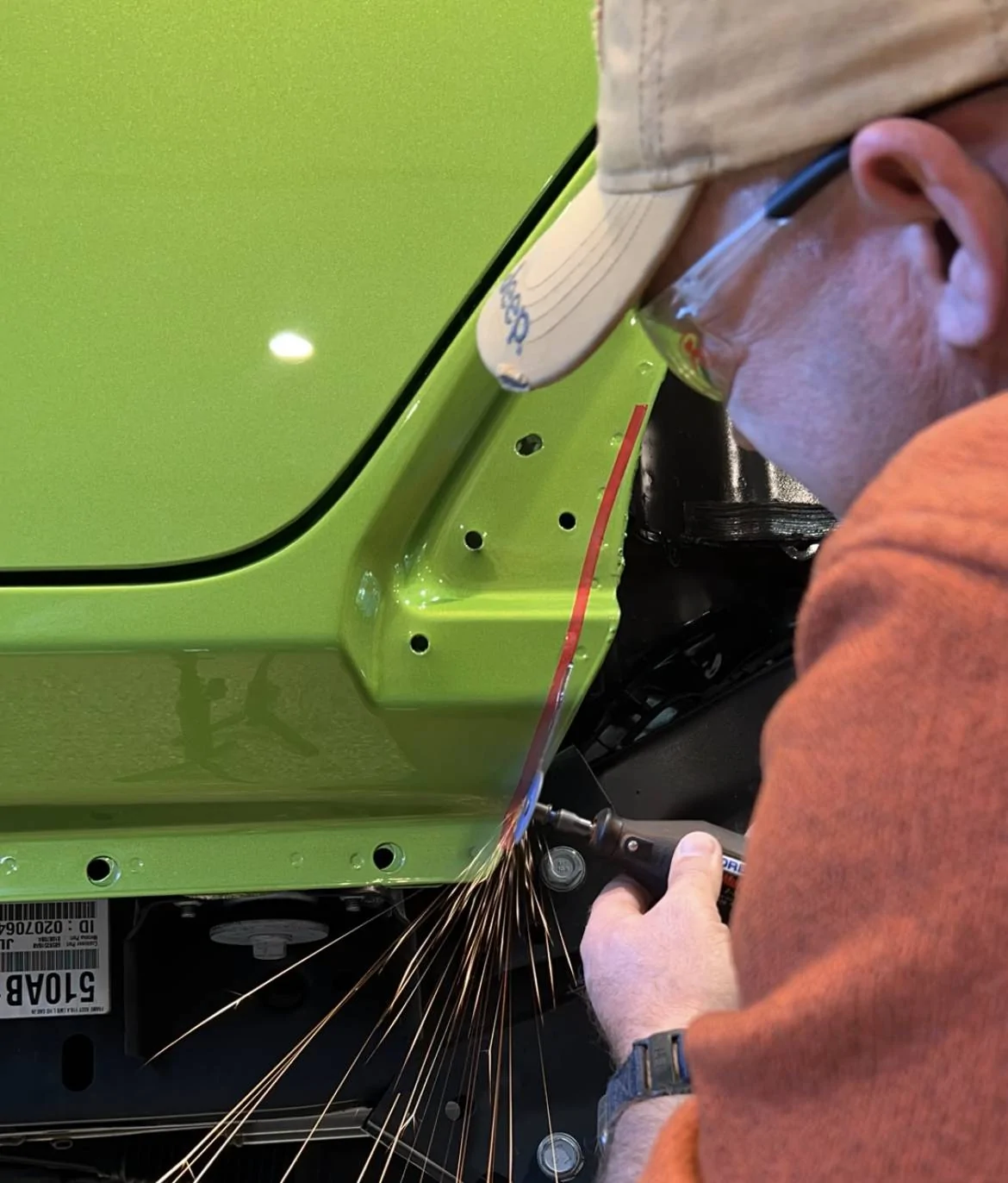

Thank you! Did you happen to do a video of the trimming process? How you determined the amount to take off, flexing, etc? I know you are pretty good at that! :)
So Scott Blum gave me some pointers to go off of, but in my case the tires had already left rubber on the metal so I had an idea of what needed to be cut. I’ll share a short so you can see the arc I used for the cut. You can see the red line in the video, and that’s what we followed. On the passenger side I still need to take a little more off. I also used a little seem sealer on the edge when I was done cutting and painted the edge with some Mojito spray paint:
Heres a screenshot showing the line of what I cut off on the front side of the rear tires.
Jeep Wrangler JL 40's on 392? IMG_1880
I didn’t have to do any cutting up front other than to remove the crash bar on the passenger side.
This was a 6-figure build I did a bunch of things to clear the 40’s… but only mentioned what was cut away. For the front shocks, I changed my spring rates, added AGM sliders, notched the frame and moved the lower shock mounts. I also needed to replace a few boots and install an HD Antirock in the front… but I tacked those at home.
Philip
Philip
Aug 31, 2020
94
99
Aurora, Co
2021 JLUR 392 x2
IT Strategy Consultant
Oh, I should also mention that I’m running Cooper Stt Pros, which run a little under 40”. My shocks and bumps are also adjustable so your results may vary
