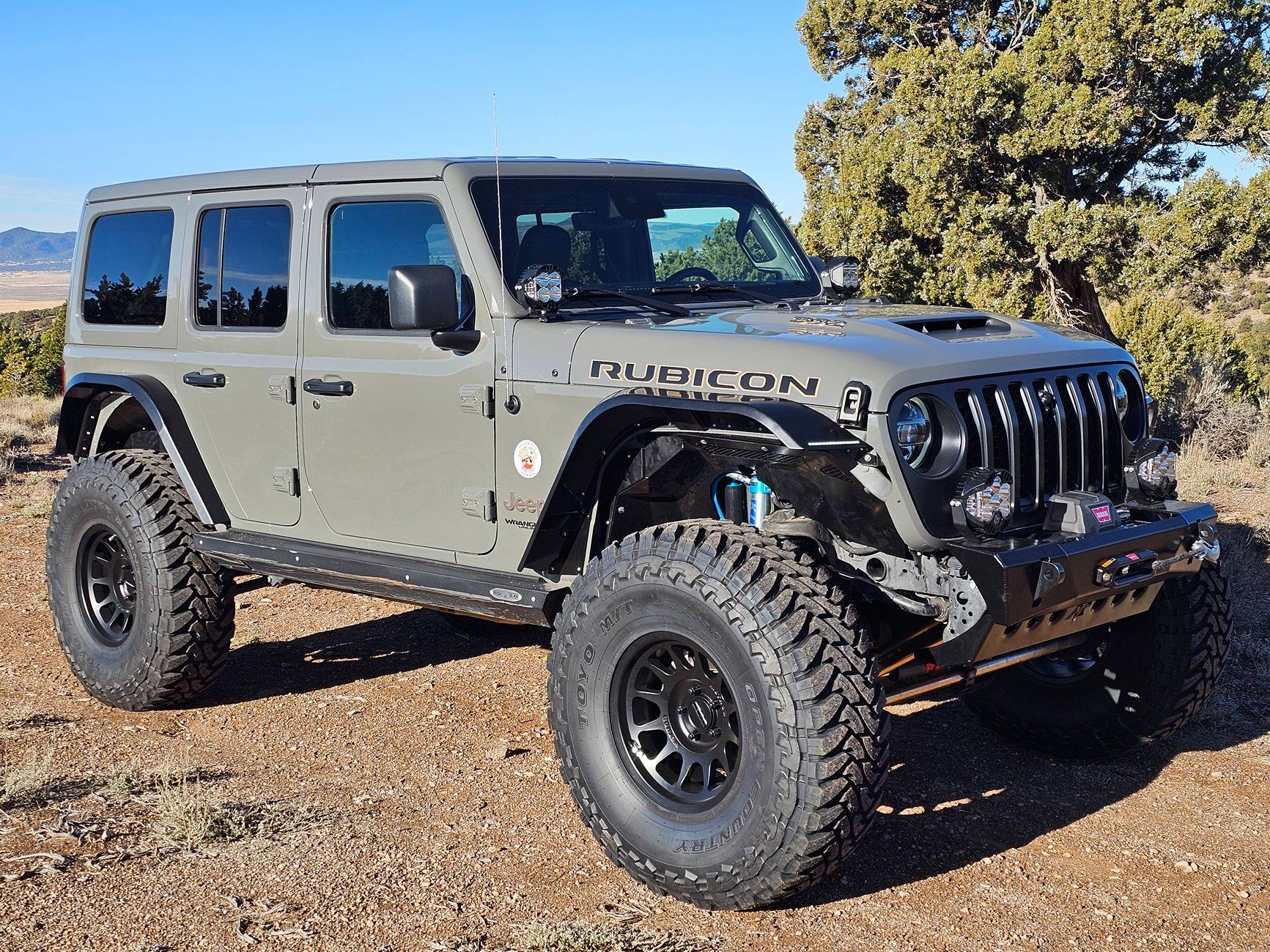

I think it is more how the Jeep is driven. Some people are throttle Jocky's, and some people aren't.
Some people could break an anvil.
On my last trip to Moab two weeks ago I had a built Gladiator with tons and 37s following me for the better part of the day. He asked me what I was doing to drive my 392, because from what he could see from right behind me I never appeared to give it the gas or even use the brakes. When I drive my 392 on challenging trails, NOT buggy trails, (there is a difference) I rarely have to give it very much throttle at all. It has so much torque even at idle that it will idle over most anything. If I want to go faster, I upshift with the paddle shifter. If I want to go slower, I downshift with the paddle shifter.
And there is so much talk in this thread about everything that needs to be done to run 40s on a 392, or any Jeep for that matter. I think people are forgetting that for most of us a Jeep is a work in progress. It is never finished, at least mine never are, up until they are put up for sale that is. The eventual plan is UD 60s and an Atlas II transfer case. I'll get there someday. In the meantime, I'll do trails I enjoy, like Rubicon and Moab. I just picked out trails I'm going to try to get for this year's Easter Jeep Safari. I have picked one 5, four 7s, an 8, and a 9.
I have driven Jeeps for 50 years, and all Jeeps definitely do not drive the same, or respond the same to larger tires. I test drove a JK on 40s that I was thinking of buying a few years back, and it was HORRIBLE! It felt so vague and floaty that it was scary. In contrast, my first impressions after going from a 2 1/2" Metalcloak lift and 37s to a 4 1/2" Metalcloak lift and 40s on my 392 was being surprised about how really good it drove. The tires were balanced perfectly, there is no driveline vibration up to the 80-mph speed limit. It tracks straight, doesn't wander, or pull to one side. It actually corners flatter than it did with the shorter lift and 37s. It is really pleasant to drive to work and back and on the several long trips to Moab I take each year. I think part of that is set up. I went to a CAT scale and got an axle weight for each axle on my Jeep, a total weight, and weighed a tire and wheel and sent the information to Accutune to build the King shocks I am using this time around. They did a much better job than they did with the Fox DSC shocks I had them do with the shorter lift. The Dynatrac ball joints and Metalcloak tie rod, drag link, sector shaft brace, and track bar brace also help. I am also using Metalcloak geometry correction brackets on the front suspension. An Apex power steering boost kit and cooler help with the steering. I have no complaints at all with the way it drives.

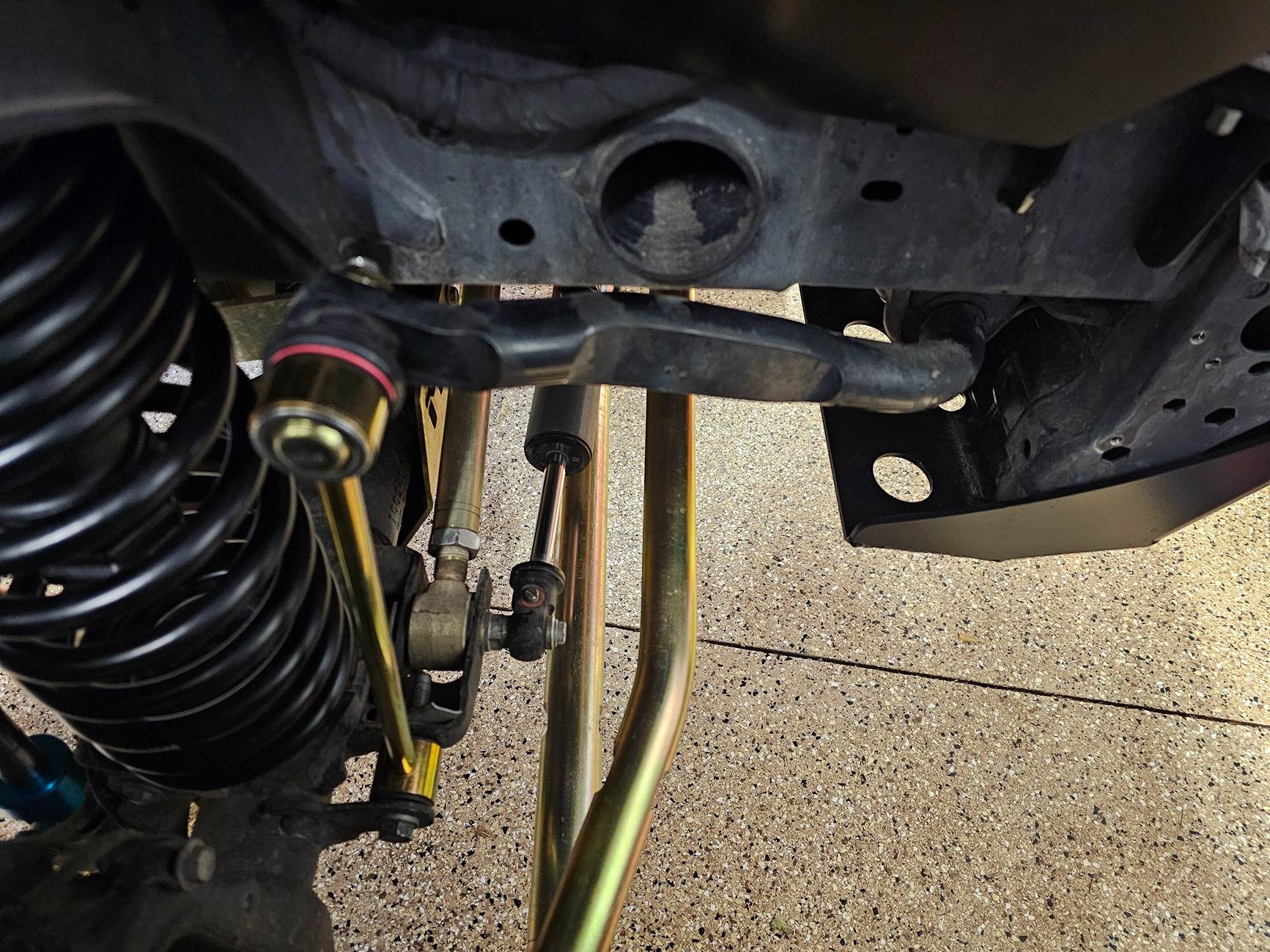

Do you mind getting me couple of pictures of the Fox ATS mounted on the tie rod when the wheels turned all the way to driver side? I'm still running stock tie rod and drag link, after relocating the Fox ATS I noticed rubbing and it's really tight. Bought the MetalCloak stabilizer relocation bracket, but I'm afraid there's an angle causing binding when the wheels locked on the driver side. When the front wheels are straight, the SS is almost level, even better when wheels locked to the passenger side since the tie rod goes a bit higher.

Sorry it took me a while Fast Man.
Here are pictures of the relocation bracket from Synergy, and how close it comes to the Next Venture differential cover and differential skid plate.

Thanks a lot! Happy new year!
