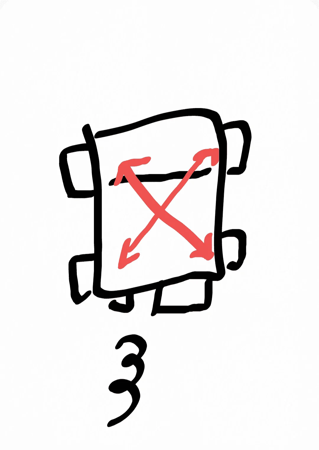

I just got mine rotated at 5k miles and decided to rotate in the spare in this pattern after reading up about it on the forums. The shop wanted to rotate them a different way but from what I read this is the best way for rear & 4wheel drive vehicles:

Man, I wish I did 5 tire rotation. I have way too much wear to do that now. Lessons learned.

I like a 5 tire rotation where one of the back tires goes onto the spare, and the spare goes to a front. Main reason I like this is the front tires are more likely to be cupped and I don't want an ugly cupped tire on the spare.

I find that switching sides and changing the direction helps with the cupping. This is basically what I do and I just eyeball which tire is the worst and swap it with the spare.
