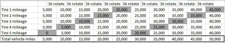

You'll get 25% more miles before needing new tires with a 5-tire rotation (though you'll need 5 tires vs 4), and here's why:
Let's use round, easy numbers. Say your tires are good for 40,000 miles and you do a 5-wheel rotation every 5,000 miles. You will end up doing 9 rotations before the original 4 on the ground (as well as the spare) hit 40k miles, and since all 5 tires will be in the spare position twice, the total miles the vehicle will travel is now 50,000.
Jeep Wrangler JL 4 or 5 tire rotation???? mileag
Grey block indicates which one was the spare for that 5,000 mile period.
40,000 + 25% = 50,000
