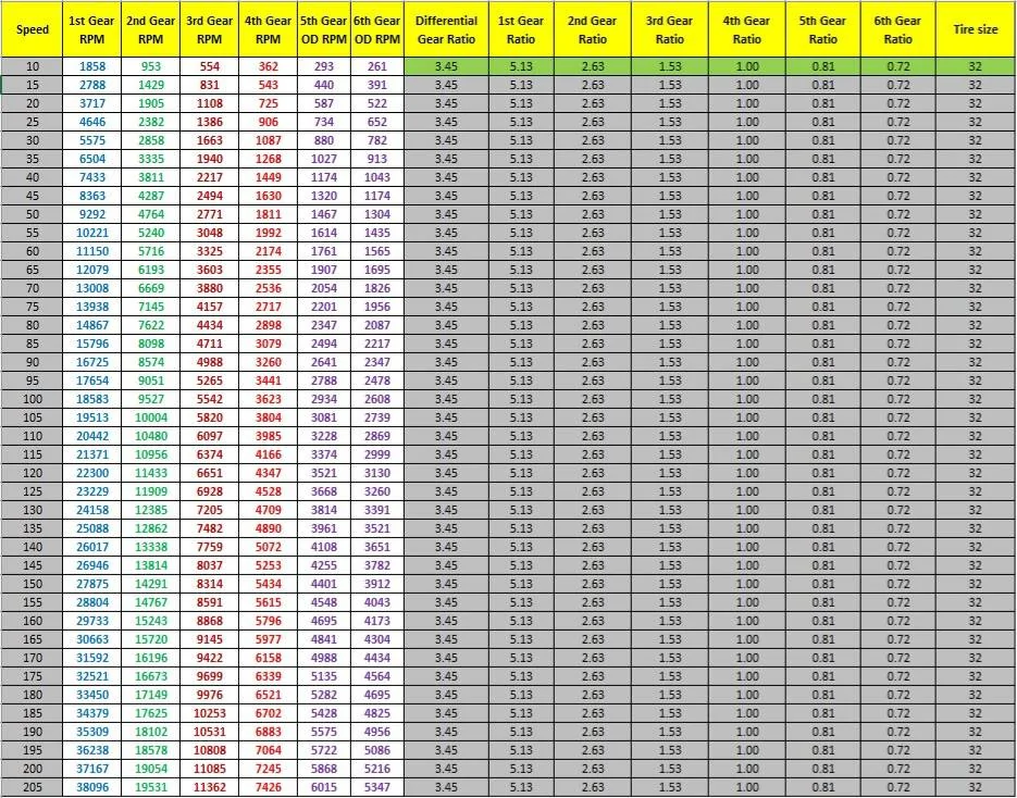

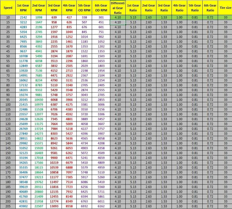

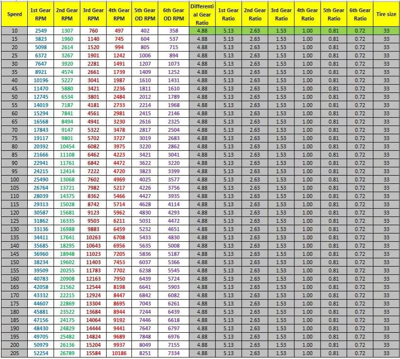

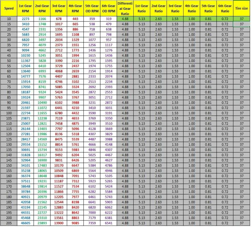

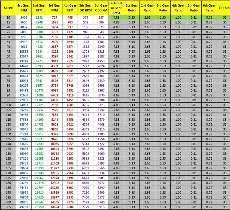

Here is a few rpm and tire charts I posted somewhere on this forum
Jeep Wrangler JL 4.88 manual? Jeep JL-RPM-3_45-32
Jeep Wrangler JL 4.88 manual? Jeep JL-RPM-4_10-33
Jeep Wrangler JL 4.88 manual? Jeep JL-RPM-4_88-33
Jeep Wrangler JL 4.88 manual? Jeep JL-RPM-4_88-35
Jeep Wrangler JL 4.88 manual? Jeep JL-RPM-4_88-37
