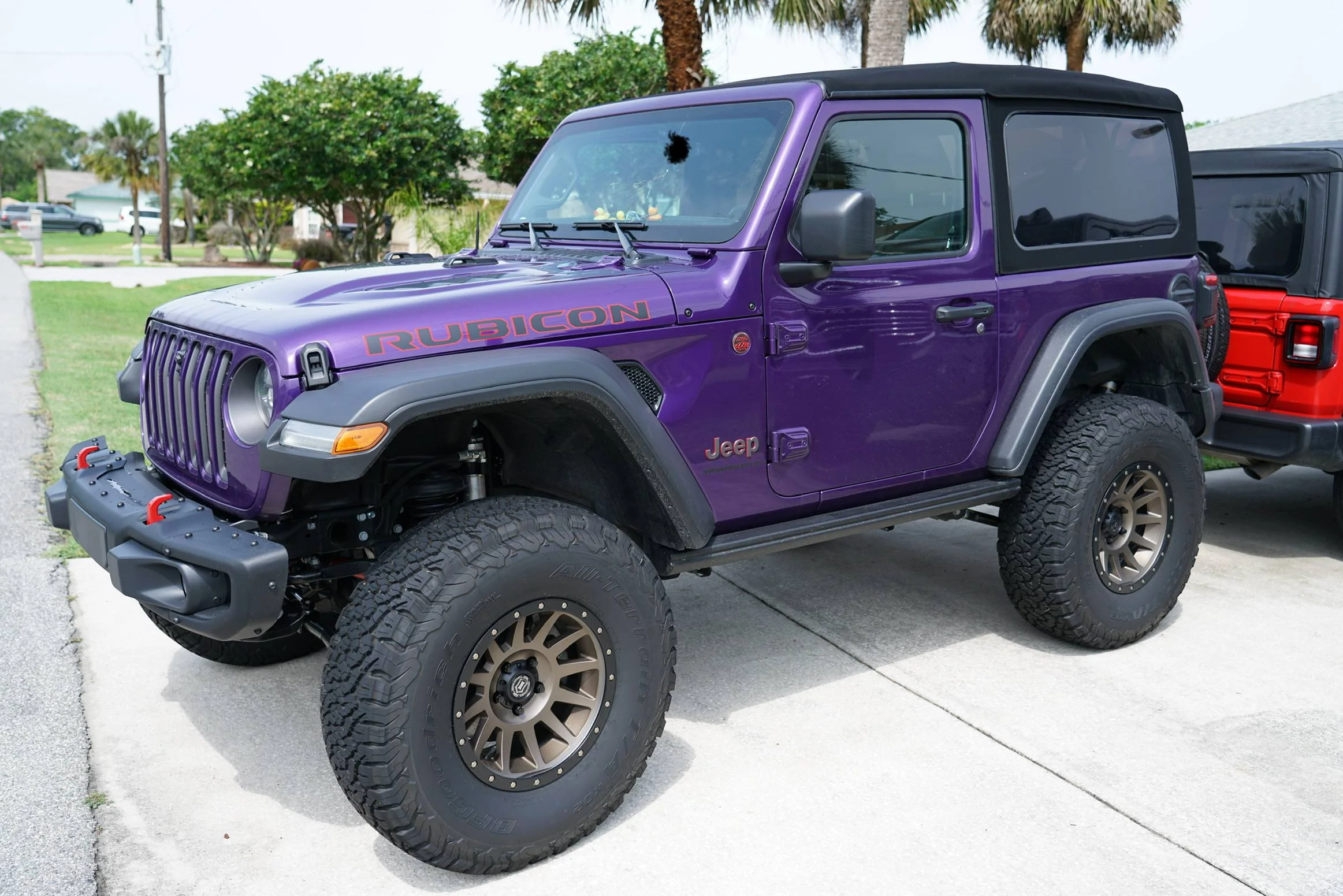

I am running am factory 4.88s on 37s with 2.5” lift. Seems like a great combination and would recommend… However, it doesn’t drive as as well under windy conditions at interstate speeds. Other then that, it’s great.
Jeep Wrangler JL Manual 2dr  4.88 question IMG_5595
May as well throw a picture into the mix.

I am running am factory 4.88s on 37s with 2.5” lift. ...However, it doesn’t drive as as well under windy conditions at interstate speeds. Other then that, it’s great.
If only there were a gear ratio that improved handling in windy conditions at highway speeds. You sure as can bet Jeep is designing a software update for this on the 4 door. :)
Awesome pic btw.
Awesome pic btw.
I know you're trying to be funny. But there's a very noticeable difference going from stock to a lifted Jeep on 37s in high winds on the interstate... I don't think I would do it again for a daily driver. However, the gears really do help going uphill with 37s. Headwind or not, I rarely have to come out of 6th to maintain speed going over tall bridges (we don't have many hills in Florida).
No doubt that the lift and the 37s increase instability on windy roads at speed. Big brick turned into giant brick.
