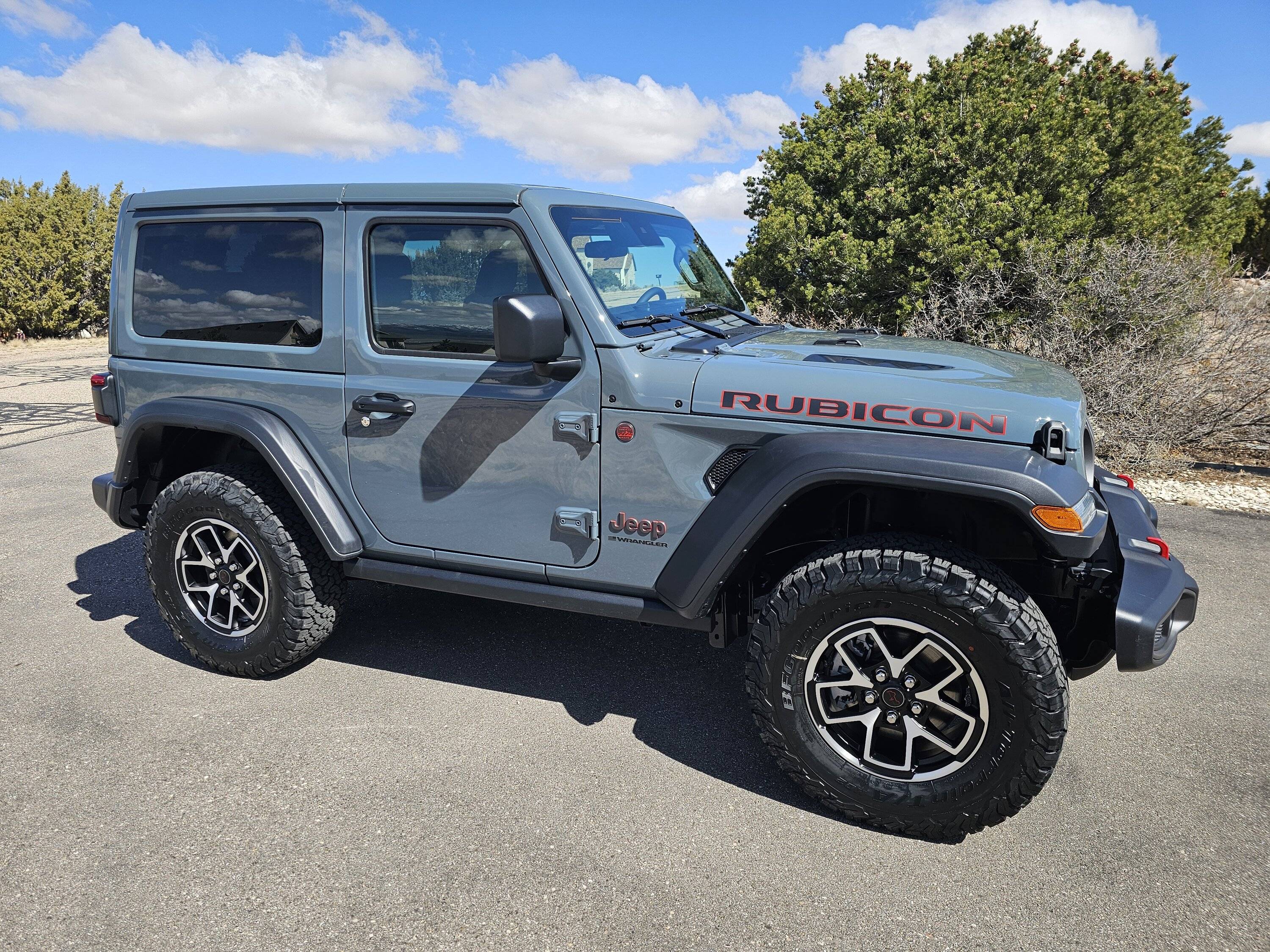

Hi everyone. I've been Jeeping most of my life but have never created a build thread. This time I wanted to capture the improvements I plan to make over the years.
I bought this Jeep to be a towed vehicle behind an RV. I want to spend more time seeing the country with our 3500 Ram dually with Arctic Fox 992, and Jeep in tow. The Jeep will likely be trailered some of the time and flat towed at other times, depending on where we are going. I want the Jeep to be capable of most off-road trails I encounter, but still comfortable enough to drive around town and through National Parks and other places we want to explore.
Here is the starting point:
2025 JL Rubicon, Anvil
2.0L Turbo
8 spd auto

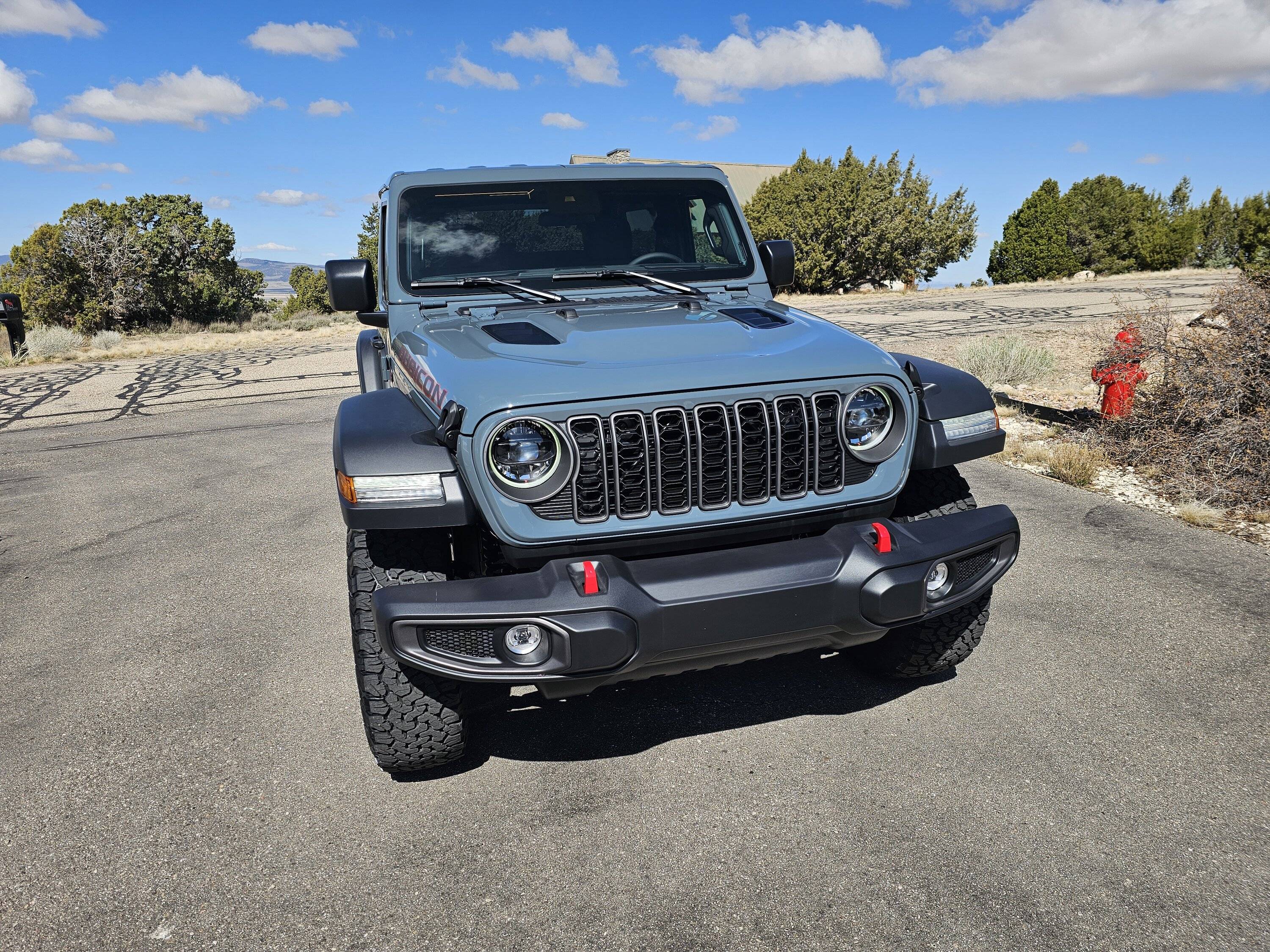

Jeep Wrangler JL 3TV's 2-Door Toad Build 2025 2DR6
Jeep Wrangler JL 3TV's 2-Door Toad Build 2025 2DR1
Jeep Wrangler JL 3TV's 2-Door Toad Build 2025 2DR7
Jeep Wrangler JL 3TV's 2-Door Toad Build 2025 2DR4

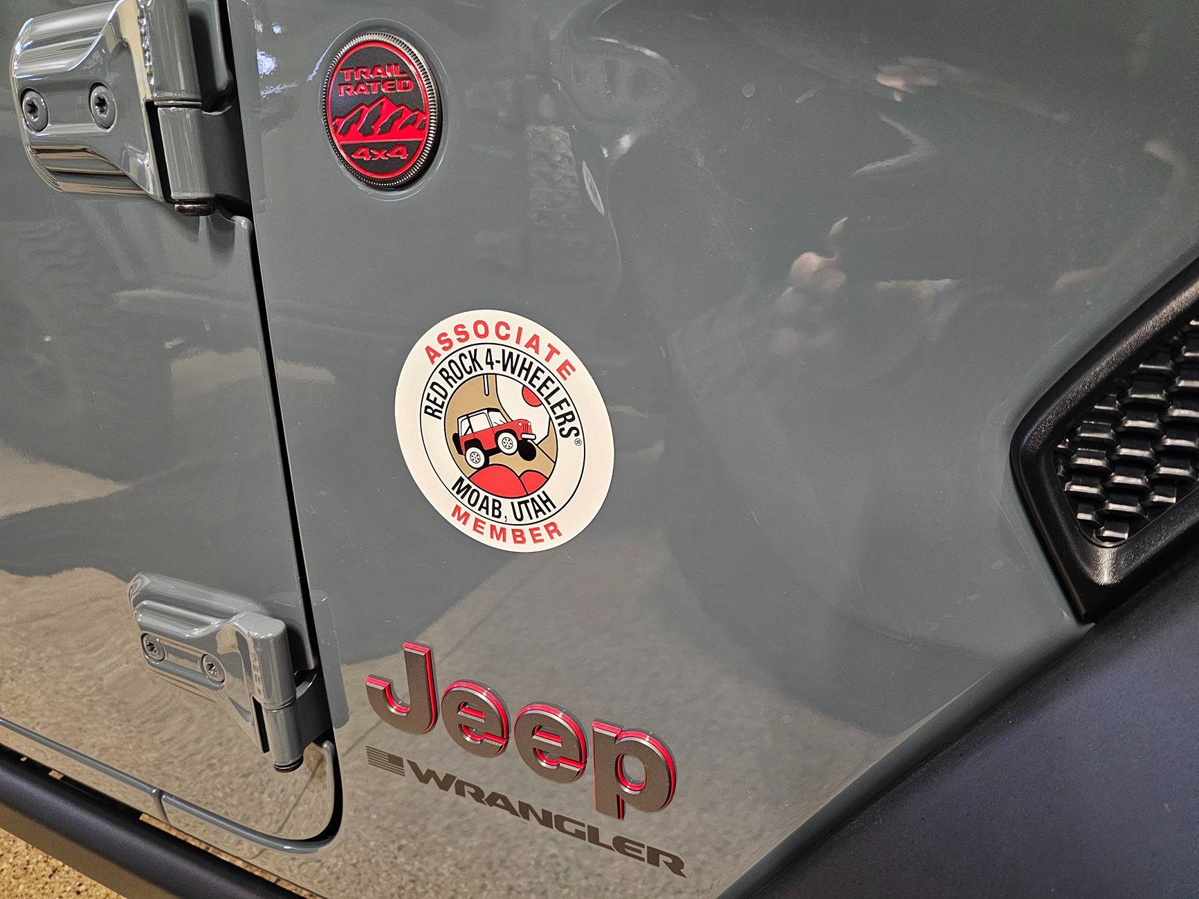

Day 1, and first mod.
Hopefully this mod will help the little JLR feel more comfortable while on the trails in Moab, being as it will hit the trails with some experience behind the wheel.
Jeep Wrangler JL 3TV's 2-Door Toad Build 2025 2DR 1st mod

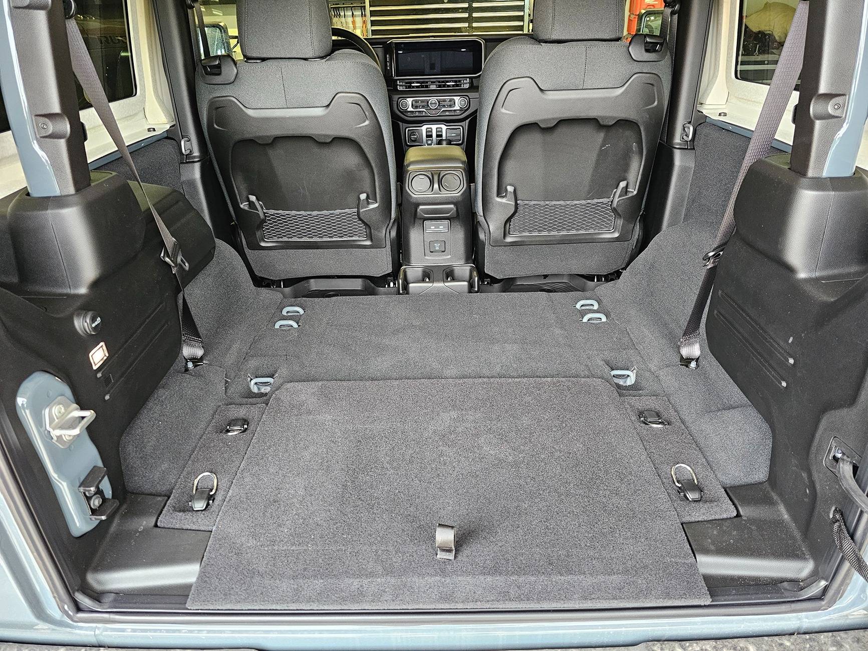

Baby steps. I removed the rear seat and organized the storage cubby under the deck.
Jeep Wrangler JL 3TV's 2-Door Toad Build Toad's Rear Deck

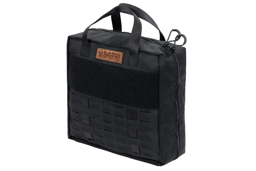

My Blue Ridge Overland Gear tool bag is the perfect size for the storage cubby. It fits snugly and can't move around at all, almost like it was made for that space. It is heavy because it holds a surprising number of tools, in fact, everything I need to carry in the Jeep on a regular basis. And it keeps everything in one place and out of view. A good first aid kit, tire plug kit, Colby valves, shop rags, gloves, and a bowie knife also fit in the storage cubby.
Hey brother, jelly of your blank canvas……lol
you got a link to which one of the tool bags you got, I looked at their site and there are several…… I’m thinking of trying to get more use out of the cubby, and maybe downsizing my trail tools a bit……. Although every time I’ve done that in the past, it came back to bite me in the ass……😅

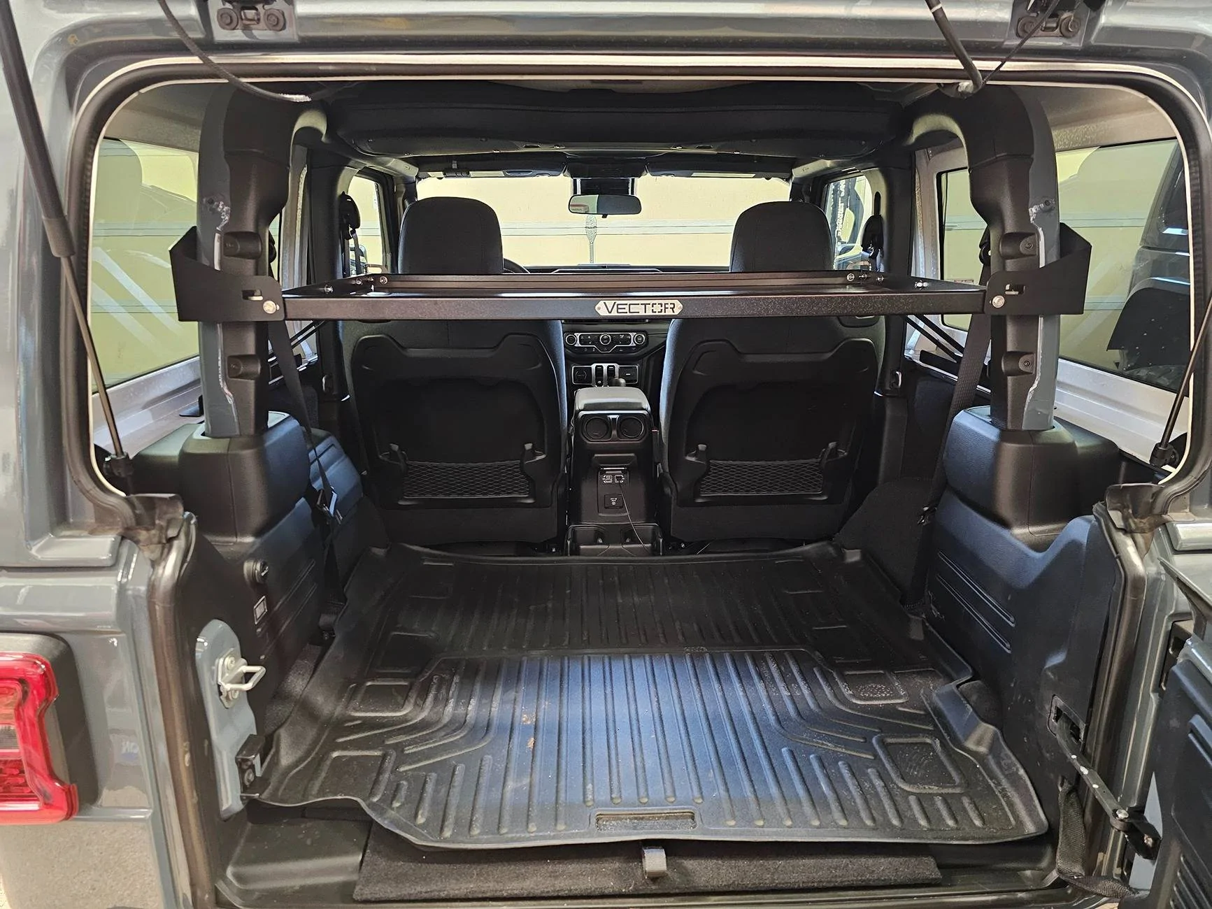

Today I installed a Vector Offroad storage shelf. I like the way it mounts, and it feels super solid. It is made of aluminum and is very light weight.
Jeep Wrangler JL 3TV's 2-Door Toad Build 2025 2 DR storag
At first glance, all of that room in there I thought it was a 4 door. Nice set up 👍
Thanks, there is lots of room, but just 2 seats. I just retired; the kids no longer go on most 4-wheeling trips, and if they do, we can take our 4-door JL. So, it's just me and my wife, and a 2-door is so much fun to drive. Besides, nobody likes to crawl into the back seat of a 2-door anyway.

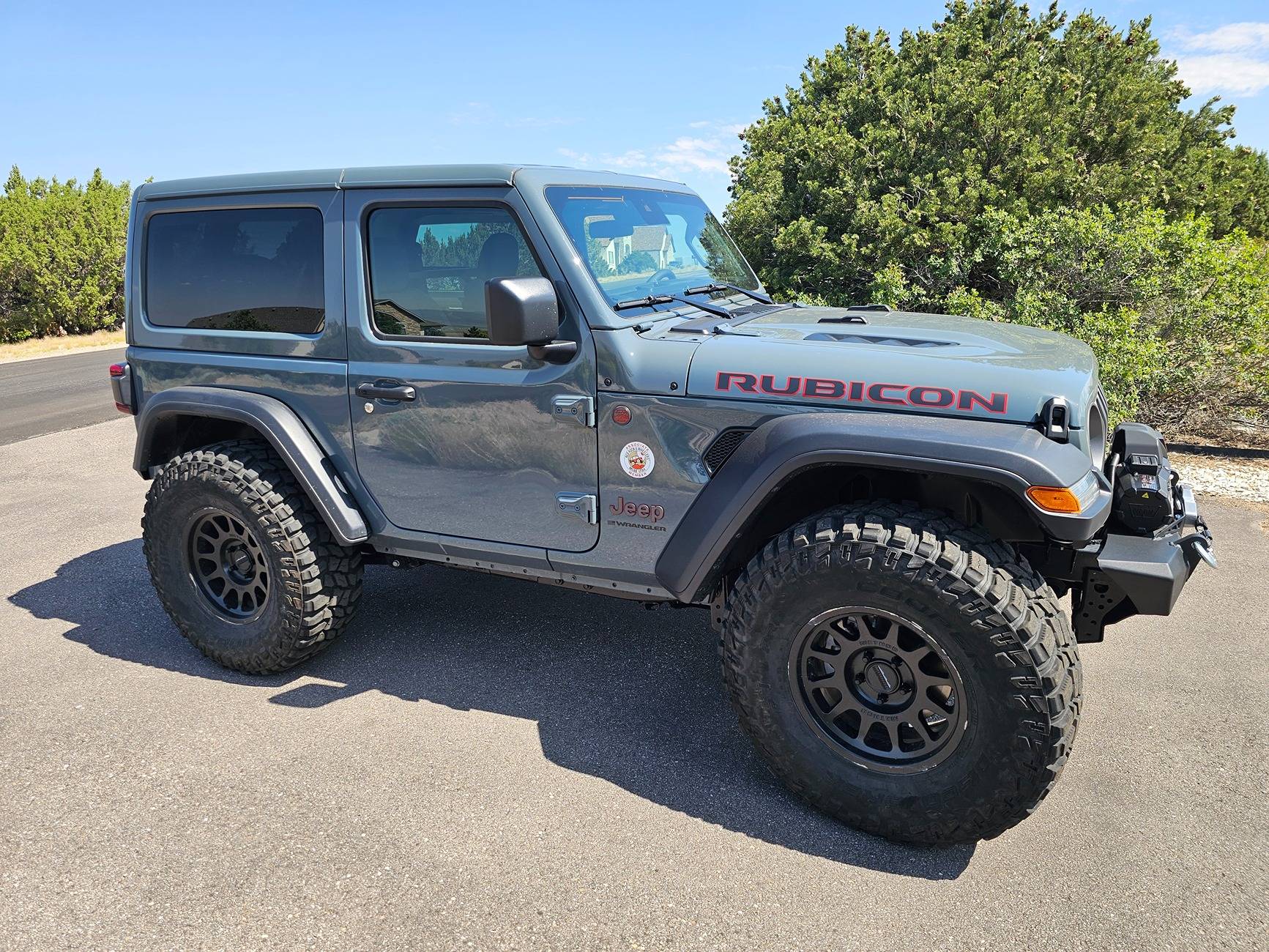

I'm getting ready to drop the Jeep off for suspension changes and 4.88 gears. So, I installed 37s on my stock suspension 2-door JLR today. I've driven it about 15 miles on pavement and no tire rub, steering lock to steering lock. I have been avoiding bumps :fingerscrossed:. These 37x12.50R-17 Load Range D Cooper STT Pro tires are mounted on Method Bead Grip wheels that are 17x8.5 with 0 offset. The best part is that they were FREE! These are the tires and wheels that came off of my 4-door JL when I switched to 40" tires on that Jeep. The rock rash on the wheels are compliments of the 392.
Jeep Wrangler JL 3TV's 2-Door Toad Build 2-Dr 37s 6
Jeep Wrangler JL 3TV's 2-Door Toad Build 2-Dr 37s 3
