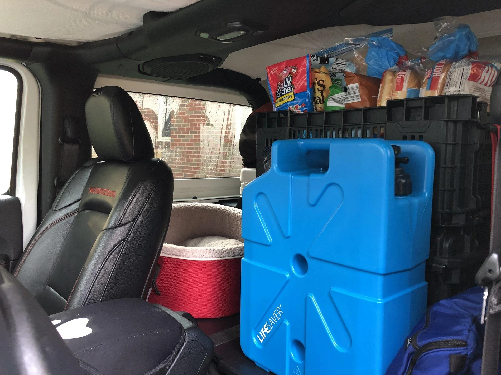

I've been camping off and on for most of my life. I love it. But, I'm relatively new to wheeling. I love that just as much. The Youtubes told me I could combine the 2 and be an OVERLANDER!!! Sweet. Sign me up. What's not to love, right? Combining 2 of my favorite things couldn't have any negatives right? Wrong. Surprisingly, I didn't really care for what they call Overlanding. Maybe I just don't have the right lift kit for overlanding. That very well could be the case. Maybe it was the 2 Door size? I don't know. What I do know is this; the dynatrac lift, if it has a shortcoming, is handling added weight.

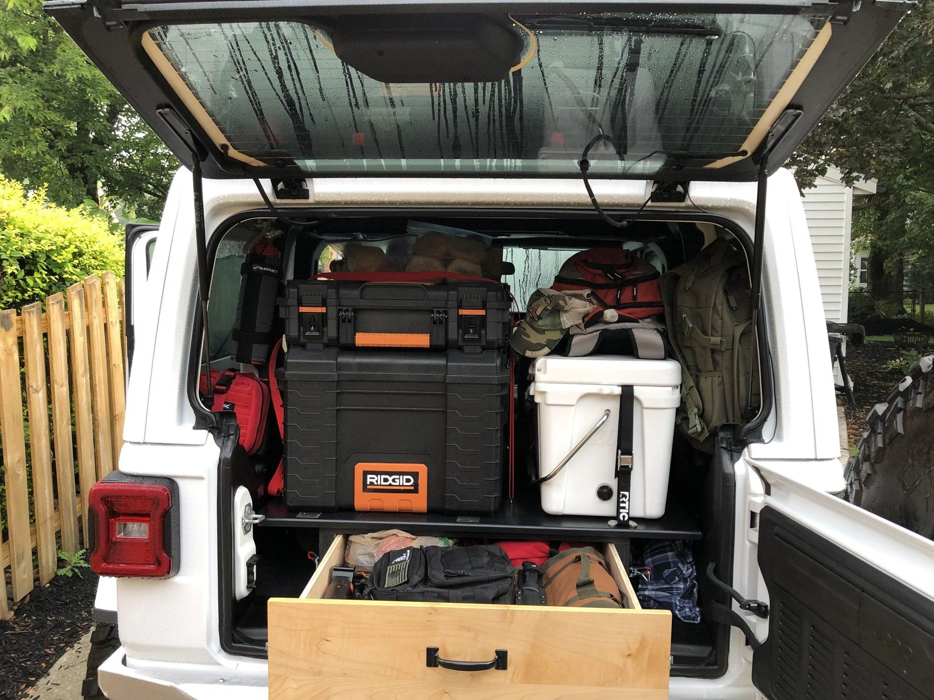

Obviously, I have superior organizational skills. ;) This is me all loaded up and ready to roll. Gear for days. All 500 lbs of it. I don't know if that is considered a lot of added weight or not. For my rig and the way it's setup... it's a lot.
All that gear had me squatting pretty good. I only had about 2" off space between the bumpstop and the jounce bumper. Upon arrival to Colorado and driving on the dirt access roads to my AirBnB (plan was to stay 3 nights and overland the rest of the trip) I was bottoming the suspension out. I knew very quickly i may have to make some adjustments. After my stay, I loaded back up and headed to Ophir Pass. I camped at the trailhead and packed back up and headed out the next morning.
It made it but I had to travel super slow. Still bottomed-out numerous times. After Ophir, I headed up to Alta Lakes. Same deal.
All-in-all it just wasn't fun for me. All that added weight, the bottoming-out, the slow travel, the camp kitchen rattling around, the water sloshing around... Maybe this Overlanding just isn't my style. The other thing was making camp in the evening and then having to pack it right back up in the morning is a total pain in the rear. I can see the appeal of the RTT, but that's just 150-200 lbs more weight added. I can't imagine that. I don't know how the TrailRecon's and the OvrlndX's of the world do it. I found it cumbersome.
Maybe I could lighten the gear load. I'm most certain I could. I didn't even touch half the gear I packed. I could maybe shave off 100-150 lbs. Not sure that would make that much of a difference. I could add spacers in the rear to help alleviate the bottoming-out problem. I could get a larger lift with stiffer springs. Or, I could just not overland per se. I'm leaning towards just wheeling or just camping. If I do combine the 2, I would probably just base camp and stage out of one location. The packing up in the morning just really sucks. I still love the Dynatrac lift. The ride is great both on and off-road. It's done everything I've asked of it so far. I'm pretty reluctant to change that out.
Nice Jeep.. you have what i wanted.. but my kids got involved thus the green 4 door..
BTW: best 100 bucks i ever spent was on the airsprings.. https://www.airliftcompany.com/shop/60818hd/ My Maxxis stickies weigh ~140 each and I tow a M416 military trailer.. so the mopar tailgate reinforcer and the airsprings saved the day for me. no bottoming.. I run rubicon, dusy trail a couple times and no issues..
