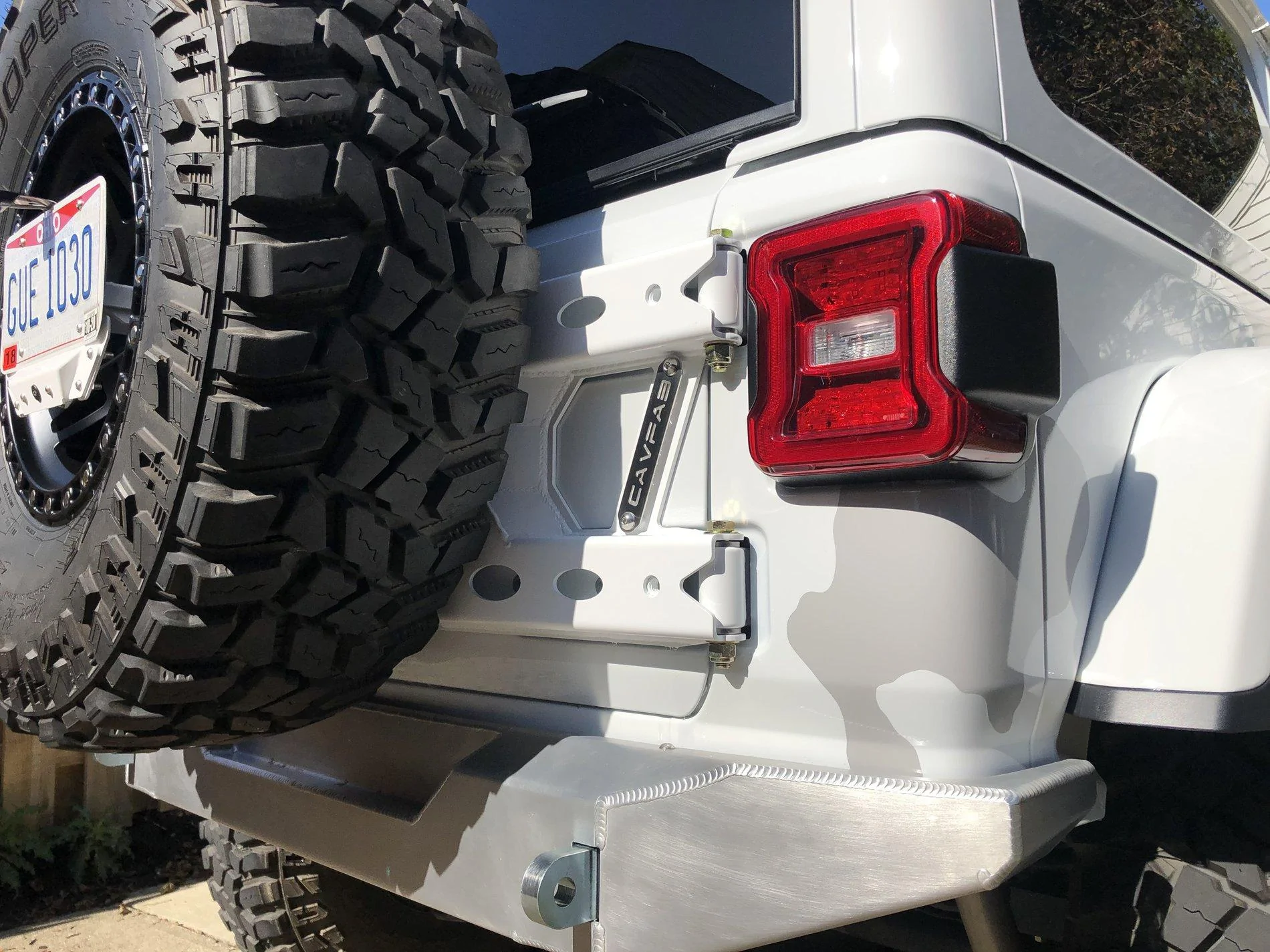

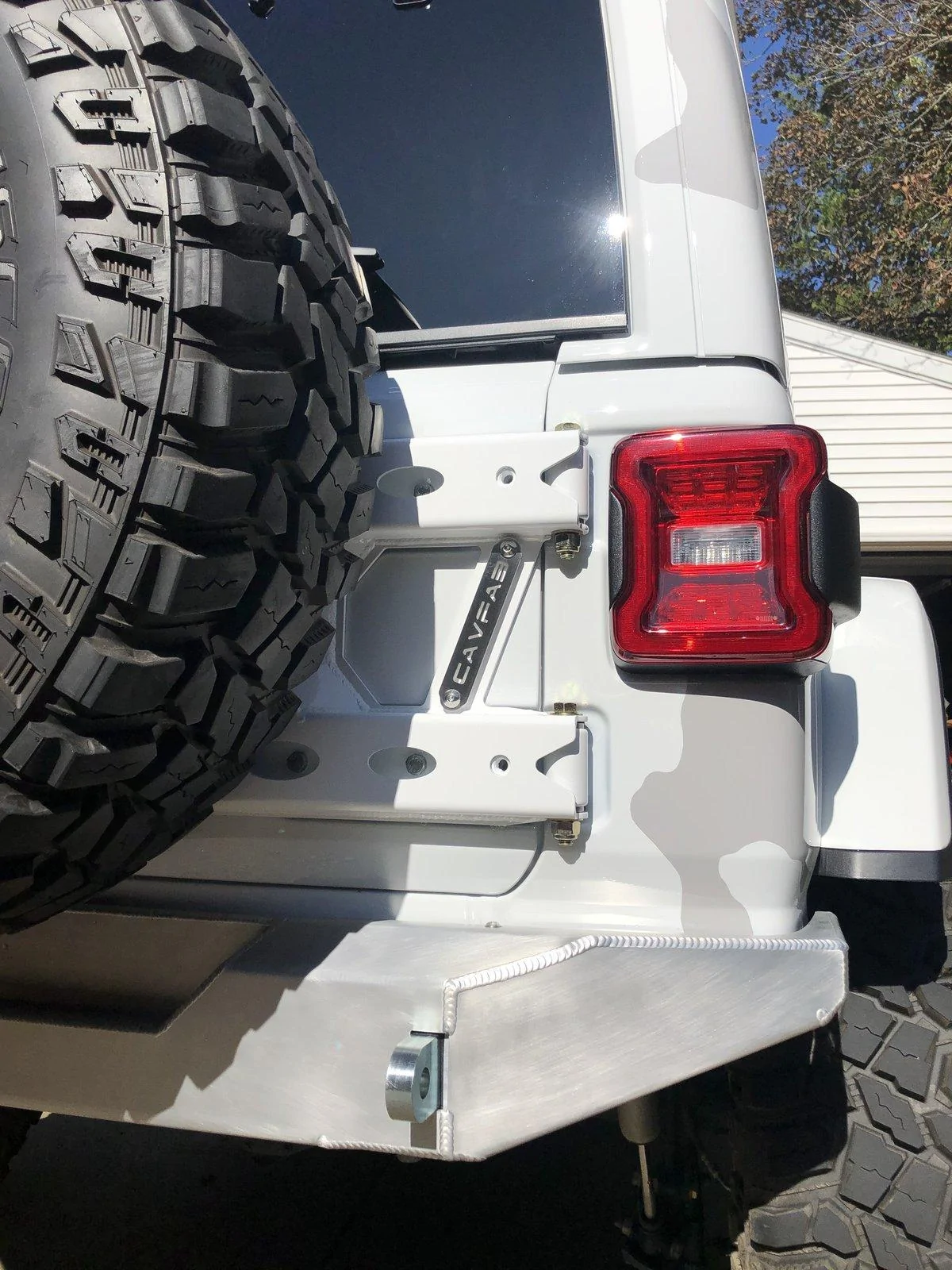

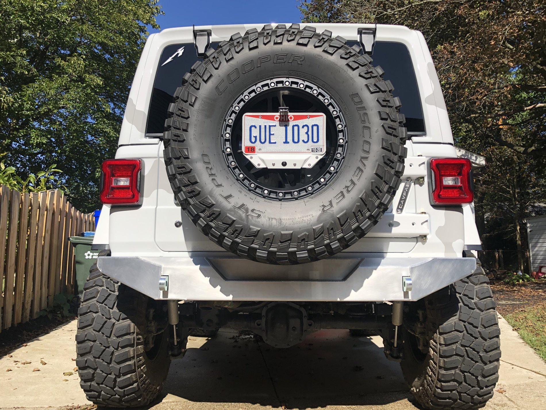

Finished up my new tire carrier install this weekend. I ended up going with the CavFab Elite Carrier. My first impression of it is that it's awesome. Super clean and beefy. It is extremely well built. Looks great color matched (not a perfect match but it's close).
I was waiting for Maximus-3 to release their carrier, but after I decided that I no longer wanted to hang a bunch of gear off the back, I decided on CavFab. It ticks all the boxes for me; replaces the factory hinges, relocates the license plate, looks clean. Install was easy also. Hardest part was lifting the tire on and off a few times to get it dialed in.
Also, added the @DynoMax Exhaust muffler elimination pipe a couple of weeks ago. I'm liking the sound so far. It's not perfect. It's a little obnoxious on the highway when the Jeep drops into 5th and 6th on the inclines. What I am loving is the clean look, the added clearance, and the 20lb weight reduction. Winning!

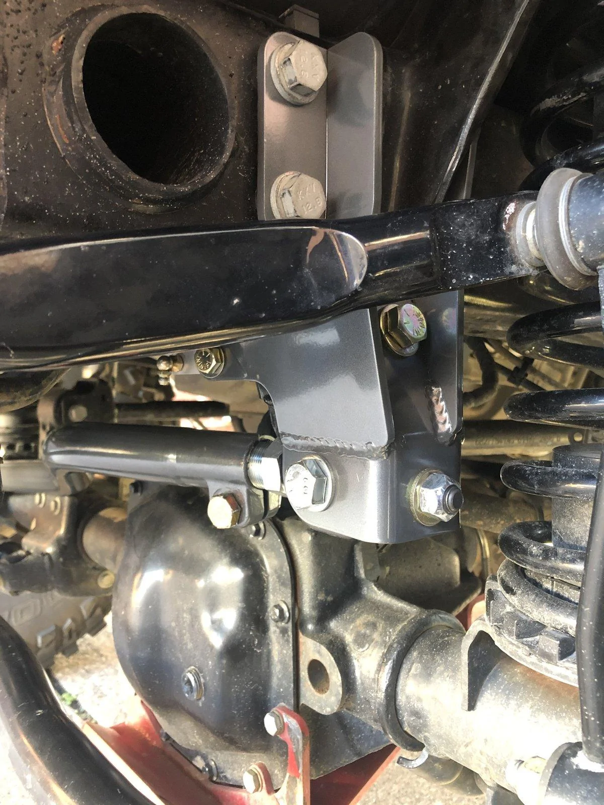

Next, I installed the Synergy Front Track Bar and Sector Shaft Brace and also their HD Adjustable Track Bar. This install couldn't have come at a better time. The day before I installed this I got my first taste of death wobble. At about 30 mph I was traversing our lovely NE Ohio roads and it hit. had to slow down to about 10 before it stopped. I'd had been noticing the steering get a little loose over the last few months. Certain bumps would send the steering wheel back and forth more than what I would consider normal. When I took off the OEM track bar I noticed 2 things. The frame side bushing was trashed and the track bar mounting hole on the frame bracket was in the very beginning stages of rounding out/enlarging.
After the install, there is a noticeable difference in steering feel. It's so much tighter and a lot less vague. I never had any wandering issues or what I thought was an overly large dead spot in the steering. This setup virtually eliminated what little play I had in the steering. I drove the same road that induced the death wobble trying to see if it would do it again and it didn't. I'm fairly certain the culprit was that OEM trackbar but I'll be changing out the rest of the steering components anyhow. IMO this needs to be on every JL. It's that good.

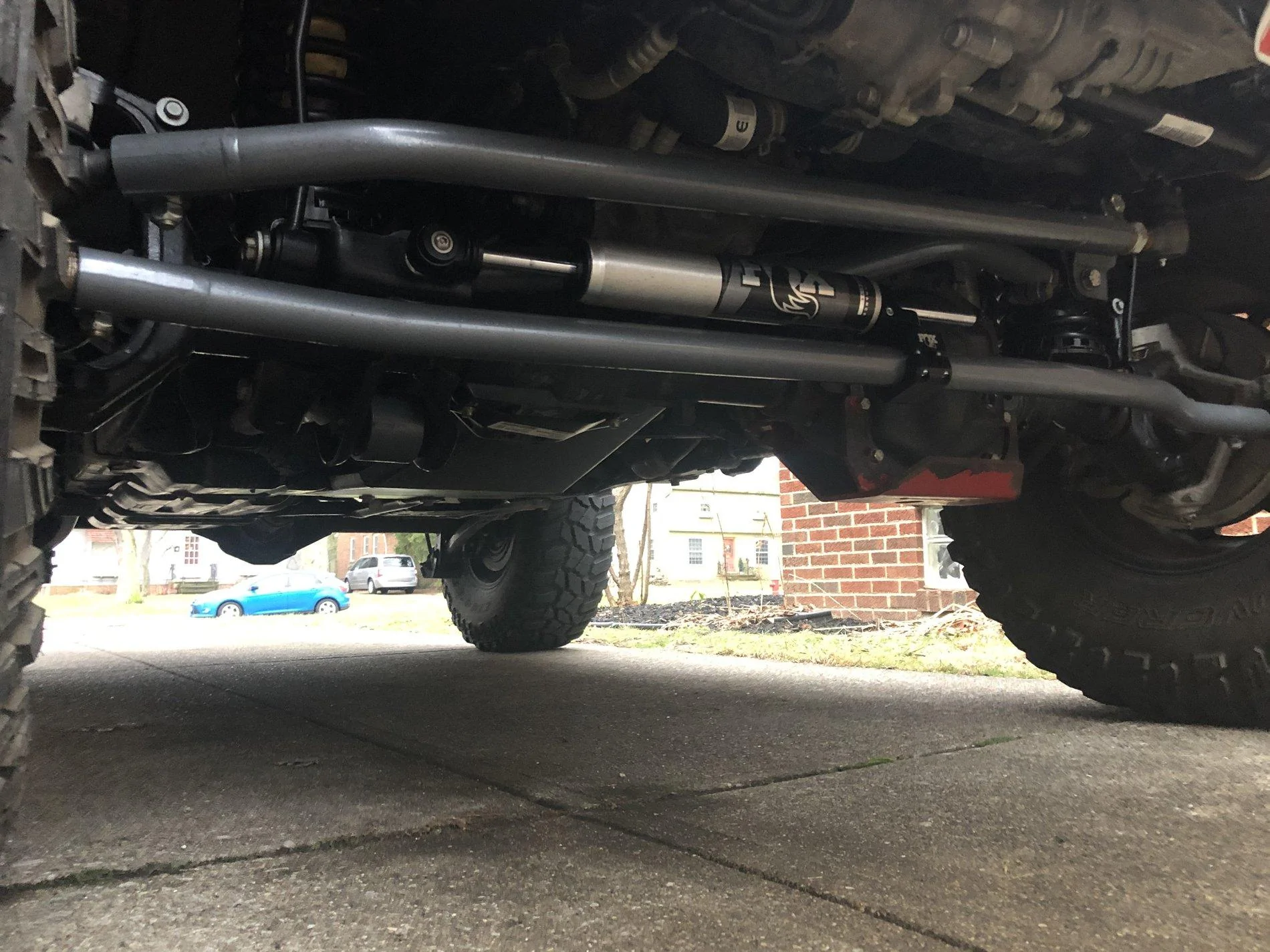

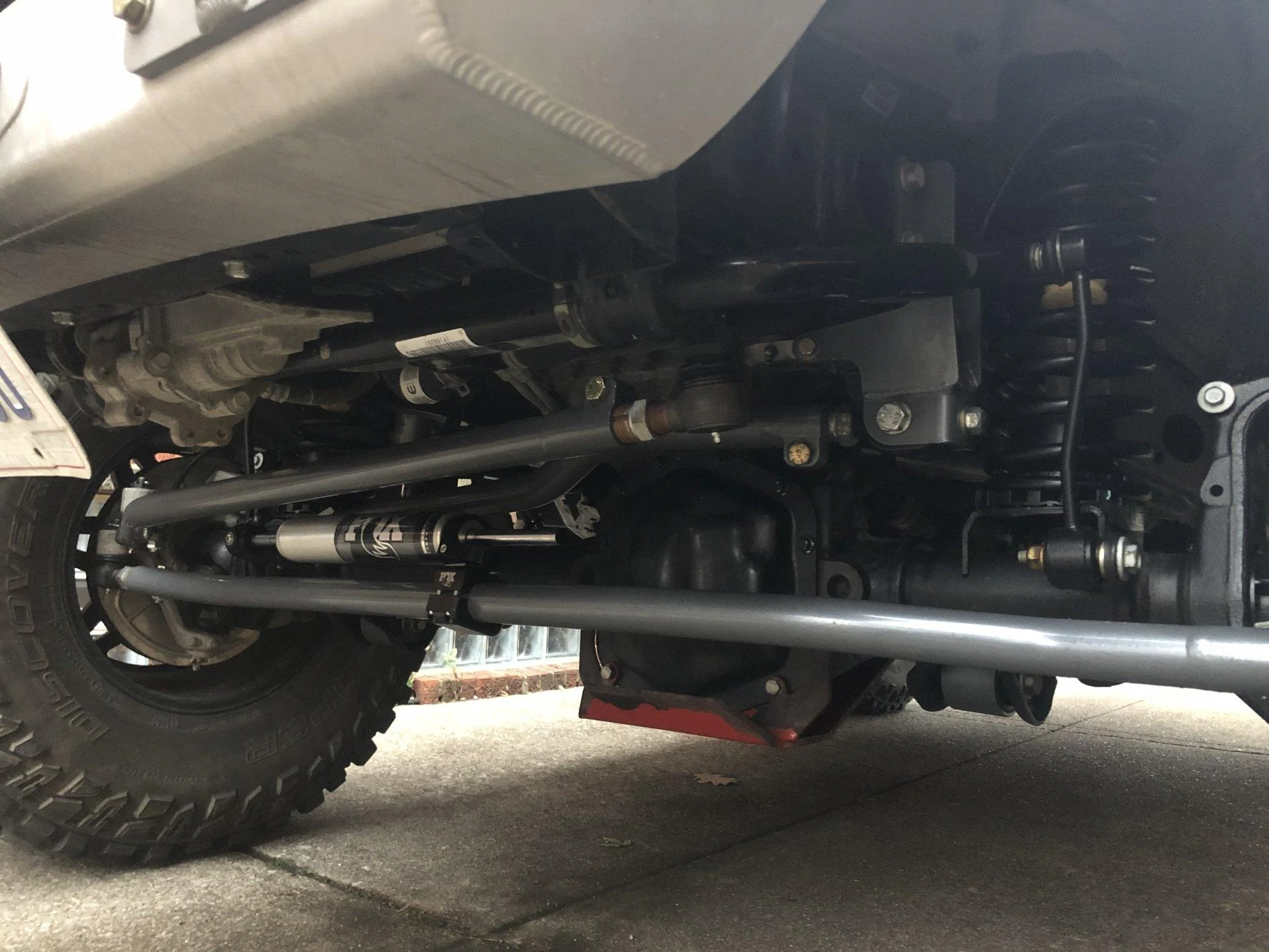

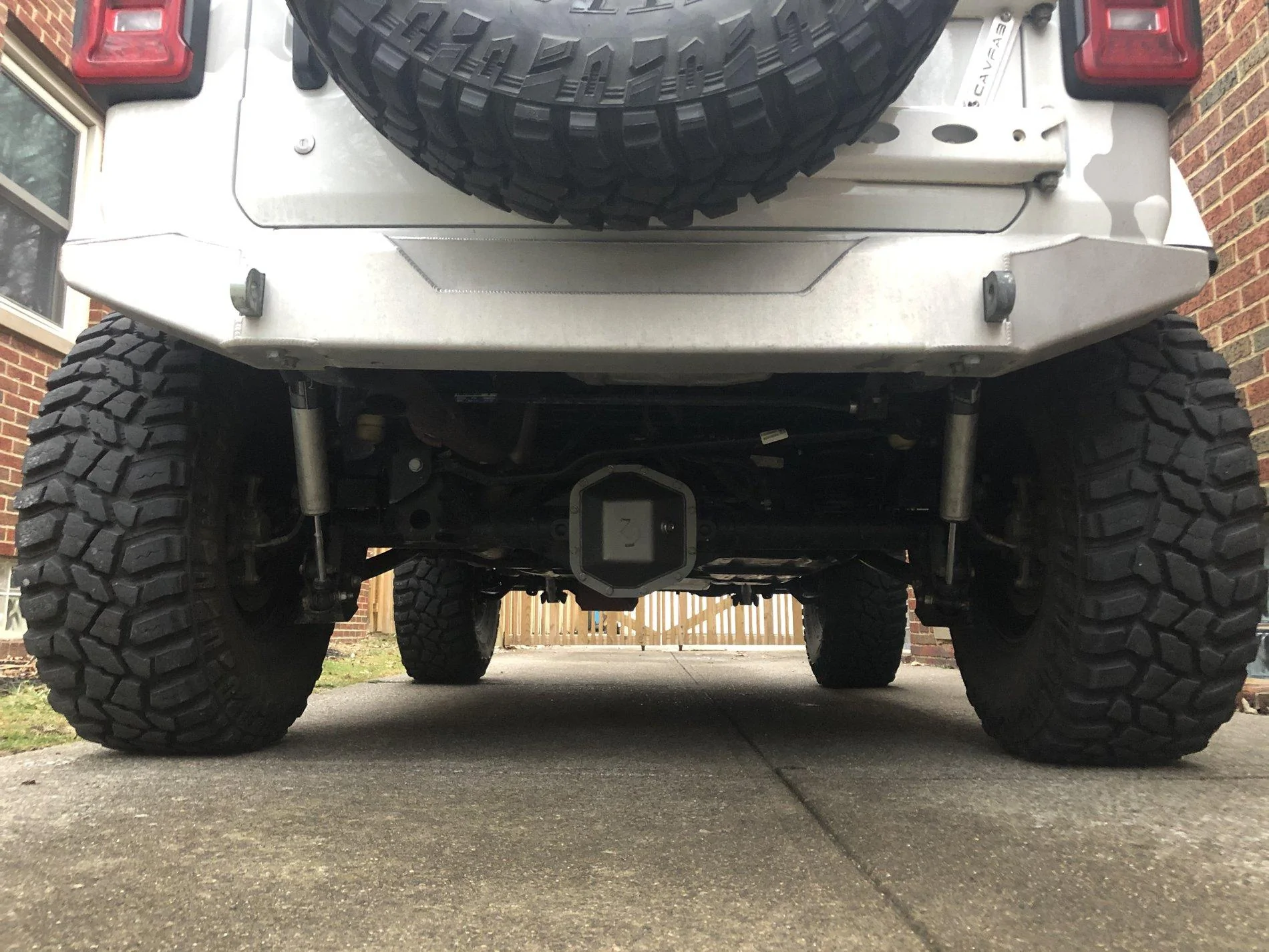

Braved the cold, the snow, and the rain this past weekend and finished up the Synergy HD steering. Also got my CavFab rear diff cover installed. So much more to do before EJS. Wheels should be back from powder and new tires should also be in this week. If the weather cooperates, I think the RCV's will go in this weekend. Still waiting on inner fenders to do the fender chop.
The front LCA's went on about 3 weeks ago. I'm at aprox 6 deg of caster (4.2 deg before the LCA install) and 1/8" toe in on the alignment. The jeep practically drives itself now. Super Impressed.
And yeah, that's a major Rancho powder coat fail. I have to pull that damn glide plate off and re-coat it. I hate rust. My tire carrier is already rusting and looks like shit - extremely pissed about that.
Looking good! Spray some Fluid Film on everything and you won't have any issues with rust or corrosion.

Thanks Chris. What would you suggest I do with the tire carrier rust? It's just starting to rust on all the edges. Would I need to clean that up somehow before applying the Fluid Film?
