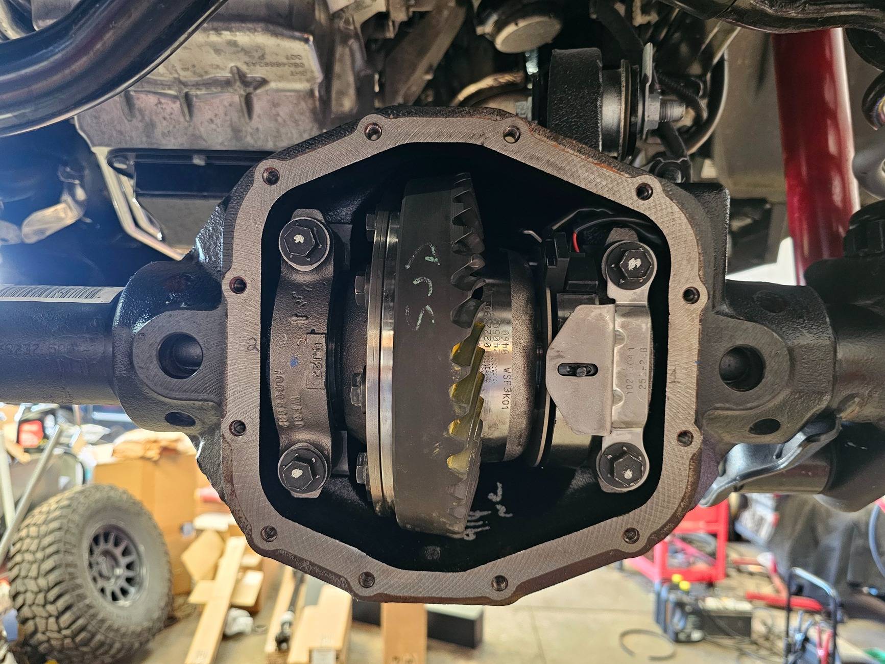

Diving into the more involved mods this week. Starting with 4.88 gears in the front differential.
Jeep Wrangler JL 3TV's 2-Door Toad Build 2-Dr front diff 1
For some reason the bearings and bearing races had an unusual wear pattern for just 1500 miles on the odometer. The OEM differential also had a mix of Timken and Koyo bearings instead of the usual all Timken bearings found in Dana axles.
Here is the wear pattern on the bearings
Jeep Wrangler JL 3TV's 2-Door Toad Build 2-Dr front diff bearin
and on the inside of the bearing race. Again, unusual for just 1500 miles.
Jeep Wrangler JL 3TV's 2-Door Toad Build 2-Dr front diff bearing race
It appeared that the bearing shims had not been fully seated, which allowed the bearings to ride at a slight angle. The differential is now assembled correctly and has all new Timken bearings throughout.

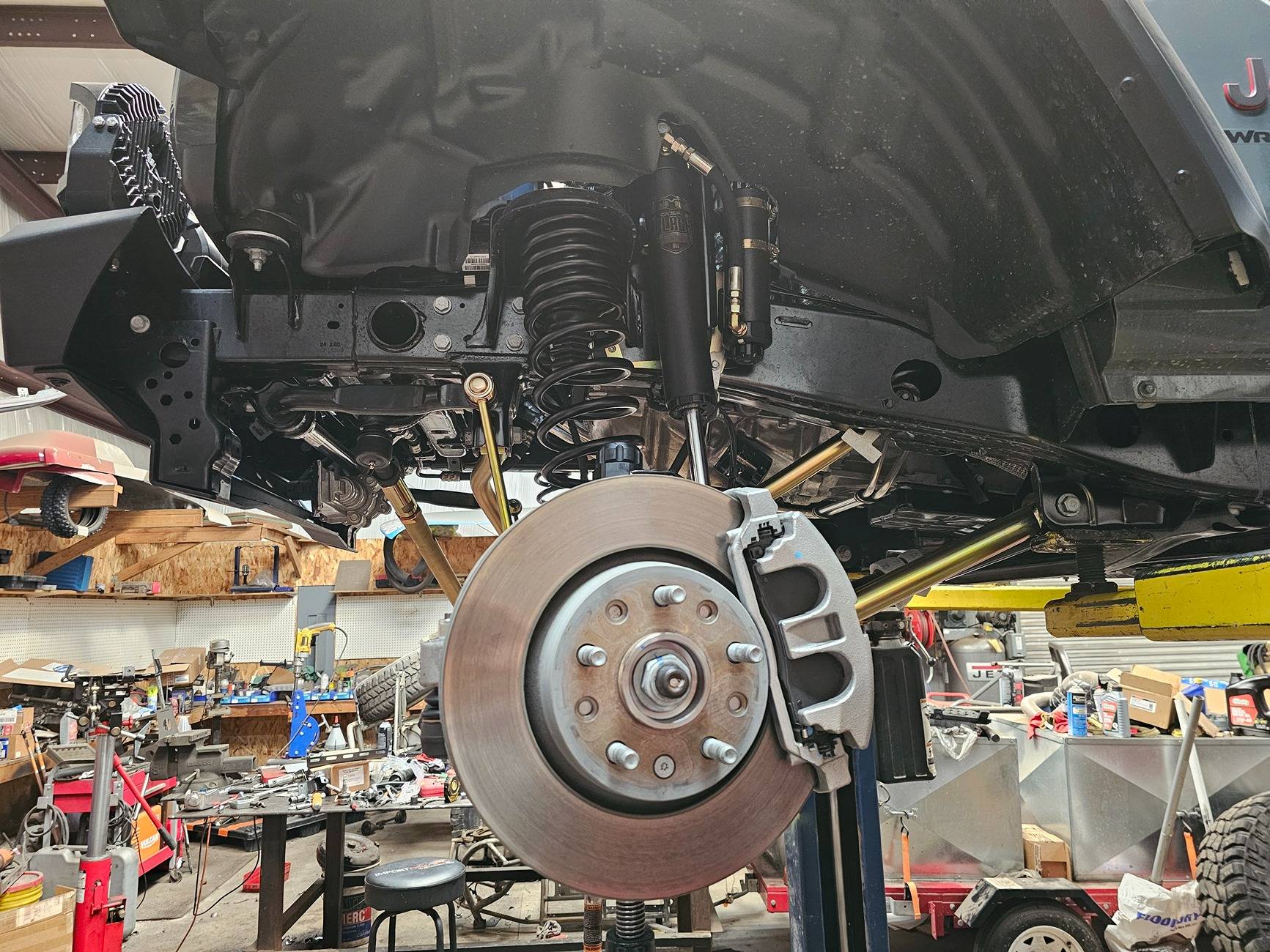

Making some more progress. Metalcloak front 3.5" suspension went on today, along with Metalcloak 1-ton steering upgrade, Black shocks, and Adam's front driveshaft. I decided to also use Dana 44 AdvanTEK differential covers. I'm still undecided on whether I need a differential skid plate.
Jeep Wrangler JL 3TV's 2-Door Toad Build 2-Dr Metalcloak 3.5 1
