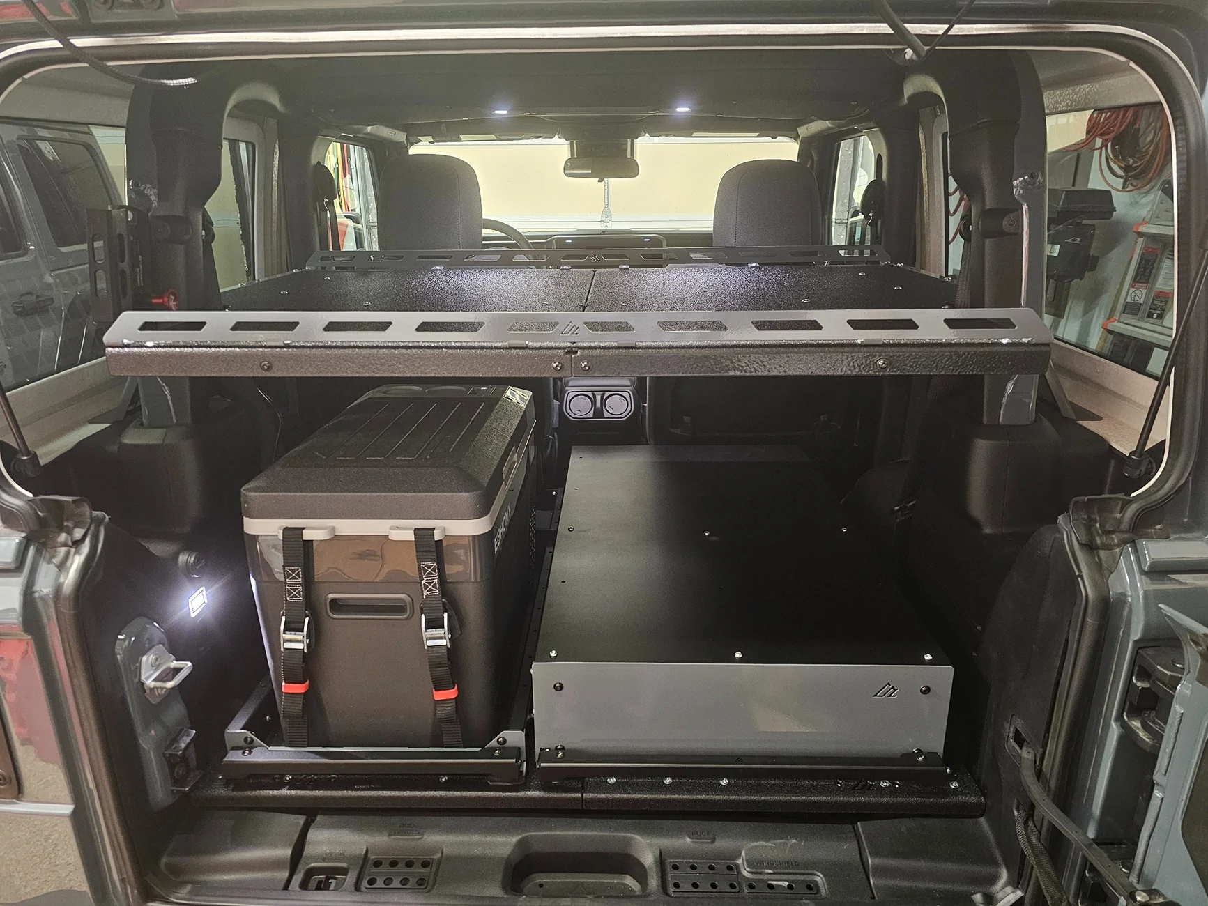

Here is the first of the AAL products going in my Jeep. It is a M.A.S.S. Plus storage platform that can be used as is, or as a base to add a slide, drawers, and more. I am impressed with the build quality, using a steel frame and an aluminum load carrying surface, it is stout. And it fits a 2-door JL like a glove. The whole thing is powder coated textured black, then the load carrying surface is also Mil-Spec coated. The Mil-Spec coating adds durability, slip resistance, and sound deadening. The two removable doors in the platform can be removed to access the OEM storage cubby.

Here is the first of the AAL products going in my Jeep. It is a M.A.S.S. Plus storage platform that can be used as is, or as a base to add a slide, drawers, and more. I am impressed with the build quality, using a steel frame and an aluminum load carrying surface it is stout, and it fits a 2-door JL like a glove. The whole thing is powder coated textured black, then the load carrying surface is also Mil-Spec coated. The Mil-Spec coating adds durability, slip resistance, and sound deadening. The two removable doors in the platform can be removed to access the OEM storage cubby.

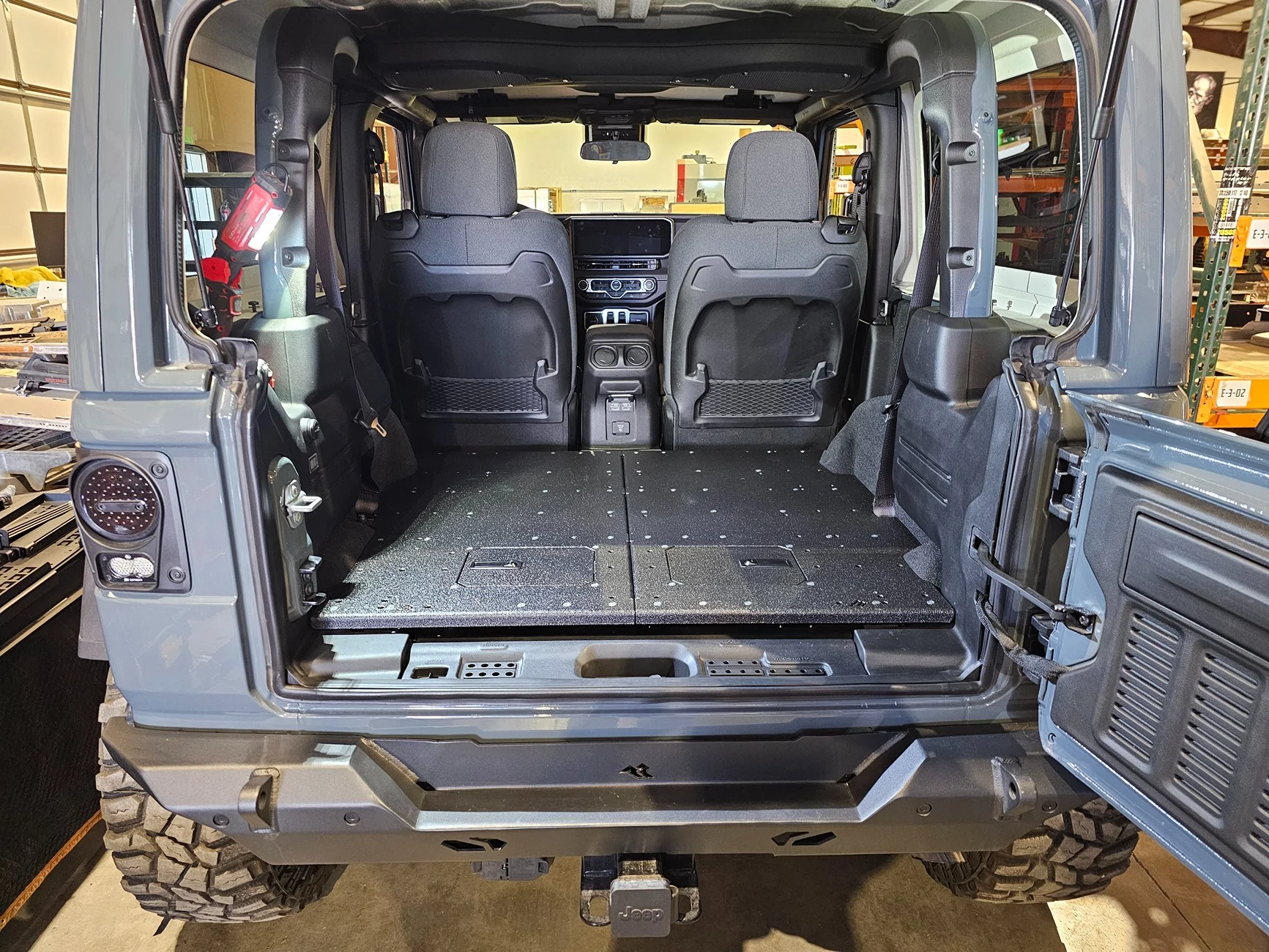

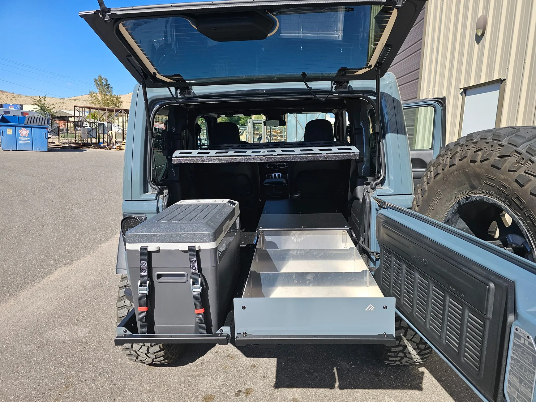

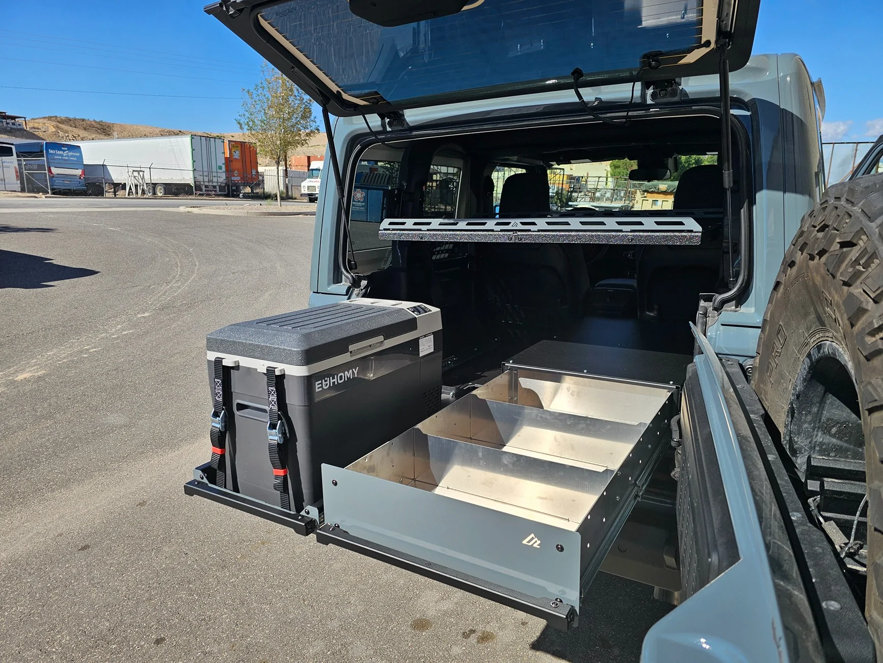

I picked up my Jeep from American Adventure Labs today. Here is the work they did for me. All of these parts will now be available to purchase for the 2-door JL. I can't emphasize enough how good the fit and finish and build quality is on all of the AAL parts.
The shelf on top is their new Overland Storage Shelf. Underneath is a new slide that is narrower and longer, and a 6" storage drawer that is wider, and also longer than the 4-door versions. All are powder coated a combination of textured black and Anvil, with a Mil-Spec coating on the top of the shelf and the M.A.S.S. Plus platform
Underneath the M.A.S.S. Plus Platform, and mounted in the OEM cubby, is a 100aH lithium battery that has its own DC-DC charger. There is also a separate 5-amp trickle charger mounted in the cubby that can be plugged into shore power to keep the lithium battery charged if I am unable to drive the vehicle for an extended period of time. The fridge is a compact Euhomy model that will keep food, drinks, and medicine cool with minimal power draw.

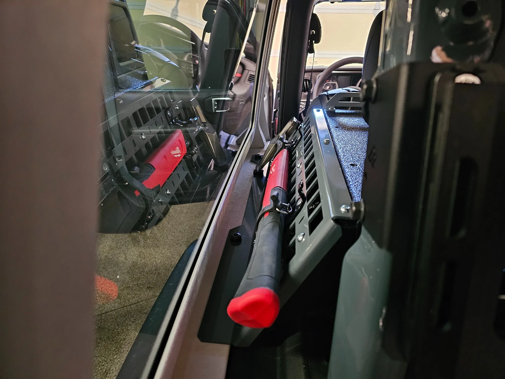

Mounted my Milwaukee axe to the Overland cargo shelf using AALs clamps. I like it, the axe is mounted rock solid and is out of the way.

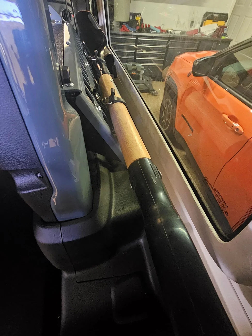

And I mounted a shovel to the other sides molle panel.

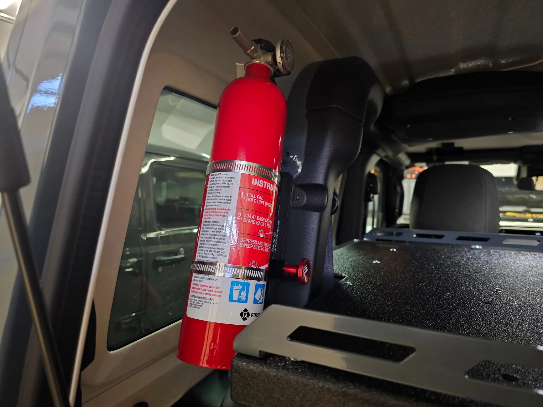

And a fire extinguisher on an AAL mount

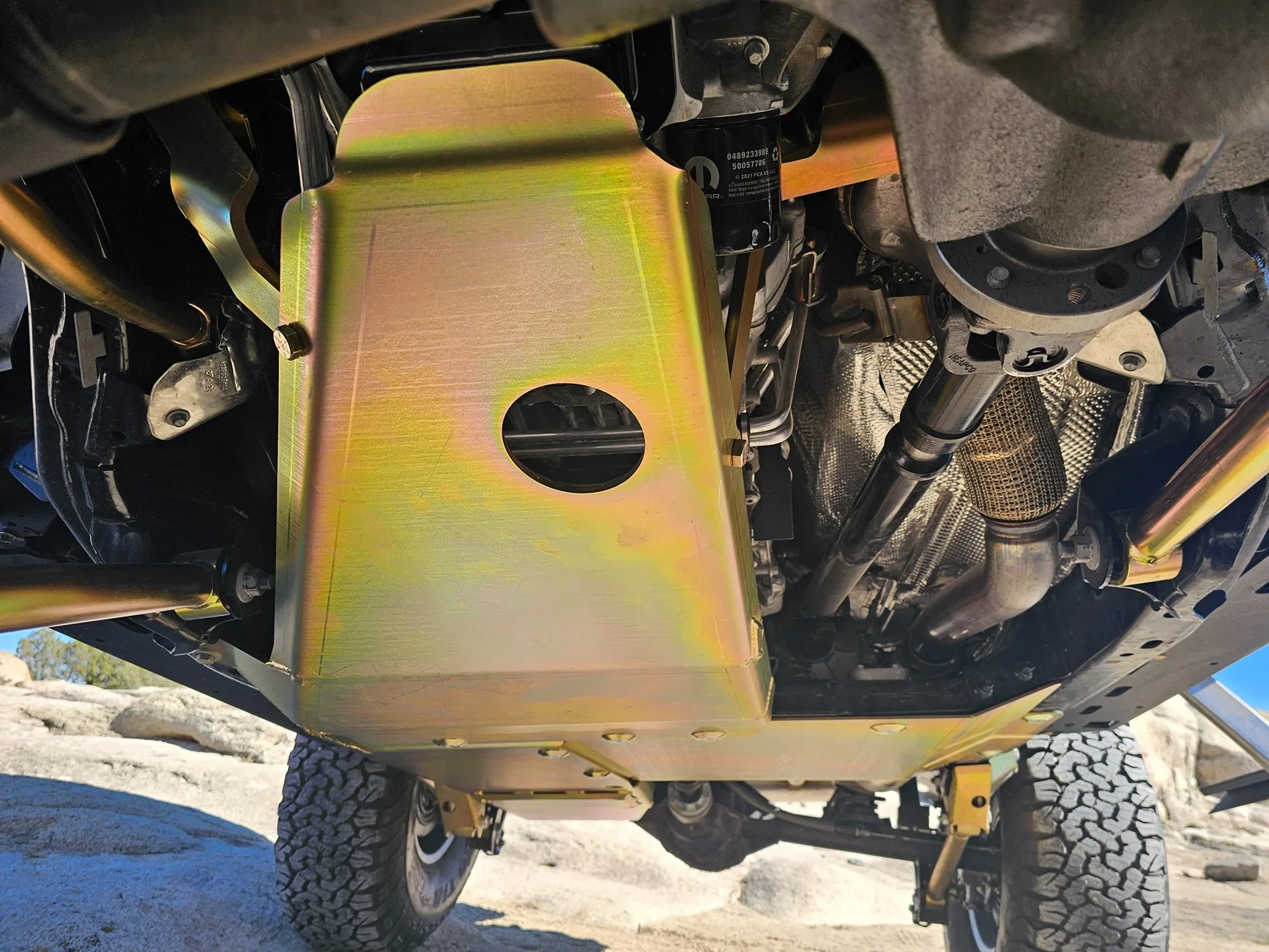

I installed Metalcloak Undercloak skid plates to help protect its belly. This completes my original list of planned upgrades.

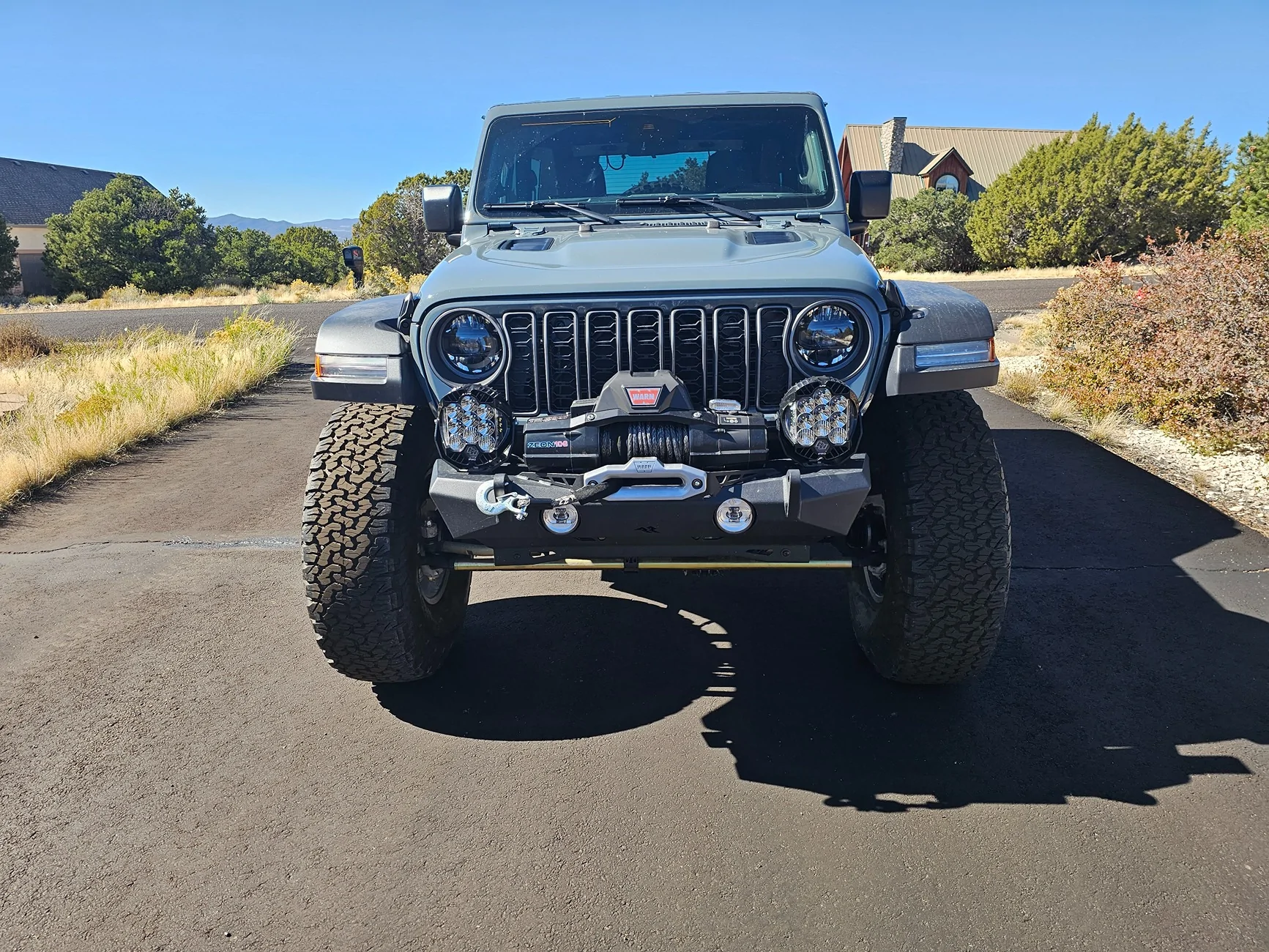

I wasn't happy with the BD LP6 lights mounted on a fairlead light mount. I tried two different brands of fairlead mount, and they both flexed too much, which caused the light beam to bounce up and down whenever you hit a bump. I removed the fairlead mount LP6 lights and will use them elsewhere. I'm now back down to just the LP9s on the bumper, which is more than adequate.
