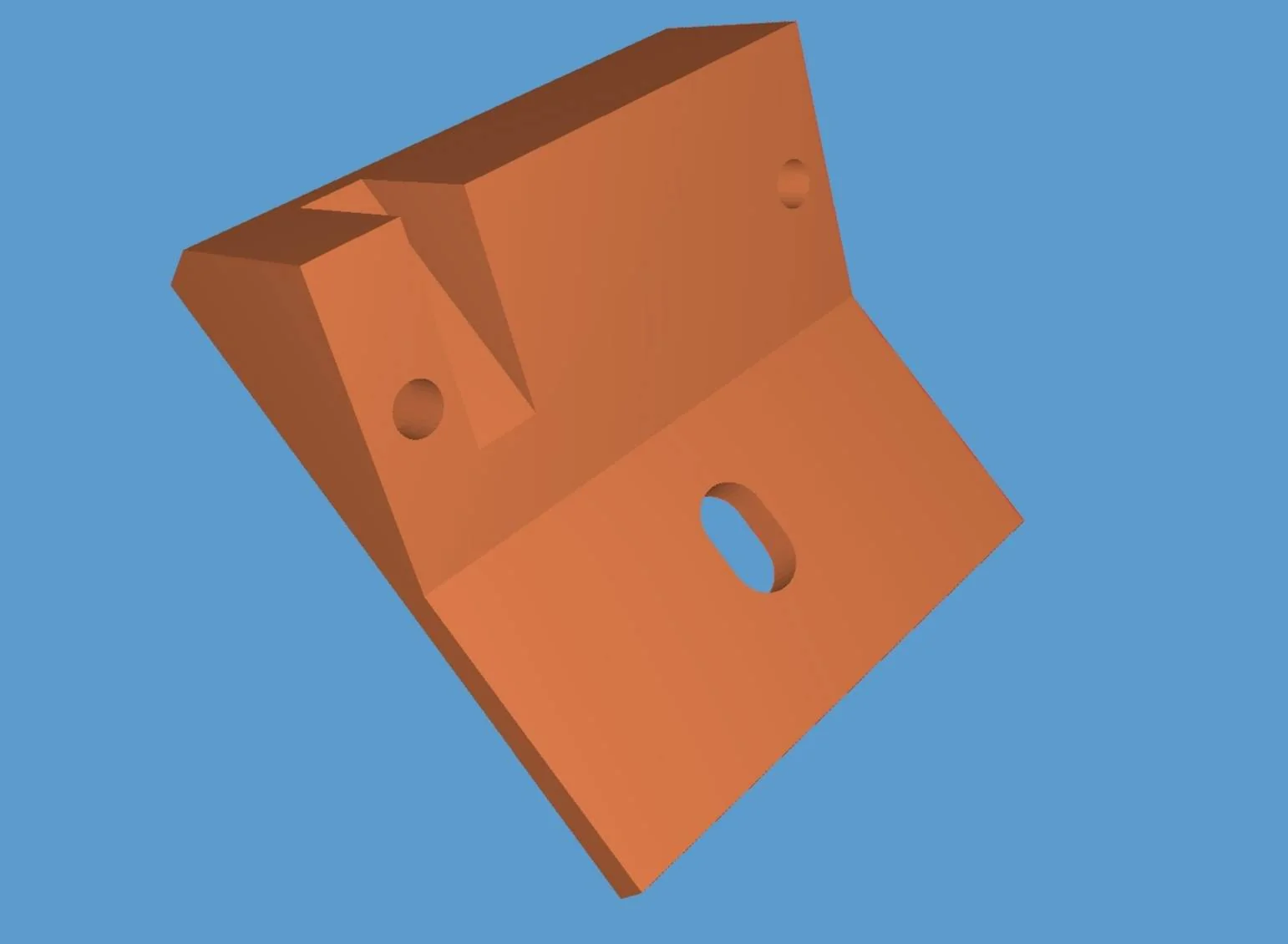

made a 25mm x 13mm bump stop for my DV8 rear molle panels to keep them from rattling against the roll bar at the front. You can use/tweak for whatever; uses an M4 socket head bolt, a M4x6 heat set insert, PETG, and TPU.

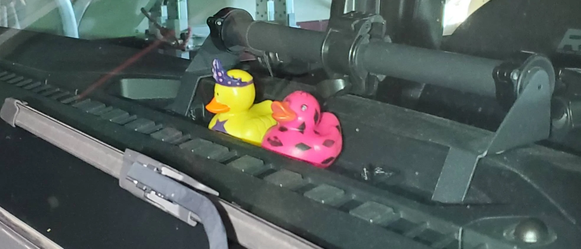

More 3d designing/printing fun for Jeep ducks. A "no tape" secure dash display.

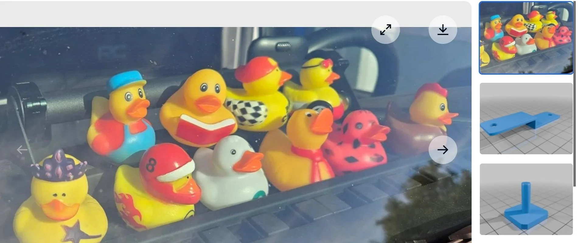

Had some time over the holidays, so I designed some add-ons to my no-tape/friction fit duck holder. This brings the capacity to 10 ducks. I realize ducks aren't for everyone, but I know my wife really enjoys the whole thing.

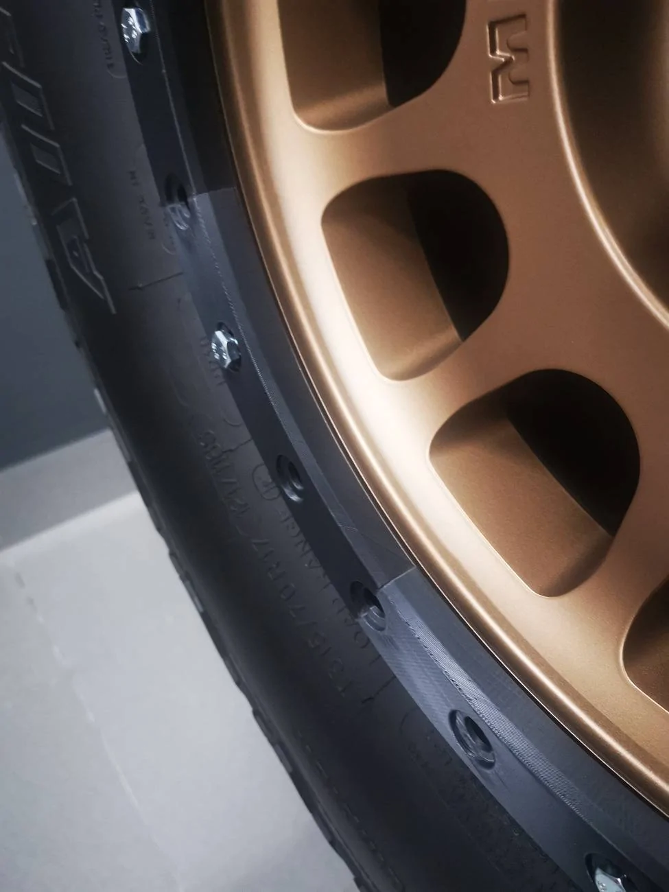

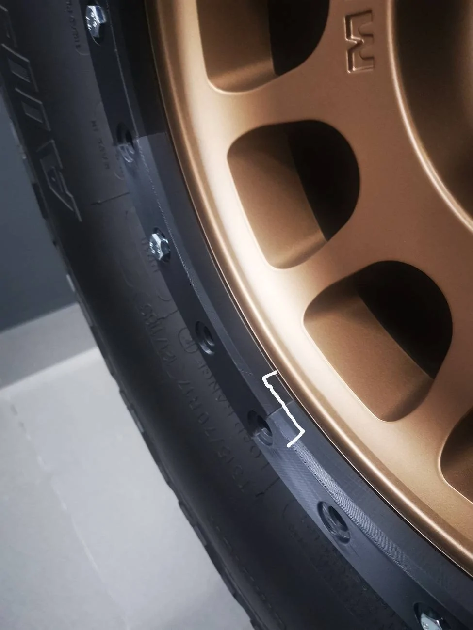

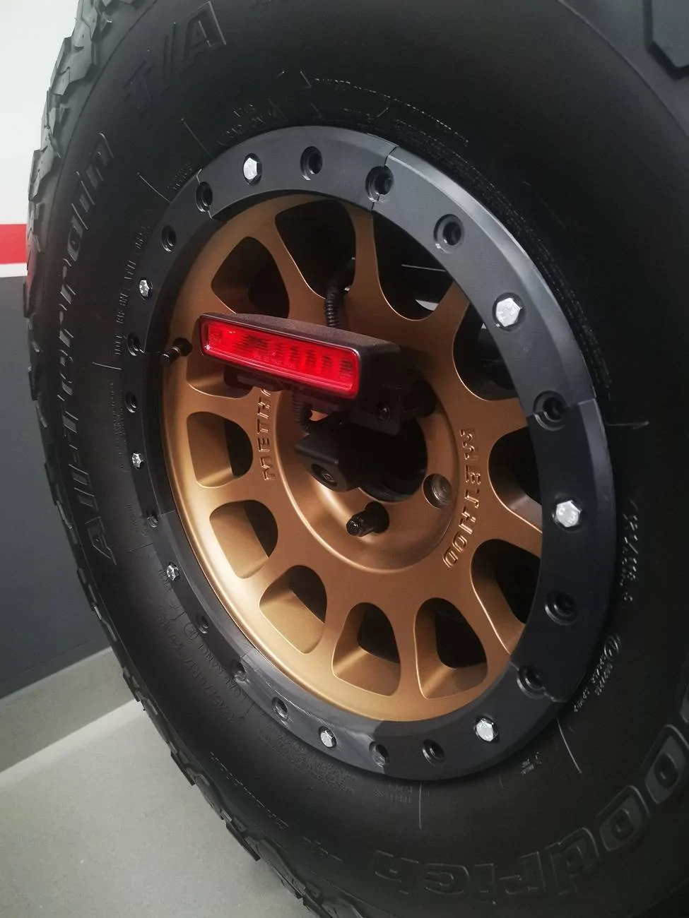

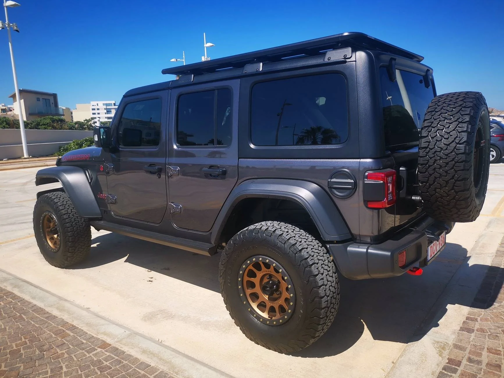

Designed my own 3D printed Method 305 wheel protection
That's pretty slick. You could do multiple different colors even.
If you don't mind, I'd make a suggestion for a slight change. Instead of a 90 degree splice, how about a lap joint. As in, see white line...

I agree. The bolt going through both pieces will prevent any kind of gap opening up from temperature changes.

I appreciate your recommendations guys. This was my first time that I looked into 3D printing, and in order to get to this I had to learn some basic Autodesk Fusion and print a couple of sample models in order to get the final design to work. Then found a local company who 3D printed them for me.
I have already printed 50 pieces (to cover all 5 wheels plus 10 extra) sanded them by hand, primed them and raptor coated them. So for the time being I will keep them as they are, but will keep your suggestions in mind for any future projects.

No worries man. Just a suggestion, definitely not a "do this or it'll never work."
If that's your first go at 3D modeling and printing, solid job. Matching diameters and hole locations on a diameter is no easy task without some somewhat specialized measuring tools.

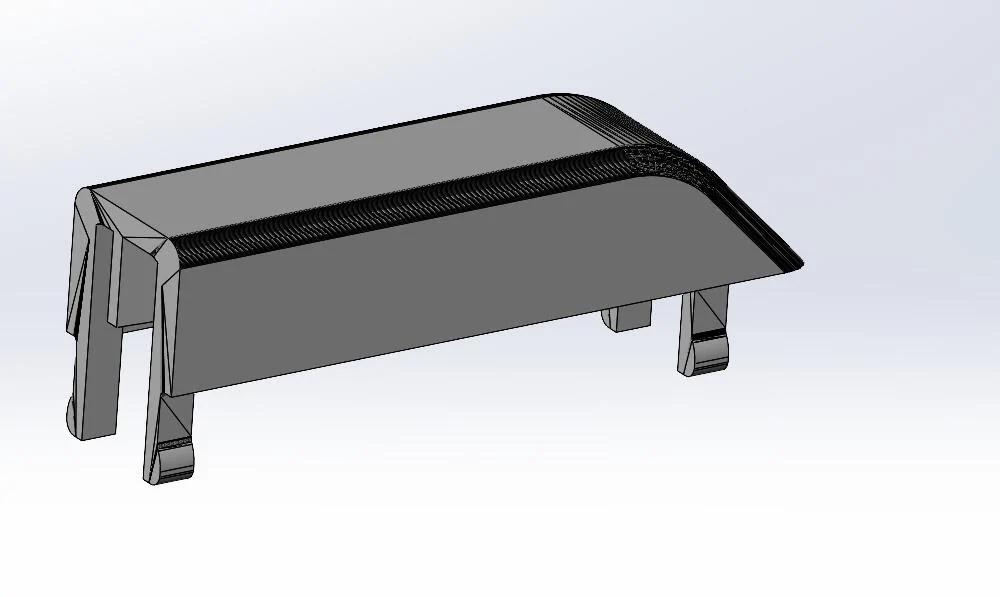

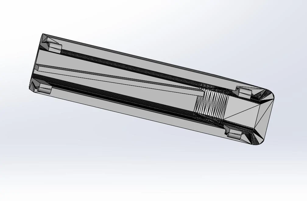

Not sure if this is quite what you're looking for, but i printed one of these for the driver side of the defrost vents. It works pretty dang well. The snaps need to be tweaked a little bit, sometimes my sun shade will knock it off. Super easy to put back though.

Cheers mate! Yeah somehow a managed to make it work using mostly a ruler, and cardboard modelling. However when it came to aligning the holes I had to give a bit more wiggle room than the actual bolt size.
