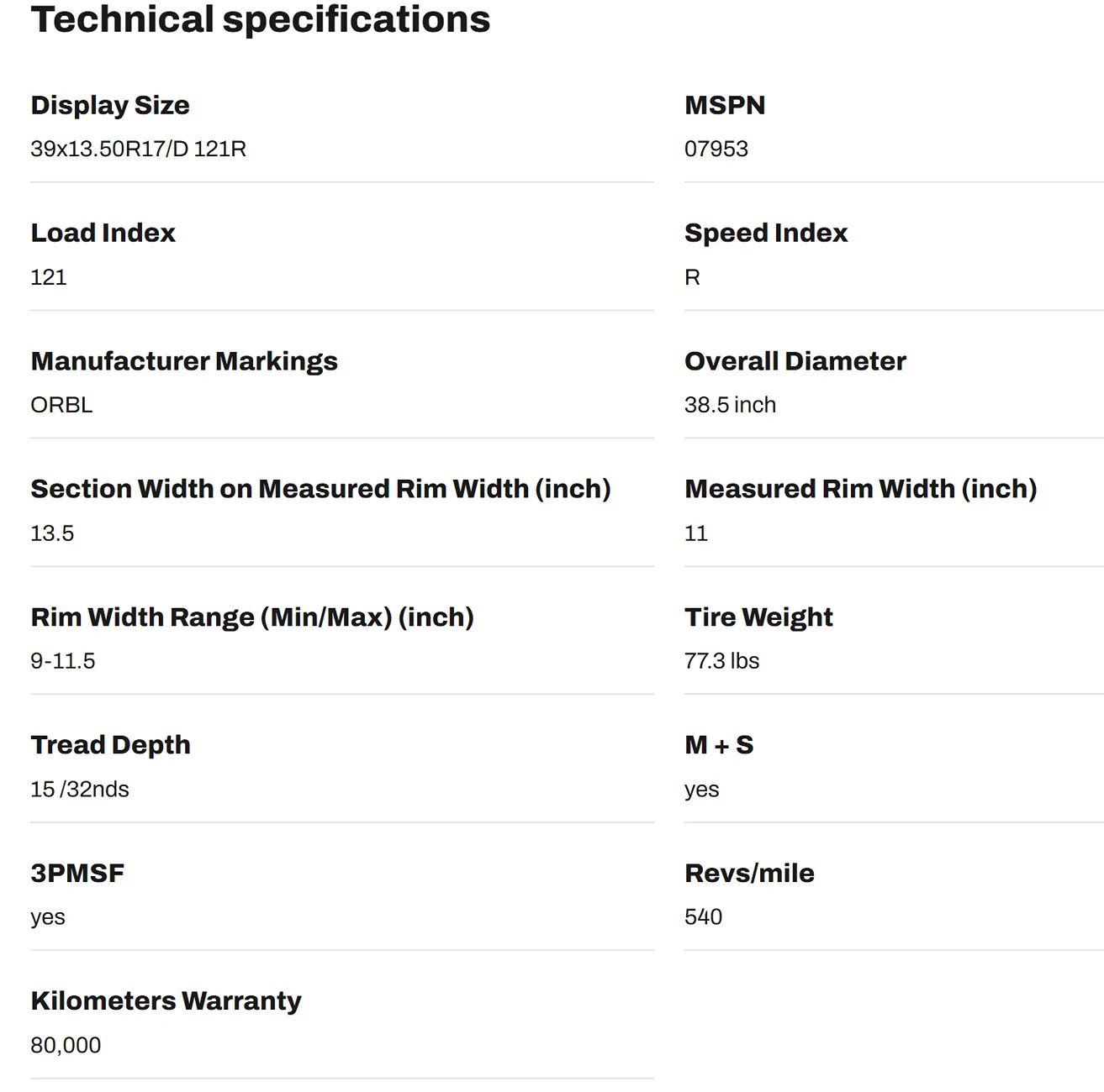

Is 3-Peak rated a concern for you? I'm pretty sure nothing larger than a 37 has it.
BFG KO3 39x13.5r17 Load range D - 3pmsf rated
77.3lb weight. Likely a true-size/taller 38 than a 39
since its a KO3 i bet this is going to be only as tall as what a Mickey Thompson Baja Boss AT 38 would have been with higher tread depth (18/32 vs 15/32).

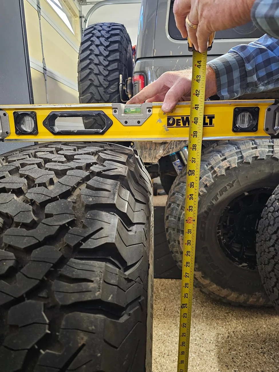

BFG's claim of 38.5" overall diameter is pretty accurate. I took some measurements of my 39" BFGs before mounting them on my Jeep. Mine measured 38 5/8" tall mounted on a Teraflex Nomad 17x8.5 wheel with 30 psi in the tires.
Jeep Wrangler JL 38" Tire options? Tires 39 BFG
Here is a 40" Toyo, compared to a 39" BFG, compared to a 37" Cooper.

Good to know.
Did u happen to take a measurement installed with the weight of the JEEP on it? Nitto 38s seem to run about 37" installed@street pressure by most accounts ive read

I have not taken that measurement. Everyone's Jeep is going to weigh different, and mine is a lard ass with all of the recovery gear, tools, and survival gear I carry.
