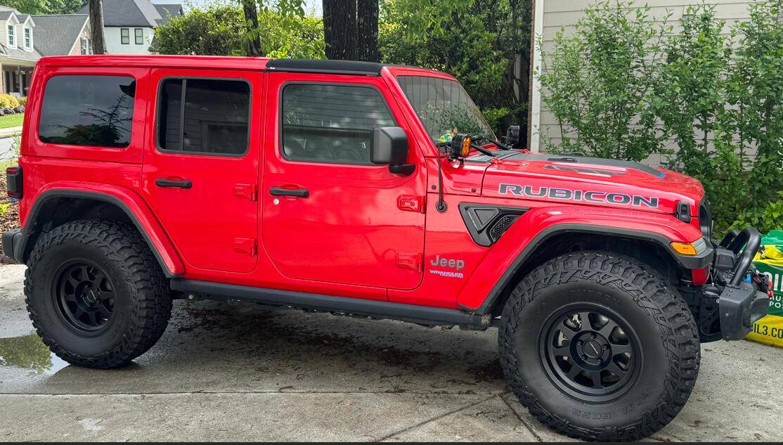

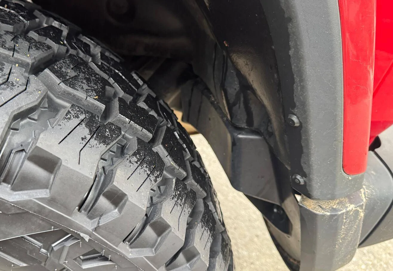

If you dont have a lift you might not have the space to flex them.
b/w 37 is always the right answer lol
This is my 37 sitting on stock '21 4Xe
Jeep Wrangler JL 35s or 37s 1747416621230-9b
Thats the gap on the rear, it rubs getting on my driveway. no rubbing on the interstate or going to the mall though.
Jeep Wrangler JL 35s or 37s 1747416682267-a4
My lift is sitting in the garage, waiting to be installed.
