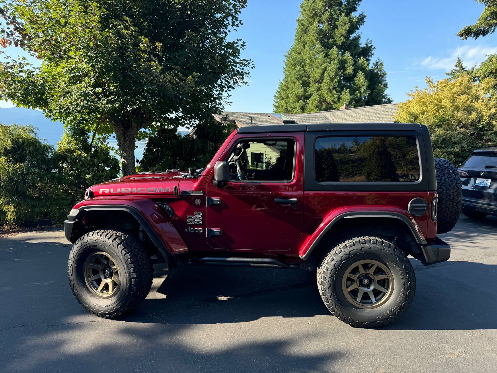

I don’t think you will be happy with 37s w/o any lift. I have a 2dr JLR with 35in tires and a Clayton 1.5in lift. Actually netted 2in. Managed the Rubicon Trail. I think you will end up doing more to your Jeep if you go with 37s. I love my setup and don’t desire bigger. Here is the stance.

That’s looks really good. I don’t have the highline fender flares. And I have stock rubicon suspension.
