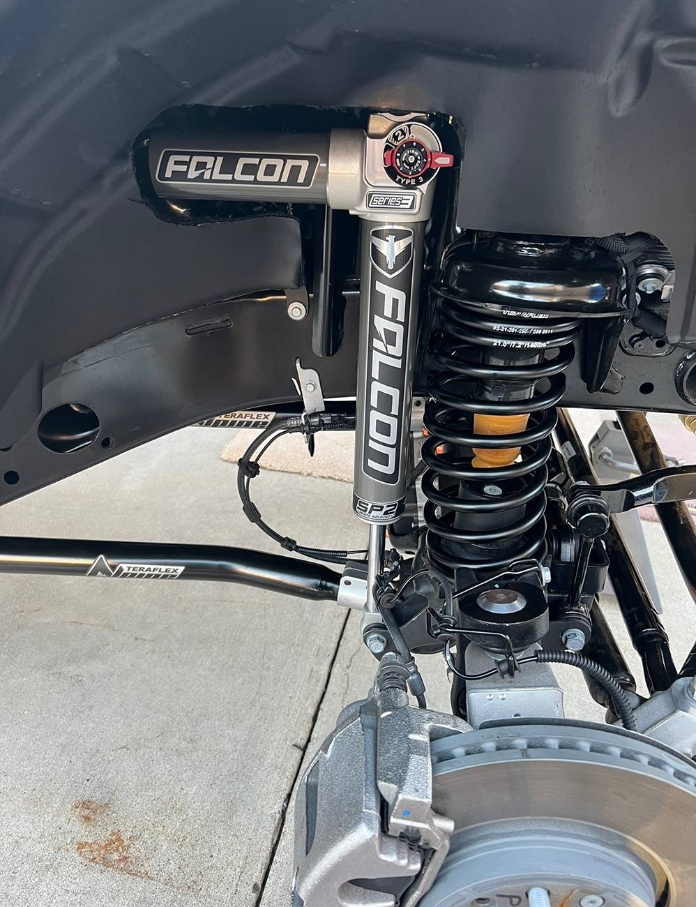

I think I’ve settled on 35s. That way I can get a better lift. I’m thinking this teraflex kit.
Now is the battle royale of which tires. My wife has 35x11.5x17 KO3s on her Escalade and they’re quite on road. Handle great I hate that they pick up rocks/pebbles and just absolutely flings them like David at Goliath. I’ve also been considering MT Baja boss ATs. I’ve read nothing but great things about them watched countless videos of tire reviews. I like the AT4W also. My thing is it needs to have the 3PMS rating. So if you guys have some ideas of a decent lift and tires let me know!

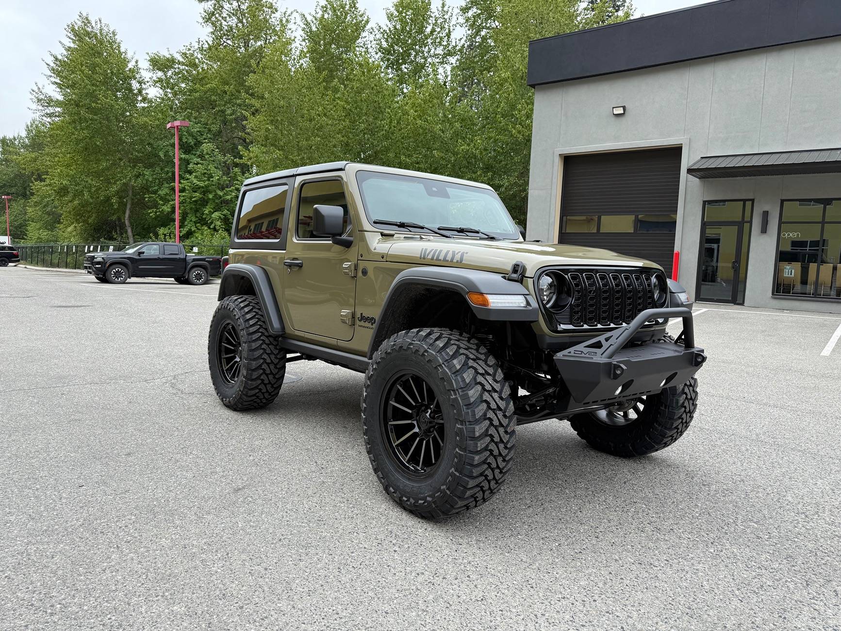

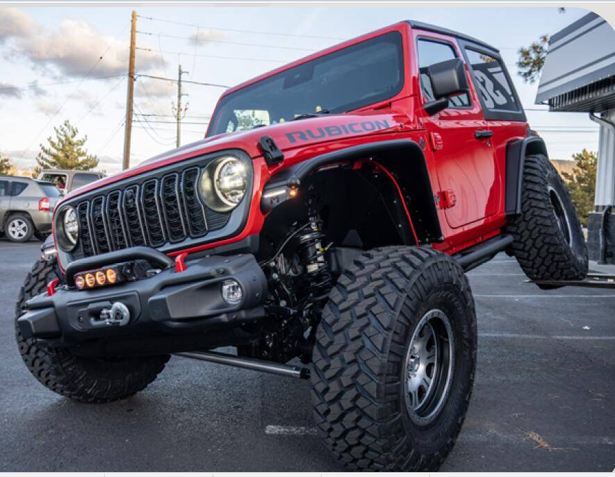

Rubicn fenders , mopar lift +leveling kit , if you have stock set back then youll need 2” spacers . Adjustable track front bar . And minimum 4:10 gears ,
The cheapest youll get 37s on to a sport .

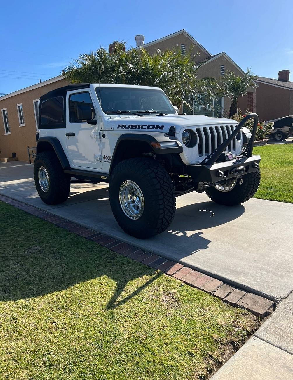

I don’t think you will be happy with 37s w/o any lift. I have a 2dr JLR with 35in tires and a Clayton 1.5in lift. Actually netted 2in. Managed the Rubicon Trail. I think you will end up doing more to your Jeep if you go with 37s. I love my setup and don’t desire bigger. Here is the stance.
I ike these setup. so 37 need onli 1.5inch? Thats it?

My pic is with 35s. I’m saying OP won’t be happy with 37s unless he does a whole bunch of other mods.
