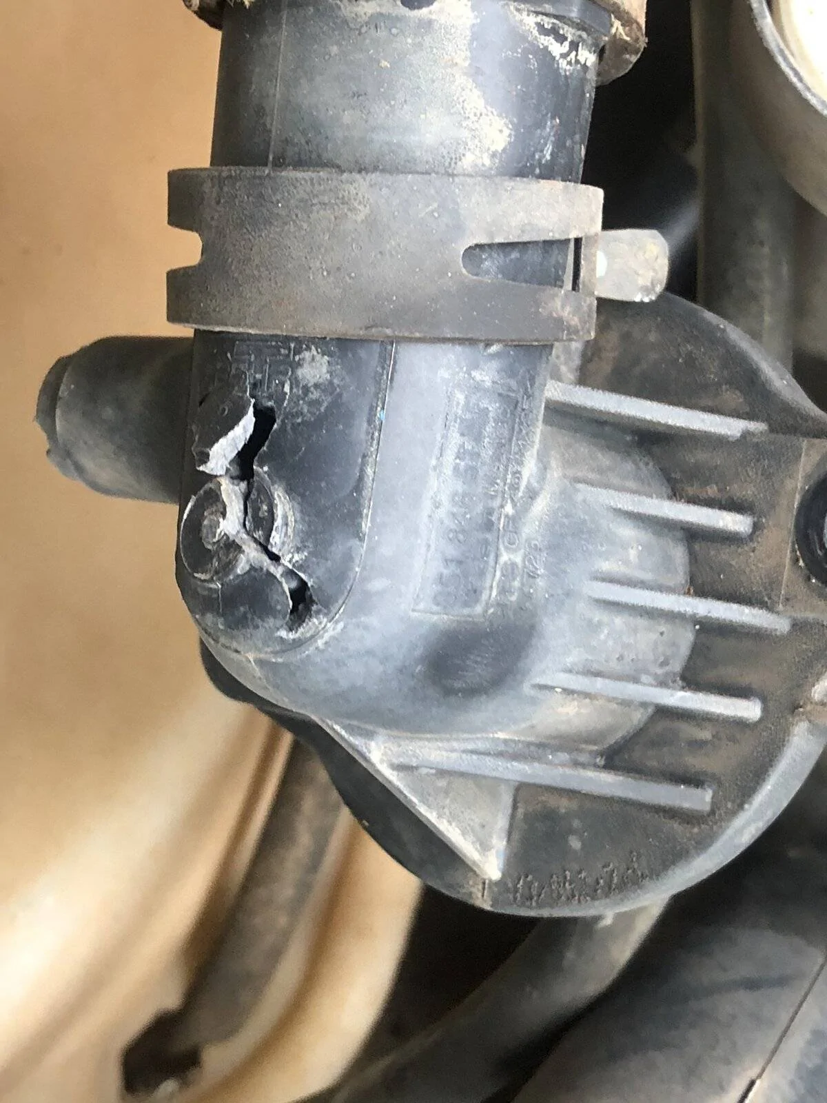

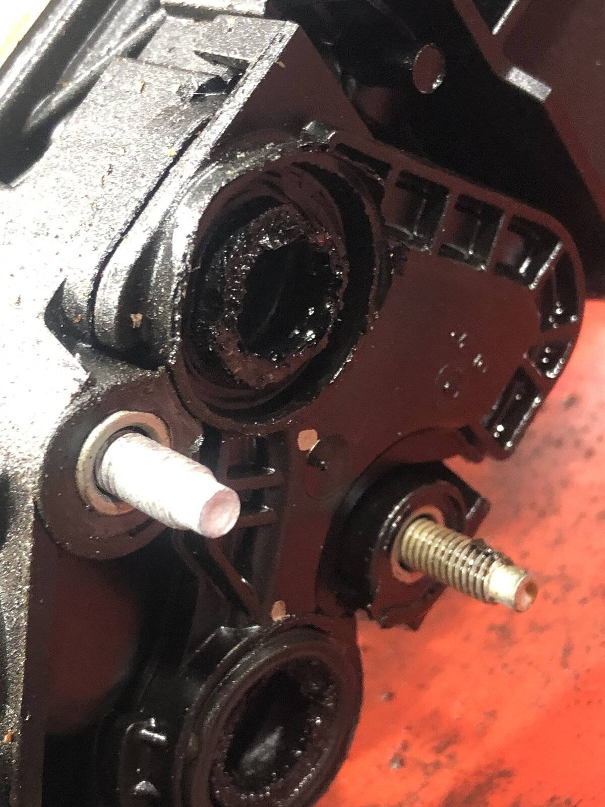

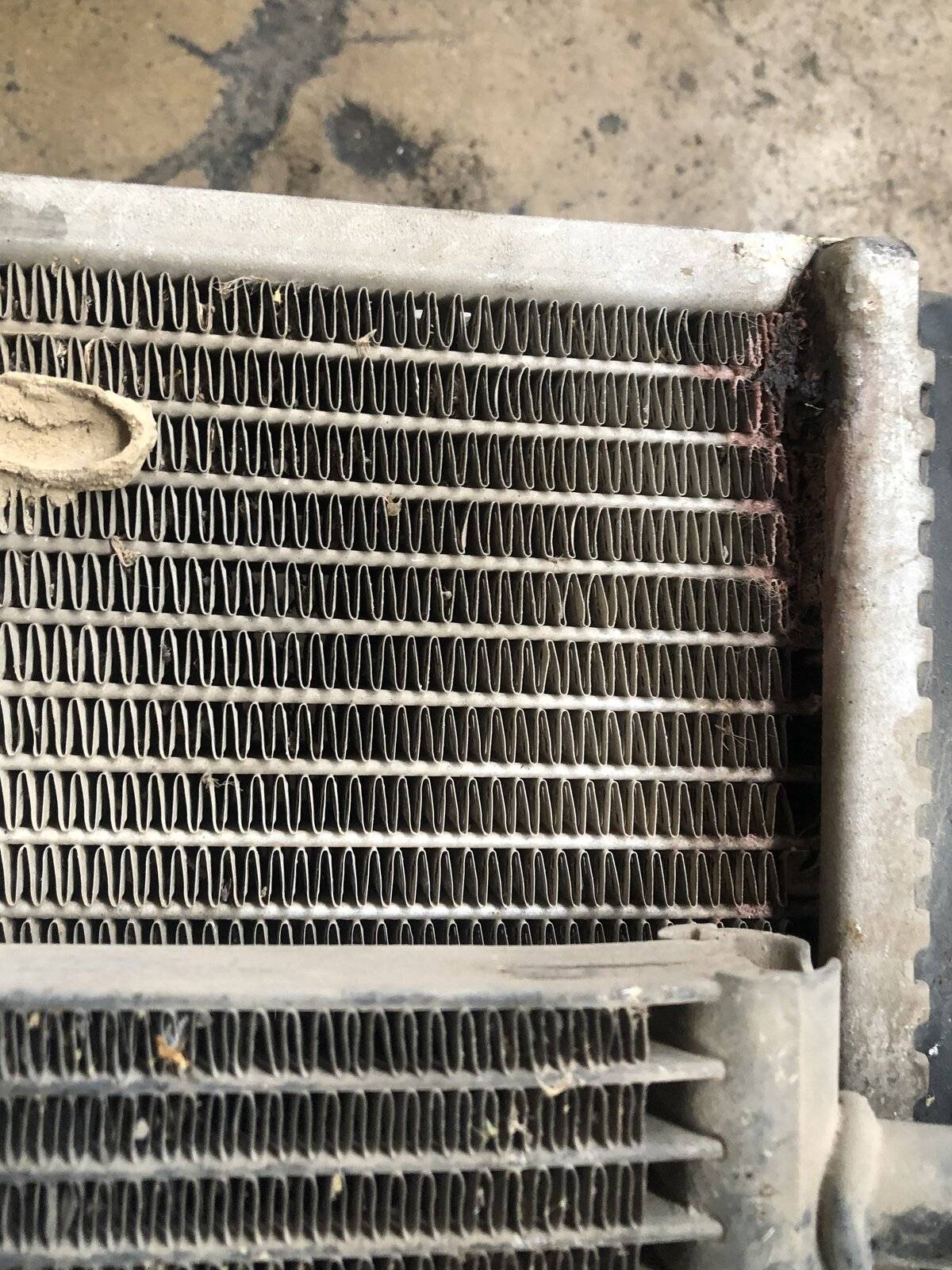

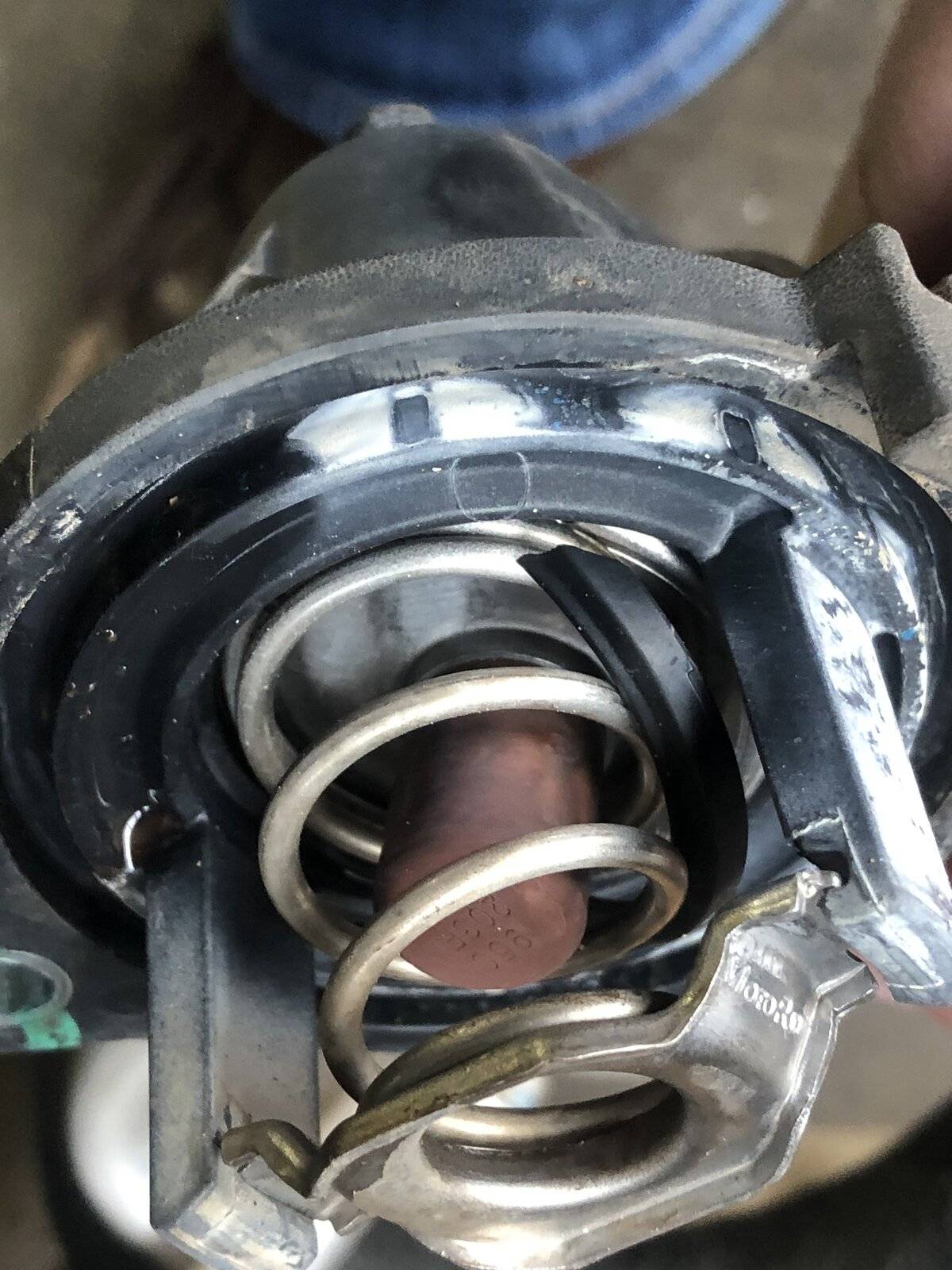

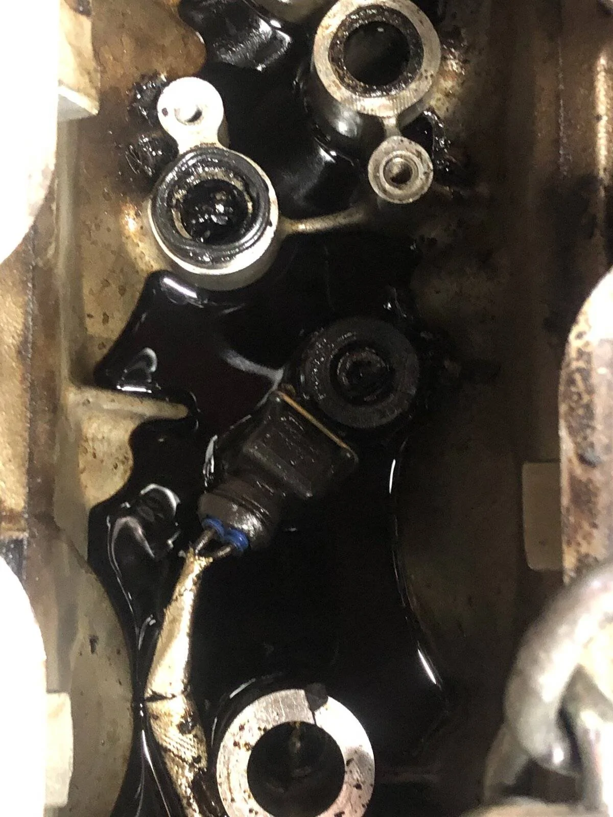

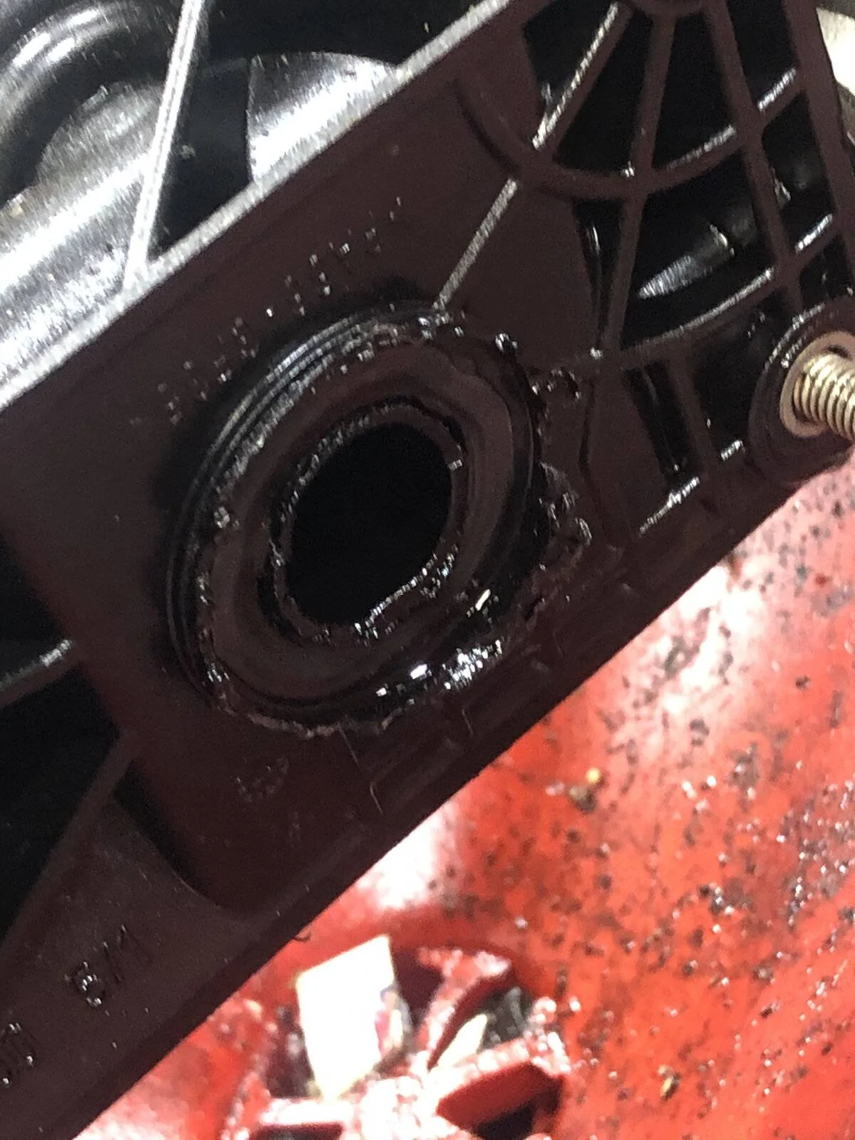

I have a series of photos coming up for a 2015 JK that completely burned out the engine, a young girl owned it. I tell you, it got so hot the oil cooler partially melted.

What started as a small radiator leak over time turned into a major engine failure. Excessively high temp resulted in overexpansion of the thermostat, blowing out the back of its plastic housing. This is not the first time I’ve seen this happen.
What surprised me was the melting oil cooler. The engine then pumped all of its own oil out in a matter of seconds.
Plastic parts are the worst 'advancement' of the modern engine.
I have seen plastic cooling parts fail across all makes. It doesn't matter how good the engine is if a $20 plastic pipe fails.
