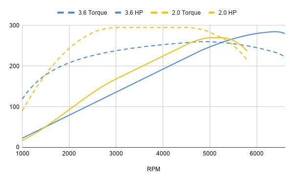

The power characteristics of the two motors are an important difference:
If you care about HP
Are you trying to start a riot with a question like that?!
Seriously though, the 2.0 will recommend premium fuel with or without e-torque. You don't have to run premium.
As a former engineer, I love the chart. Can’t argue with the numbers. I owned a 2017 JK 3.6L and now own a 2.0L JL. I see a noticeable increase in torque with the 2.0L, although I understand it’s an apples /oranges comparison, as the JK and JL are on different platforms (eg, different transmissions, etc.). Some folks have had issues with the 2.0 L at altitude, but that hasn’t been my experience (Moab and Ouray). I think the 2.0 L is markedly better, in my humble opinion.
