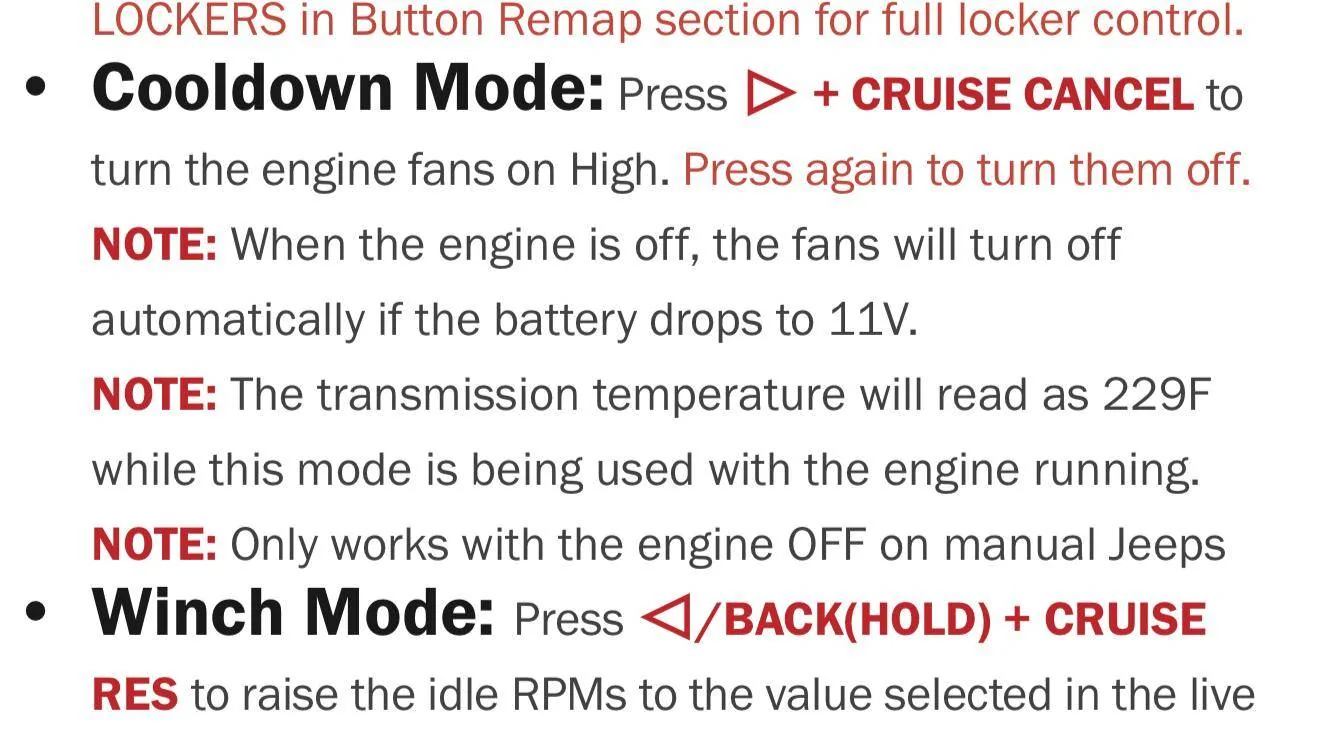

I don't let my Jeep idle excessively, but I do let it idle till the oil is at or over 100 degrees. On trails I actually turn my A/C on if it's hot out. Not for me, but for the Jeep. That makes the fan go full blast and it helps keep the oil/coolant temps low. I actually just ordered the gen 3 940 watt fan for my Jeep. That should make a difference with temps. Anyway, isn't this like the 4th thread this month starting the same oil argument?
A lot easier to use the cooldown function I the tazer than wait for the Jeep logic to kick the fan on.

Is there a setting on the tazer to let the fans kick on earlier while driving? or just on shut down.

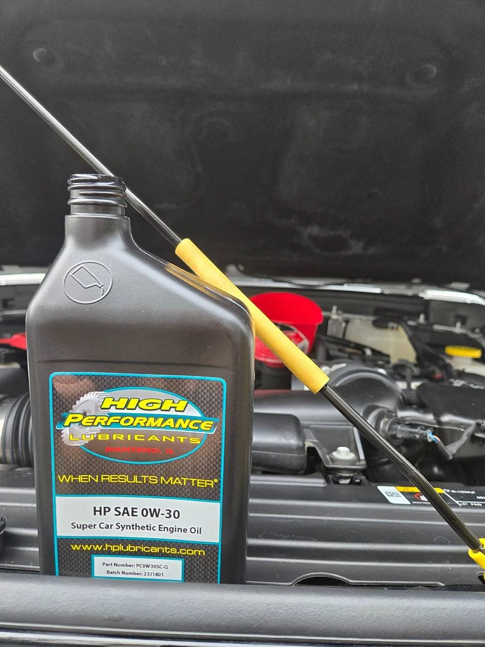

I am using HPL Super Car 0w30 that has 1,200 ppm Zinc and is so thick for a 0w30, it is 12 at 100 degrees.. It also has a TBN of a whopping 17.5
