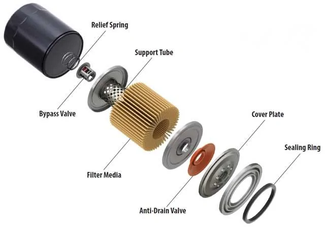

I had the same problem with 3.6 bone chilling rattle rattle on cold starts and I was stunned to see on my first oil change that the oil filter housing was completely void of oil and the filter did not even have oil dripping off of it.
I discovered the Baxter oil filter adapter was not convinced until my local 4x4 shop said he had installed dozens of them so I gave it a try.
I now have Baxter on both my jeep and no more bone chilling rattle rattle.
This is common scene. With the Baxter you now have two anti drain back valves.
No more draining back of the filter and oil cooler housing.

The reason for the "dry filter" is the return to crank case tube, the one sealed by the o-ring I talk in my previous post that I suspect is turning bad allowing oil to go to crank case instead of the oil galley. Since your was point bad i think you may have something else on that 3.6
