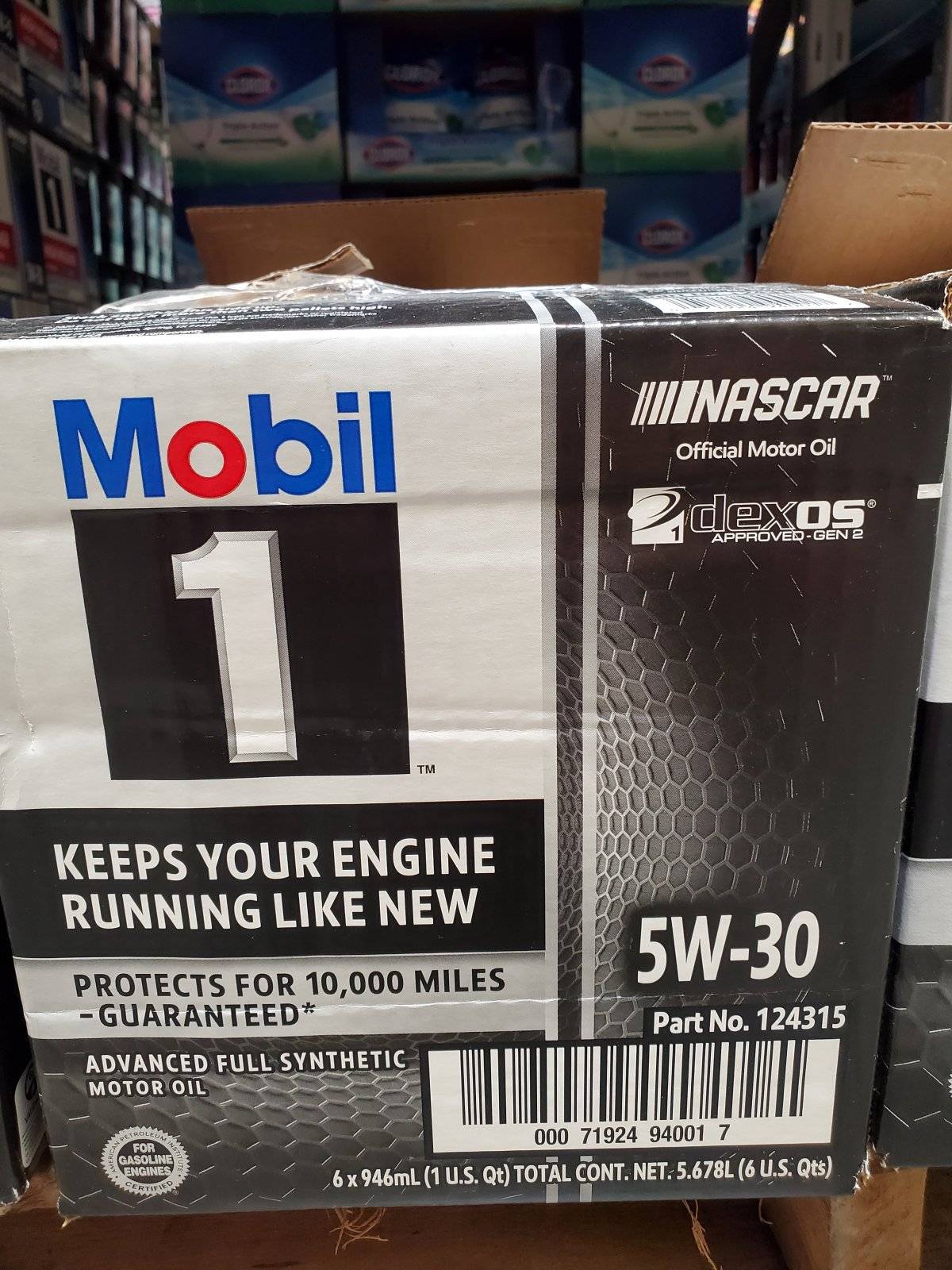

I have a JLUR 3.6, about 44k miles and this will be my first time doing an oil change myself. Is this the correct weight? And decent kind of oil? It's also on sale. How many courts oil does it take? Thanks
It is all in the manual.
0W-20
5 quarts
@Intropy is right. 0w20. Here is what I'm running right now....
Jeep Wrangler JL 3.6 l Engine Oil Type 1616273193413
If you like Mobil 1, there is also Truck & SUV 0w20 and Mobil 1 Extended Performance 0w20. Any flavor will do. The EP is the hghest performing version, but all are outstanding.
