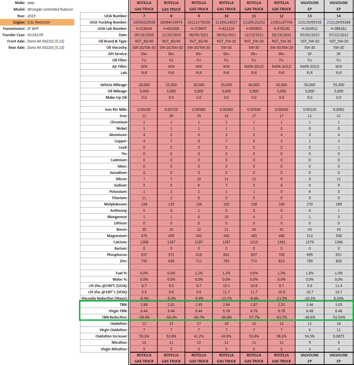

I have UOA'ed every fluid change in my JLUR and can say that for the 3.6L, I chose 5K OCIs because the TBN (total base number--which measures an oil's ability to neutralize acids) is typically in the 2.x range at 5K miles, though I recently switched to Valvoline Extended Protection, its TBN was in the 3.x range.
While TBN depletion is not linear, neither Rotella or Valvoline would make 10K and likely not 7K without being depleted. You would need to look into a longer drain oil such as Pennzoil Ultra Platinum, Mobil 1 Extended Performance, Castrol Edge Extended Performance, or the like for a 10K OCI. You would need an oil that starts with a fairly high TBN (10 or better) to "blindly" run to 10K, but I would still want to know what the TBN measured after 10K to know how much cushion I had.
Jeep Wrangler JL 3.6 l Engine Oil Type UOa7Ia

Pennzoil platinum or ultra does not advertise as an extended drain oil

Yeah, I know, but Ultra Platinum's TBN is above 10 (or was the last time I checked) so labeled or not, it would make a 10K OCI.

Terrific series data, I'm wondering about the spike in Iron on #14 with Valvoline EP. I run this in 0W-20 form on both my JLU (20K miles on odo) and Toyota RAV4, haven't pulled an oil sample for analysis but now I'm thinking I should.
Did your usage conditions change during that May-July interval to account for the nearly 3x iron?

The same thing happened on the second UOA of Rotella Gas Truck and I attribute it to the change in additive packs between the different oils. Since it returned to "normal" on the third and thereafter, it was nothing of concern.

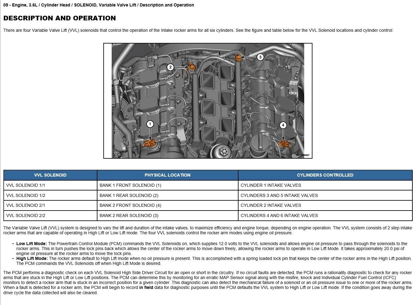

It seems I've seen some reference to using 5w-30 instead of 0w-20 (which the mfg calls for), in these latest PUG 3.6L's.
Please correct me if I'm wrong, but don't these engines utilize oil pressure in the actuation of the VVT or VVL systems?
And if so, would using an oil viscosity other than what the mfg calls for, impact the function of these systems?
Maybe I'm wrong on the use of oil pressure in the operation of these engine systems.
I remember my Ram 5.7 Hemi was sensitive to oil viscosity for the MDS (multiple displacement system).
Thoughts? ?
Thanks!

Looking in my 18 service manual, I found the variable valve lift description, but couldn't find anything on variable valve timing, although there are cam phasers that seem to provide variable timing. I don't know if I just can't locate it or they omitted it. But it sure looks like variable timing is incorporated as well as variable lift.
Jeep Wrangler JL 3.6 l Engine Oil Type vari valve lift
