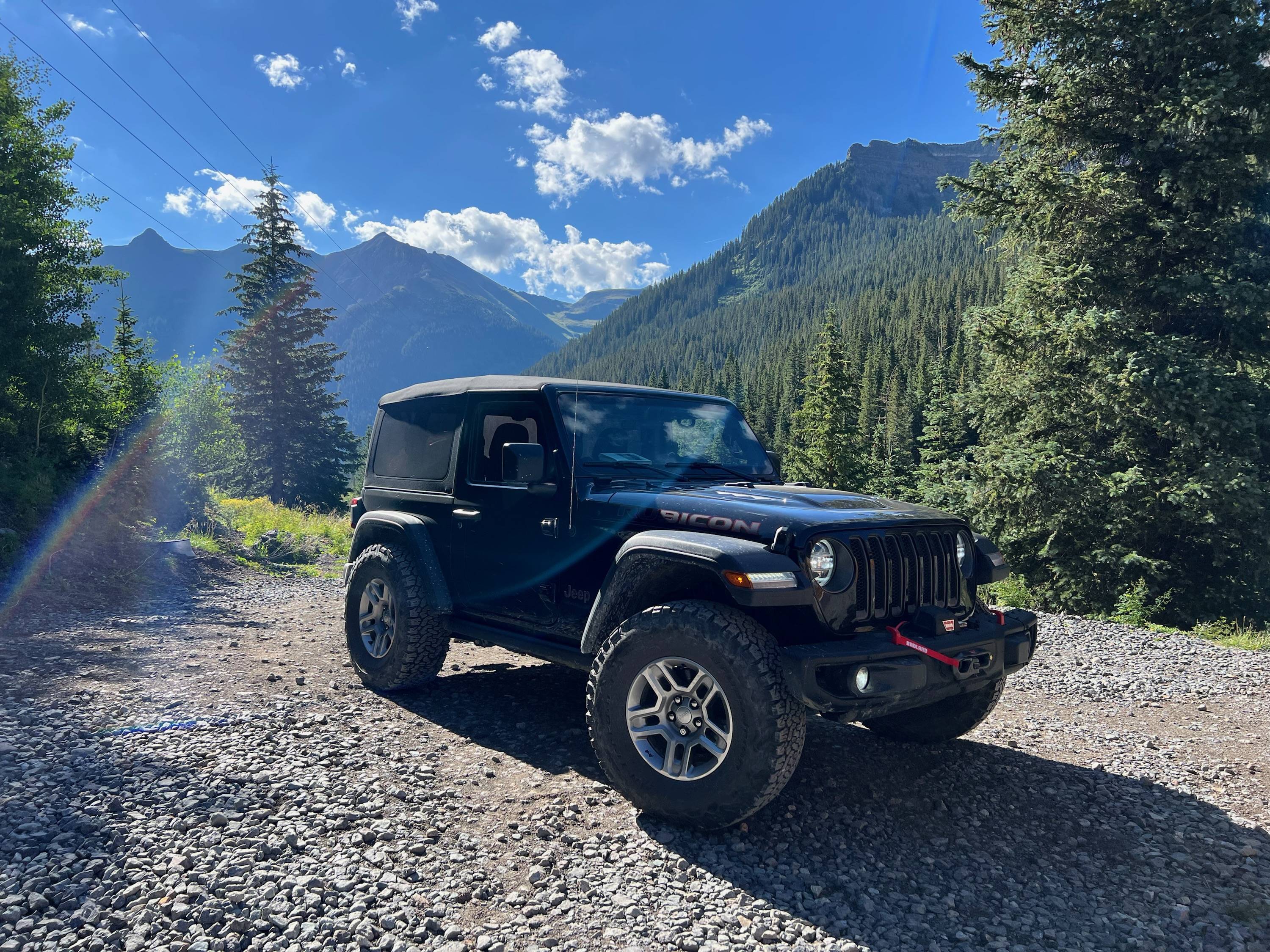

Here's another vote for the relatively lightweight, C-rated BFG K02 315s. They've been great on my (essentially) stock 2.0t JLR... comfortable on the highway and capable on a variety of trails. Next step for me will be a small lift so I can handle the tougher obstacles and ledges that often appear/develop on the "easy" trails.

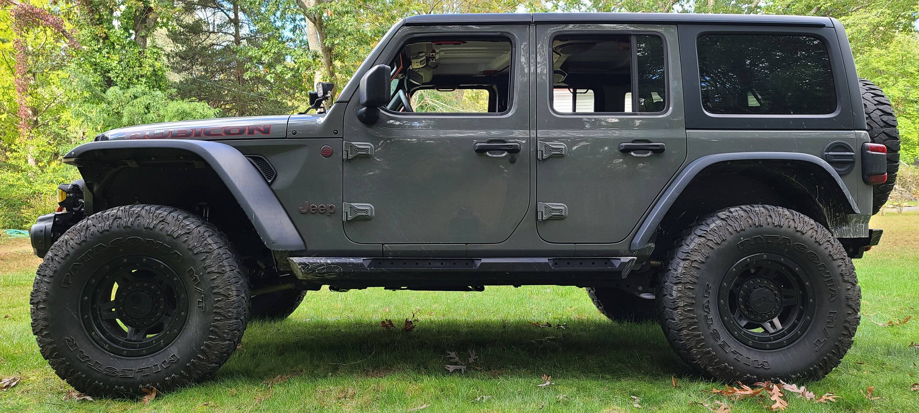

I drove my 2.0 JLUR for over 50k miles on 38x13.5's, and it was far from a dog. It didn't start growing a tail until I swapped to 40x13.5's.
Jeep Wrangler JL 2dr Rubicon tire question 20211013_132632
Plus, the OP has the added advantage of a lighter 2 door, on top of the torque advantage of the 2.0 engine.
