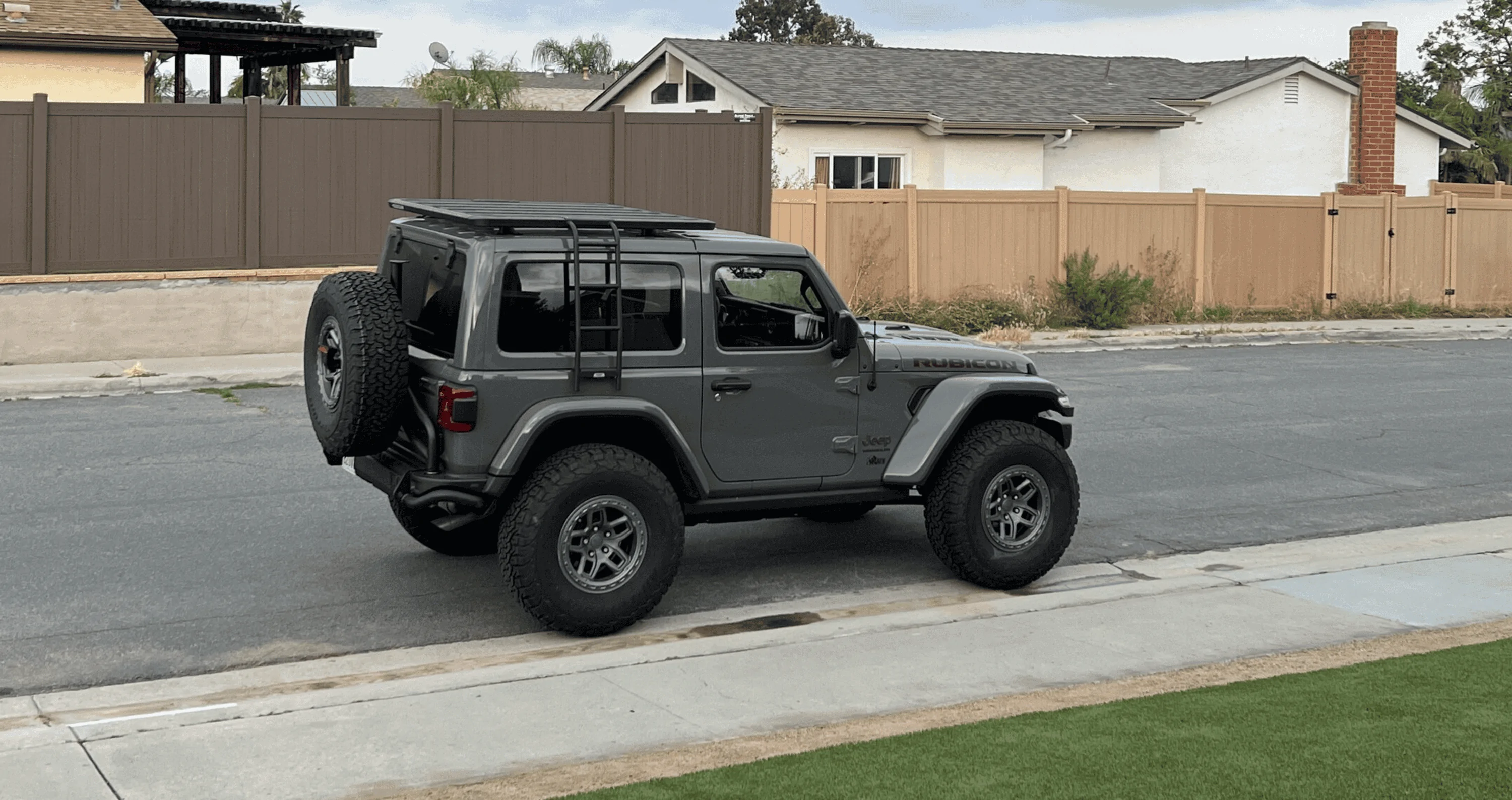

Ran the exact set up you are asking about; 37 inch BFG load C's with a 1.5 lift. They, in my opinion, didn't bog the ride down and I have the 3.6L too. With the torque the 2.0t has you will be more than fine it seems. My MPG did take a small hit but that was expected ?

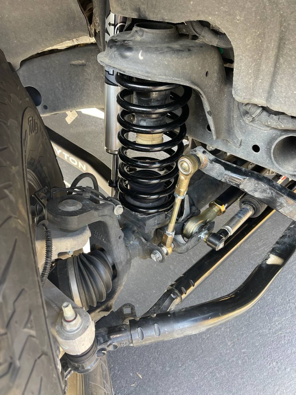

I’m tickled pink… whatever that means. The lift netted about 2in (as advertised by Clayton) and I haven’t seen any appreciable additional mpg loss after going to 315s. Got my RoadMaster Exact Center steering stabilizer dialed in and I absolutely love the ride.
I have to mention I added Artec aluminum belly skids at the same time as the lift so maybe that helped the aerodynamics?
Also will add that I went with Fox 2.0 shocks with the Clayton 1.5in Overland+ lift. Have to say it is the sweet spot for me handling on/off roading with my 2dr Rubi.
