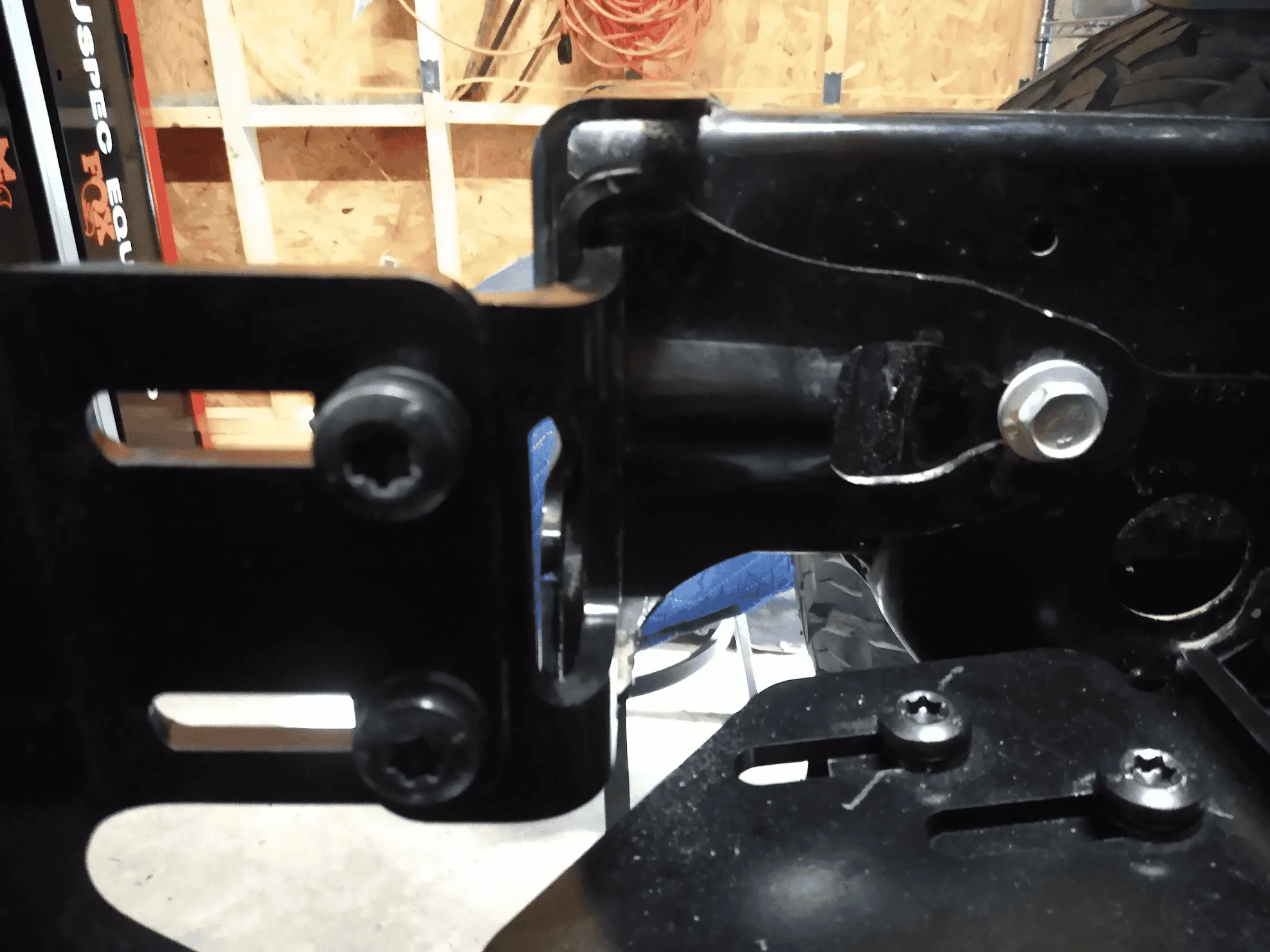

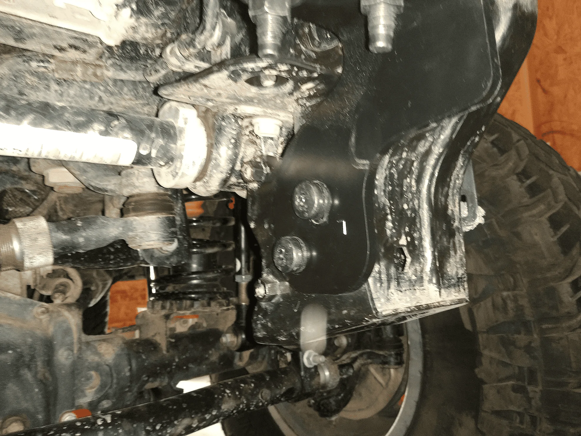

Winch install inching along - I'm only working like an hour in the evenings after work to get things moved along. Winch plate went in Monday evening:
Jeep Wrangler JL '22 JLR 2.0T build progress/wheeling thread 1683115482718
It's the Mopar winch plate. Generally I find the aftermarket to have a better package than the Mopar kits, but in this case the big selling point was that it mounts behind the bumper plate for the front support as opposed to in front of the bumper plate like the Warn plate:
Jeep Wrangler JL '22 JLR 2.0T build progress/wheeling thread 1683115581157

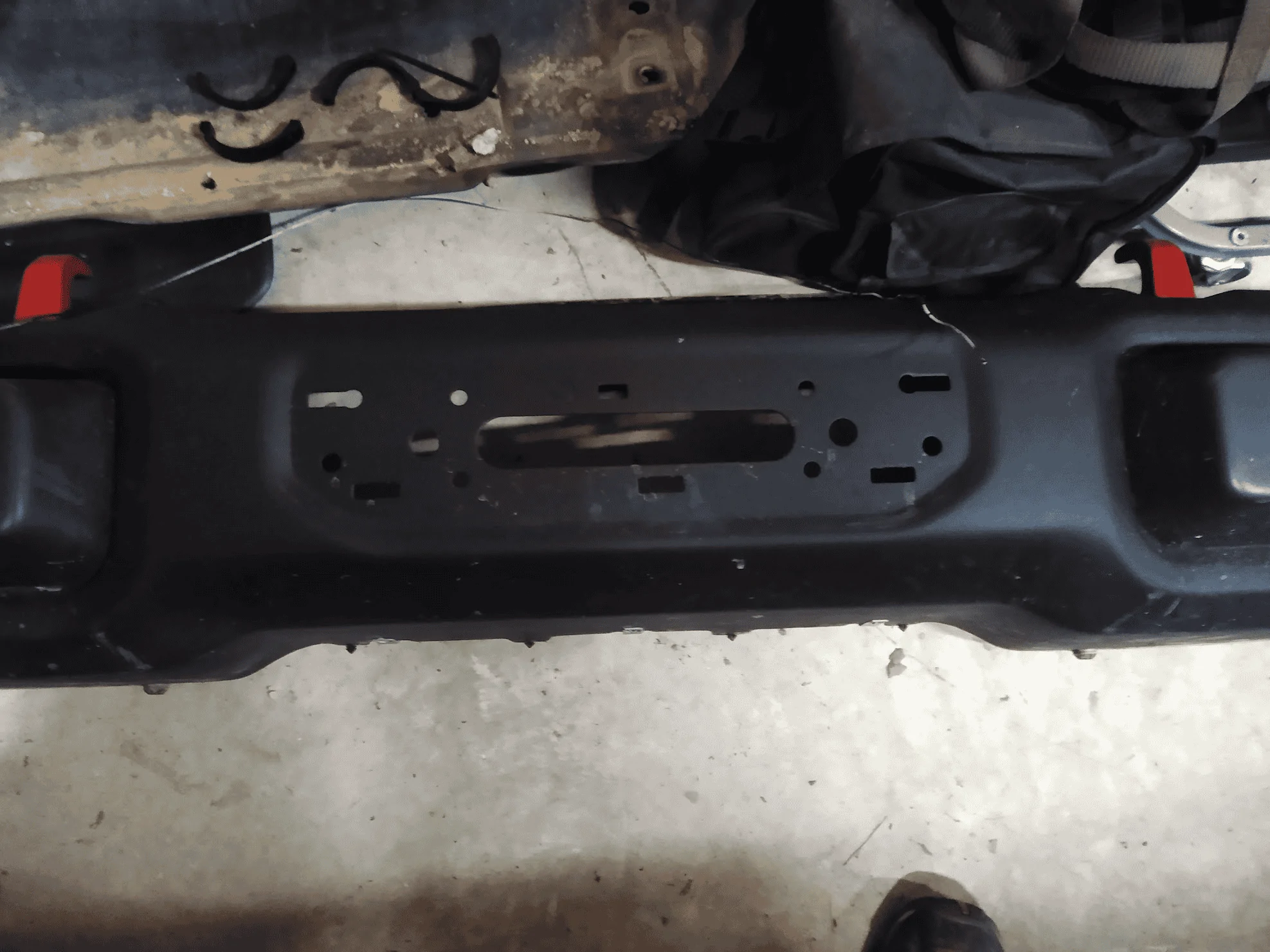

The Rubicon bumper already sticks out far enough, I wanted to keep it from adding any further length and this fit the bill. Excuse the blurry pic, but I also like that it attaches at the frame horn as well:

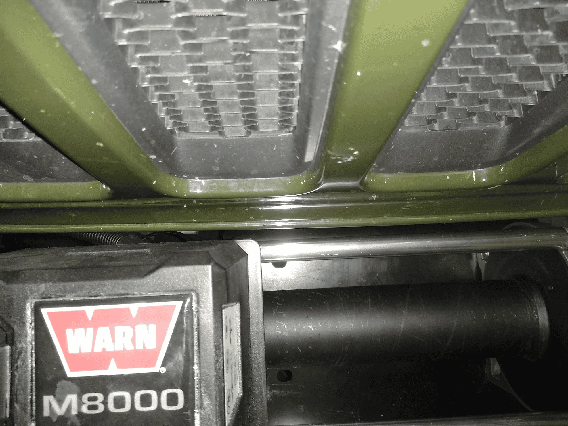

Came out pretty clean I think. M8000 has tons of room in the tray. I chose this winch specifically because it's still (ostensibly anyway) at least mostly US made, can be had under $1k, and is smaller and lighter than the Zeon series:

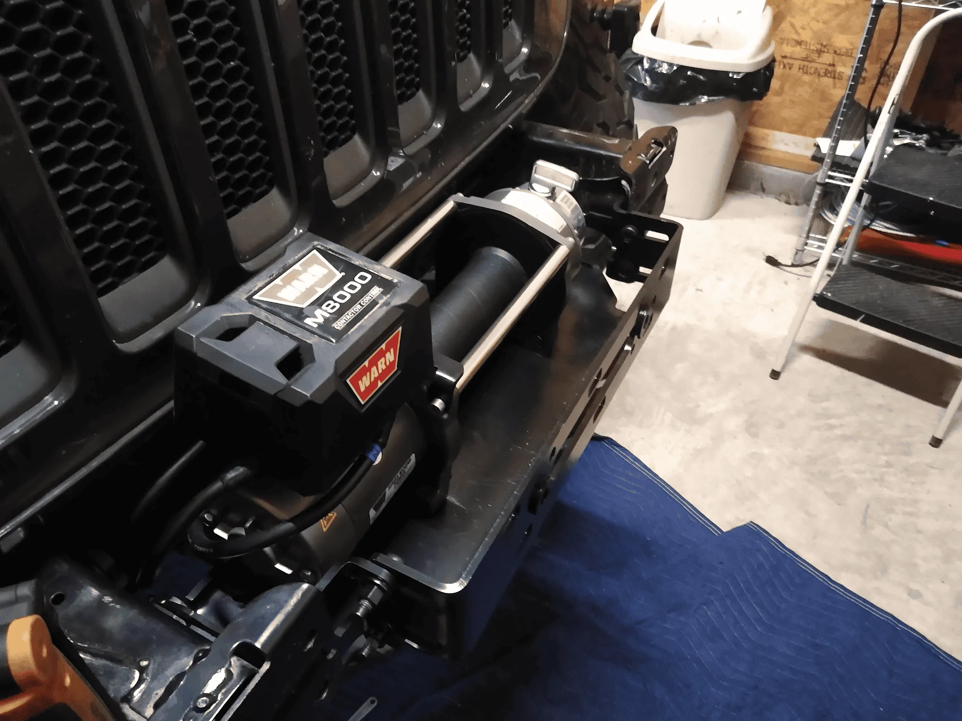

One thing to note, Mopar specs an off-center fairlead adapter for non-Zeon winches (i.e. M8000) - 2018-2023 Jeep Fairlead Adapter Plate for Off-Centered Winch 82215527AB | Mopar Estores. DO NOT buy this if you have a current production winch plate and Rubicon bumper. It doesn't work.
Jeep Wrangler JL '22 JLR 2.0T build progress/wheeling thread 1683116224695
Jeep Wrangler JL '22 JLR 2.0T build progress/wheeling thread 1683116240543
Fairlead holes don't line up, neither does the slot for the rope. With the current production winch plate you need the centered version: 2018-2023 Jeep Fairlead Adapter Plate For Centered Winch 82215528AB | Mopar Estores
The current winch plate has two sets of mounting holes, one set slightly offset, that allows the drum of an asymmetrical Warn winch with standard mounting pattern (i.e. M8000) to line up properly:
Jeep Wrangler JL '22 JLR 2.0T build progress/wheeling thread 1683116388085
Anyway, so that's it. She's coming along, just slowly. Waiting on the centered adapter plate to be delivered and then I can start stringing the Bubba Rope winch line on: 100-Foot Synthetic Winch Line • Bubba Recovery Gear (bubbarope.com). I opted to order the steel rope version of the M8000 as it was both cheaper and allowed me to choose my own synthetic line based on the features I like. The Bubba Rope hdas a nice end loop for a metal-free system, I dig it.

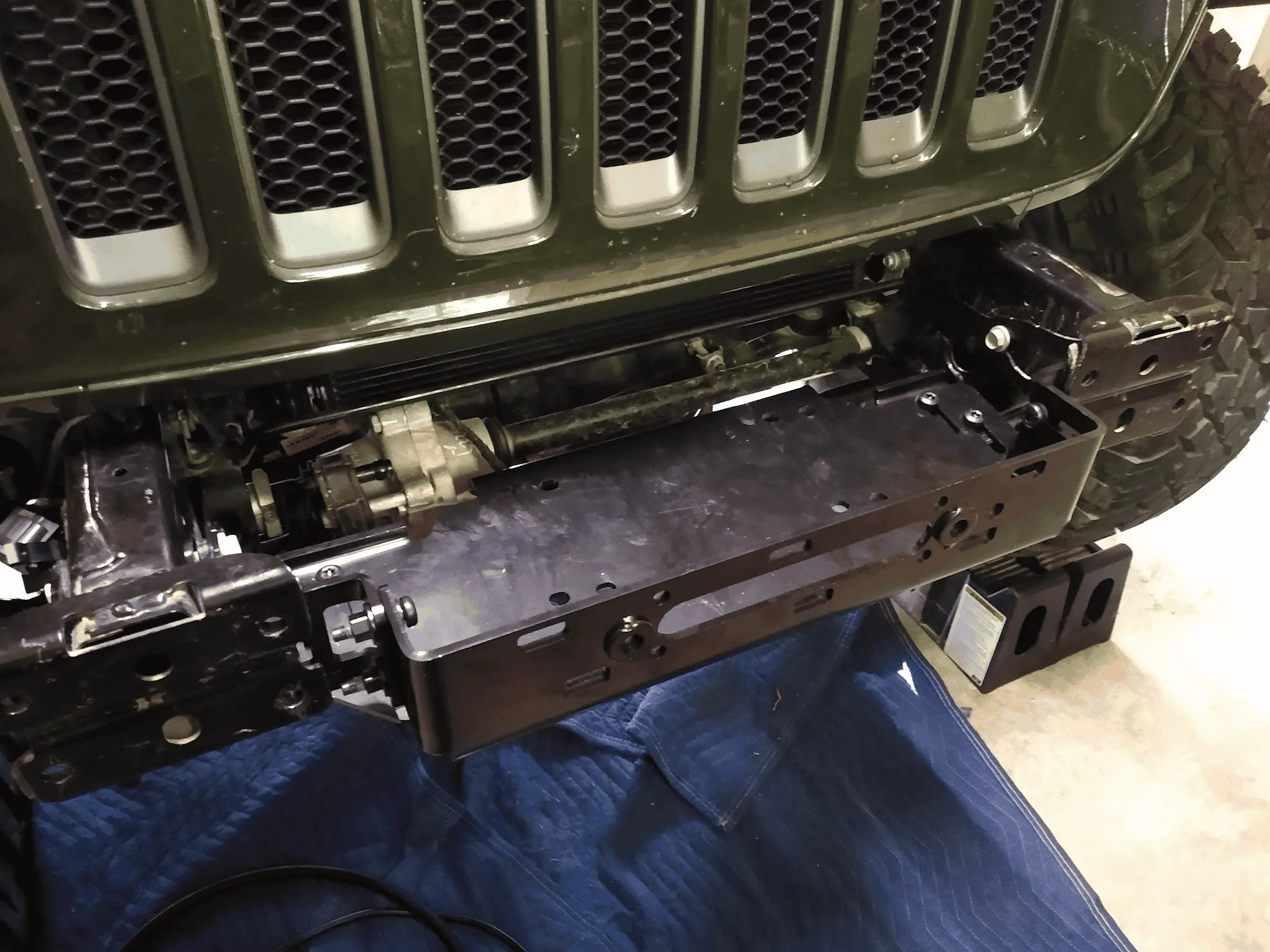

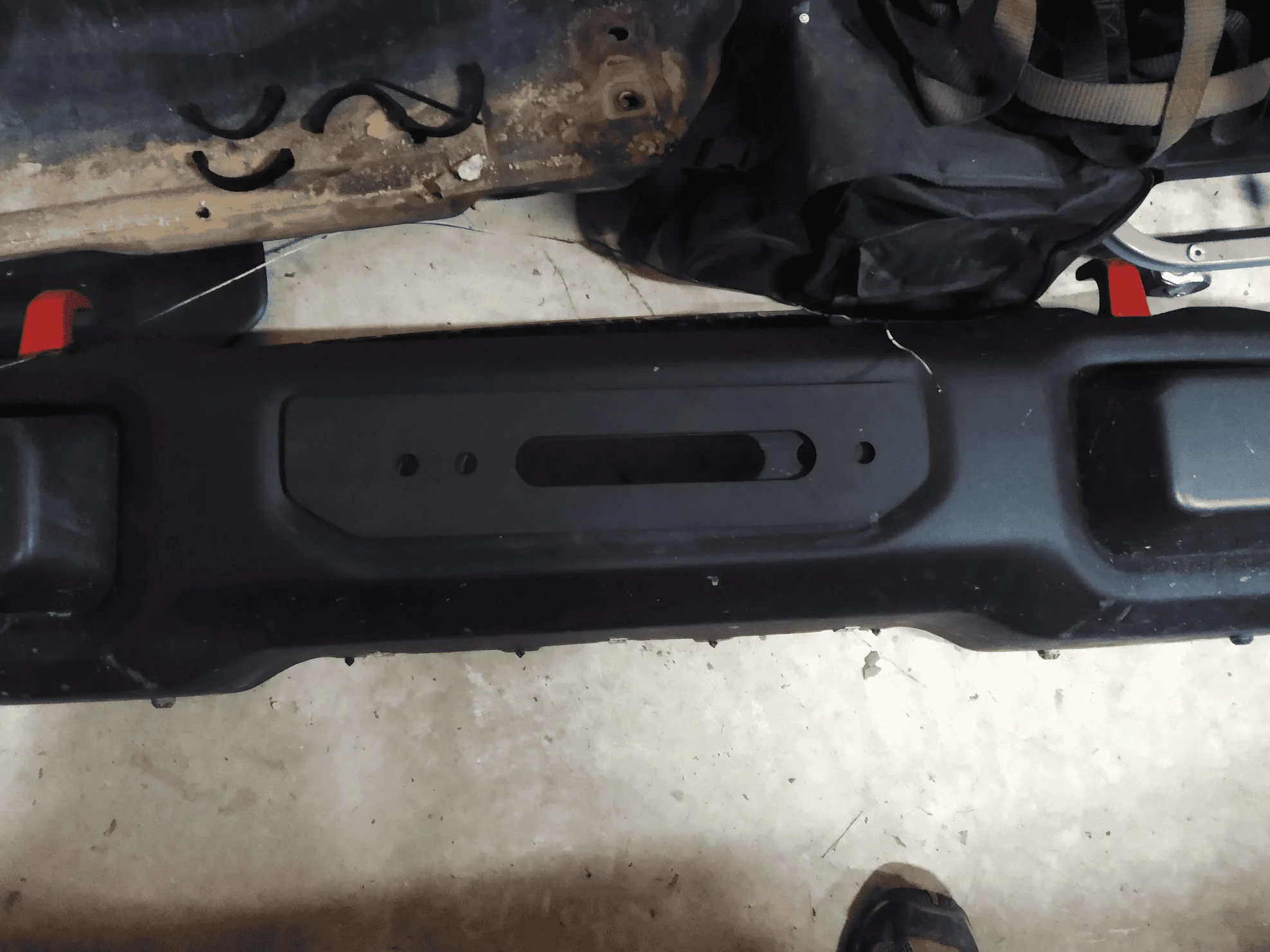

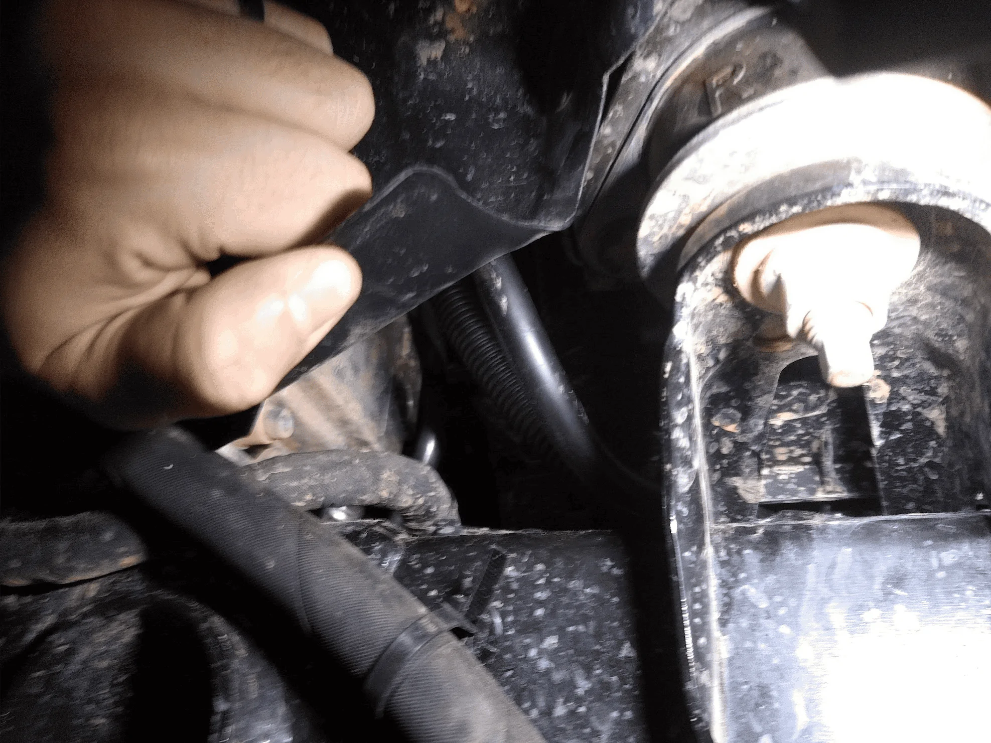

Anyway, got the winch loosely bolted in last night and power cables routed. For anyone else like me that struggles with cable management, I went along the inside of the passenger frame rail:

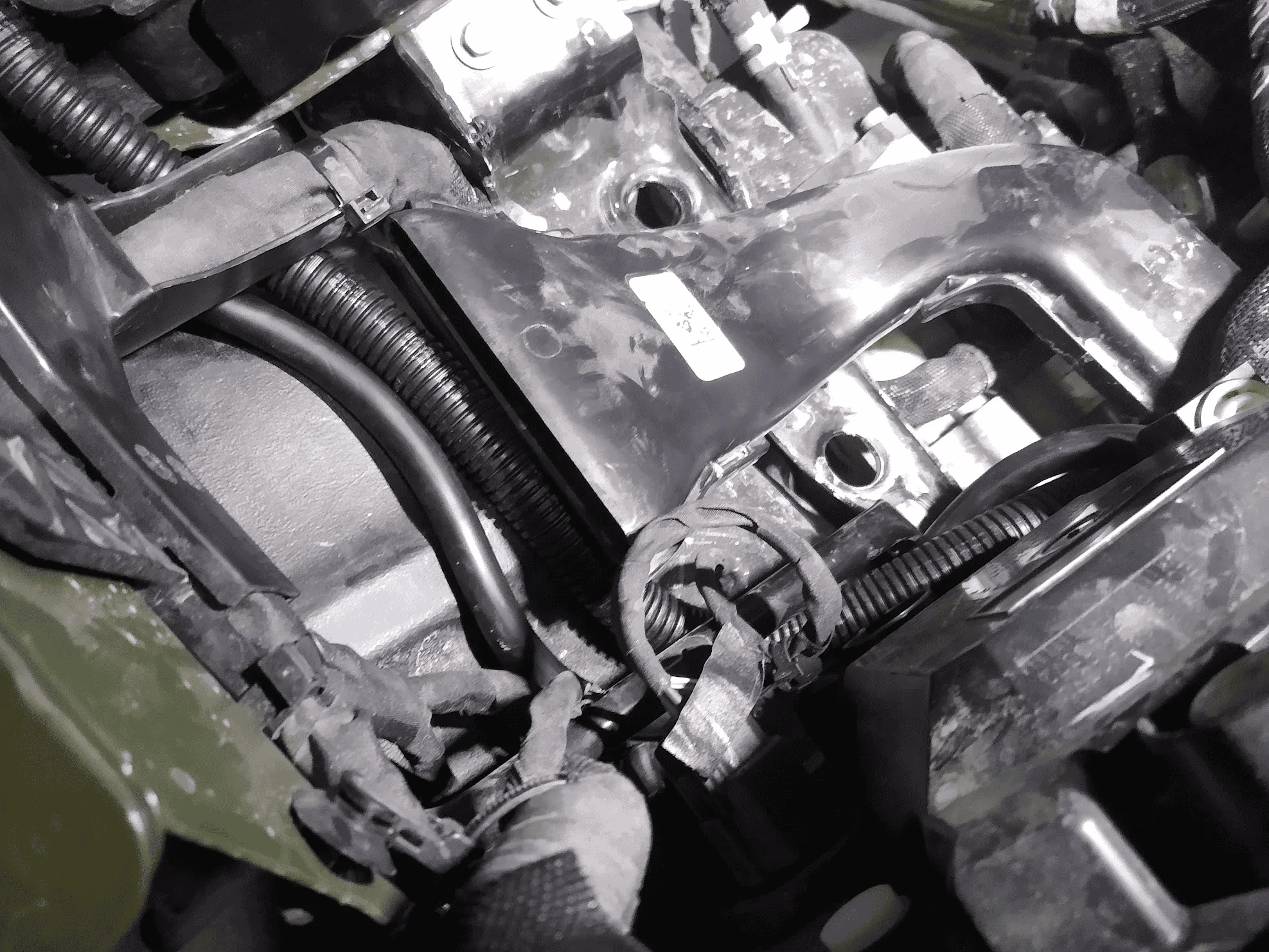

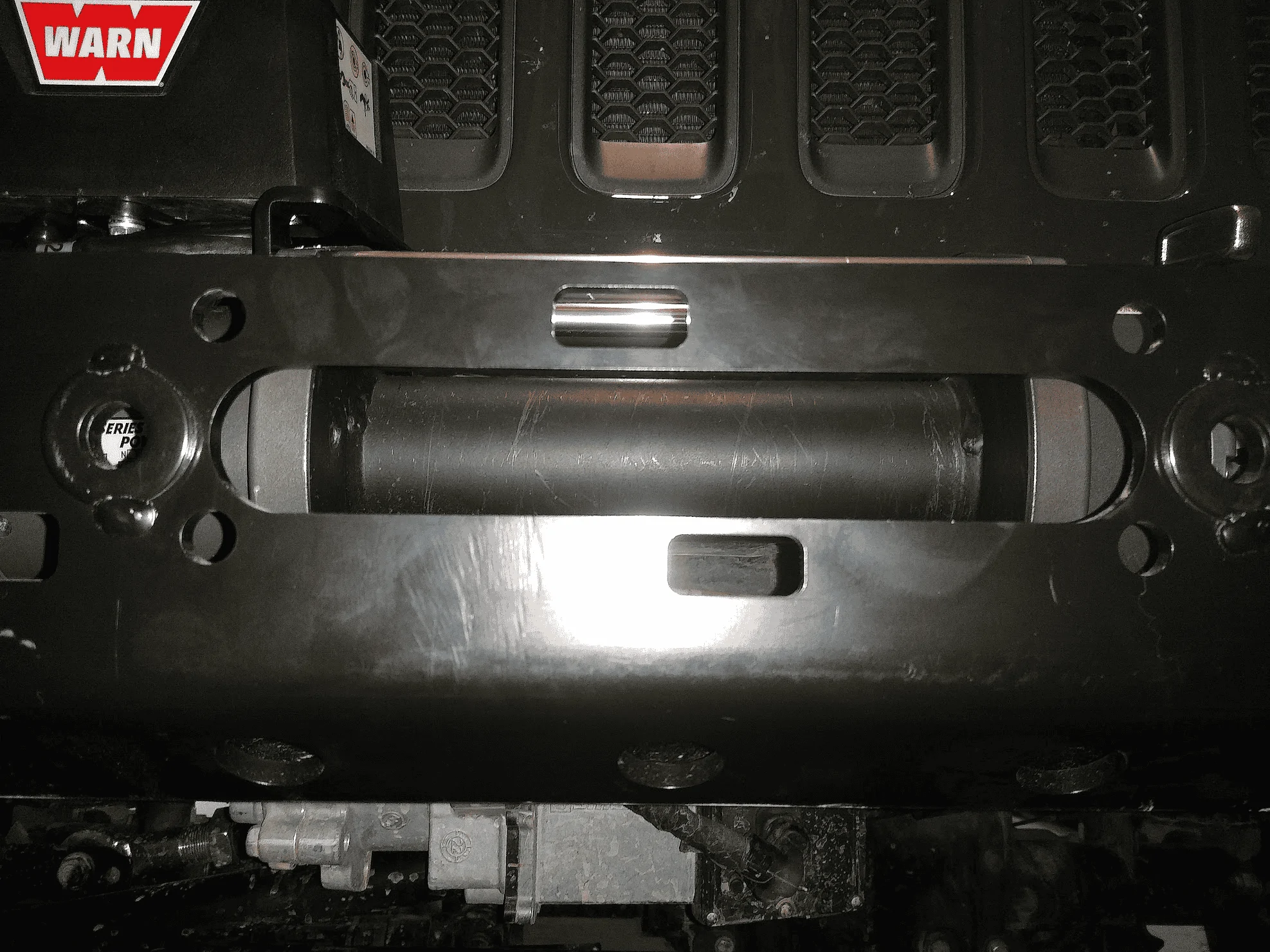

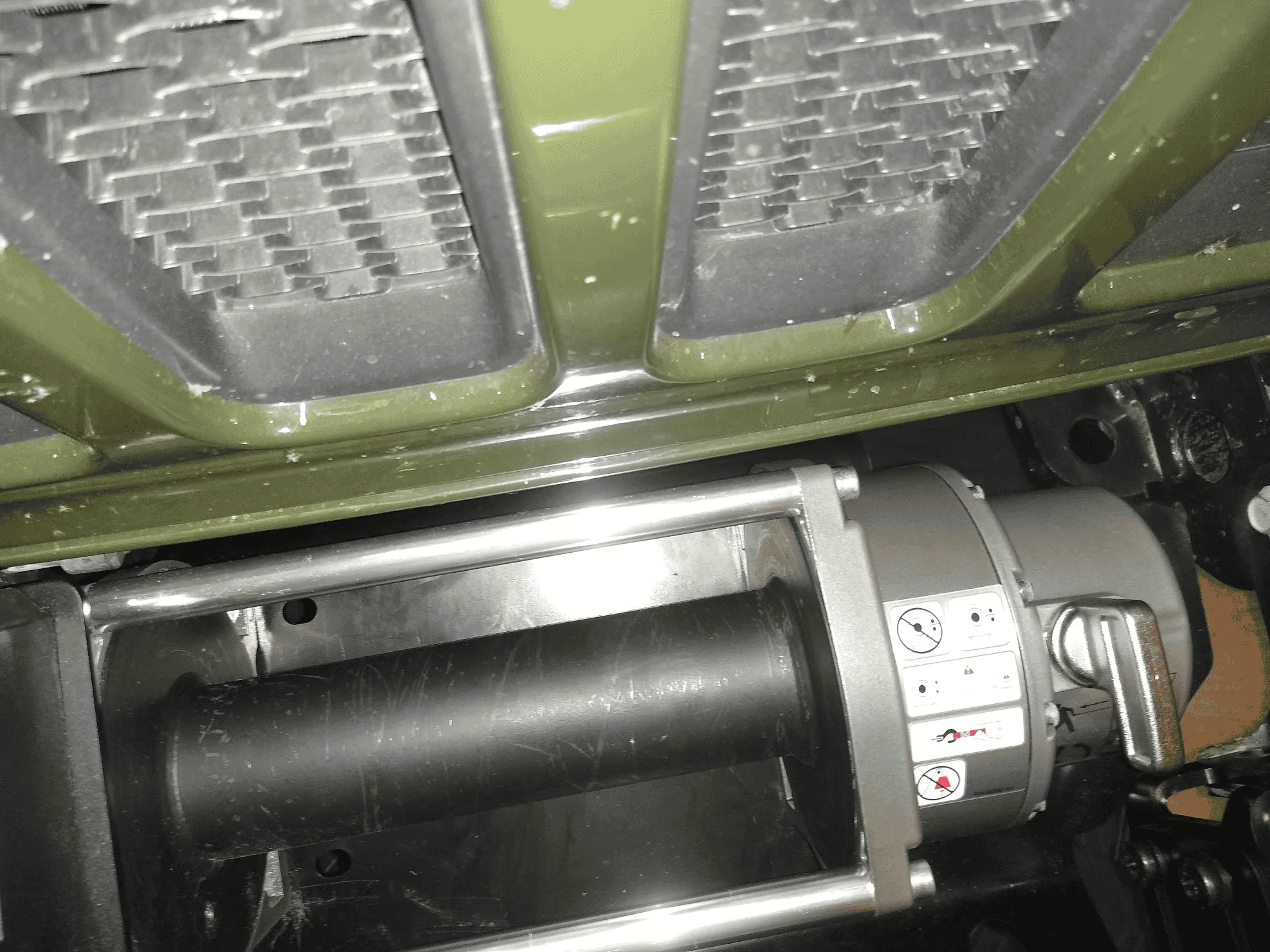

Up behind the fender:
Once up along the inside of the passenger headlight, I went under the fender brace bar, under the air intake tube along the top of the fender, and through the hole in the bracket behind the airbox (I did remove the airbox for this):
