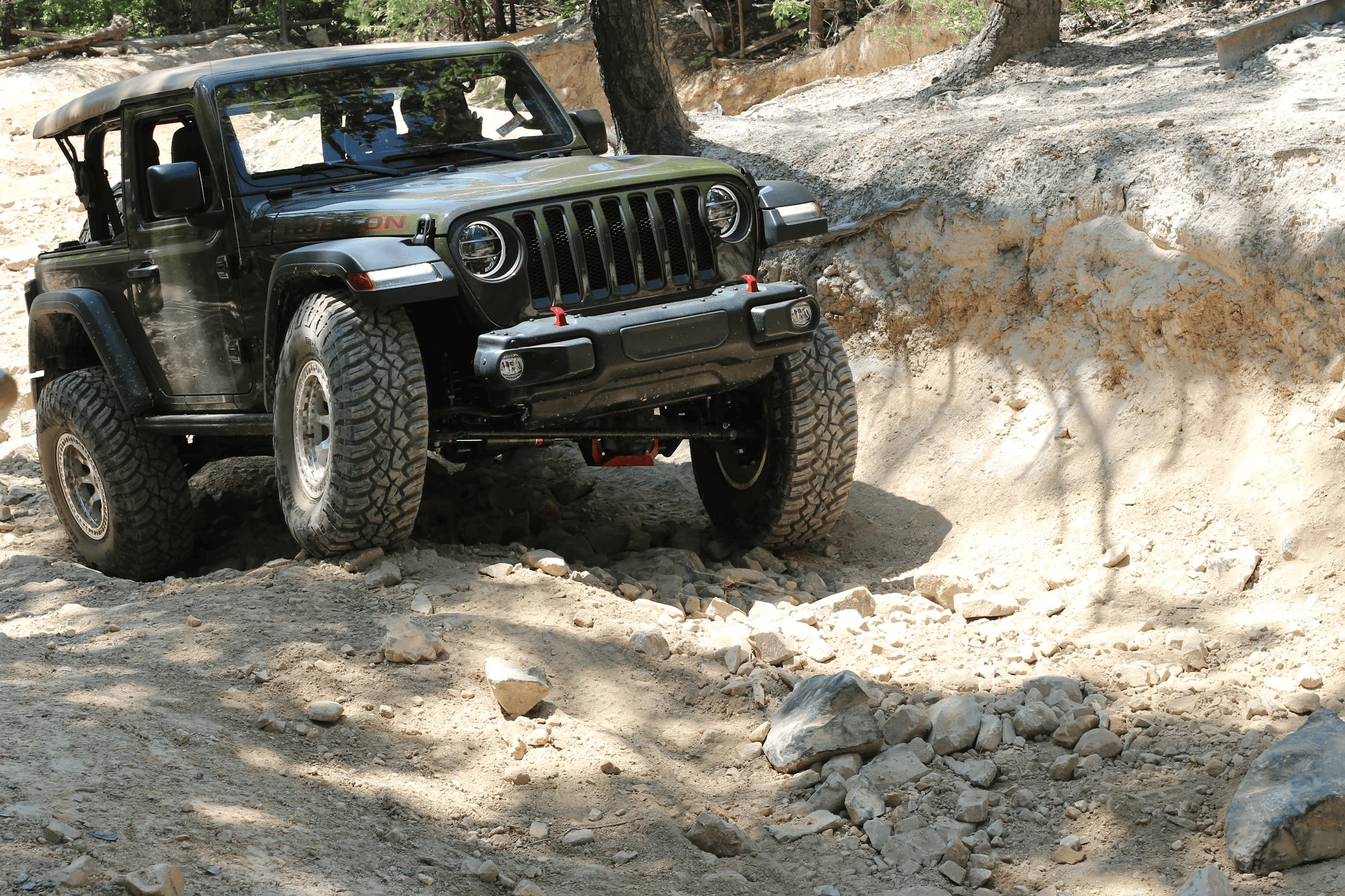

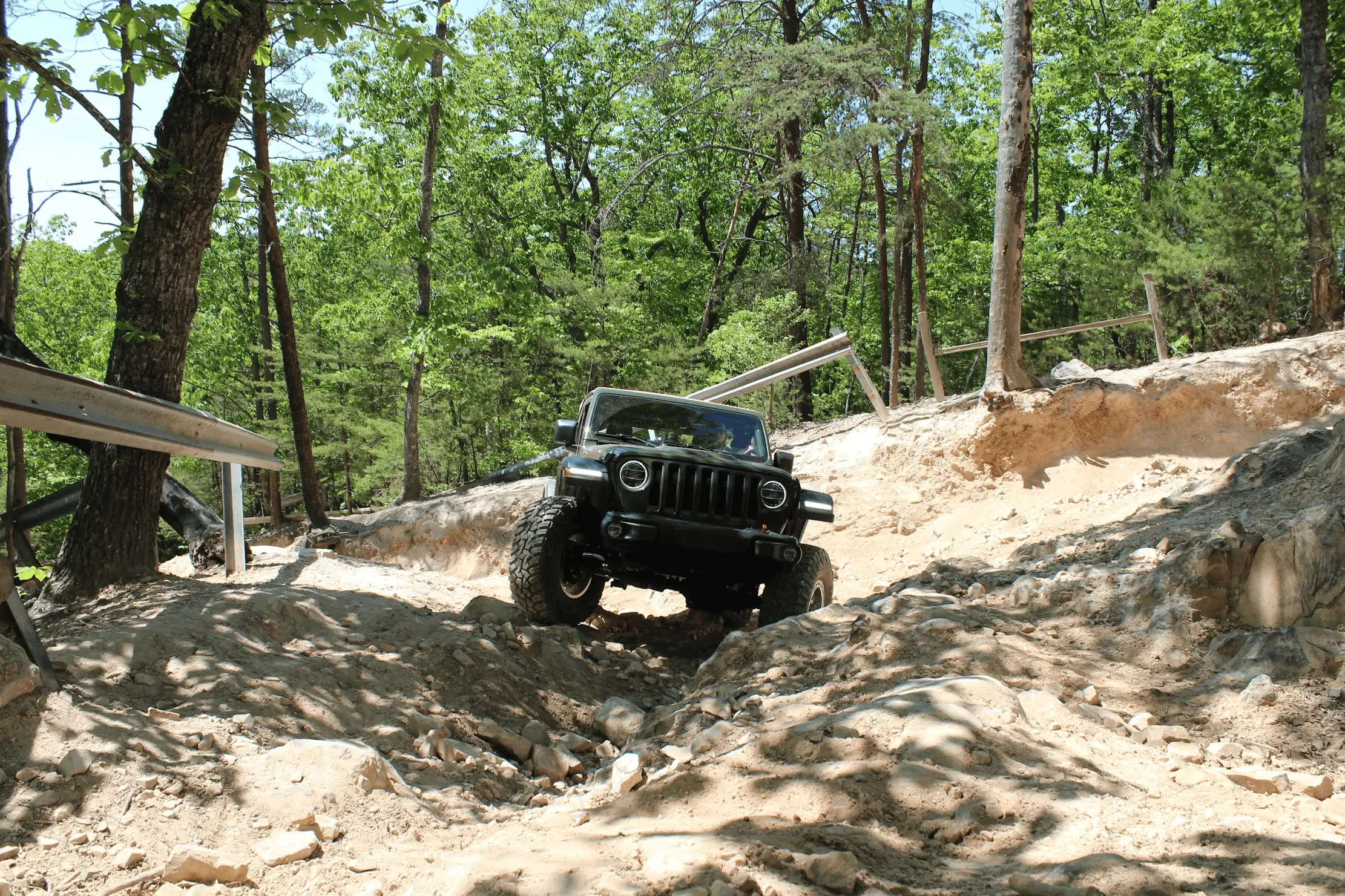

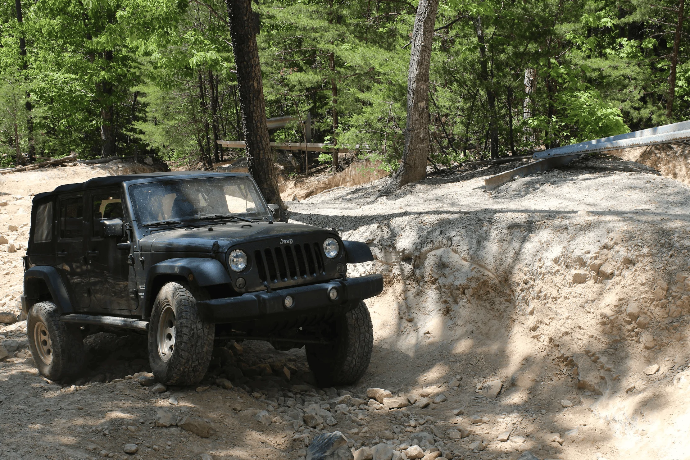

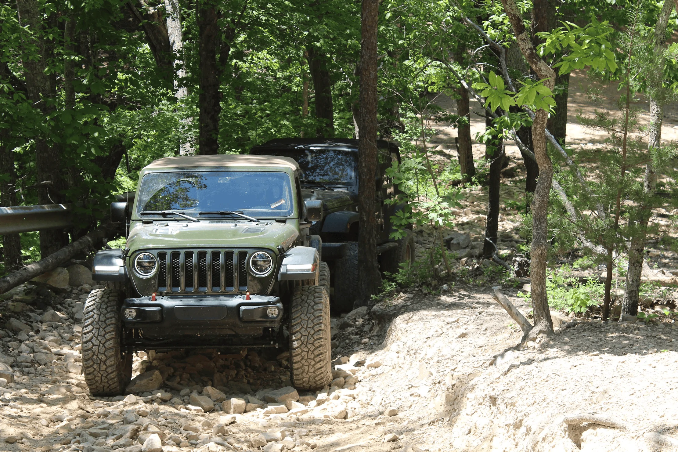

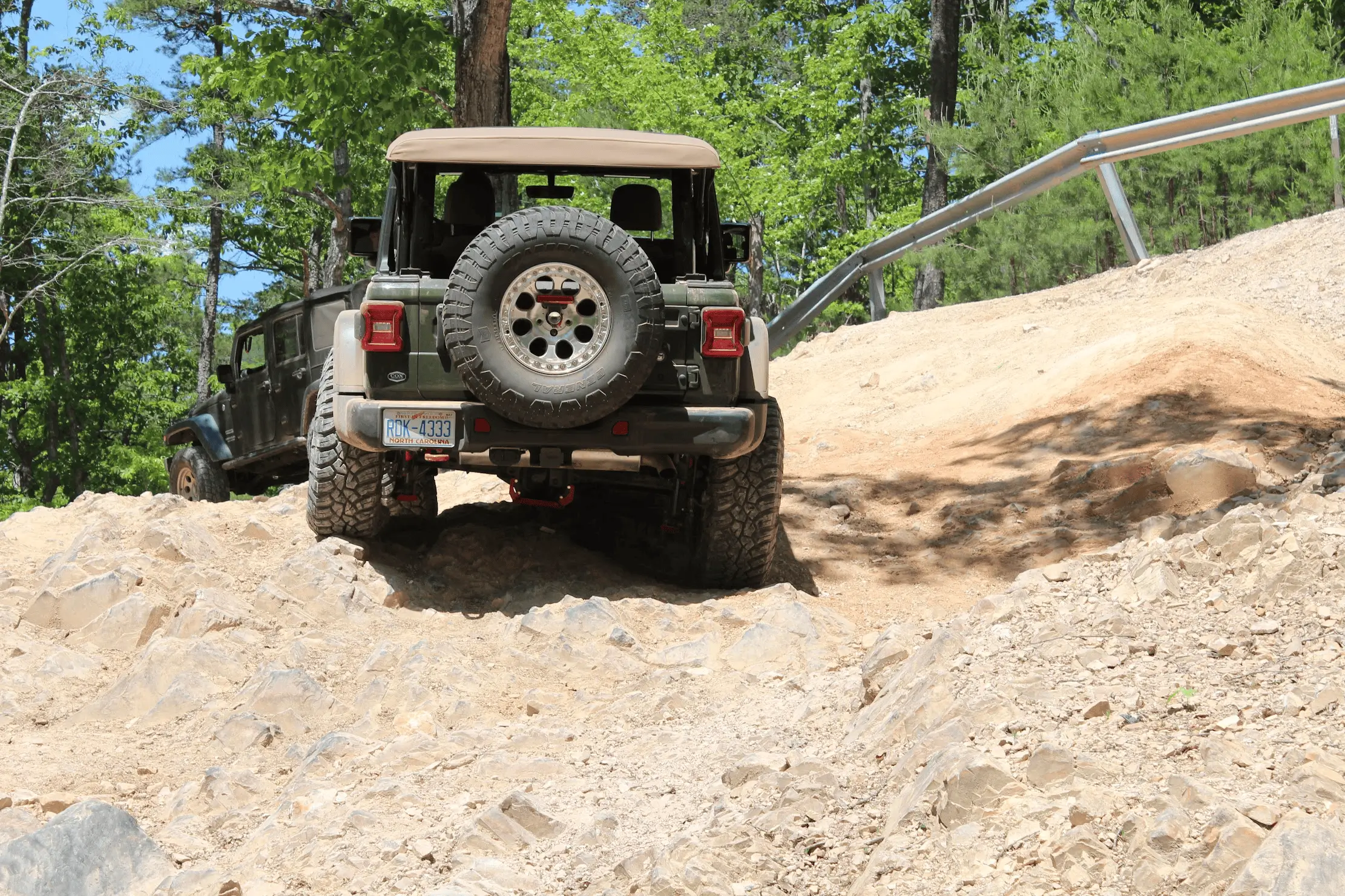

Well, got the Jeep out for wheeling yesterday. Ran great, no issues, suspension felt great. Only minor things to chase down - I have an annoying groan/pop from the rear of the body (sounding like tailgate/tailgate reinforcement/tire carrier) that I need to figure out and my passenger rear tire was getting into the fender closeout panel pretty aggressively, so that needs to get massaged or something. May replace the closeout panel with a flat piece of ABS and flatten out the bump in the fender liner with a heat gun. Gonna stare at it some more and think on it.
Either way, Jeep performed great and felt great on the road home afterwards as well. We ran all the D trails basically (Dutch John, Dickey Bell [twice], and Daniel). Still need to crawl under it to check everything out, but fairly pleased. Random pics and vids below:
Daniel:
Jeep Wrangler JL '22 JLR 2.0T build progress/wheeling thread 1682451979298
GoPro view of the ledge:
Dickey Bell:

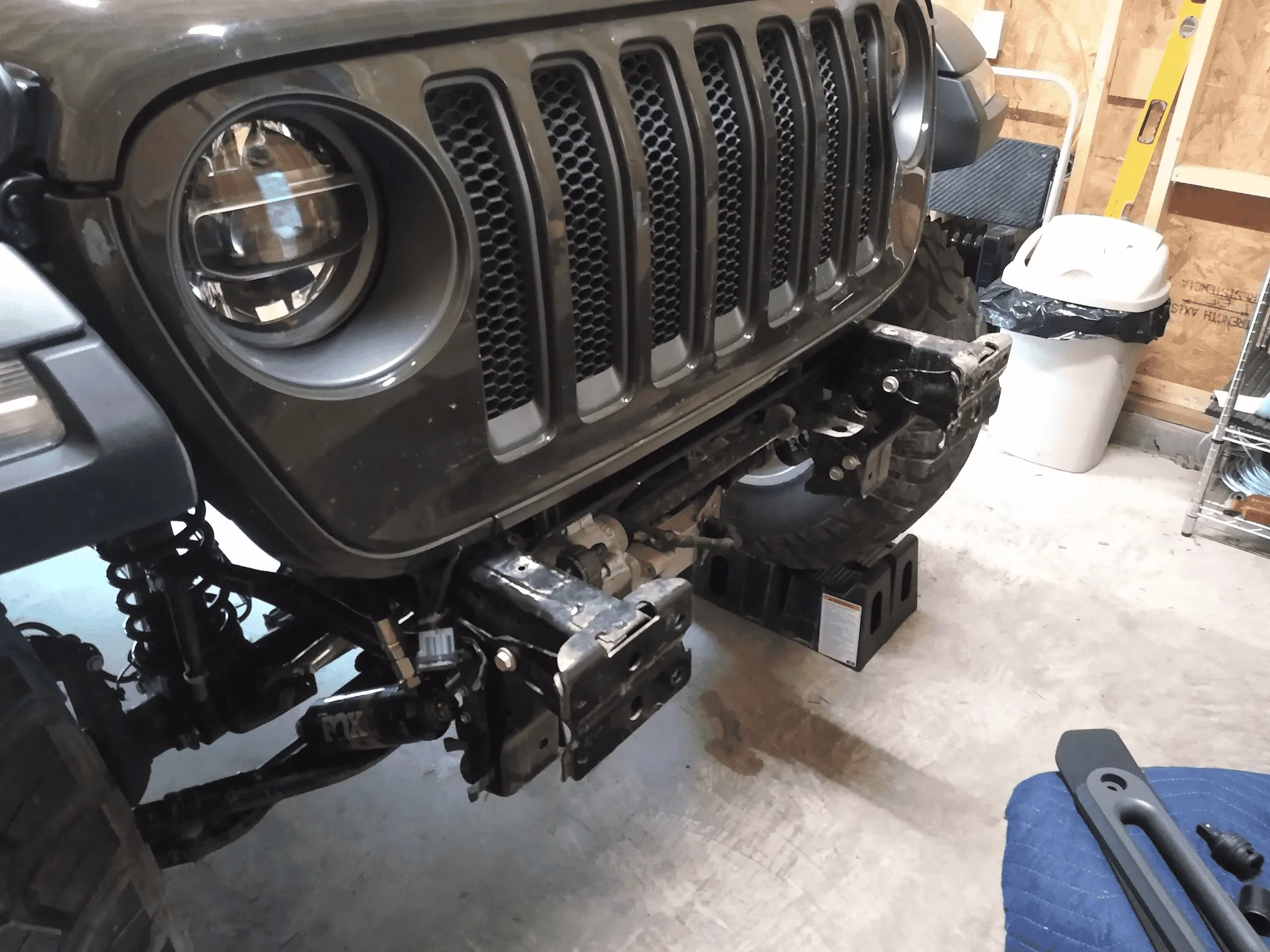

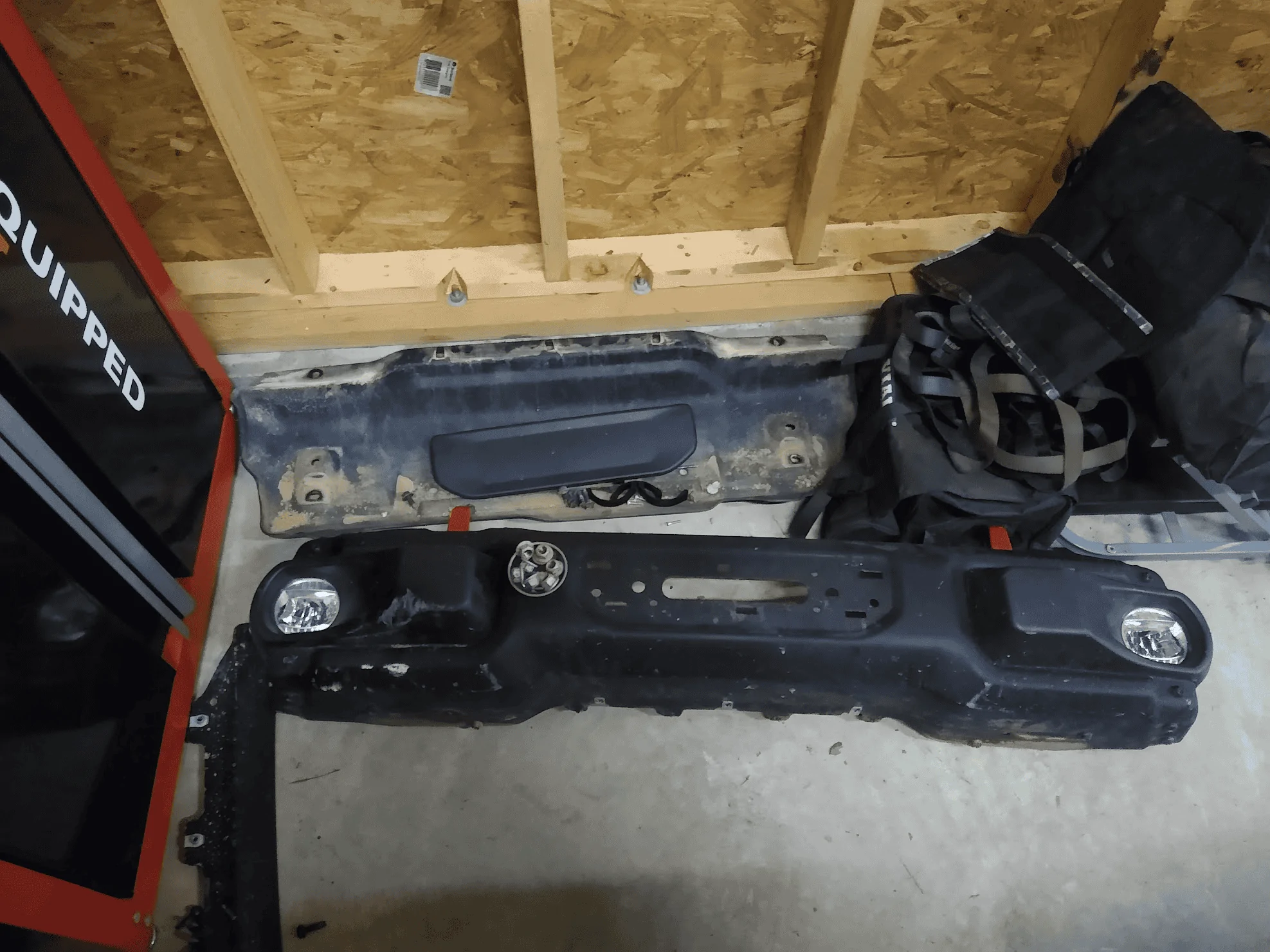

Took care of the 2 door frame stud recall yesterday. 45 minutes of screwing around with the MORE gas tank skid and less than 5 minutes with a hammer and chisel to knock the stud off the frame. Laying on my back taking that skid on and off though is enough to make me consider some aluminum skids if I keep staying out of them at Uwharrie. 90% of my wheeling will be there, and it's easy enough/the Jeep's tall enough that I'm not anticipating getting into the skids often at this height (only things I caught last trip were the muffler, rear LCA frame skid, and diff skids). Trips to Windrock/Gulches/Rausch/etc will probably get into the belly skids, but those are going to be fairly infrequent trips just due to how busy life is, so I'm really wondering if I can get away with the weaker but lighter aluminum. Might be just enough...
Also, since Shrockworks up and went out of business, I've been looking at alternate rock rails and have landed on the Metalcloak overline rails as my likely set: JL Wrangler 2-Door Overline Rocker Rails (metalcloak.com). I've been pretty unimpressed with the amount of flex present in even the frame mounted rails for the JL (which I assume is probably related to the thinness of the JL frame material) and so I'm just sticking to body mounted. It'll probably flex about the same, but at least I'll keep the ground clearance. They seem plenty strong enough for how little I'll probably use them.
Other than that, started prepping the Jeep for winch plate/winch install:
Jeep Wrangler JL '22 JLR 2.0T build progress/wheeling thread 1682948825810
Jeep Wrangler JL '22 JLR 2.0T build progress/wheeling thread 1682948844939
Gonna pick at that in the evenings over the next little while.
