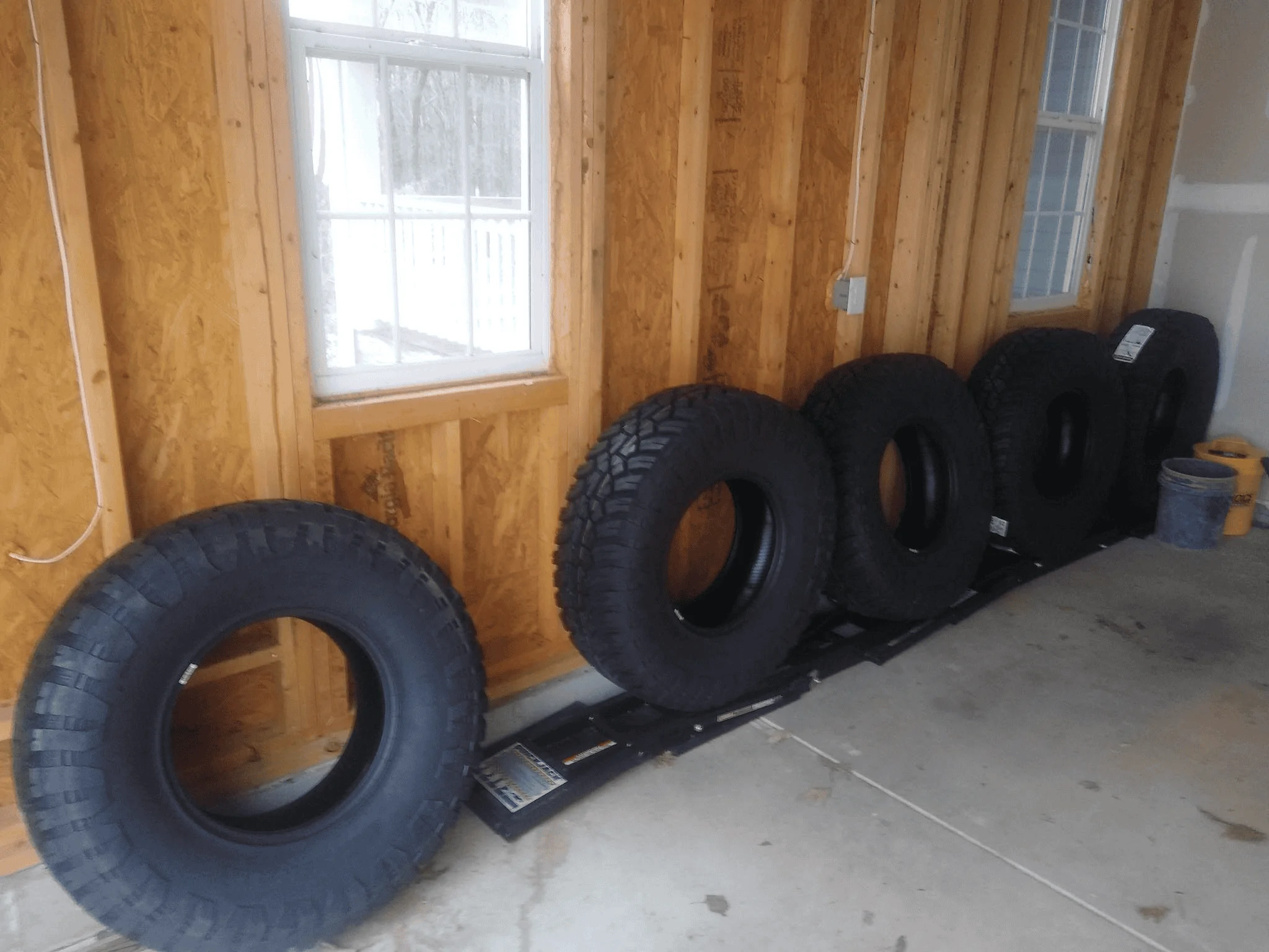

And tires just showed up. Wheels slated for early next week, garage and shop gonna get crowded.

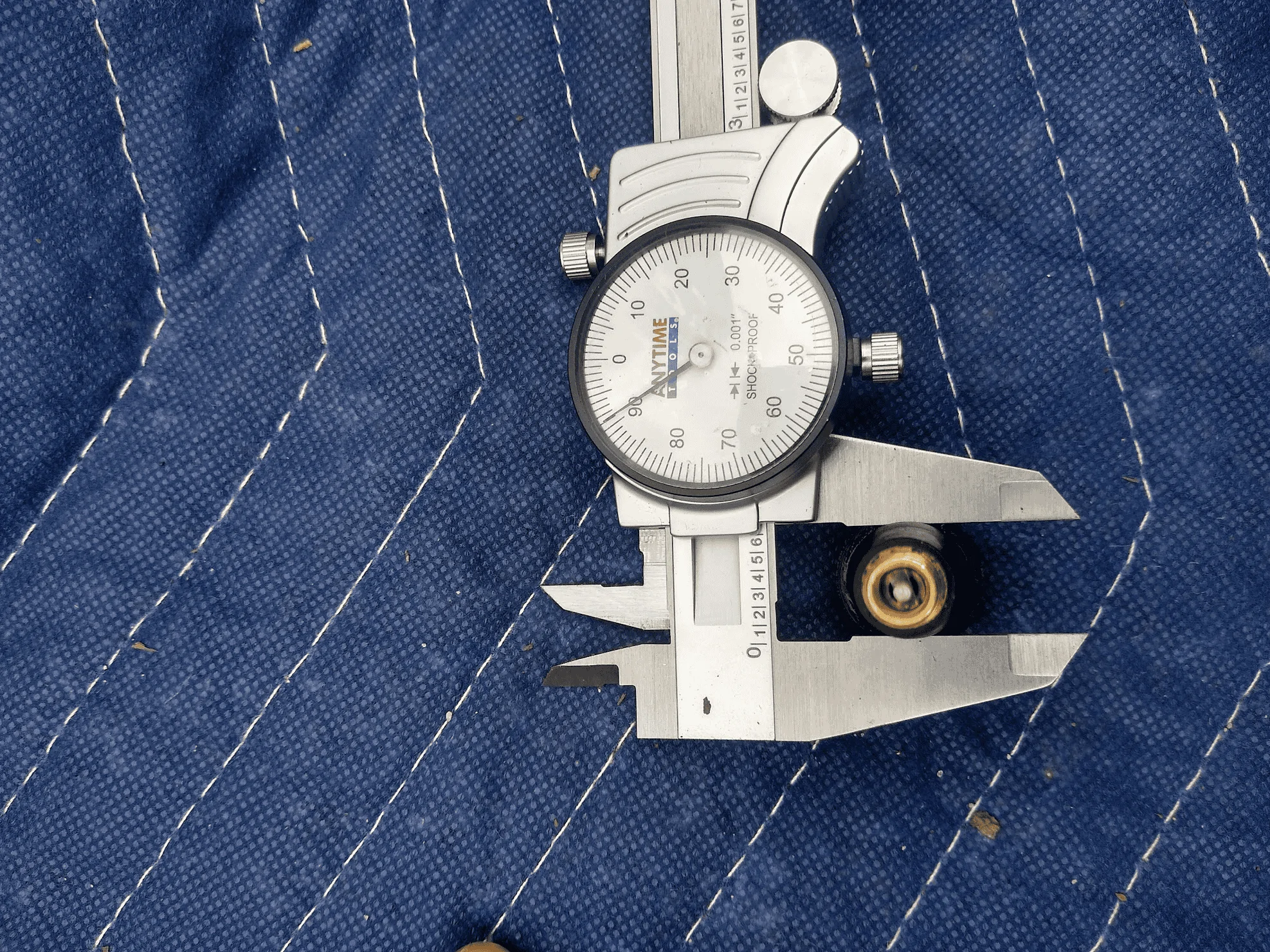

Been a bit since the last update, finally had a chance to start putting wheels and tires together. Went pretty smooth, just a couple hiccups. Turns out valve stems aren't included (though nobody ever said they were, but I had the idea in my head for some reason) and found out the stock TPMS stems are too big for the 0.453" holes in the rim.
Stock TPMS sensors are ~0.590":
Jeep Wrangler JL '22 JLR 2.0T build progress/wheeling thread 1676991767646
Once I raided the local auto stores I was able to get enough 0.453 standard stems and TPMS stems to swap the stock sensor over to the aftermarket TPMS and build two wheels. More stems are on order to finish the other 3.

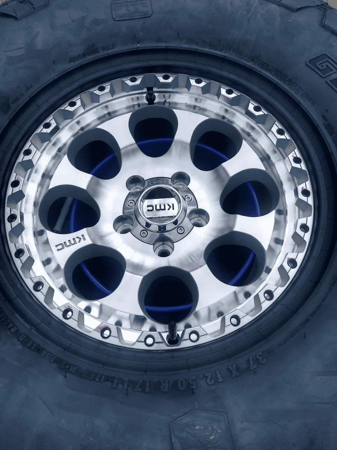

The Grabbers set down perfect around the ring bead, very minimal fussing with the tire:
Jeep Wrangler JL '22 JLR 2.0T build progress/wheeling thread 1676991875566

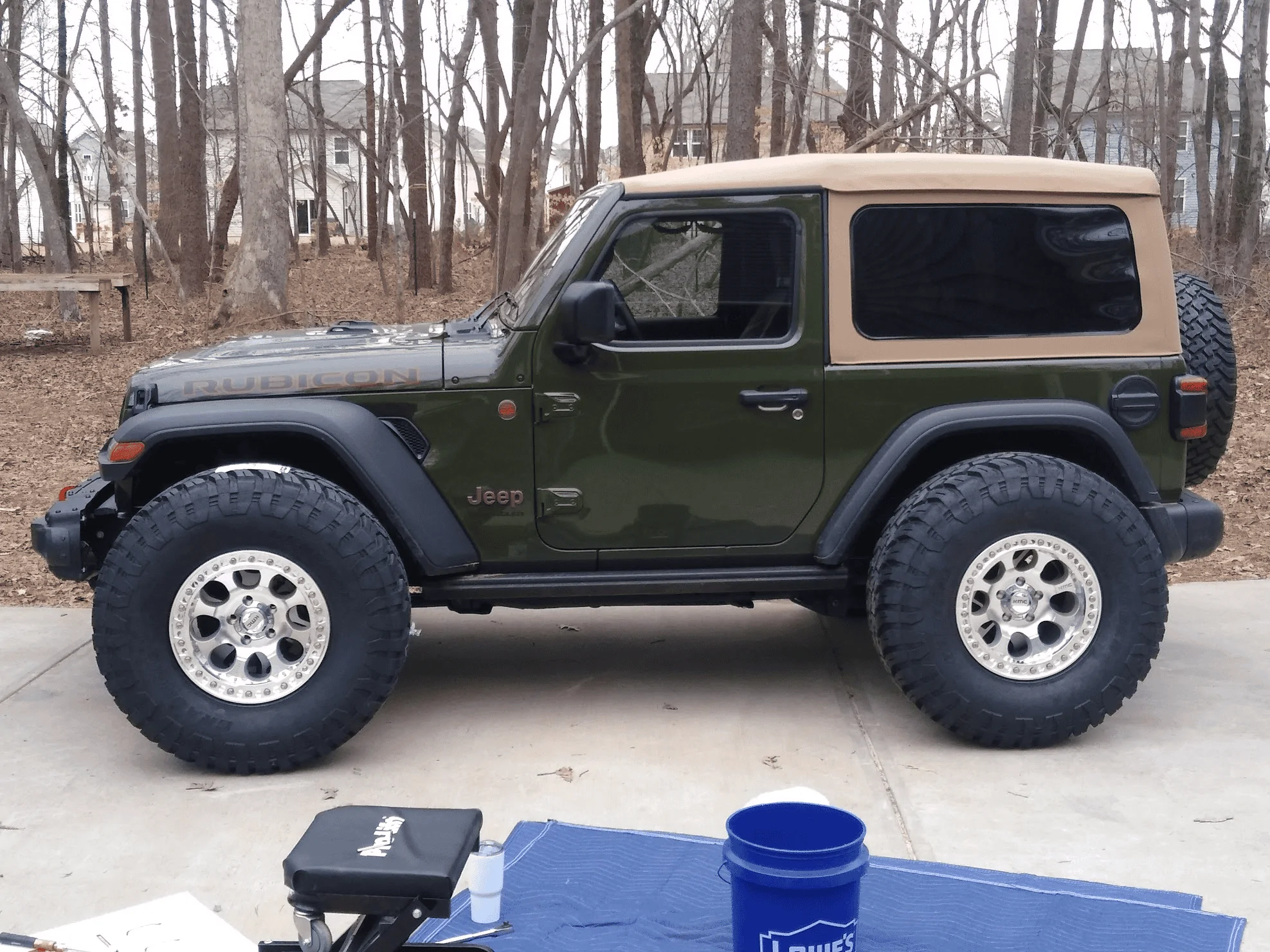

And of course once done I had to roll them in front of the Jeep for pictures of how she'll look with the new wheels:
Jeep Wrangler JL '22 JLR 2.0T build progress/wheeling thread 1676991994436
Jeep Wrangler JL '22 JLR 2.0T build progress/wheeling thread 1676992009016
So, this being my first time doing beadlocks, a couple pointers out there for anyone else who is interested but hasn't done it before:
  • A little bit of dish soap rubbed on the beads of the tire goes a long way. Extra smooth seating of the rear bead, helped the beadlock ring settle down fantastic.
  • KMC recommends tightening in a circular pattern on their instruction placard provided with the wheels - ignore this and do a star pattern for all tightening passes. First wheel has a few bolt pedestals with 1-1.5mm gaps because I followed their circular pattern instruction. Second wheel is perfect, and so first will have the ring redone because I'm too anal to let it slide.
  • It's really as simple as shove the wheel in the tire, plop it all on a bucket, seat the bead around the front, and spend forever slowly tightening the ring in successive passes. The KMC spec is 32ft-lb, I did a pass at 10, then 15, then 25, then 32 and then rechecked all bolts are at 32 again after that.

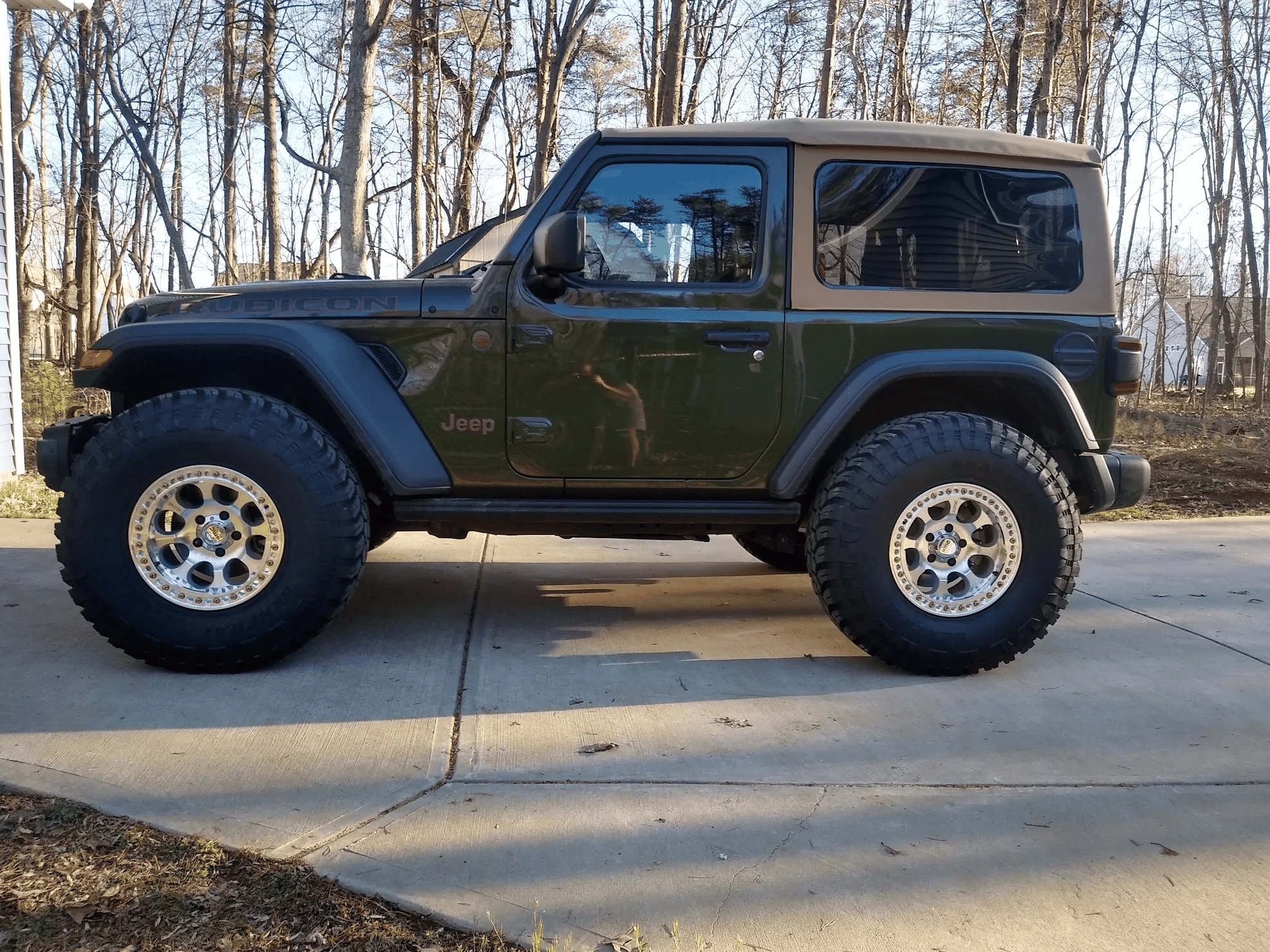

Alright, 37s bolted onto the Jeep and test driven. They weren't balanced, but are completely smooth up through at least 70. Maybe a slight vibration at 75, but we'll see how that shakes out - I only had a limited amount of time testing, so I don't know if it's just shitty road surface or actually a tire vibration.
The 2.0T handles the weight of the KMCs + 37s really well, still saw 8th gear cruising down 55MPH country roads. No issues with power delivery or anything, but I also drive it like it's a Jeep and not a sports car. Given that, probably will stick with 4.10s for the time being. Didn't feel any need to upgrade. Still averaging around 18.5 MPG, just like I was with the stock 285/70/17s.
Used ECRI as my programmer, went super smoothly aside from being a pain in the ass to get the security gateway plugs undone even with the panel under the steering wheel removed. Really dig the GPS tire size calculation feature of that programmer - though I ended up not really needing it, using a tape measure and measuring the difference in height from floor to diff skid both before and after the 37s, I managed to calculate out the tire size using that value and the value that Jeep configured for the stock tire size and came within 0.05" of what ECRI calculated using GPS, but was nice to confirm that I was close enough.
Anyway, next step will probably be the Teraflex spare tire carrier during the week sometime soon, and then the next weekend where I can align schedules with my wrenching buddies we'll be putting on the lift. Coming along, hoping to be able to start doing shake down runs before we get too far into April. Goal is Windrock in either April or May after shaking down at Uwharrie - never been to Windrock, looking forward to checking it out.
