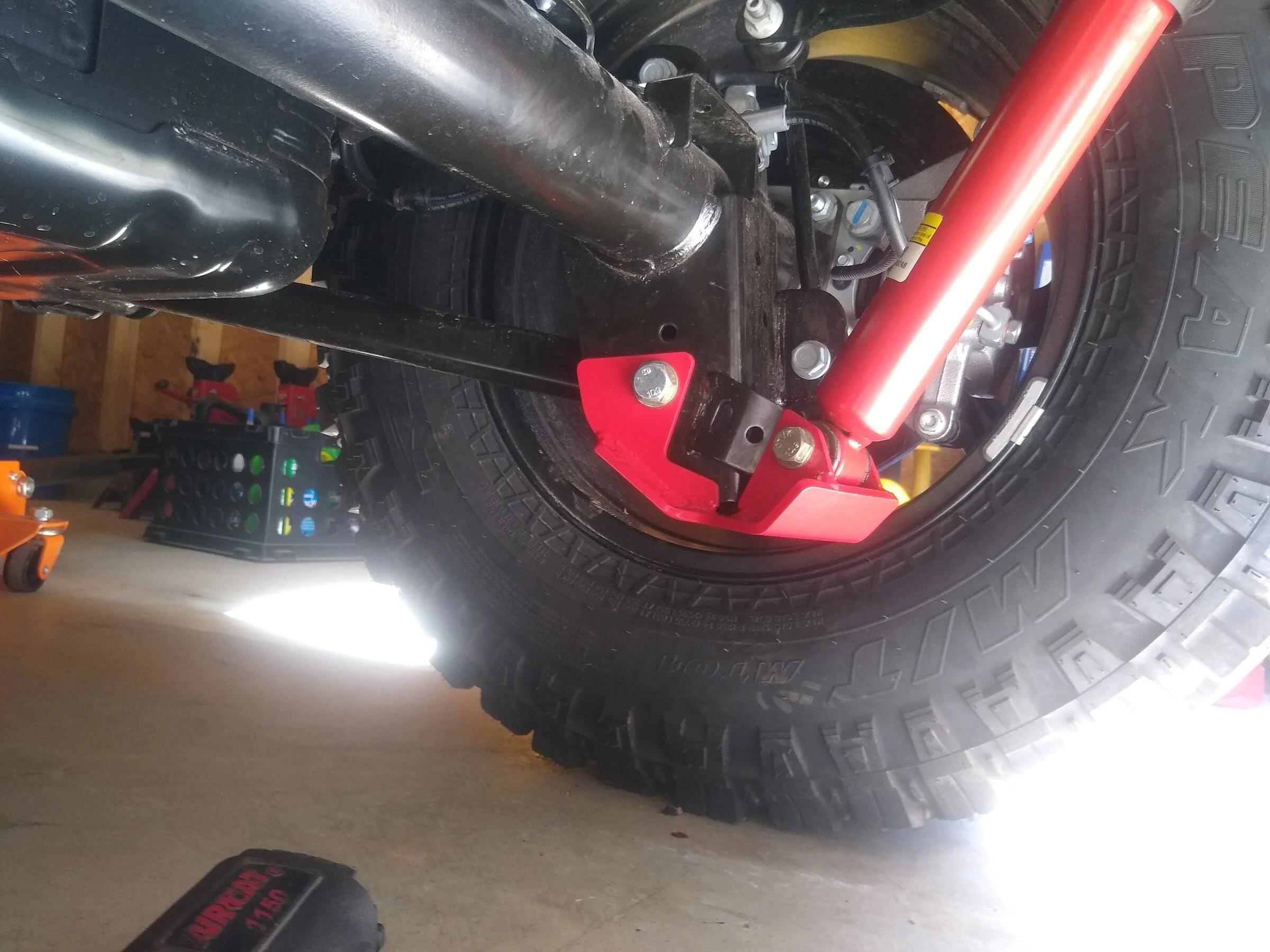

Got the Rancho skids installed this past weekend, and got started painting up the Rusty's skids. Installation was straight forward, minus issues lining up the shock eyelet, but more on that later.
Before removing the axle side LCA bolt, in order to ensure you're not fighting to get the bracket hole/LCA bushing lined up, just pop a jack under the axle casting and snug it up (don't lift the Jeep) and this'll keep the axle from rotating when the LCA is released. Just be sure to release the jack before torquing the LCA bolt to spec to ensure the Jeep is under its own weight when doing final torque on that side, and do one side at a time.
All told, these skids seem solid and went on relatively easy. Only issue is getting the shock eyelet lined back up when reinstalling the shock. Typically, prying inside the eyelet or underneath the shock end to line up the shock with the mounting holes is all that's required. However, since the Rancho skid design has two tabs, completely surrounding the shock, you end up prying against the skid itself in order to line up the shock, which causes things to misalign themselves, making it a pain in the rear to get the bolt in. I found that by placing the jack underneath the skid and applying pressure to hold it in place, I was eventually able to pry enough to get the bolt started and use a rubber mallet to tap it through. I considered jacking the rear of the Jeep up from the frame to have the shock fully extended and let the raising of the frame raise the eyelet to where it needed to be, however my creative cussing got the bolts in without needing to attempt that.
I like the protection this skid looks to offer, but the shock install was a pain. Rusty's LCA and shock skid is a single tab design and might be an easier install. Will keep this in mind for the future if this becomes a massive pain when eventually lifting and installing much longer shocks. The reason I think this might be a better design for serviceability/installation is that you can use your prying tool to lift the shock eyelet into place by leveraging against the stock bracket on one side, preventing you from misaligning the skid as you're not pushing against a skid bracket.

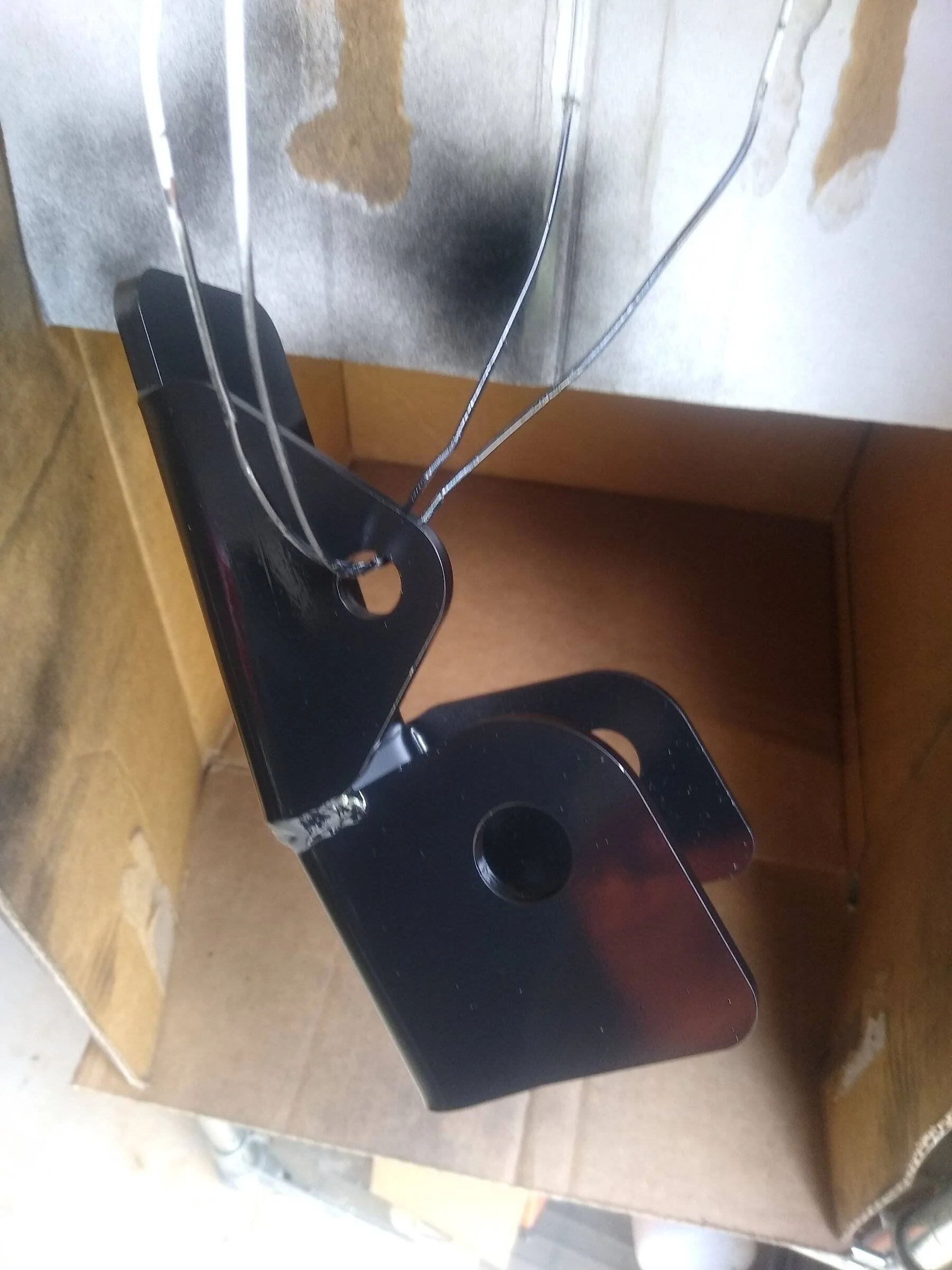

Preview of the Rusty's frame-side LCA bracket skids below. One is fully sprayed with a POR15 DTM top coat, the other will get finished soon once work/life allow me the opportunity. Not doing full rust preventative, they're skids, they're consumable and will get beat on. No need to get too fancy.
On the passenger side, there is an imminent issue I can see coming up for installing these - the gas tank skid plate will interfere with the bolt that goes through the existing hole in the frame. Getting the nut in there seems as though it will be difficult without bending the skid back with a prybar or something. Even then, I believe the bolt may make contact with the gas tank skid once the skid is released by the prybar after the bolt is installed. Options I'm considering are a thick rubber cap on the butt of the bolt so that it making contact doesn't really matter (with this option, I worry that the bolt will simply wear through the rubber "cap"), buying a shorter bolt (not sure at the moment if there is one that'll be short enough to make it through the frame and engage the threads on the nut but not make contact with the skid), or clearancing the gas tank skid with the dremel (my worry with this option is that the bolt may be long enough to make contact with the gas tank itself once a slot is ground into the skid).
One of those options should work, will get it figured out and follow up in the next install update.

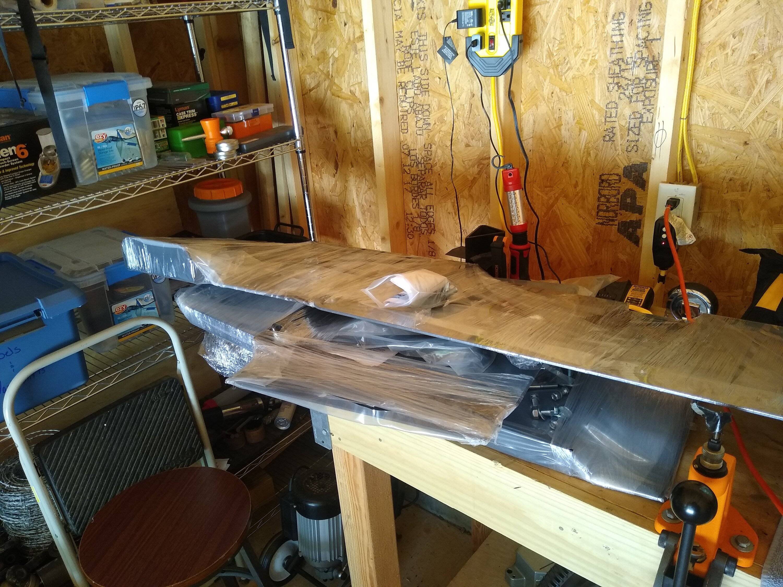

Pile of skid plates waiting to go on. Scheduled a wrenching day with my group on July 17, but might start picking at this before then...

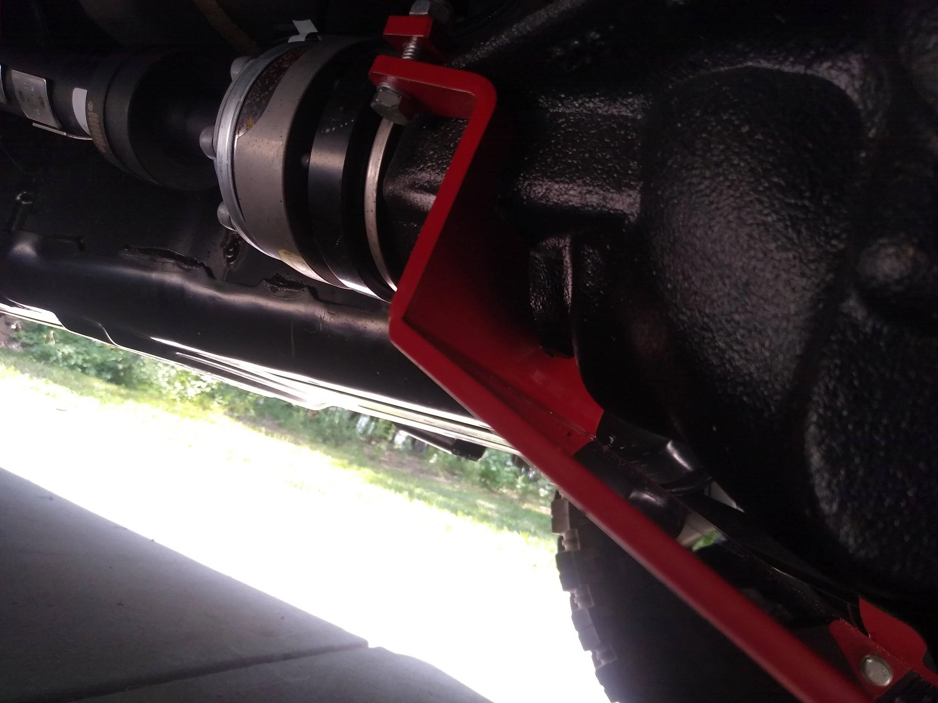

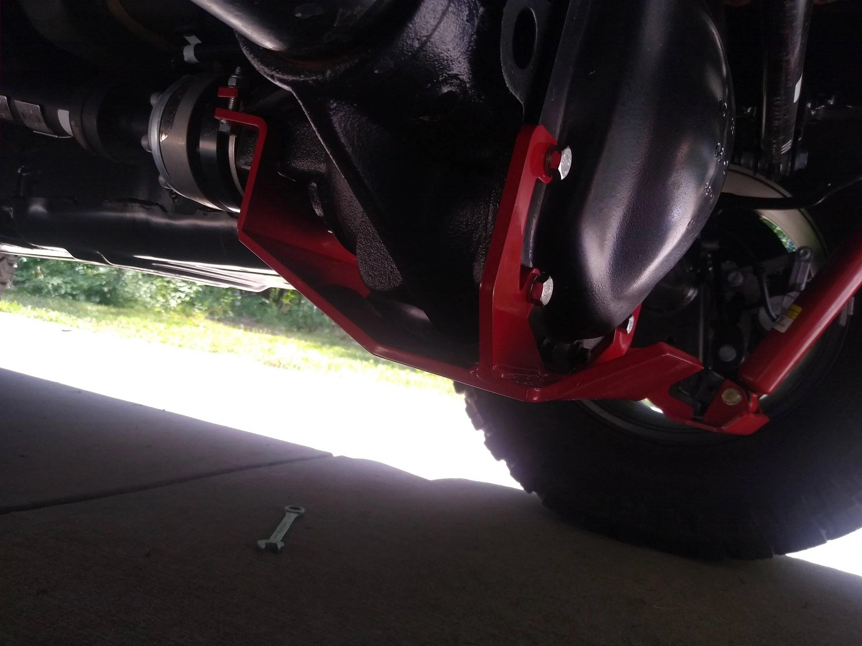

Nothing major this weekend, just installed the rear Rancho diff skid. Buddy of mine likes them on his JK and figured I'd give them a go and see if I like them. Waiting on Rancho to release one for the fronts on the '22s with the modified casting to do the front.

No issues mounting the Rancho rear skid? I noticed on their instructions it only says 18-20 Jeep JLs are compatible. Just wondering before I order one myself!
Remorseless
Remorseless
May 10, 2022
799
3,689
NC
'22 JLR 2.0T, '21 KL TH 3.2, '19 Charger R/T
No issues, bolted right up to the stock rear D44. I've even got the rear axle without drain plug and no issues.
Megawatt
Oct 28, 2020
363
975
Sin City aka Vegas
3 money pits: Turbo Busa, Road King, 22JLUR snazz
Powerplant operator
Nothing major this weekend, just installed the rear Rancho diff skid….
When you install this rear diff skid is there enough pressure from the top bolts that oil doesn’t leak out when you have to remove the lower bolts to install the skid? Or do you have to drain, install skid & bolts then refill the oil?
Remorseless
Remorseless
May 10, 2022
799
3,689
NC
I did the cover bolts first to help hold things in place to do the pinion strap bolts. No oil leakage whatsoever, the factory gasket holds pretty well for not being RTV.

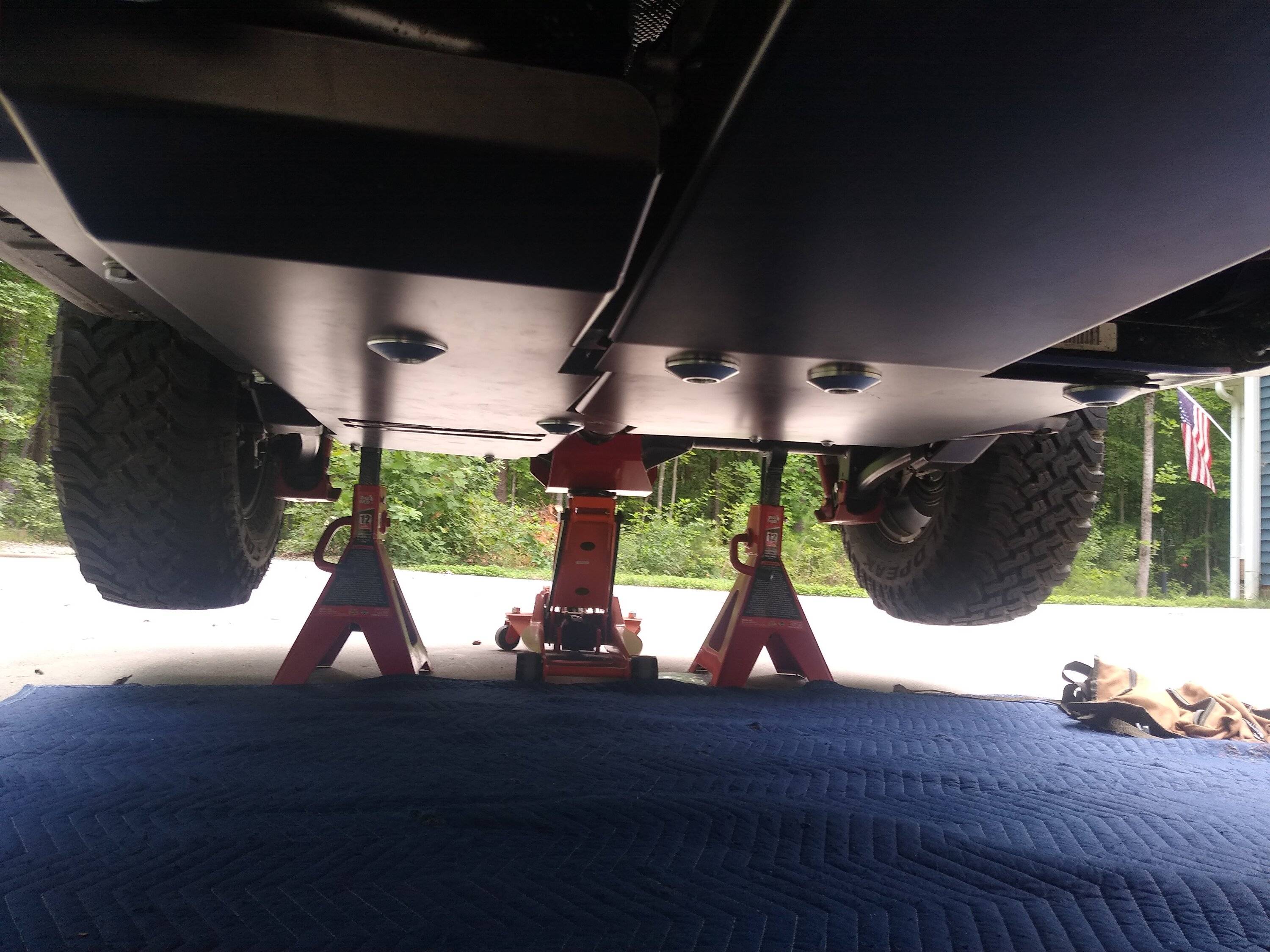

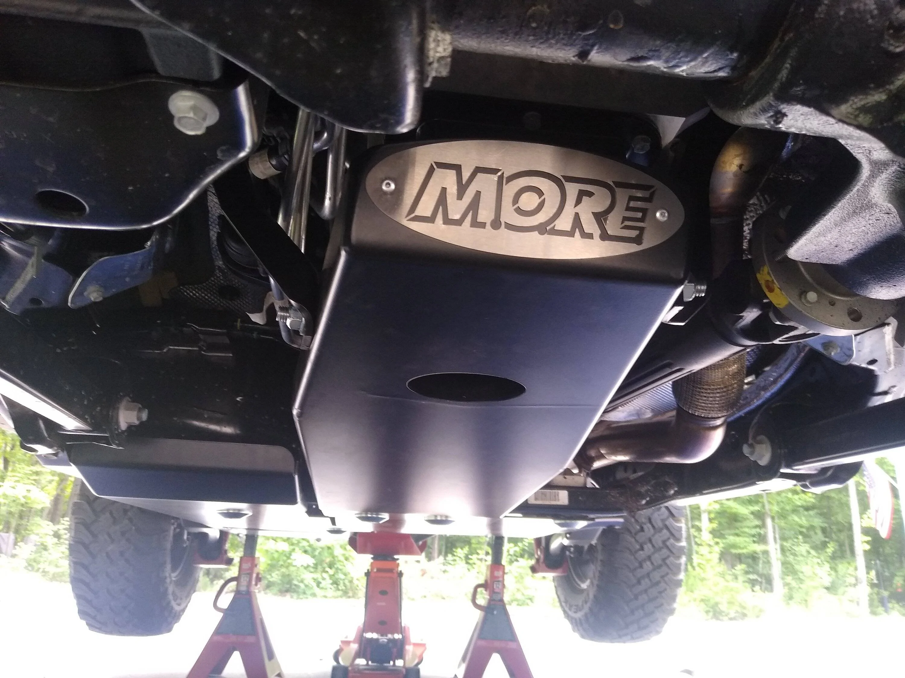

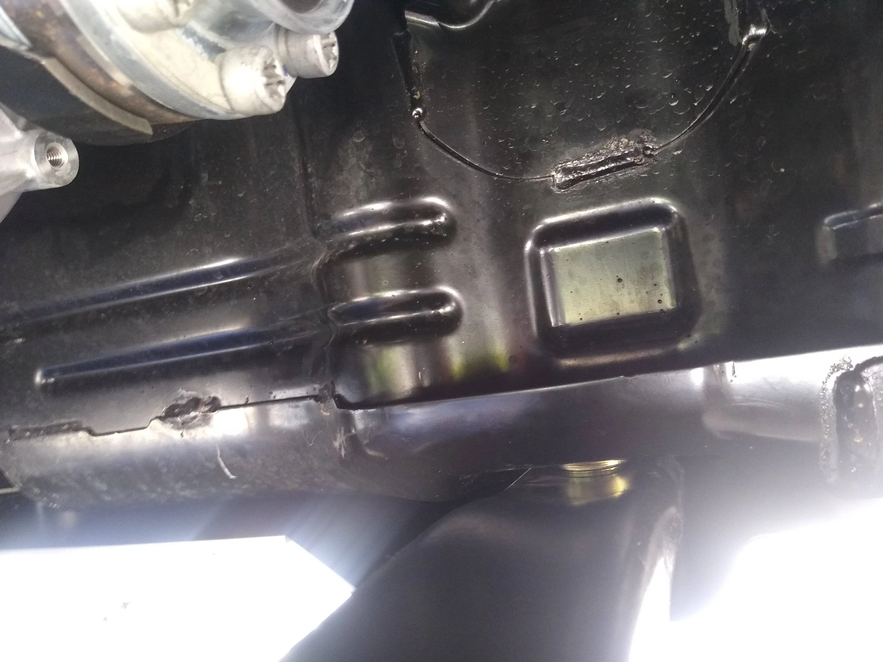

Well, interesting weekend. The wife and I ended up catching the 'vid and so I had to cancel my wrenching day with my boys. However, our symptoms were super mild so she and I tackled the skid install without the boys. Went well, but was a long day under the Jeep and by the end of it our symptoms were kicking in hard. Either way, here's the write up:
Gas tank skid:
https://mountainoffroad.com/collections/skid-plates/products/jeep-jl-gas-tank-skid-plate-for-2-door
The install here was easy enough, it's just a heavy sucker. Definitely recommend having a second set of hands and a free floor jack or two to help with holding and maneuvering. If you're like me nothing is ever as straightforward as it should be, and your gas tank skid may shift once the OEM bolts are out of the skid. This can give the M.O.R.E. bolts a tough time bolting up. Pro tip here is to bolt up the M.O.R.E. skid using the OEM bolts you removed instead of the M.O.R.E. supplied bolts, as the OEM bolts have a tapered tip that help line everything up and shift the skid back where it needs to be. Then, one-by-one replace the OEM bolts with the M.O.R.E. bolts using your blue Loctite. The only issue I ran across with this install was that the rear crossmember about halfway down the gas tank had an approximately 1/4" gap between it and the OEM gas tank skid. A few stacked washers solved this and tightened everything up.
A little hard to see in the pic, but the M.O.R.E. skid is beneath the crossmember, which is sandwiched between the M.O.R.E. skid and the OEM skid. There's a bolt that runs through the M.O.R.E. skid, through the crossmember, and into the OEM skid. Just needed a spacer to tighten everything up, no big deal.
Transfer case skid:
https://mountainoffroad.com/collect...s/jeep-jl-transfer-case-skid-plate-for-2-door
This install was super straightforward and no issues whatsoever. Just make sure to install this skid loosely before you install the engine skid. There are two bolts that this skid shares with the engine skid, so you'll need to make sure to leave those out when installing the engine skid.
Engine/trans skid:
https://mountainoffroad.com/collect...l-turbo-2018-current-1?variant=40587980505199
This was mostly straightforward, just a little trouble with the driver's side bolt through the motor mount horn. The bolt-to-bracket-to-frame fit was super tight and had to be threaded through the powder coat on the M.O.R.E. bracket. Not a big deal, just a bit of a pain in a super tight spot. Recommend a ratcheting box wrench for this bolt, really hard to get a regular ratchet in there.
Overall thoughts:
This system ticks a few nice boxes for my use case - I like the option to revert back to stock skids by just dropping the skids and putting the OEM bolts back in. This does mean this system is a pure weight addition, which is something I try and avoid, but it's 3/16" steel instead of 1/4" like most of the other systems, so it's not entirely as horrible as it could be, but it's still not great in terms of keeping weight down. It's also a simple enough driveway install.
Build construction is good, and bolt quality is OK. The slide washers are awesome at first glance, but time will tell on how they hold up. Coverage is pretty good, but the stock skids weren't awful to begin with. Once the Jeep is lifted, I am considering keeping only the engine/trans skid in place and removing the others - but time will tell on this one.
