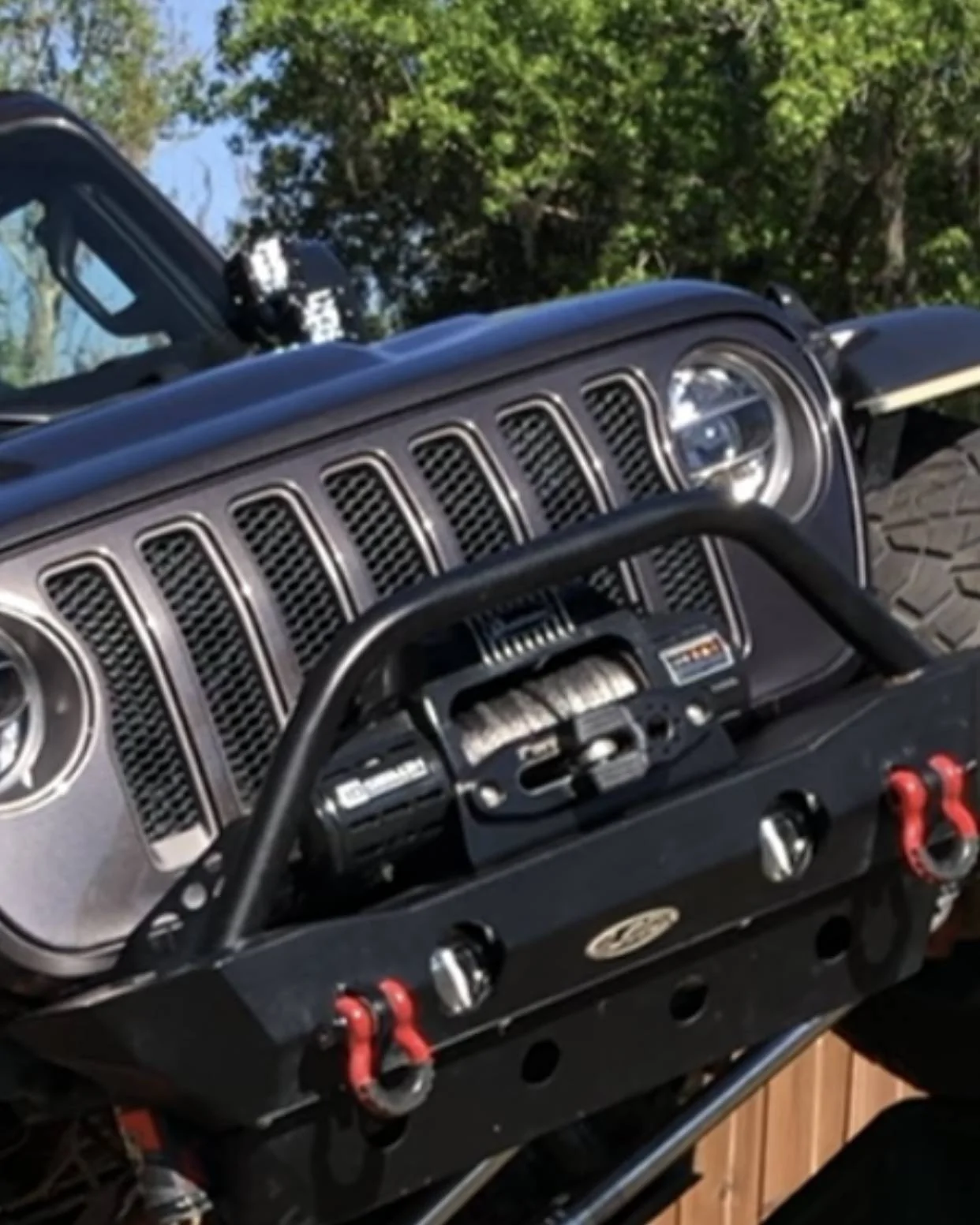

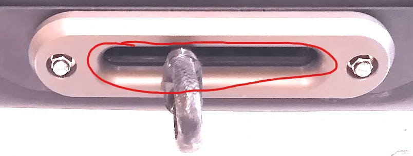

Ok …….. now we’re finally getting somewhere…..? … you need that part you have circled to be bigger or smaller up & down or side to side…..?
Yeah, slot height of the fairlead rope slot is too tall given the narrowness of the Mopar slots in the filler plate, bumper, and winch plate. But, Factor 55's fairlead is specifically larger than "standard" in order to facilitate wild and crazy thimble sizes. Looks like the standard Warn aluminum fairleads are 7/8" to 15/16" in slot height, Factor 55 is 1-1/8" to 1-1/4", rough measurements. Given that the Mopar slots are ~1-1/3" tall (I believe it was 1.360" last I checked) in height, the Factor 55 is very close to just being level with the plates and bumper. Best case there is a little over 0.1"/under 1/8" of "drop" behind the Factor 55 fairlead and the top of the plates behind it. So, tracking down a narrower fairlead to have more vertical space.
Problem is I'm trying to stay US-made and the normal style Warn aluminum fairleads are made in China along with virtually every other aluminum fairlead that isn't extra tall in the rope slot(Grimm Off Road has a US-made fairlead for instance, but it's of the taller slot variety, so would be the same issue). Basically - the Mopar rope slot height doesn't jive with non-Chinese fairleads.

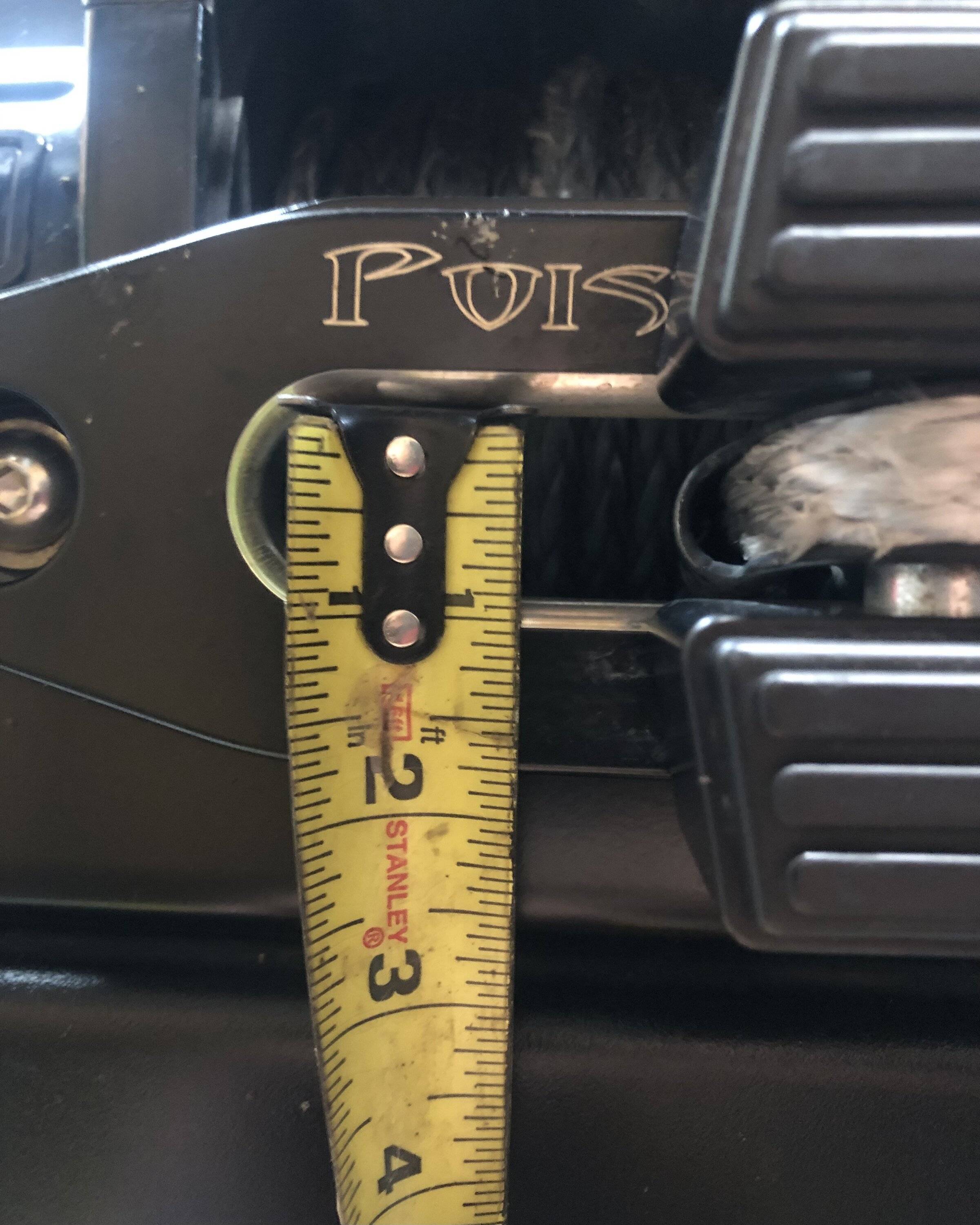

I have Poison Spyder, will it work on your setup? I can measure the gap here in a bit…. Does it look smaller just eyeballing..?
It looks narrower in the pic, but I also thought the gap looked OK enough for the Factor 55 in person lol
I've been thinking about the CrawlTek fairlead: CrawlTek Revolution Aluminum Hawse Fairlead - Bare Aluminum
Got a question out to them for height measurements on their rope slot as well.

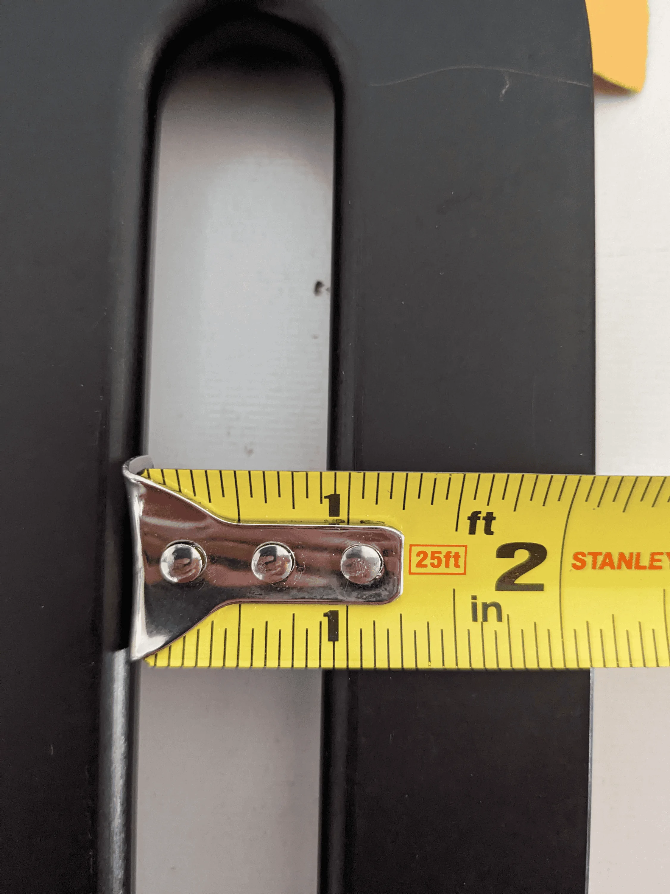

Grimm fairlead showed up today, looks like the actual opening is just a shade over 7/8" on the backside.

Ended up ordering the Crawltek fairlead as the look of raw aluminum for the fairlead was growing on me (and it's a bit cheaper than the Grimm). Whenever it shows up, if there's issues or if the bare aluminum corrodes (shouldn't, central NC doesn't see hardly any road salt or anything) I'll go with the Grimm since it's anodized, but really hoping I don't burn through 3 fairleads chasing down fitment...

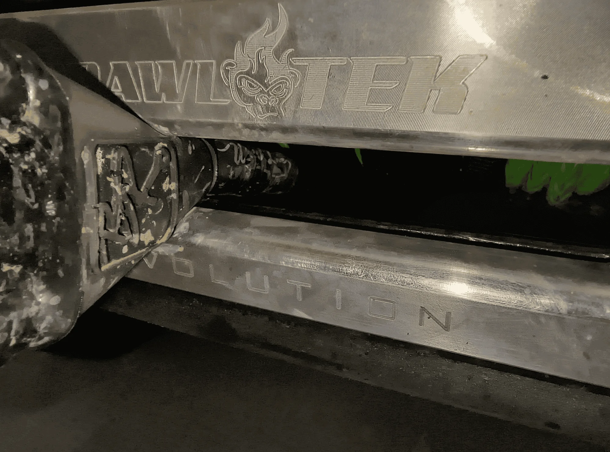

Alright, update time: Crawltek fairlead ended up being exactly 7/8". This helped greatly, but there's still slight contact with the slot in the bumper. You can see how close it is below:
Jeep Wrangler JL '22 JLR 2.0T build progress/wheeling thread 1685970198202
At some point I'm going to have to grind that down, but will put it off till it's an immediate problem. Contact was light and no fraying noticed during the retensioning process.

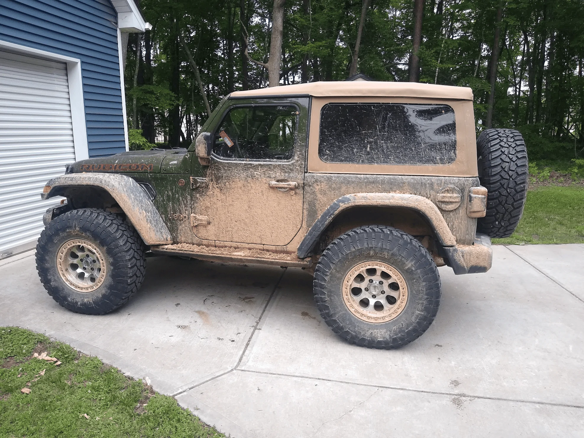

Anyway, on 5/30 I got to go wheeling and it was wet as hell out there:
Jeep Wrangler JL '22 JLR 2.0T build progress/wheeling thread 1685970389613
We ended up doing Dutch John, Rocky Mountain Loop, Wolf's Den, Falls Dam, and Dickey Bell. I usually cancel when it's this wet out, but decided to just go with it this time, in the below vid you can see little rivulets running down Dickey Bell - it was a lot of rain.

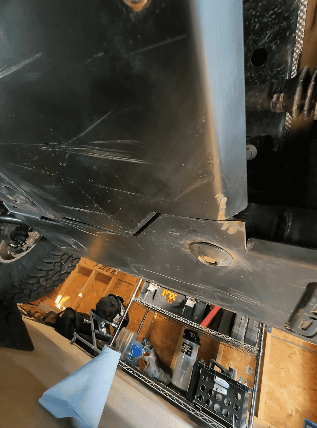

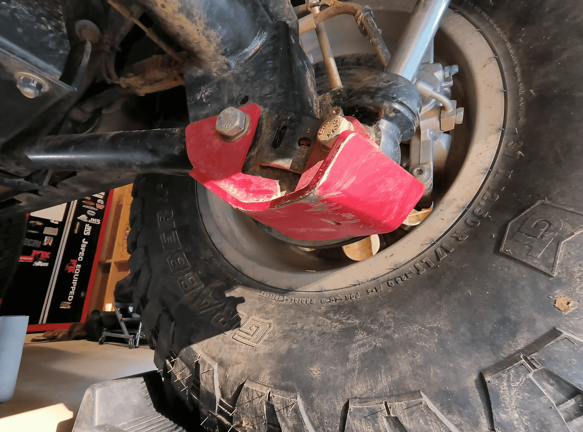

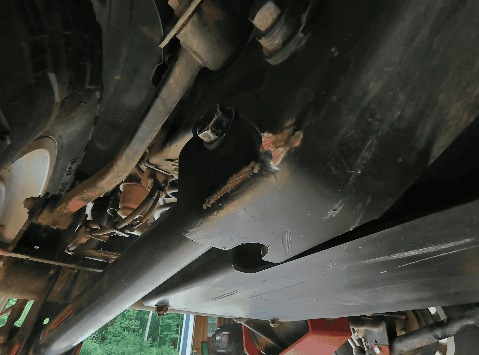

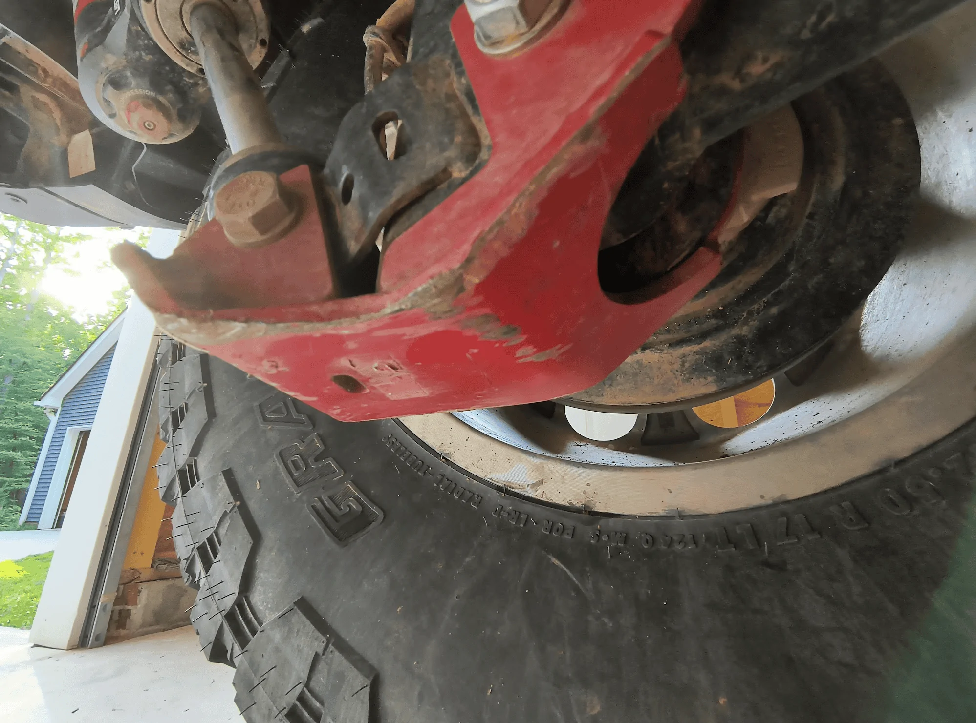

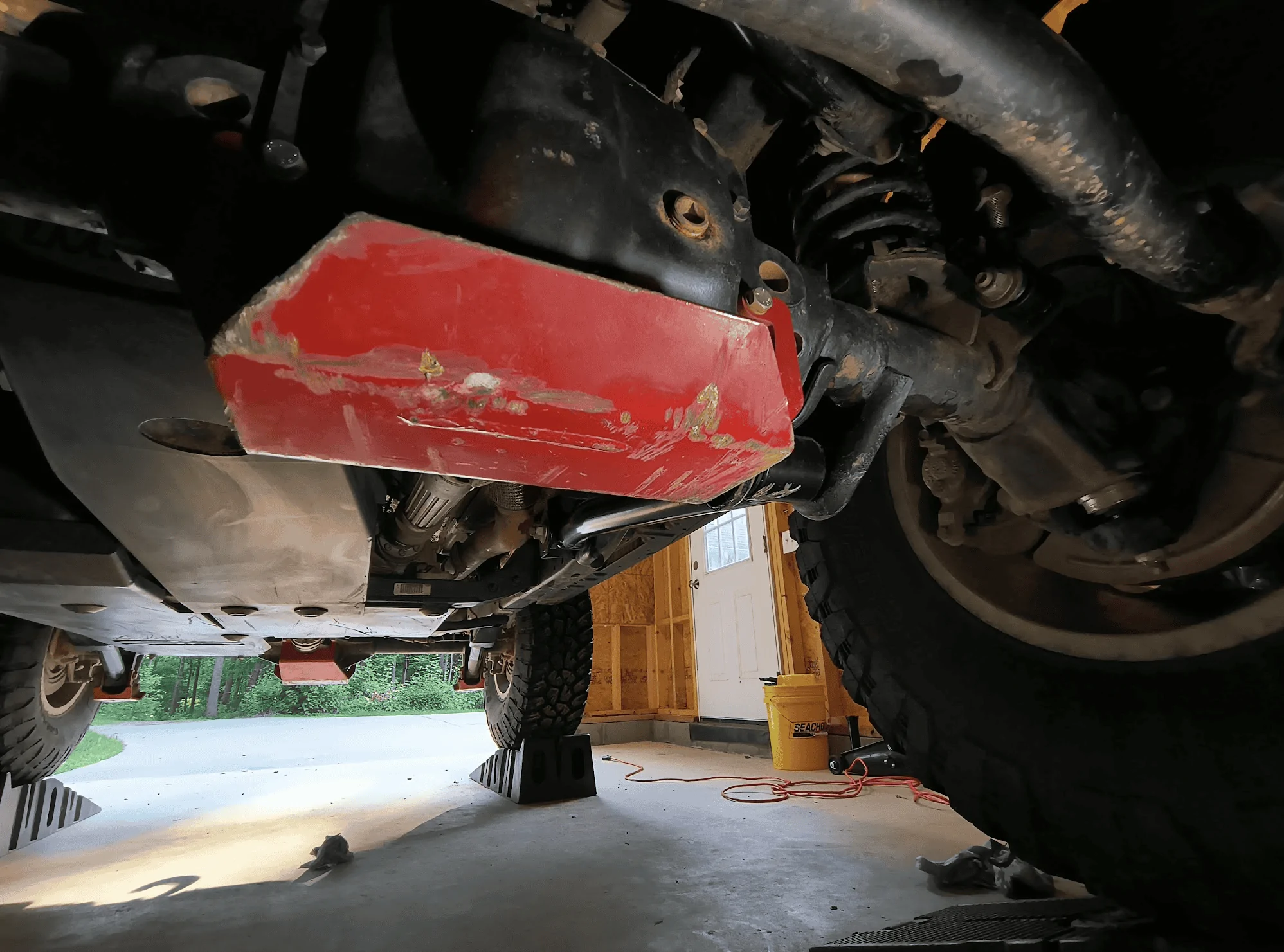

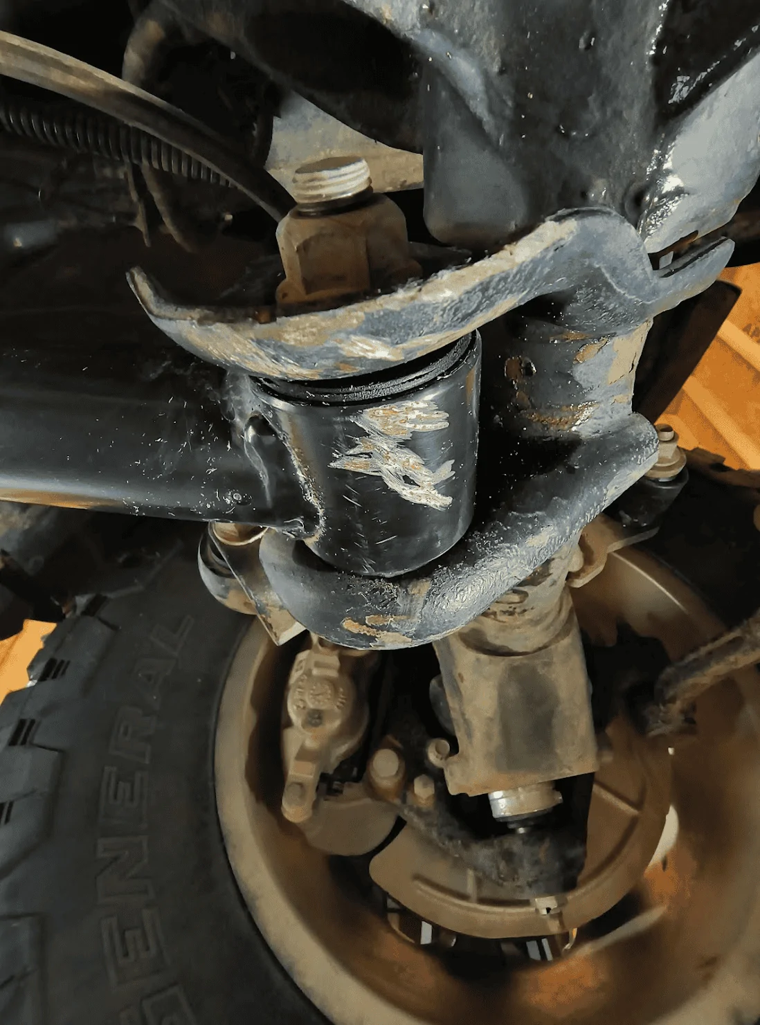

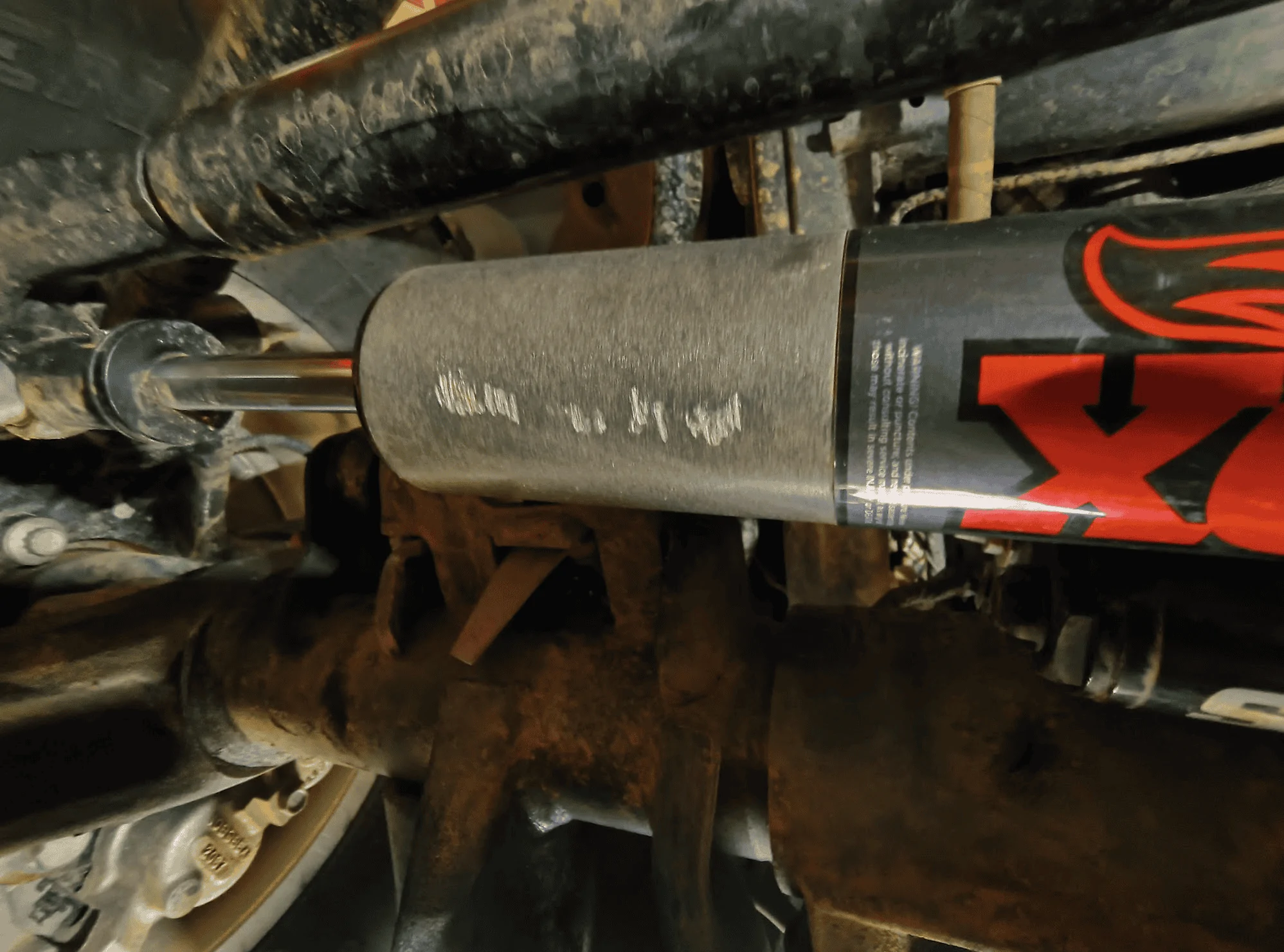

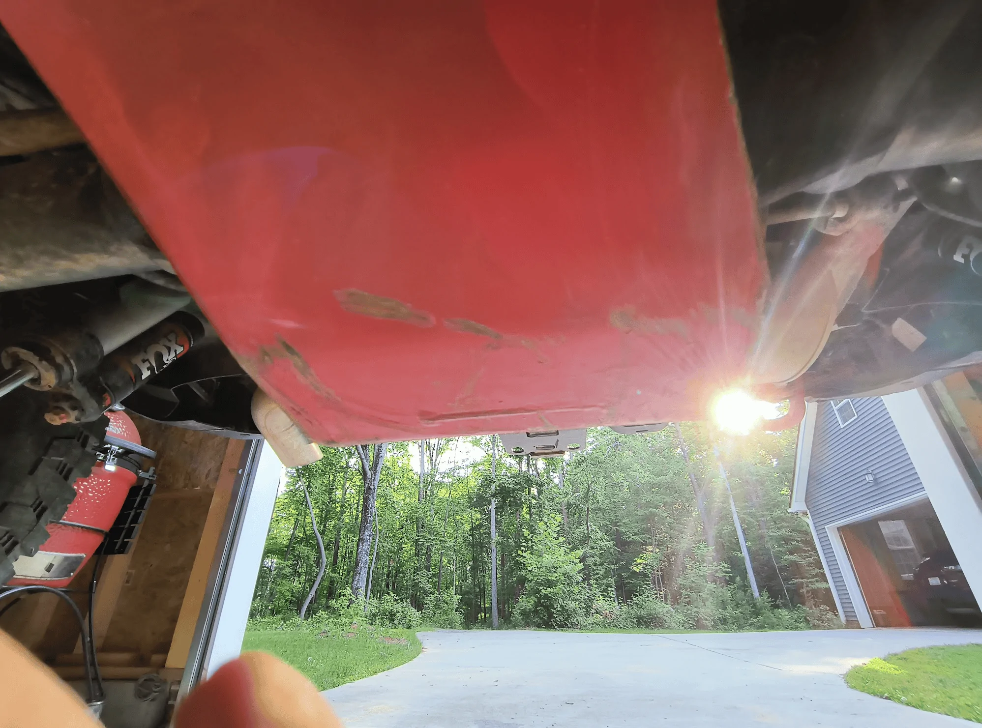

With it being that wet out, there was some slipping and sliding (mainly on Dutch John and Rocky Mountain Loop), and I did a good one on Dutch John on one of the optional little rock obstacles which is normally no issue even stock, but I slipped off and tagged pretty much every skid, my front axle-side LCA, and the steering stab (I know, I know, it needs relocated, but still thinking about what I'm going to do for steering and don't want to relocate twice):
Jeep Wrangler JL '22 JLR 2.0T build progress/wheeling thread 1685970688595
Jeep Wrangler JL '22 JLR 2.0T build progress/wheeling thread 1685970707717
Jeep Wrangler JL '22 JLR 2.0T build progress/wheeling thread 1685971069370
Jeep Wrangler JL '22 JLR 2.0T build progress/wheeling thread 1685971085896
Jeep Wrangler JL '22 JLR 2.0T build progress/wheeling thread 1685971120504
Jeep Wrangler JL '22 JLR 2.0T build progress/wheeling thread 1685971137964
Jeep Wrangler JL '22 JLR 2.0T build progress/wheeling thread 1685971159216
Jeep Wrangler JL '22 JLR 2.0T build progress/wheeling thread 1685971176415
Jeep Wrangler JL '22 JLR 2.0T build progress/wheeling thread 1685971205299

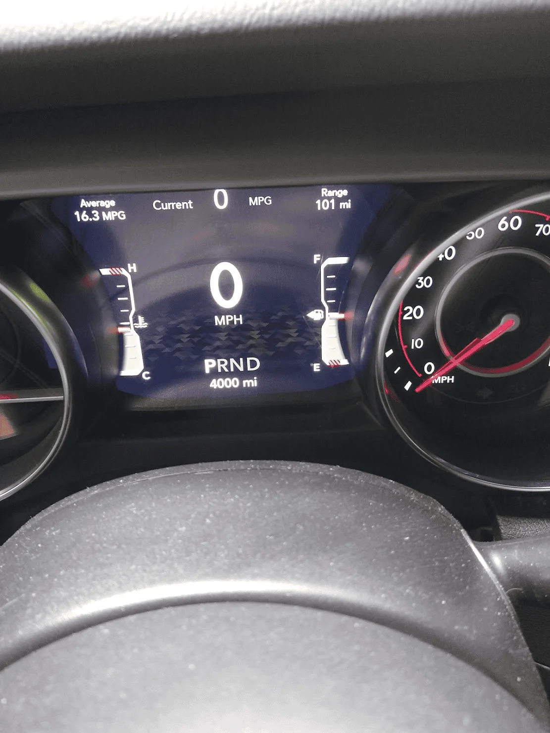

Forgot this - been about a year with the Jeep now and this past trip she just ticked over 4k miles at the end of the trail day:

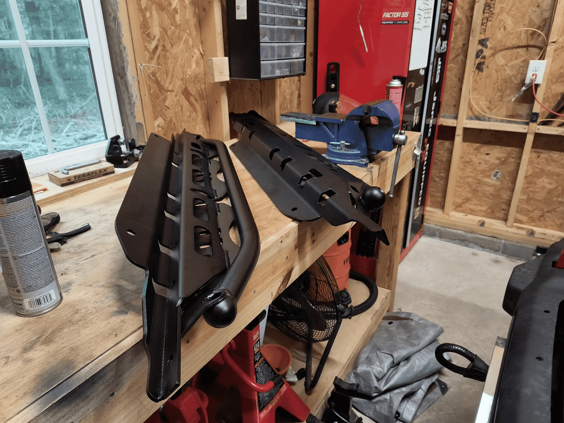

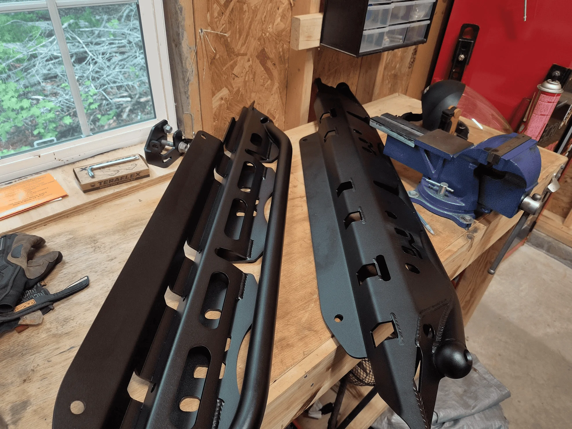

Rock rails arrived! Was a little nervous about their listed 35lb weight that maybe they'd feel flimsy, but no, very pleased with how they feel and how the construction appears to be just handling them.
Jeep Wrangler JL '22 JLR 2.0T build progress/wheeling thread 1686228798092
Jeep Wrangler JL '22 JLR 2.0T build progress/wheeling thread 1686228834703
Windrock is at the end of July, aiming to have these on before then, along with hopefully at least the rear HD springs to see how those sit.
