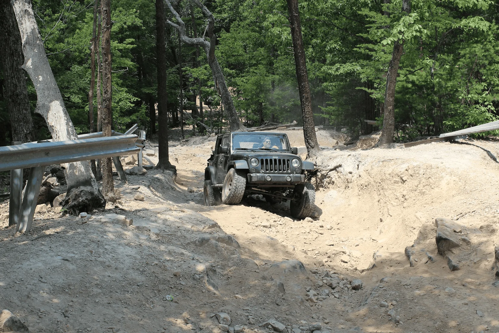

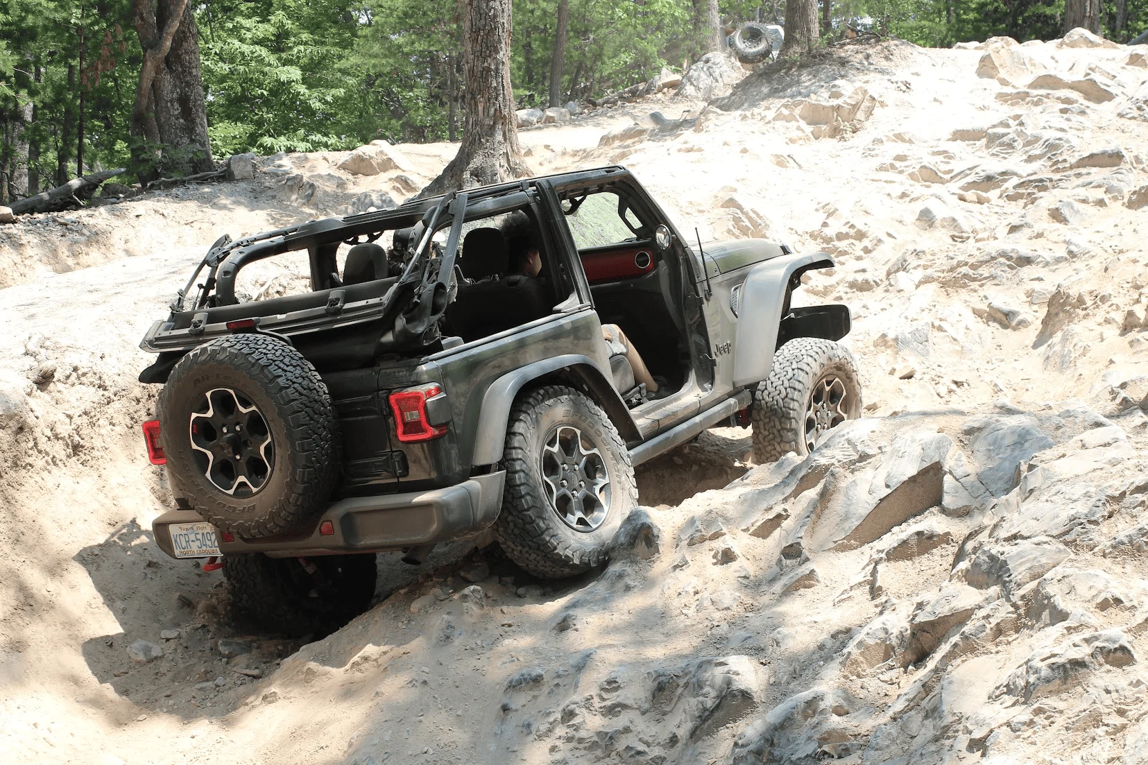

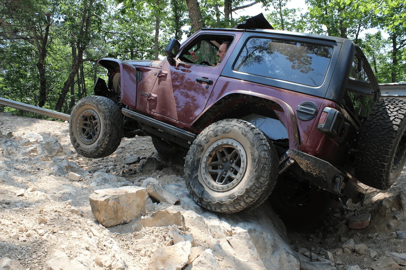

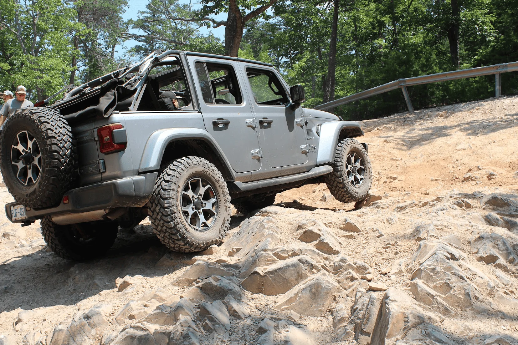

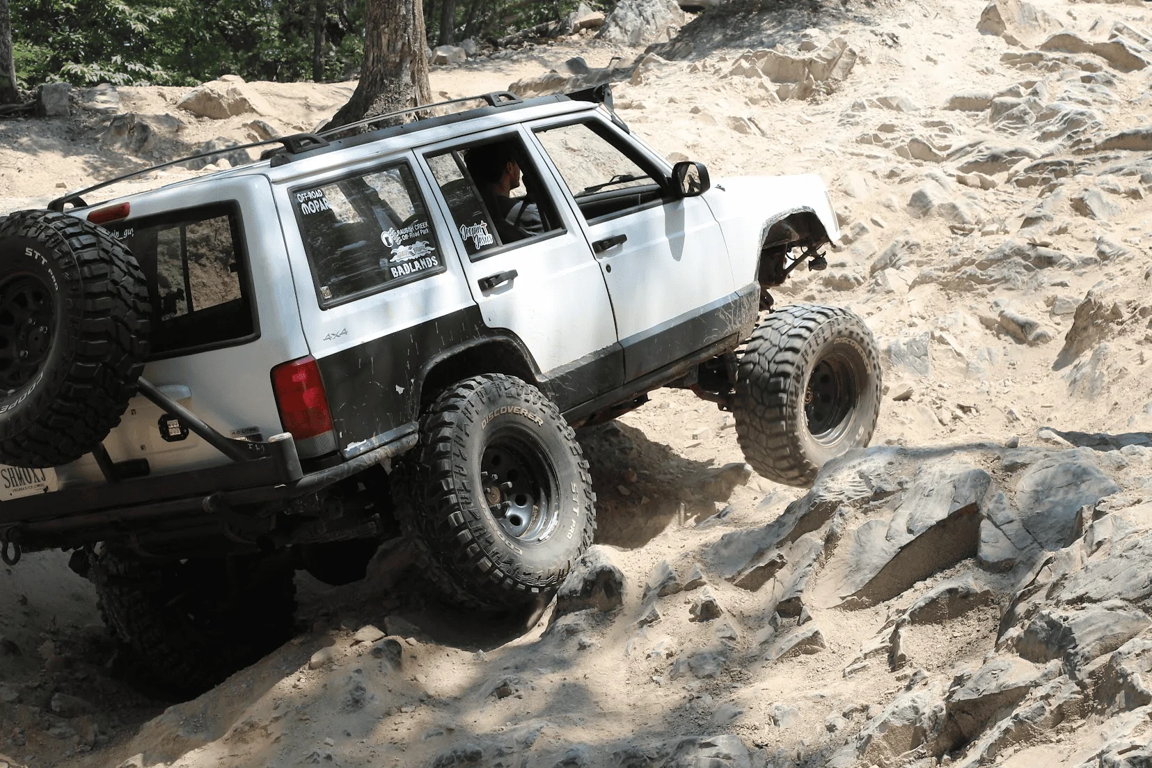

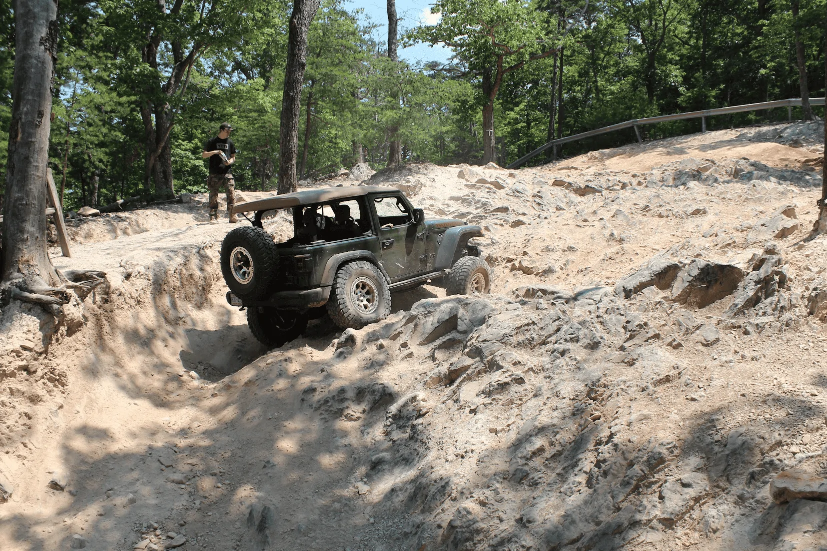

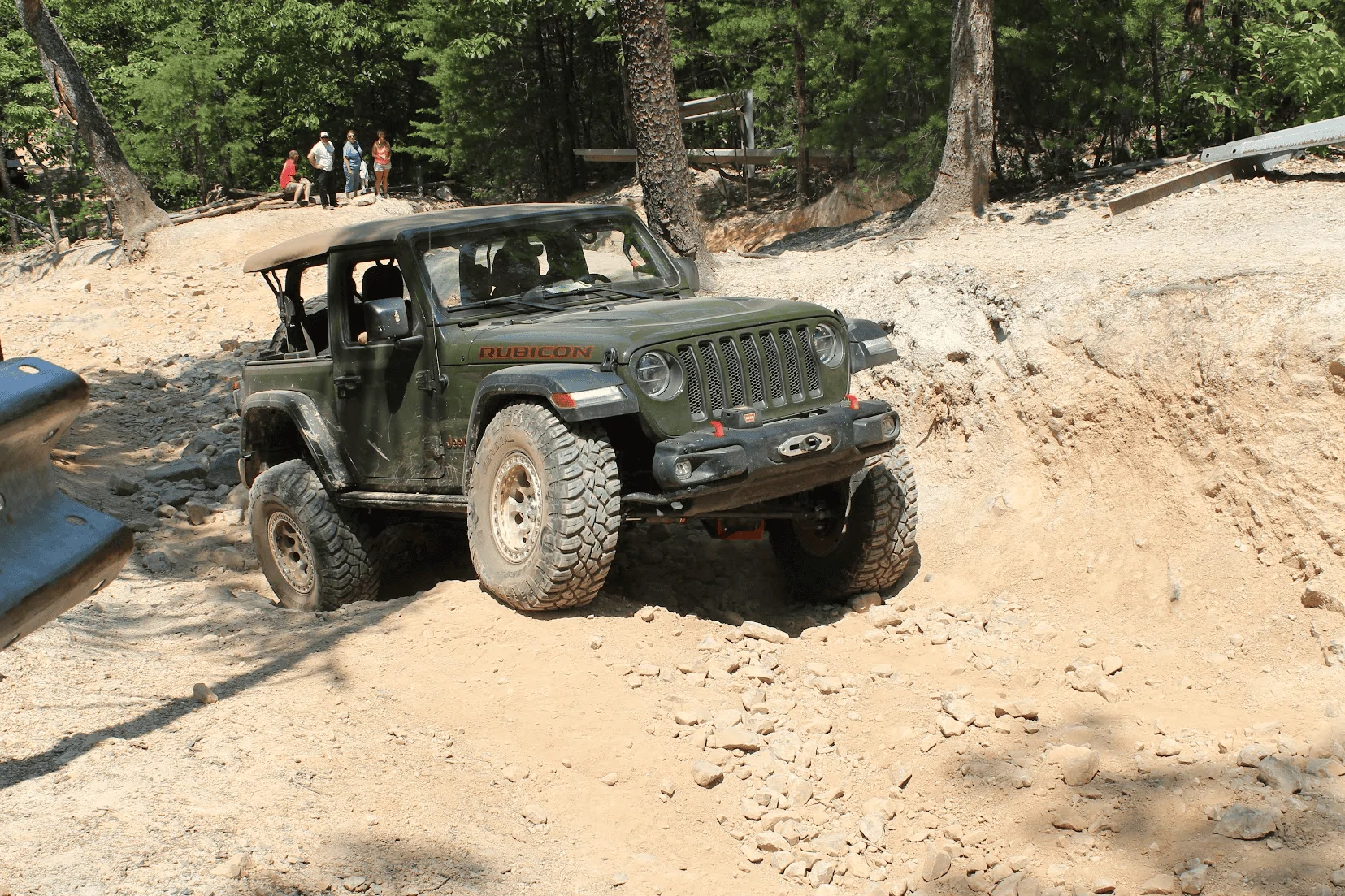

Alright, another Uwharrie trip in the books this weekend and the last before the Windrock trip at the end of July. Met up with @Sean L and @yokramer for a trail ride. Was a great time! Pretty much the only place we take pics is on the Dickey Bell climb it seems and this time was no exception:
Jeep Wrangler JL '22 JLR 2.0T build progress/wheeling thread 1686614576144
Jeep Wrangler JL '22 JLR 2.0T build progress/wheeling thread 1686614873488
Jeep Wrangler JL '22 JLR 2.0T build progress/wheeling thread 1686614971449
Jeep Wrangler JL '22 JLR 2.0T build progress/wheeling thread 1686615048507

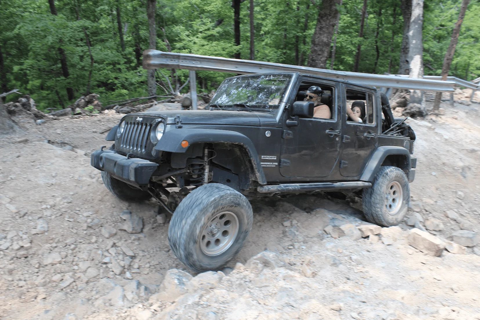

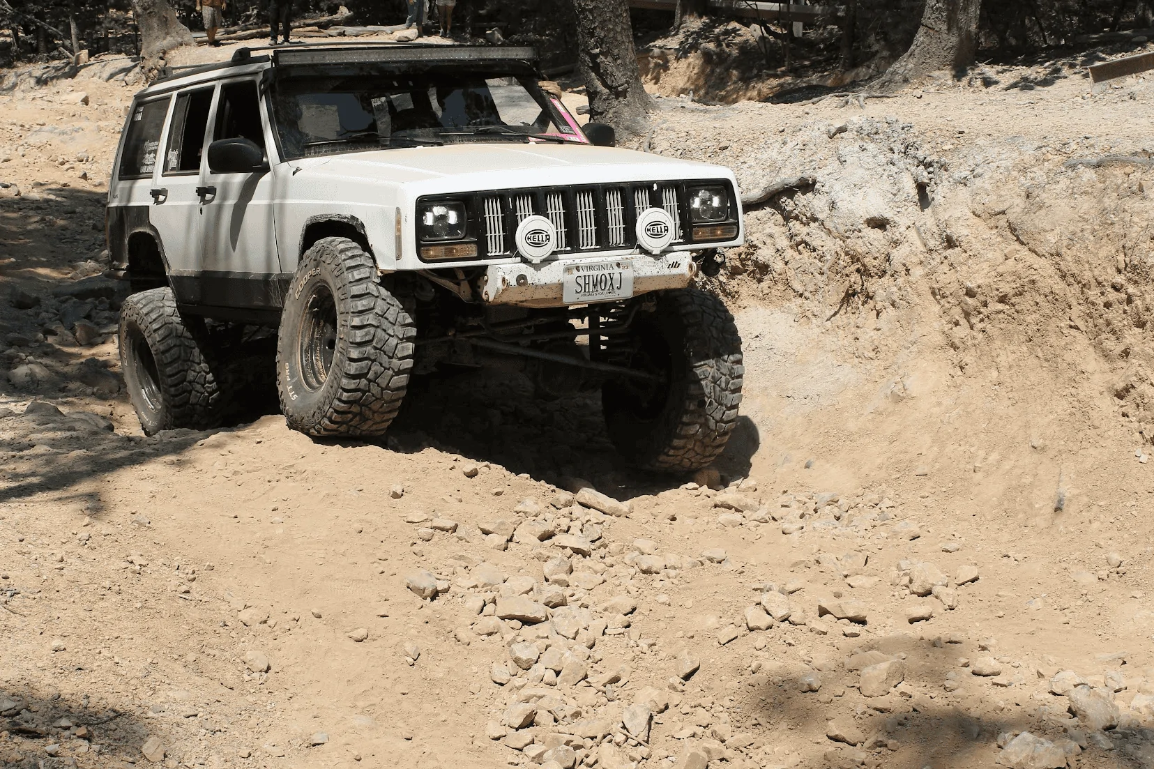

We also ran across someone on the trail in an XJ who wanted to attach themselves to a group and do Dickey Bell for their first time, happy to help out with some spotting and get someone doing a trail they wouldn't otherwise have run. Made me miss my XJ though!

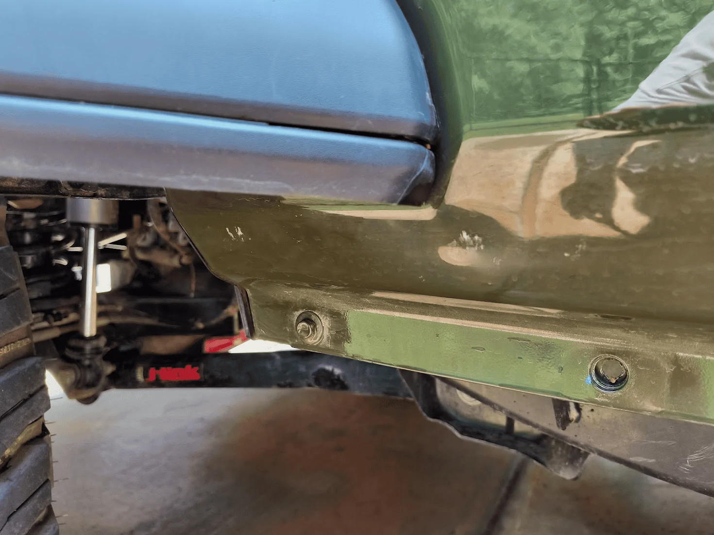

And now for the damage update - touched a few of the diff and shock skids as usual, but the big hit this time was the rear bumper getting into the tub some when I took a hard shot after a suboptimal line on an optional rock section on Falls Dam:
Jeep Wrangler JL '22 JLR 2.0T build progress/wheeling thread 1686615691488
Not the worst damage I've seen folks report the stock bumper as causing, but frustrating nonetheless. I'm torn on how I want to approach it - I like the look of the OE bumper, but it's certainly not the most optimal off road bumper. I'm also trying to avoid spending much more on parts this year, given that I'm kinda sorta wildly over budget. So, I've been chewing over either not doing anything till next year or doing something that's a little lighter on the wallet like the Metalcloak bumper reinforcement brackets. Long term I waffle even harder - if I do the brackets and they work well, stick with those even though this bumper's going to get tore up with all the plastic on it? Move to an aftermarket bumper - really the only one that's been catching my eye is the Metalcloak bumper given the nice rear pinch seam protection and replaceable nature of the end caps, but I dislike not having a smartly integrated license plate solution. I dunno, things I'll have to mull over I guess.
Anyway, also pulled the stock rails and sure enough they got into the body too, likely from a few hits I took while wheeling stock:
Jeep Wrangler JL '22 JLR 2.0T build progress/wheeling thread 1686616195929
These are the most egregious, but there's also a nice line of scratches down the full length of the driver's side rocker. The "performance" rails were definitely a gamble that didn't pay off. Got some touchup paint coming and then it'll be time to start work on the Metalcloak rails. Hoping to get started with that sometime in the next week or so, and then start in on the rear spring swap to the JKS HD springs.

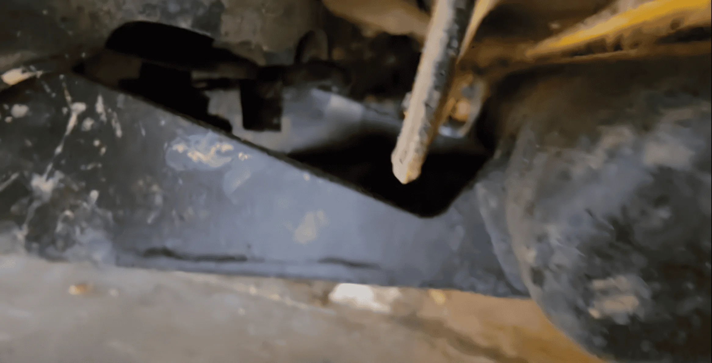

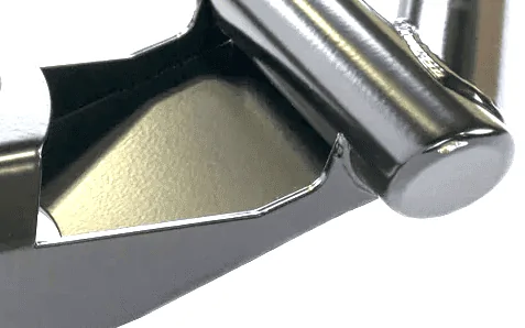

So, just as a point of conversation, this video that popped up in my YouTube feed provides some context to the decision to go with the MC body mount sliders:
In particular, this still from the video:
Jeep Wrangler JL '22 JLR 2.0T build progress/wheeling thread 1686688294558
Anyone else noticed how many frame mount sliders follow a similar formula of tying in at the body mount brackets and using super long brackets to reach out from under the body past the pinch seam to hold the tube? Not a dig at Rusty's in particular, I like a bunch of their stuff, and their mounts do appear to be overbuilt compared to some of the others out there:
Jeep Wrangler JL '22 JLR 2.0T build progress/wheeling thread 1686688764439
But the fact that even this is still not enough - at least on a 2 door, no idea if a 4 door might flex less because of more support from the third body mount bracket - to keep the slider out of the body is pretty crazy to me. It definitely seems like a thing that's more common with JLs than I remember being common with the JK. I really don't remember hearing about frame mount sliders flexing with the JK.
Anyway, random ramble lol, this has me even more curious to see if my gamble on the tub mount MC sliders is bullshit or legit.
