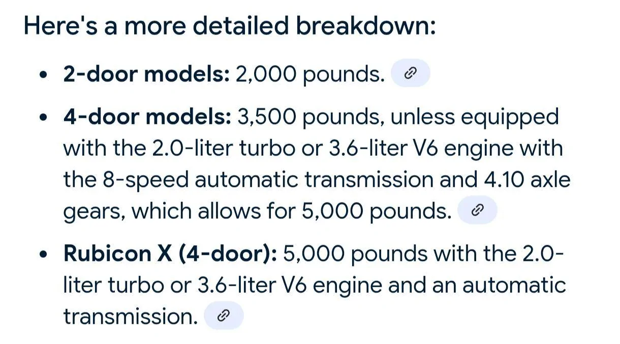

If you want to play by the rules, I would follow this screenshot from Google AI:

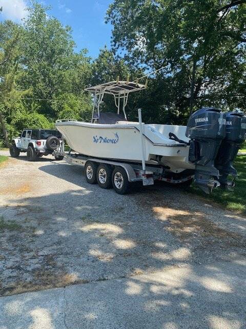

However I have personally pulled double+ (~8,000 lbs) the weight my '21 JLU EcoDiesel is rated for, 400 mi across flat ass Texas, with zero issues. About 4 hours of driving one way with outside temps around 98°f. The engine saw a max temperature around 232°f, and that was with the AC running and the engine fan on full blast. We only stopped once halfway so I could top off the fuel tank, but I never turned off the engine the whole way. My mileage ate shit, but beyond that wasn't too bad.
I agree those numbers are just recommendations. I gotta put it in 4 low and lock the diffs to get up the boat ramp though.

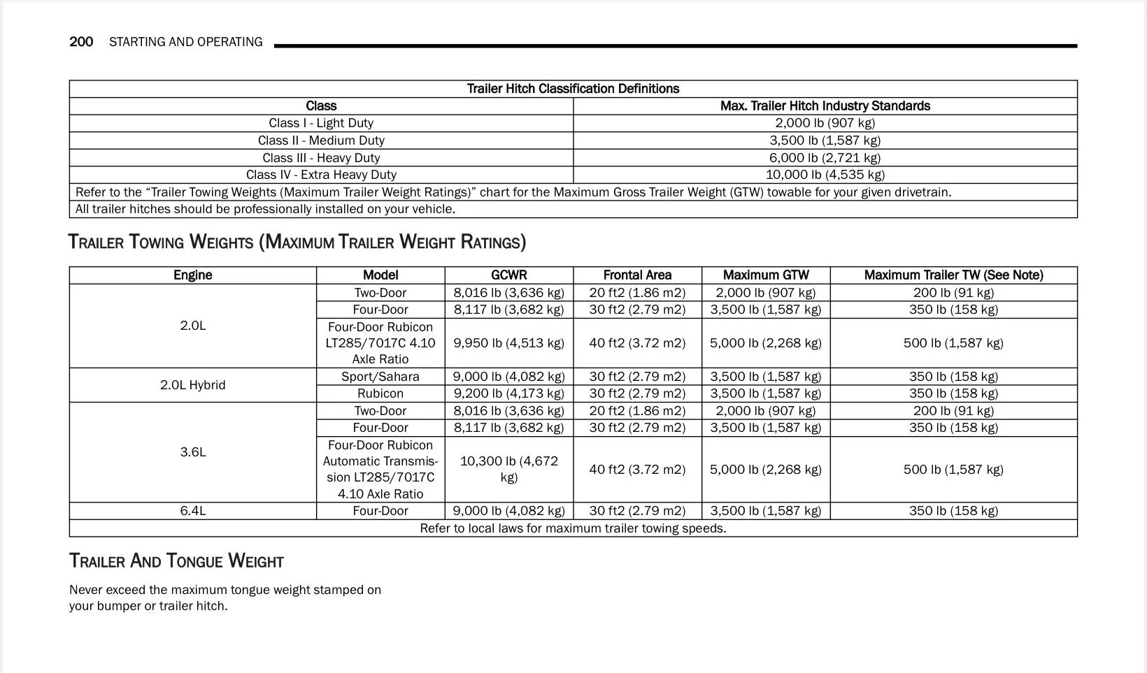

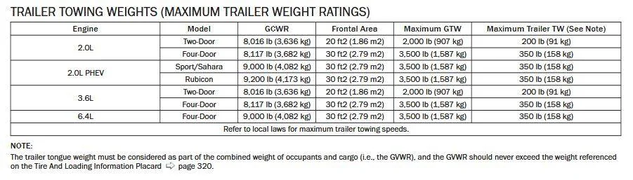

There are multiple versions of the owners manual, some which show 5000 lbs and some that do not. Also the frontal area is different. Here's what the online manual shows.
