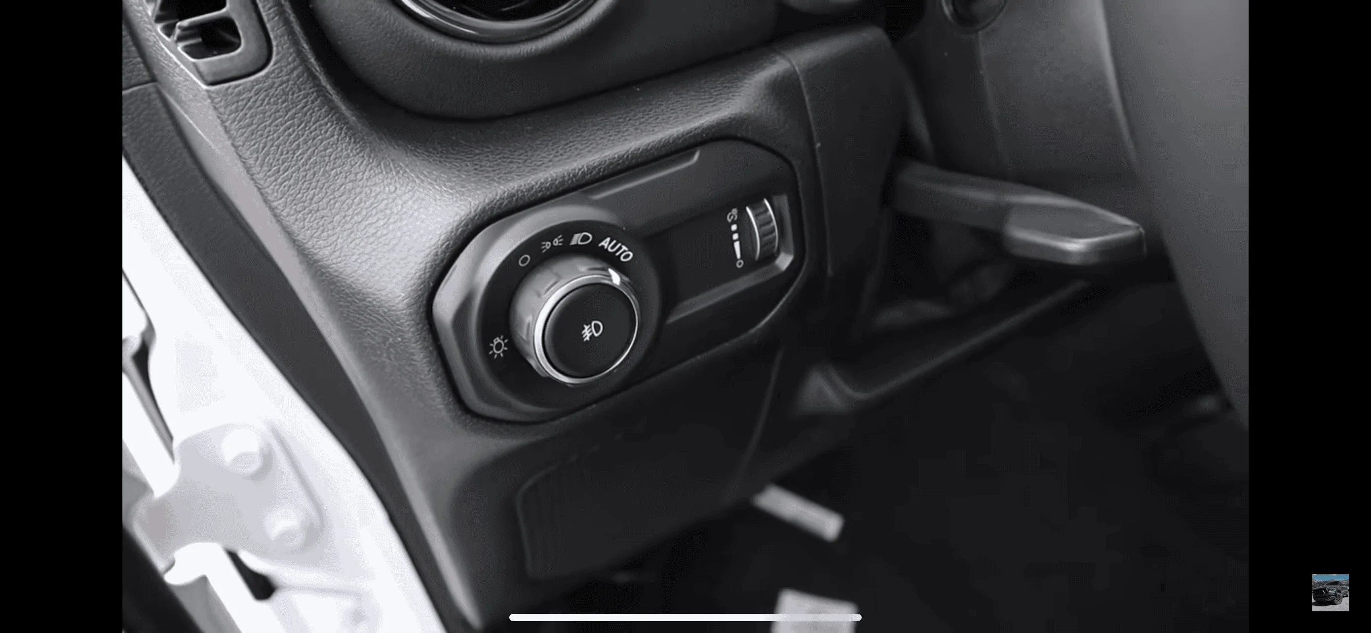

Jumped into my new 2023 noticed its missing one of the dimmers. They combined it into one dimmer. I really enjoyed the double dimmer on my 2019. I had the dash lights all the way up and footwell lights dimmed low. Now you adjust all of them together. I wonder if it can be modified to dim each of them separately.

I'm not happy about this on my 23. I like the option of the lights at the floor but find it distracting when I'm driving. Now you have to dim all the dash lights to make the floor lights go out. I'm wondering if an older switch would be plug and play. Maybe trade someone with an older sport that has the second dimmer for no reason.

Not really sure how bright the footwell lighting was in older JL models, but for my '23 it's so dim already that it's hard to tell whether it's on or off. Rest of the ambient and button lighting is super-dim at max brightness at well.
Already mentioned it before, but I absolutely hate the new single dimmer dial and get pissed having to mess with it multiple times each day. With park or headlights on during the day (or with auto on), the gauges and uConnect screen are far too dim to read unless the dimmer is in the upper notch below the dome light being on. At night they're eye-searingly bright unless moved to the sweep portion just below that notch. Imo, that notch on the dimmer should be an 'auto' setting that uses the auto headlight sensor to adjust interior lighting (or max brightness for models without auto, and the sweep always being a manual override of either).
I know not everyone drives with park or headlights on during the day, but for rural windy roads it's recommended and our state law requires headlights on when wipers are in use or within road construction zones (active or inactive). Been driving in this manner for several decades and it's never been a problem with dozens of other vehicles - just find the sweet spot and forget about it.
