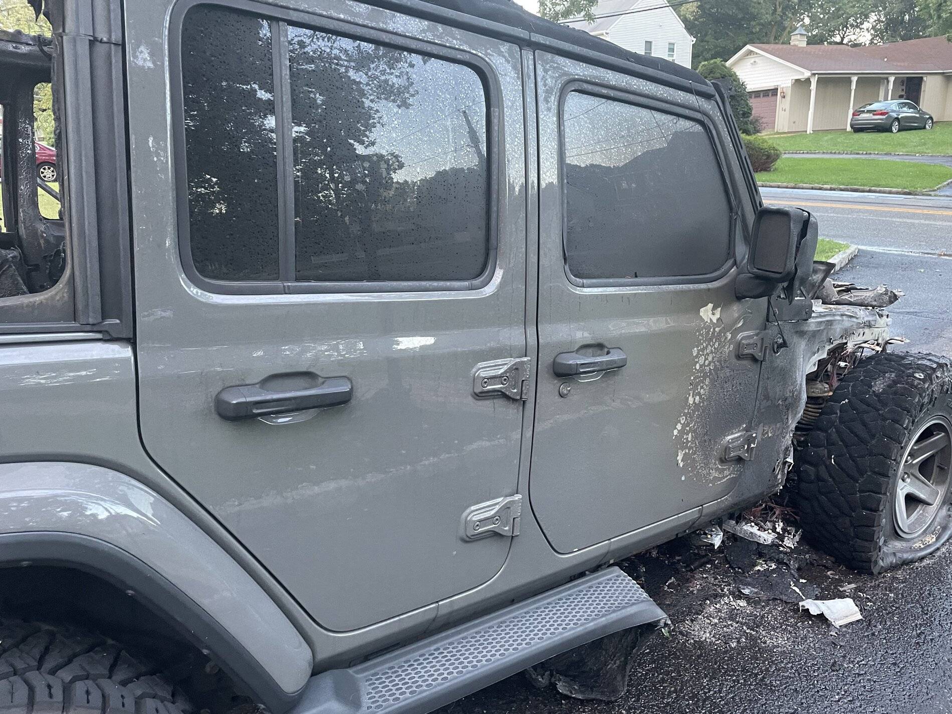

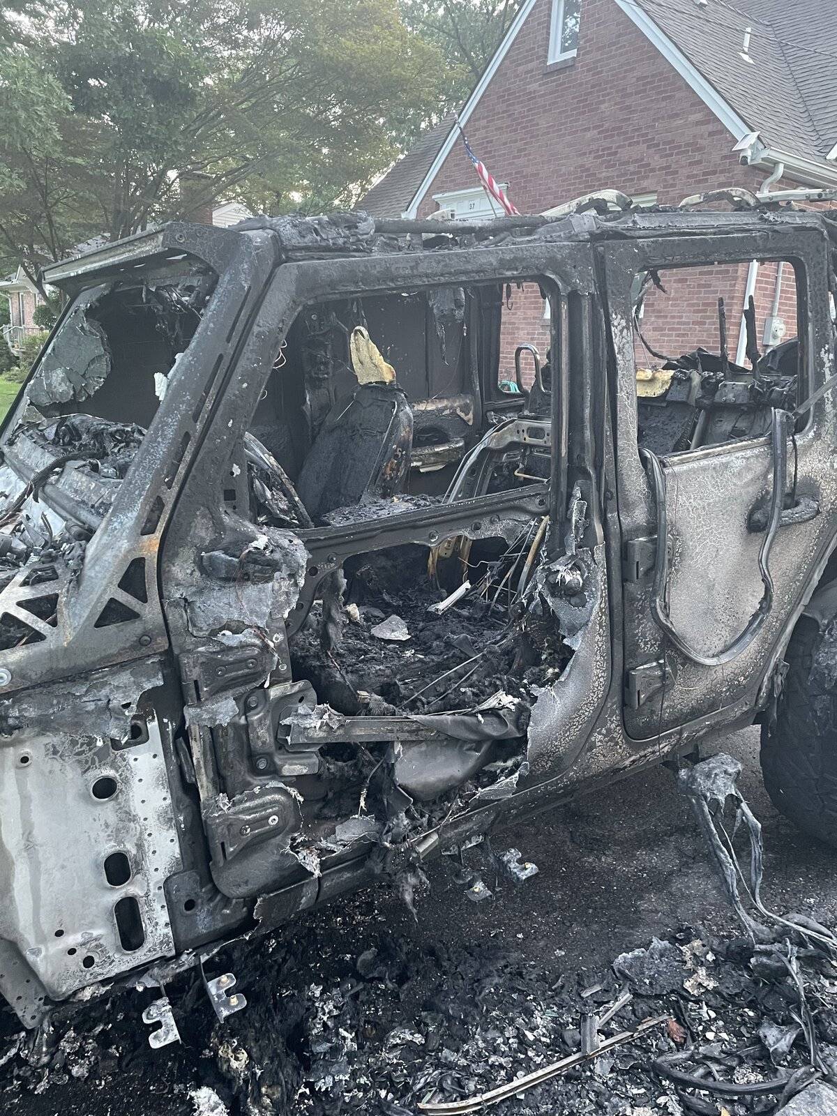

How are you able to identify that the fire started inside of the engine compartment, under the hood? You state that it's obvious but... is it??
Does this picture make it a little more obvious where the fire was? Seems pretty clear to me that the fire was at the front of the vehicle and not the rear...
*sigh* What story does this picture tell? Looks to me like the fire was at the front and also the middle, almost exactly where the 48v battery is located. How can you tell if the front or the middle started first?
Jeep Wrangler JL 2018 Jeep Wrangler Fire 6AB15949-4BEB-4BE9-BF2F-B421203C8B84
I swear I'm not trying to be an asshole. I'm no fire investigator and never made a claim to be. But you seem so confident that it had to start under the hood and I want to know why you're that confident. I look at these photos and think "damn... could be either one" I don't even know where to begin to make an argument for one over the other.
eh, still way less damage at the rear than the front. back tires aren't blown which means it didn't get too hot there. Pass side paint and plastics arent even melted or damaged. Drivers rear tire is right next to the battery (along with the gas tank) I would think if the fire started there you'd see most of the damage at the rear. The driveway is also sloped up at the back and down at the front, fire naturally would run upwards so if it started at the rear there is no way the rear (pass side) would be completely unscathed and yet the downhill side (the front) would be melted into the ground.
I'm no fire investigator either, I'm just using basic logic while assessing the photos.

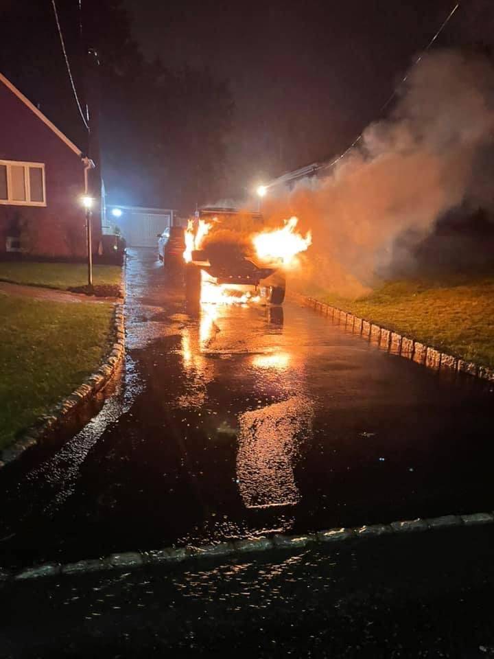

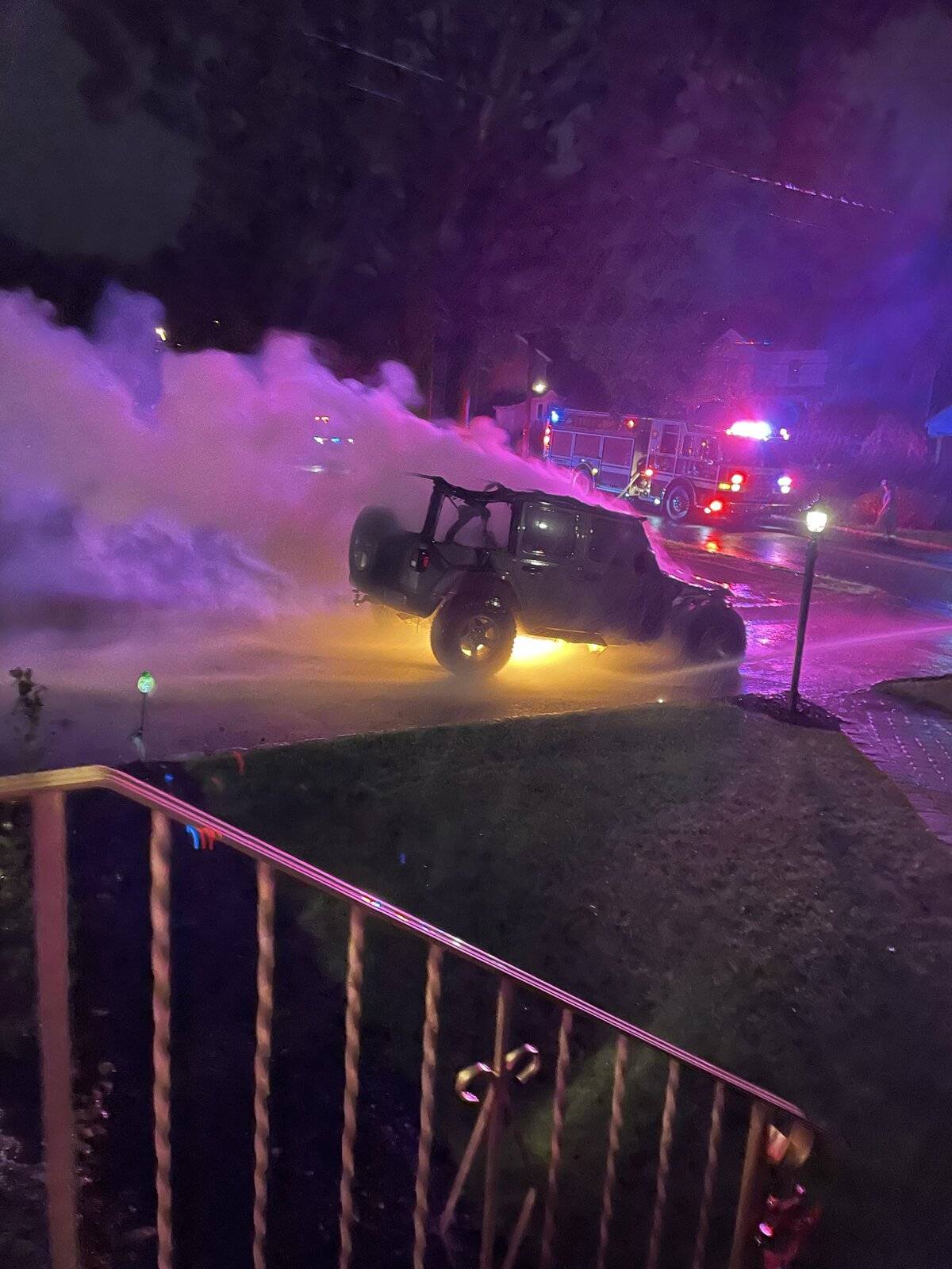

Look at this pic and tell me where the fire is burning ,left or right side. Now there is no aftermarket wiring on the drivers side of the jeep only what comes from the jeep itself 48 Volt wiring , Coolant lines 48 Volt, and fuel lines and exhaust and brake lines. second pic look at the color of the fire under the truck that's not full burning.
