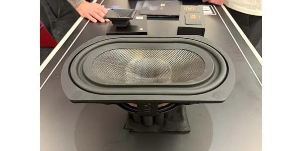

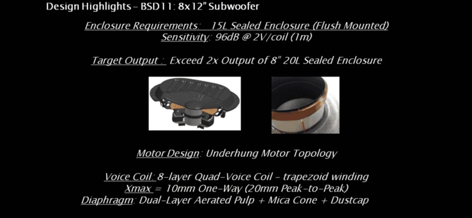

I've messed around with the 2-door sub in a few other threads, mostly by adding polyfill & sound deadening to the OEM enclosure, but recently thought about a full subwoofer and/or amplifier replacement. I found the Tang Band W8Q-1071F rated 250W RMS @ 4Ω, but it is discontinued. Likely not much better than OEM anyway.
Recently I found the BLAM S812 & MB812 rated 500W RMS with dual 2Ω voice coils.
Jeep Wrangler JL 2-door Alpine subwoofer replacement/upgrades BLAM-8-x-12-su
Jeep Wrangler JL 2-door Alpine subwoofer replacement/upgrades BLAM-8-x-12-sub-2
