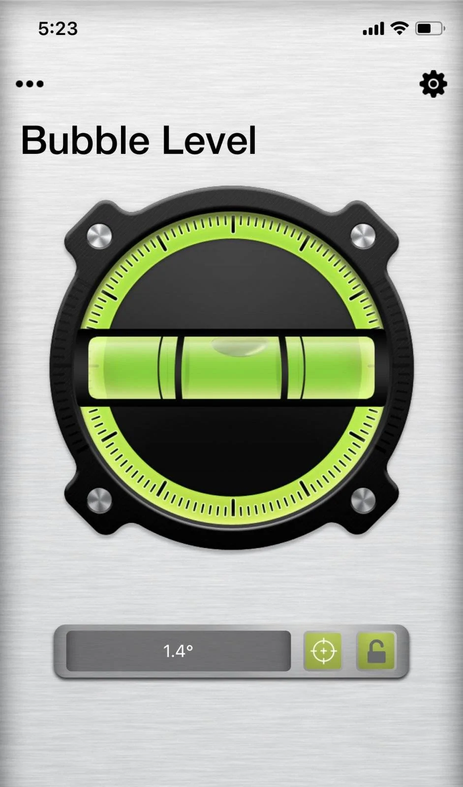

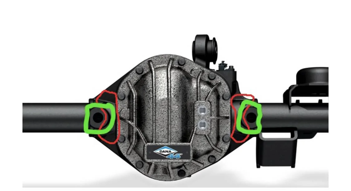

so just tried two different apps, cant really find one that seems to do angle in the right way.. and also not exactly sure what method to use. do i measure side of hole to side of hole, or hole to ground.. I am not very mechanical.. I am good at sports, business, and my dad game is pretty strong most of the time. :)
hoag4147
Rick
Dec 13, 2019
64
4,450
6,157
Colleyville, TX
2022 JLUR XR
I just used this app
Jeep Wrangler JL 2.5 plus lifts need caster correction 547B93BF-ADA9-4A35-AA91-93FAABA12267
and place phone on the section circled in green. It should show a percentage like in pic above.
Jeep Wrangler JL 2.5 plus lifts need caster correction B7004457-C02F-40AB-AA79-A7F209311F8D
ok so the regular iphone app level gave me a reading of zero, your app gave me a reading of 0.26..

So that would mean I am probably around 5.8 caster right? so likely the guy at the other shop was just lazy and thru out a number of 4.5 becuase he knew i had fixed lower, but didn't know that RK makes them longer, and instead of backing off when i asked more questions was prideful and talked me down.
hoag4147
Rick
Dec 13, 2019
64
4,450
6,157
Colleyville, TX
2022 JLUR XR
If zero on regular app I believe you are very close to 6. There is definitely better way to measure but that was just a suggestion to do something quick.
