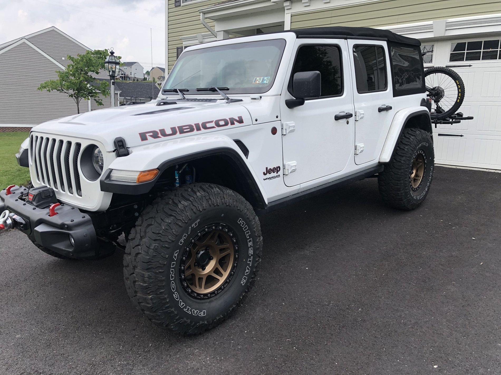

I just switched from a rc 2.5 spacer lift to Rock Krawler adventure series 2.5 lift with lower control arms
Night and day difference
Mind blowing how much better the ride is
That being said
I know a lot of people are running 2.5 lifts without a correction bracket or aftermarket control arms.
Add fixed or adjustable lower control arms or even a bracket
Such a difference

I just received my RK 2.5 lift. Do you have any pics installed ? How was the install?

Install was good
No issues at all
Biggest pain was removing the metal brake line bracket that is connected to front lower control arms
Don’t have any specific instal pics
Once I start I just kinda go

Awesome to hear! Hoping to install this weekend. Are those 37's? If so, have you flexed much?
Good luck! Yea 37 Milestar Patagonias
They ride awesome
Haven’t really flexed much hopefully soon
